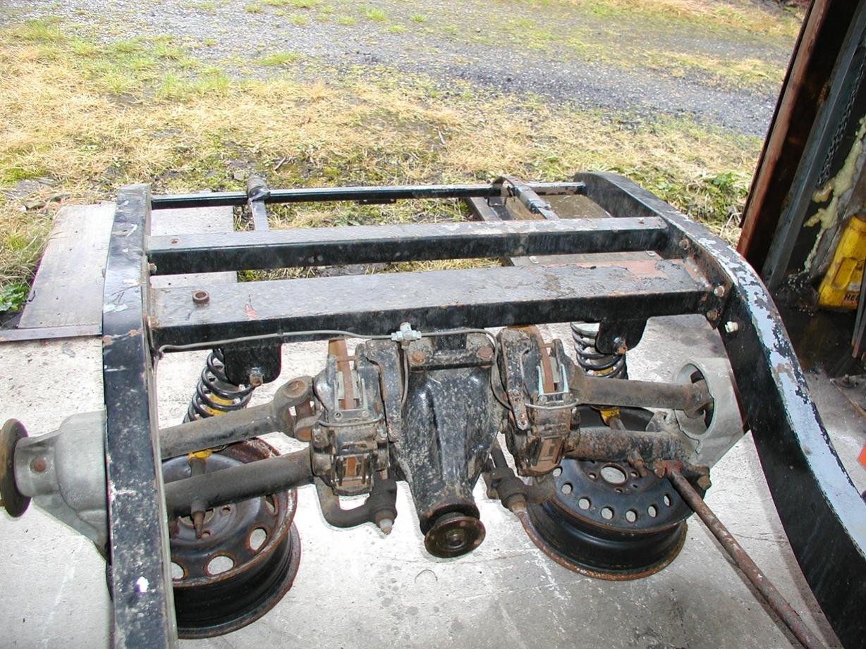

  6. These are some old (not very good) pics of a rear one I bought (already done). Hope this helps! You also need some plating underneath! ( Sorry, no pics)

    hmmm. Thanks for the pic, Looks like the dual rear coilover shocks on either side were done away with for single Alladin coilovers on each side. Im sure i'll try to get away with that --shose shocks are expensive!

    Those trailing arms were done incorrectly.
    Either lose them (not needed if the pumpkin is solidly mounted properly), or change them such that the front of the trailing arms pivot on an imaginary axis drawn forward thru the lower inner fulcrum shaft bearings to the front of the car.
    Reason: Jag rears have no rubber bushings (solid, tapered roller bearings) and have no interference movement at all. Driving the vehicle as that one is build will introduce interference movement, and since there is not any, you will be stressing and flexing pieces not intended to be stressed or flexed.
    The stock Jag runs the no-rubber-bushing IRS inside a cage that itself is mounted in rubber. That's why Jag used the trailing arms - to control the movement of the overall cage.
    This is a very common error and probably arises from builders used to rubber-bushed, interference suspensions as opposed to the Jag IRS.

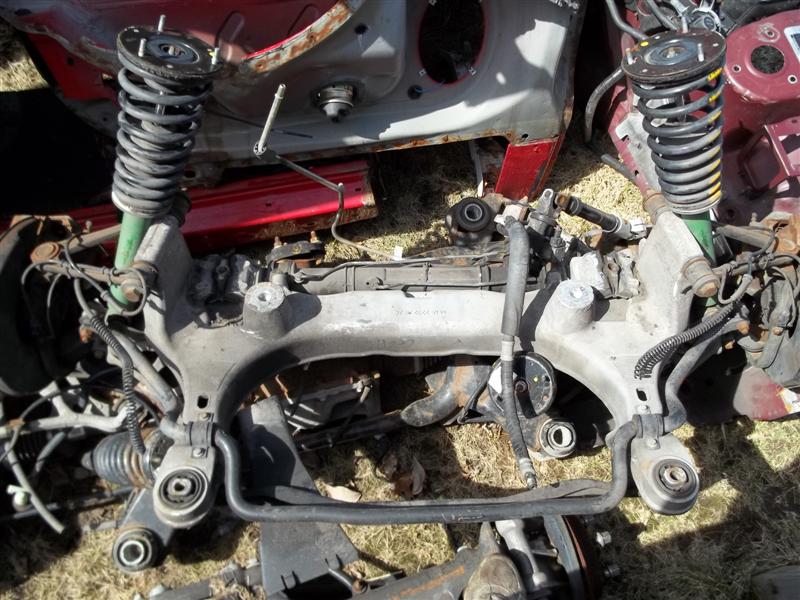

    this is the jag i found to use on mine, it's a 96 xj8 (all alluminum) might be hard to do,with that high coil over shock, but i could do steel L bracket welded off the frame, and make cup to fit the shock. if i can fit it under my fender.
