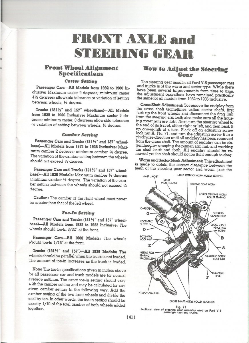

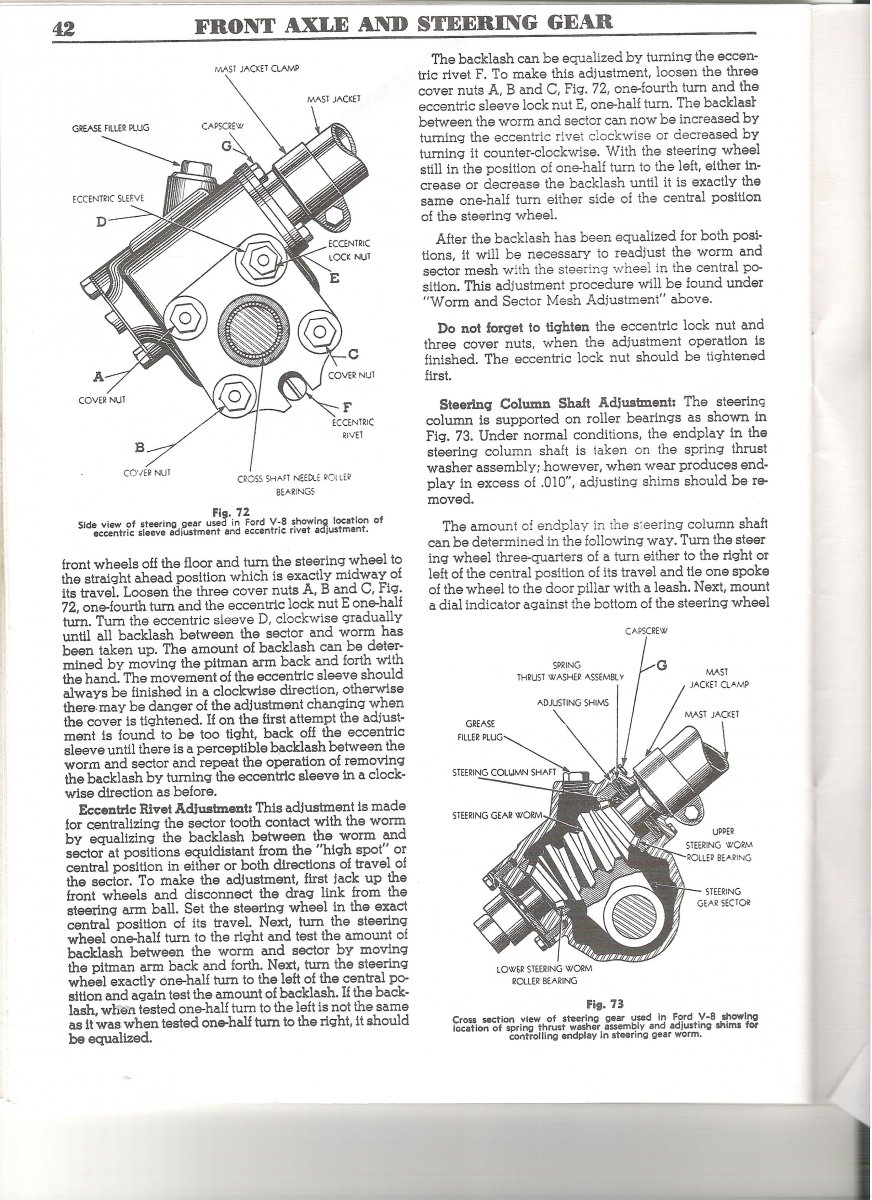

    See if you can blow these up. Sorry for the double on first page. As for upper steering rubber bearing, steering wheel needs to be removed, not a fun task. Aftermarket replacements are available, they also make a needle bearing replacement which I ave used but don't feel it is necessary.
    steeringboxadjust1 001.jpg steeringboxadjust1 001.jpg steeringboxadjust2 001.jpg

    Well, those instructions are way better than I guessed at.
    Yes the upper bushing is rubber, and 85 year old rubber is no good. I've seen replacement bushings with a bronze sleeve inside so the bronze is what rubs on the inner shaft. A much better solution.
    To get the old one out it might be done with some long construction screws turned down into the rubber, then grab them with pliers. Or you may need to slip the column off the shaft and push from below with a long pipe. It might be wise to pull the column off anyway, because you don't want any of those rubber bits to break off and slide down into the top bearing of the box. Should be a felt seal at the top of the box, but it may have disintegrated too after all these years.
