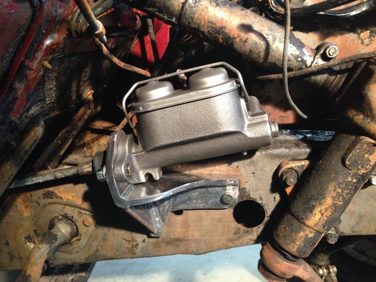

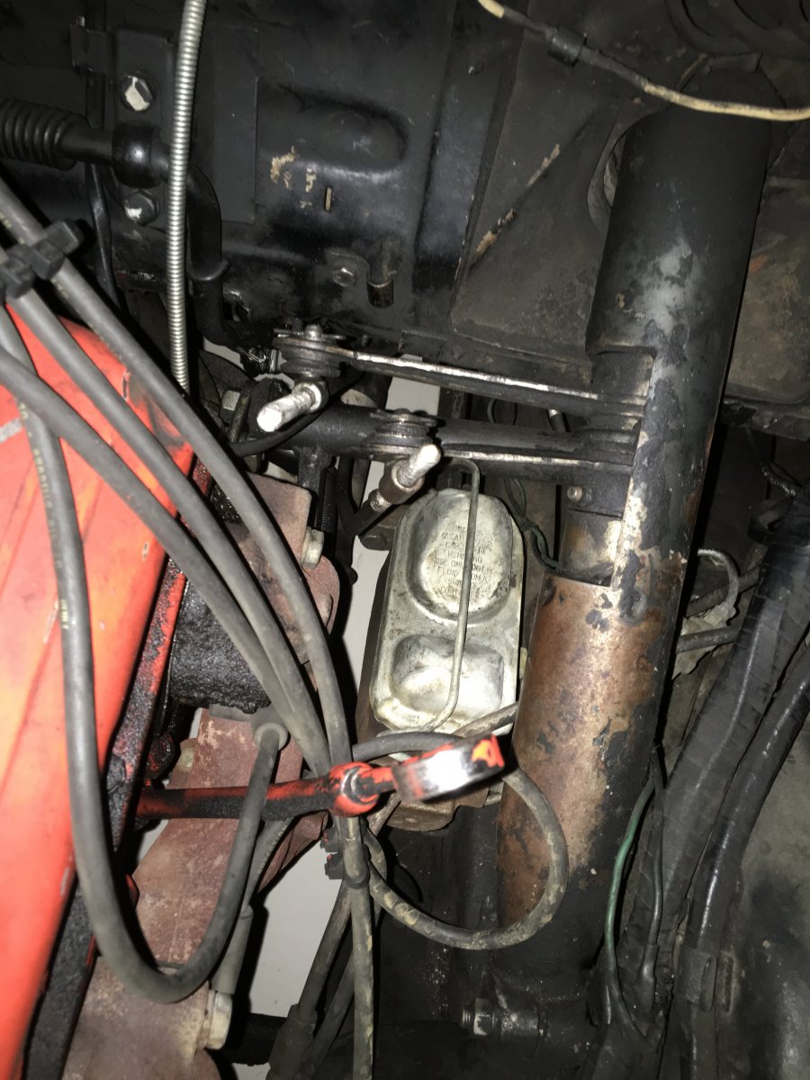

    I'm running the fatman bracket and a 1977 mustang manual master cylinder. The masters are getting hard to find and usually need to be ordered. I also have the jamco front disc conversion on the front. I have driven 60k miles with one new set of pads and one new master cylinder in that time. Works real good and gives me just enough space for my chevy motor and home made clutch z bar.
  17. Now that's a true 60k daily driven motor shot.....oil caked exhaust manifold :).

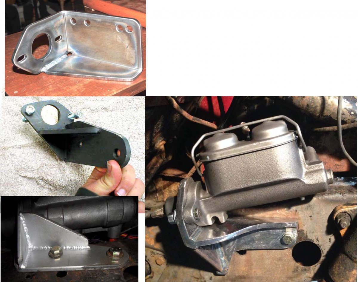

  18. Just got a bracket from ECI - top photo. Bottom 3 photos are all I'd ever seen as a 'Fatman'
    bracket. The MC will mount quite low compared with others and the outlets will be tight against the bracket.

    This is a bracket I made. I am not a fat person. [​IMG]
  20. Ok you are slim, but that master cylinder adapter mount bracket configuration has come be known as the Fatman since Fatman sold them until recently. I was led to believe ECI built them for Fatman and ECI was the only outfit who agreed to make one for me. When it arrived it turned out to be different, but I see know now it will work I plan to use the Wilwood master cylinders with remote reservoirs instead of cast iron mc.

    When I made mine, I'd never heard of fatman. I'm not slim either.
