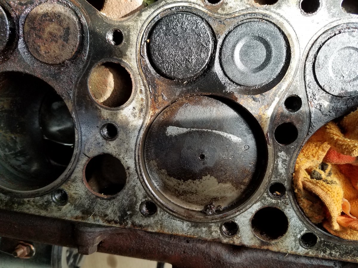

    The motor looks like it has tin can sleaves in all bores.

    not sure what you mean please explain thanks

    Hi I am wondering if what Banjo rear said is true what would be the reason for sleeving all 8 cylinders and is this a good thing as far as rebuild . thanks

    No it doesn't look like it has tin sleeves to me. I think he just saw the outline of the old gasket. Carefully take it apart and see if it's worn in the bore. If not, just rehone it, and install new rings and bearings.

    I also see no evidence of sleeves. Reasonable to suspect the ".125" stamp is for .125" overbore to 3.3125, and I don't think there's meat enough to go past that and then sleeve down to .125 over.
    Face it. you need to tear this thing down for identification/inspection/rebuild and quit trying to find a way to dance around it.

    After a second look, those gentlemen are right. I was looking at the photo on my phone and the pict was hard to see. I jumped onto my desk top the AM to take another look. Sorry if I alarmed you. There was a time that Ford was using sleeves, but your engine does not appear to have them like it was mentioned.
