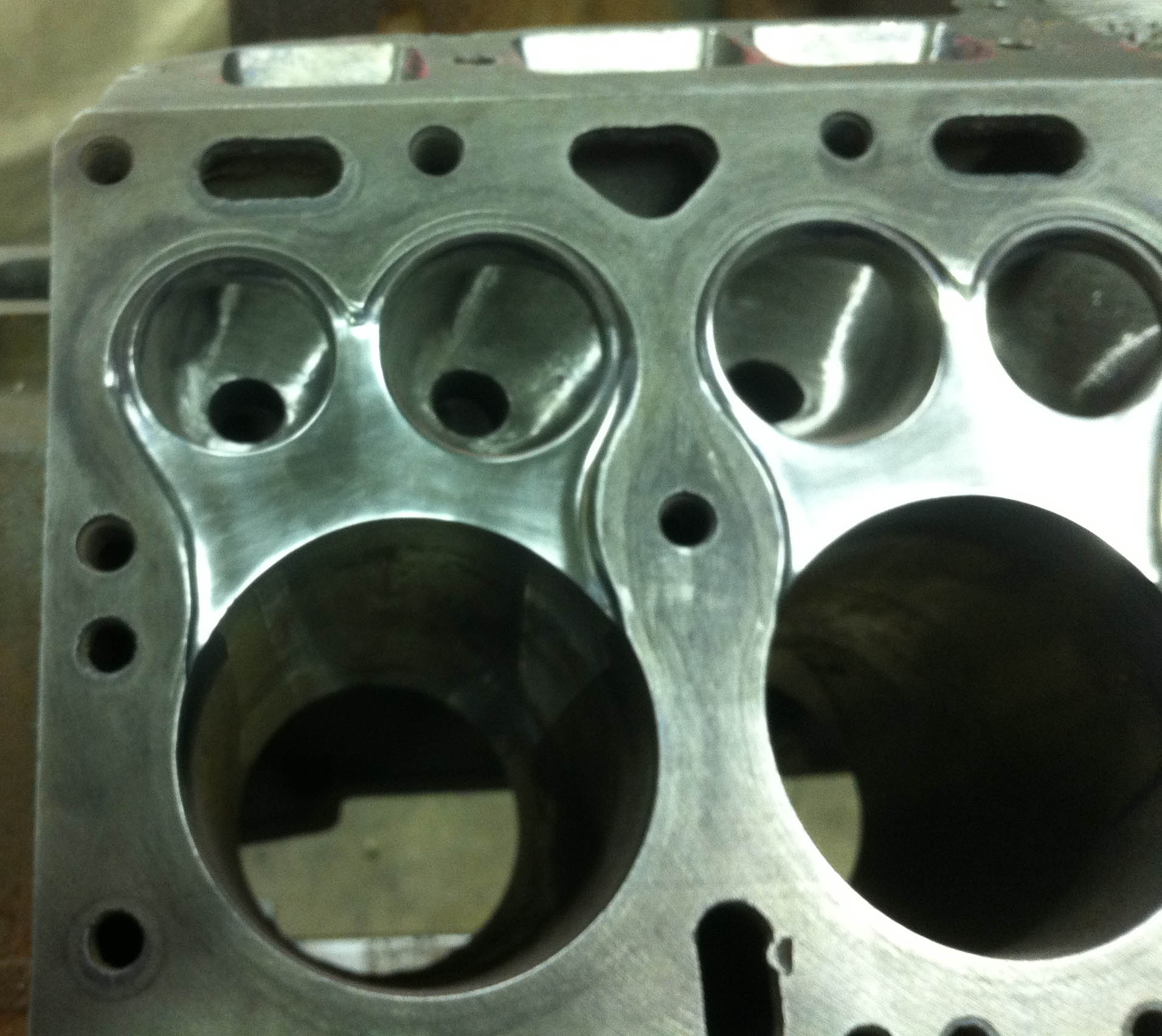

  12. seb fontana
    Joined: Sep 1, 2005
    Posts: 9,298
    seb fontana
    from ct
    Looks to me the block is relieved on intake valve side only..Not a bad way and actually a later style of hp increase so as not to lower the compression more than necessary..On the exhaust stroke the exhaust is pushed out so it would be up against the head and and relieving the block doesn't do that much except for losing compression and there is still some relief on intake side..The heads may have a little relief in the combustion chambers on the exhaust side....I can't see the marks on the connecting rod caps, all the flatheads I took apart had numbers..
    Larry Clare likes this.

    block not relieved fooled me till I looked closer both areas around valves are tapered toward the cylinder they are not ground through .
