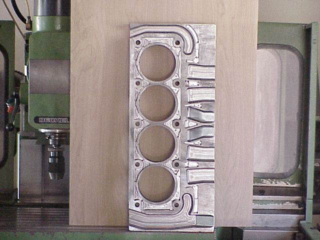

    Yes, Jimmy ran without cam bears-I don't know how Ron was set up.
    And I agree- most of all of grinds on vintage engines are based on Winfield grinds, but they work great.
    I'm also curious about the exhaust on the above flathead. Etwheels, can you provide more pics and info about the exhaust?

    We made the engine for street rodders that wanted a good strong bottom end, and that could use late model overdrive transmissions, and was a true flat head with looks of a vintage flat head. We didn't go for any cl*** at Bonneville and didn't know if it could run in any flat head cl*** as the that time it was a one-off engine. The project was started about 10 year-ago and rolled over in the corner 5-6 years ago. So all of this talk is kind of funny for us. The pictures are early in the project.

    As for the "special" cam, somethings just have to be special. It's a stock 351W blank, with the largest lift for a flathead using a factory hydraulic roller lifter and a SBC valve pattern. Even the big name cam grinder that we used said "we get funny requests but what? are you sure!"
    The only special machining on the block was some notches at the ends of the valve alley for the middle two cylinders bolt in exhaust manifolds.

    Thanks for posting. If you have any more pictures showing the engine with the heads off or any thing, I am sure many people would like to see them. I know I would.
  11. Yes not no more conjecture.
    A quick question that I am sure would answer itself but no guessing here, do the pistons climb up into the deck extensions? It is all piston top and not the ring lands?

    I see the center 4 cylinders exhaust out the top. And the end four out the bottom. Is there a reason you didn't go out the side with the end 4 as many aluminum filled Flatheads do. Would shorten up the port.

    As for the pistons **** found a manufacture of some SBC pistons that had an extra .200" on the entire top of the piston dome for someone to do their custom dome, we left all of it on and let the top of the piston come up out of the block by .200" and fill the combustion chamber. We never did calculate the combustion ratio.
    Because we added the conversion plate to the top of the stock deck we stretched the rods by that amount, so yes it has a very long rod if I remember right 7.5". For the crank we used a **** crank with a 4" stroke and the it has a 4" bore. That is why it has 402 on the top of the cylinder head, as the engine has 402 cubic inches.
    As for the sound **** said that it had that flathead sound.

    As for why the exhaust didn't come out the end of the heads is it was not built for racing, it was built to look like a vintage flathead in a street rod. And if you wanted to go for the racing look with a blower on top you wouldn't have to think about the bottom end taking it.

  21. Was the work done CNC or by hand? If you can replicate it -- I want one.
