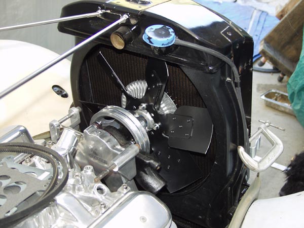

  5. The term "universal shroud" just means you're going to have to modify it for your particular situation. In your case, the big round part should probably be 4" from the radiator.
    I say "probably" because I haven't seen your set up so I have to guess a little bit.

    Fan blades should be half way in the shroud, halfway out.
    Always worked for me, Oh I like a six blade steel fan also!
