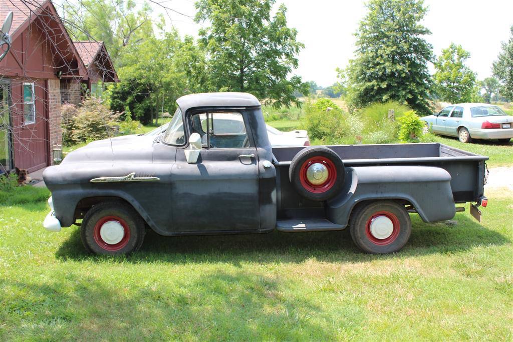

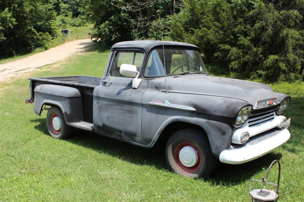

    Any suggestions on how to keep the body in good shape without putting an expensive paint job on it

    i'm jelous ..kids dont deserve a master piece like this to start out with ....restore this one to factory showroom perfect with the same factory color they came ...find restore paint shop who would know the exact colors they came in and pick one you like ...do a frame off if there is too much rust under it ...pickup trucks like this are easy to strip down using tall "cherry picker" engine lifts ...you can pull the cab with one big enough and even the bed !!!!! and then your ready to detail everything ..and it was a 21 year old kid who restored 18 wheelers who showed me this trick with big engine pickers ..and today places like harbor frieght sell lifts pretty cheap..... get one with a wide base so it will be stable and not inclined to flip over or tip over so easy ....go on ebay and you might even find the owners manual and factory shop manuals ...and look for trim pieces like for around the glass and the interior etc etc ...if you can afford it get inconel intake valves and sodium filled/inconel exhaust valves and valve seats and professionally installed with recomended valve guides and you will be able to burn any bullshit they force us to buy at the pumps.>>>>>this will explain it all >>>>

    You state that you plan to enlist after high school. That implys that you will be away from this project for a number of years. FOR THIS REASON:
    As others have mentioned, check and fix if necessary brakes, exhaust, and tires; and drive it.

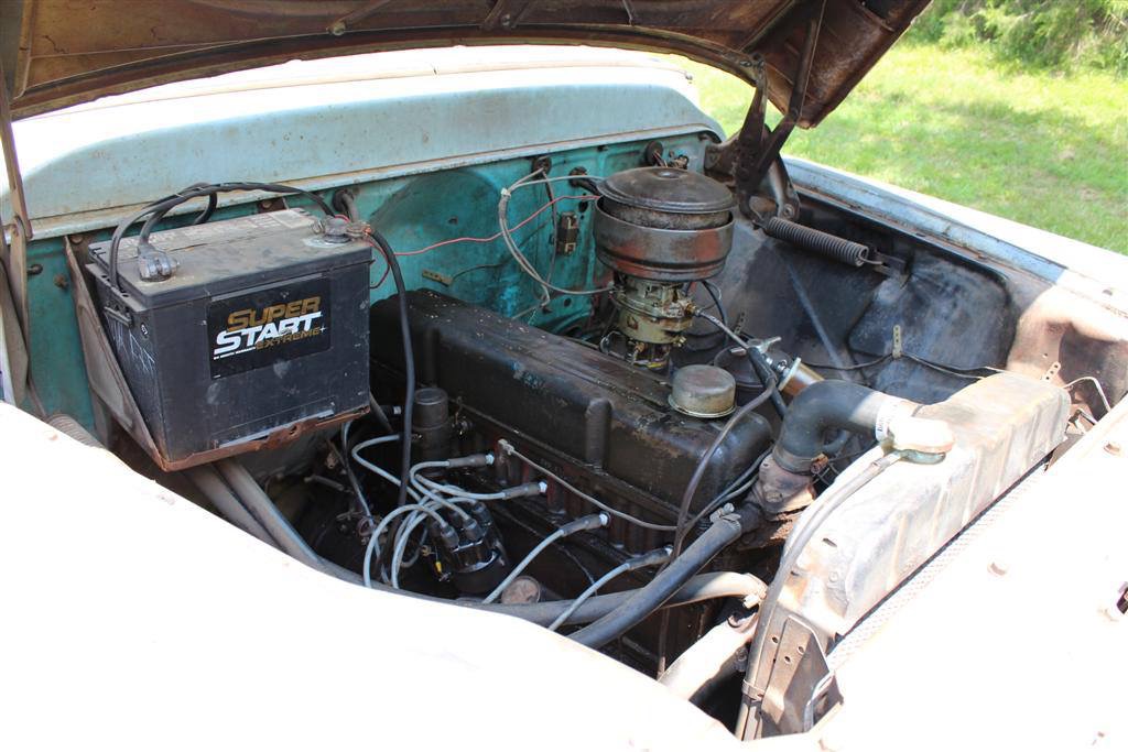

    DON'T clean the engine compartment. If you are away a few years, the stuff there now will help prevent rust until you return.
    Clean the interior (young ladies prefer not soiling their clothing in a dirty vehicle!).
    A 6-cylinder Chevy truck of this era is going to be "sluggish" if compared to a modern vehicle. Learn how if you don't know already, and do a compression test. If the engine is in reasonably good shape, do a COMPLETE electrical tune-up (points, plugs, rotor, cap, condensor, plug wires). Resist the urge to get in there and rework the engine. These things always take more time than estimated, and if you go away for awhile, parts not reinstalled may "get lost".
    Attend one of the local "cruise-ins" and look for anyone else that may have an original vehicle of this era. Get pointers from them on local suppliers that may be able to help with new old stock parts.
    In short, enjoy your last year of high school WITHOUT the responsibility of trying to finish the truck before you enlist. Drive it, preserve it, and it will be waiting when you return. It is just possible you currently have one of the most interesting rides in your high school. Enjoy!

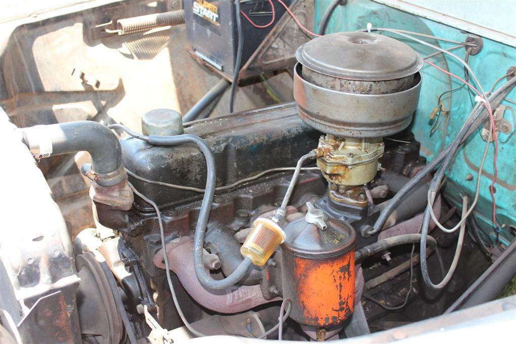

  6. Yes, replace the "rubber hose gas line" with steel, get a factory type fuel filter that threads into the carb inlet. I worked for Chevy for so many years, can't recall how many fires the rubber hoses and plastic fuel filters started.
