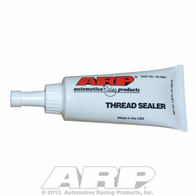

    I like to use the liquid teflon, works well or the ARP thread sealer is good too.

    The arp sealer is nice, i used it on an airtank at 175psi and was 100% leakless.
    Ive used the loc***e too somewhere else, no leaks but its a ***** to unbolt.
    Teflon should work. If it works on hydraulics a gauge on a flattie should be zero problems really.

    I prefer, the ARP sealant. It sounds like something is wrong with the threads of either the gage or the head. Did it leak before the gage? Lots of gages have multi-purpose threads and are not American Standard Pipe Thread, there are 3 or 4 different pipe threads and some of the lesser quality (cheap junk) have a peculiar thread that falls right between all of these. If you have a look in mcmaster-carr br*** pipe fitting section you'll see what i mean about the pipe threads.
