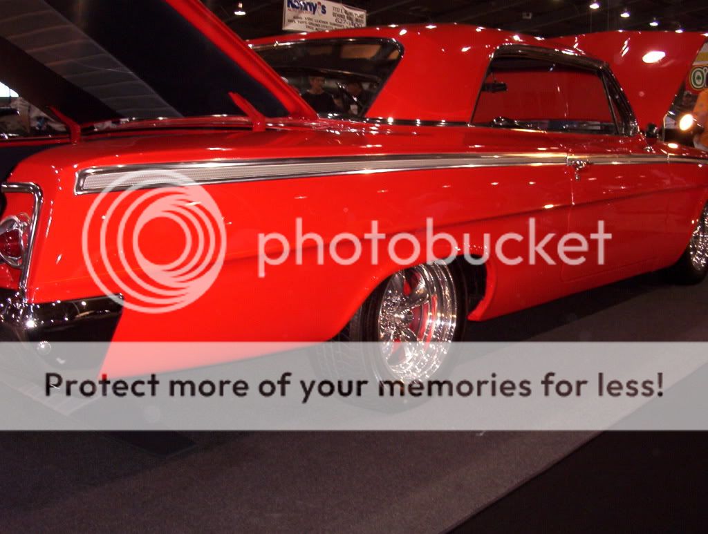

    okay, so a few guys on here know their impalas.... is it fairly even to get parts? is there any reason you couldnt use on as a daily driver?
  2. 49ratfink
    Joined: Feb 8, 2004
    Posts: 21,631
    49ratfink
    lots of repop stuff available. I did some rust repair on a 64 and got a couple catalogs. as for daily use... no problem.

    A 1962 Chevy is a great car! You can get almost any part needed from a catalog or a website. Harmon's and Lutty's are great examples.
    Roman Red is a great color. My Dad had a Roman Red 61 Impala with a 348 in it. Beautiful!
    In 62 the SS package was a dealer installed option. So there isn't anything on the VIN to identify it. The only way to prove it is to get the original bill of sale. Good luck with that! That is the reason every 62 Impala out there is wearing SS badges. It's hard to prove (disprove).
    I agree with an earlier post on the fact that you need to put this on a lift and check out the frame. The floor braces are well known to rot out where they meet the rockers. The rear body mounts are also known to rust out.
    Looks like a great car. Good luck.

    The SS option for 62-64 can ony be denoted by the trim tag and was a factory installed option. The vin show's nothing but if it was either a V8 or L6. The SS code for interior material will be vinyl. Standard bench cars had cloth, bucket cars were vinyl.
    A factory high horse car will also have a 3/8ths fuel line that is run under the right front control arm instead of the low horse 5/16ths, which was run on the frame just under the upper control arm mount. The lines are made new so they can obviously be changed, but, an original one will look just that, original.
    Also, the SS option was nothing more than a trim option. I can't remember if that was mentioned already so i just thought i'd toss that out there. An SS could be powered by an inline if so ordered.
    I won't even get involved with the rest of the discussion regarding 409's etc...
    All the early X frame Chevy's are slick, and as was mentioned in the thread, rust in the rear box mounts ( rear of the rear wheel well) are extremely common. Generally speaking, just look it over like any other car though and again, as was mentioned, get it up in the air and give it a once over.
    Getting under it will show if it is a tight solid car. The pics of it look great so it may very well be a real clean car under that nice skin.
    Best of luck!
