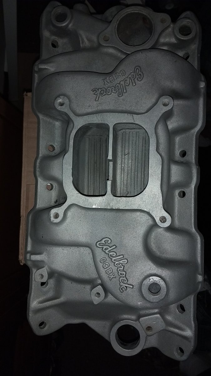

  18. RICH B
    Joined: Feb 7, 2007
    Posts: 6,297
    RICH B
    My C3BX, dual bolt pattern, no notch, fill tube angles to the drivers side, and no room for an HEI.

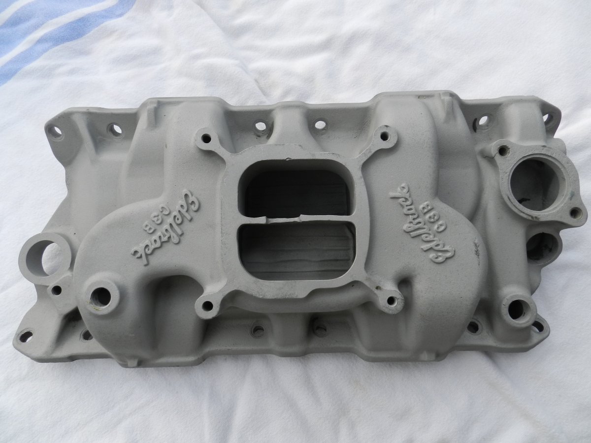

  22. henryj1951
    Joined: Sep 23, 2012
    Posts: 2,304
    henryj1951
    from USA

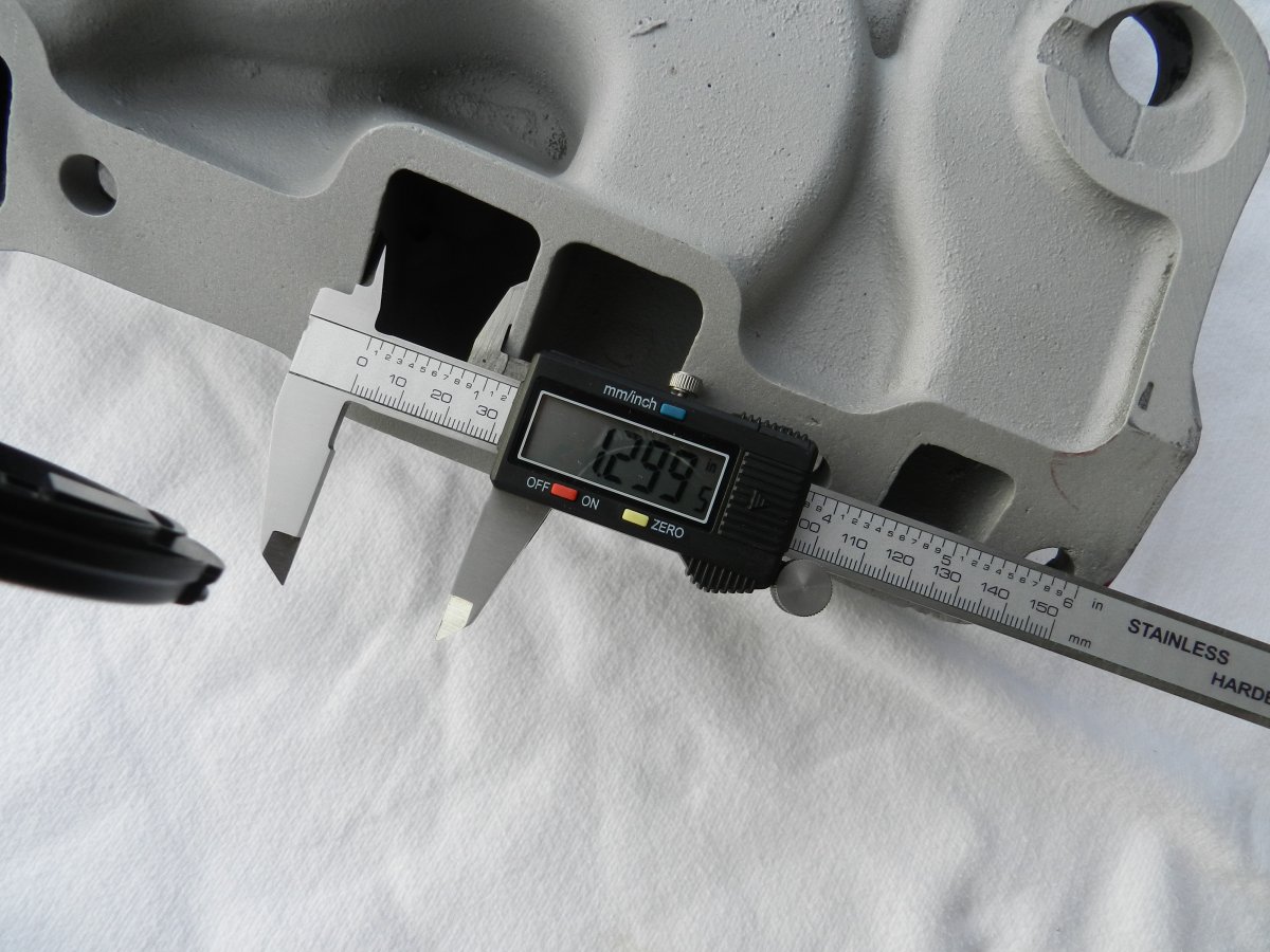

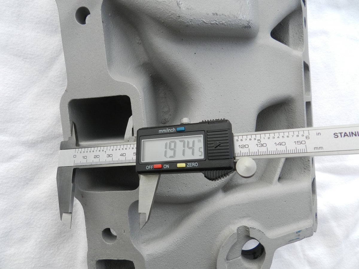

  23. henryj1951
    Posts: 2,304
    henryj1951
    from USA
    X- has dual bolt holes -n- NO cut in the center.
    Deuces likes this.
  24. henryj1951
    Posts: 2,304
    henryj1951
    from USA
    Note the flat heat riser pad in Rich B's pic ...
    1Nimrod and Deuces like this.

  26. henryj1951
    Posts: 2,304
    henryj1951
    from USA
    ^ yes or sometimes even more cut out of the center.
  27. 1Nimrod
    Joined: Dec 11, 2018
    Posts: 762
    1Nimrod
    henryj1951;Sorry I know its an old post But...In Rich B pic of his C3BX notice that his upper runners are on opposite side. His upper runner's are on the "driver's side" it has no cut for 3bbl carb, has duel bolt pattern for carb, has mount for choke pull off, has a coil mount, and oil fill tube on driver side. My C3BX is almost like the C3B you posted henryj1951 but you have no coil mount, your oil fill tube is on the p***enger side and your upper runner's are on the p***enger side like my C3BX. I bought my C3BX off of a HAMB member. It has a coil mount and single bolt carb pattern,the oil fill tube is on the driver's side, it has no choke pad, my top runner's are on the p***enger side like henryj1951 C3B upper runner's are, I have a "cut" in center from the factory like your C3B. I've noticed that there are C3BX's with upper runner's on both the driver's side and p***engers sides. It's odd because the earlier C4B's had upper runner's only on driver's side with long upper runner in front and back. And C3B's I "think" have them just on the p***enger side with the shorter front and back runner's. But Rich B's C3BX upper runner's are on the driver's side and has the long front and back runner's like the C4B. Please Look at the picture of my Eddy C3BX it's just the opposite of Rich B's C3BX. My C3BX does not have dual bolt pattern for the carb, but it does have a cut in center from the factory. Seems they did use for what ever reason the old mold like the C4B used on some C3BX with the upper runner's on the driver's side. The Eddy Co. made the C3B upper runner's on the p***enger side (maybe only on that side cuz I have not seen any on the driver's side yet) The C3BX upper runner's are on "BOTH" the driver's side and p***engers side's. Some members say they look like the Z/28 manifold and other members say no they don't. I think it's possible some have seen or owned the C3BX with the upper runner's on the p***enger side like the Z/28 manifold have there's. (This is just my opinion) Possibly other members have owned or seen the C3BX (like Rich B's C3BX) that has the "Look" of the Old C4B with the upper runner's on the driver's side,they have the long runner's that are not as efficient like the C4B. The C3BX that looks like the Z28 manifold have the more even center upper runner's on the p***enger side that are much more efficient. Like Fordors said there are many different variations of the "C3BX" and unless you look really close you won't notice the difference especially with the upper runner's being made on both sides, I'm not sure which type was made first the C3BX with the driver side upper runner's OR the C3BX with the p***enger side runner's. Or maybe they made both style's at the same time ??. From 1Nimrod
