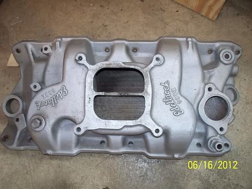

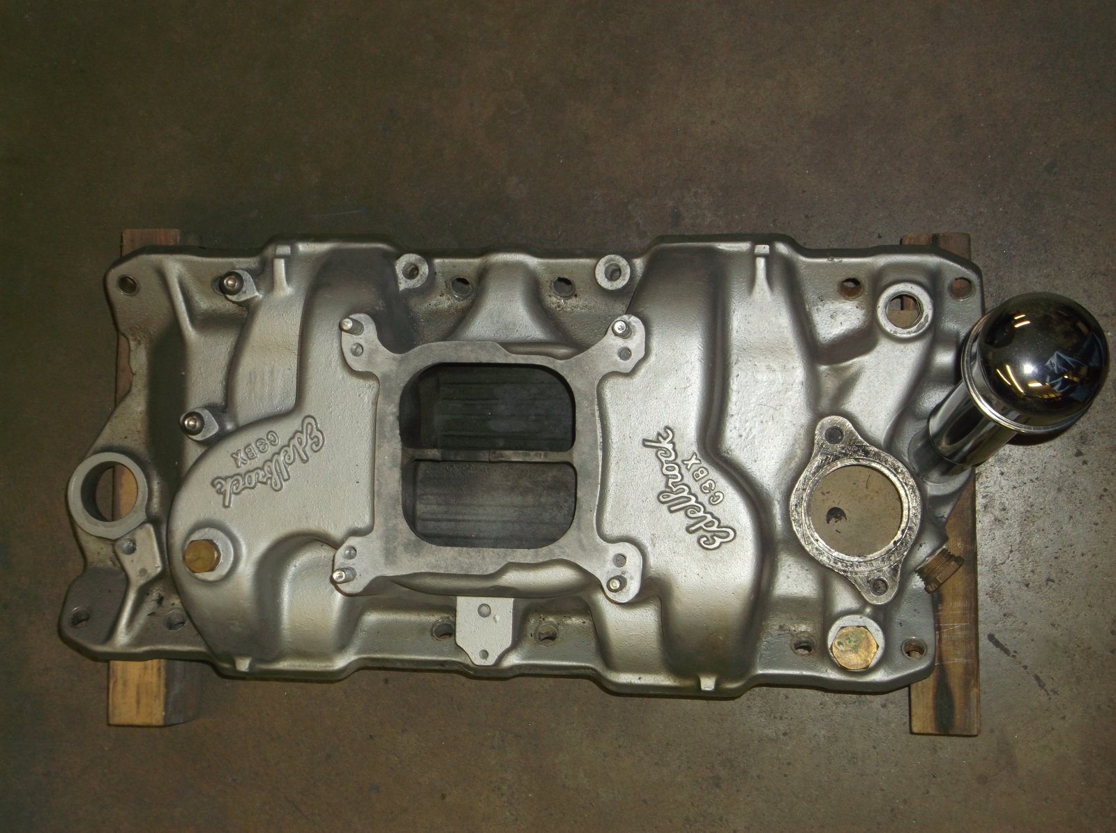

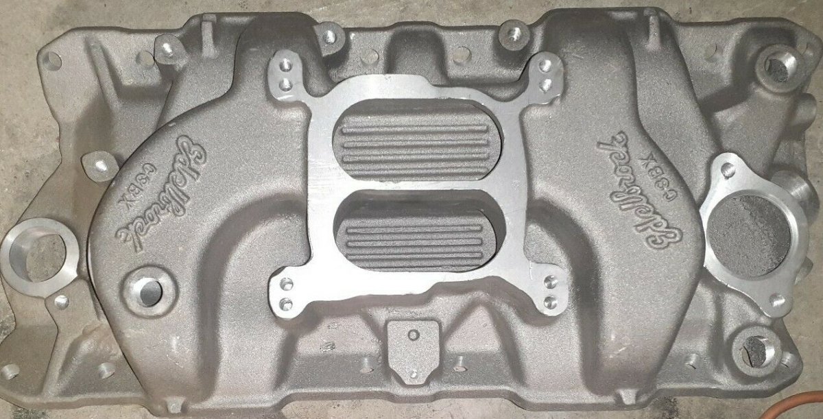

    Your Eddy "C3BX" has the runner on the driver's side and has the longer dog leg runner in front and back. This is more like the original C4B style. The only thing I can figure out is that some early C3B & for some reason some C3BX used the "OLD C4B" molds but have the C3B and C3BX name cast into them. This is one of those strange things that happened and I can't understand why Edelbrock used the "Older C4B" out dated mold for the "NEW C3B" and especially on the "Newer Improved C3BX" model that came out many years later then the C4B and a few years later then the C3B? I'm stumped...
    Pictures...
    Your C3BX #1
    The Original C4B #2
    A C3BX #3
    Can you see how your #1 C3BX looks just like the early C4B #2 ?
    See how they are different compared to the #3 C3BX that more resembles the GM Z/28 & LT1 intake manifolds ??
    The #2 C4B, & #1 C3BX intake manifolds have the "driver side" long dog leg runner in front of the Carb mounting pad and in back of the Carb mounting pad.
    Where as the #3 C3BX has the shorter type Runner's on the "p***enger side" front of the carb mounting pad and in the back of the carb mounting pad.
    This type #3 C3BX looks more like the GM Z/28 & LT1 intake manifolds and are much more efficient than the early type #2 C4B and the #1 C3BX intake manifolds.
    Bcuz the #3 C3BX Runner's are more centered and the Runner's are closer to the same length.
    Hope this helps people to see the "Biggest Difference" in the #1 & #2 compared to the #3 intake manifolds.

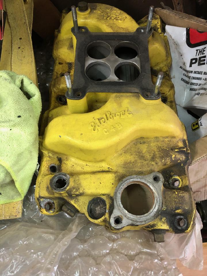

    Found this thread searching for some info.. I have a C4B with oil fill to the p***enger side. Traded a C3BX for this one, the other manifold had a crack in one of the small heater hose fittings, but the guy really wanted it and had the C4 to trade straight up. has no cracks, only mods I see is that there is some clearance made for a HEI distributor. Intersting to see the p***enger side oil fill.. most C4Bs have it to the driver side and not the 4 hole carb mount.

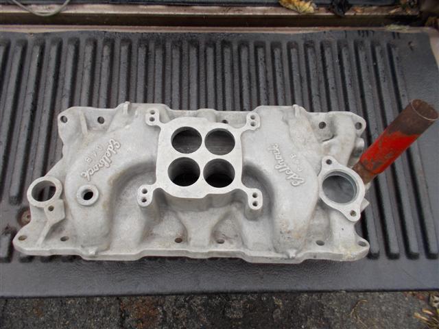

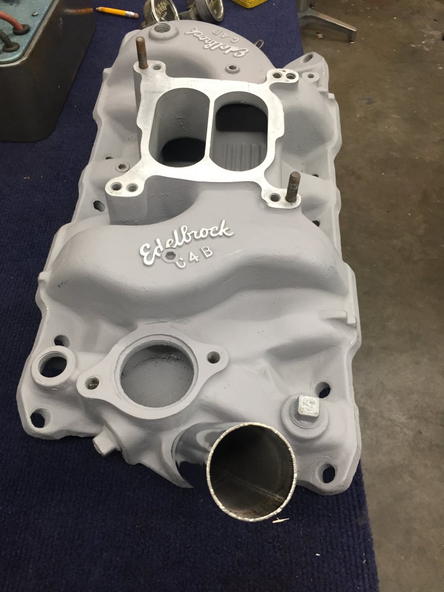

    The 4 hole C4B’s are the early ones. Here’s a later one

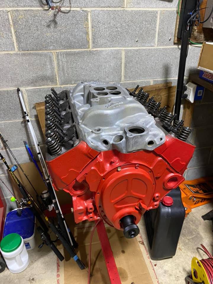

    for some reason I can't quote a previous post but the C4B I have is going on top of my 327 build. It will be going into a 56 Nomad. My goal for this build was to create a 60's vintage look in the engine bay. My dad had a 56 Nomad in the mid 60s in high school, couldn't afford the "new" engine back then. I have a 66 327/300, 2.02 462 heads. will be running ram horns, vintage valve covers. etc. The carburetor is brand new, but holley is holley.
    Bought the engine with a set of 9 fin valve covers and matching oil pan. had a C3BX on it but had a couple cracks on the heater hose threaded connections. hopefully can restore the valve covers or find a set of Cal custom 6 fin
    Will I be able to run the oil separator can under the intake with this intake? Plan to keep the original crankcase vent setup.. Either vented oil fill cap, or reverse it to draw air through the rear and PCV on sealed oil fill..
    1Nimrod likes this.
  17. Moriarity
    Joined: Apr 11, 2001
    Posts: 37,755
    Moriarity
    SUPER MODERATOR
    sure you can. back when these manifolds were new, all sbc's had em.......

    Did that first C4B intake manifold you showed have nitrous on it at one time? I see it has plugs in the top front and back runner's ?
    Thank you for your help...
    1Nimrod
  22. Moriarity
    Posts: 37,755
    Moriarity
    SUPER MODERATOR
    I don't think so. I think they may have been vacuum ports at one time

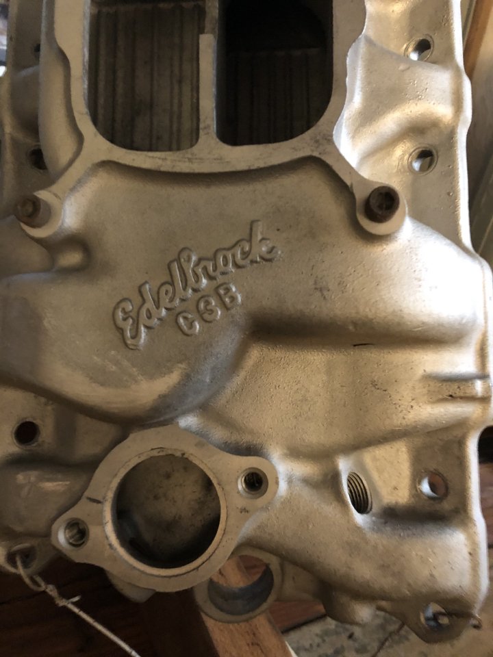

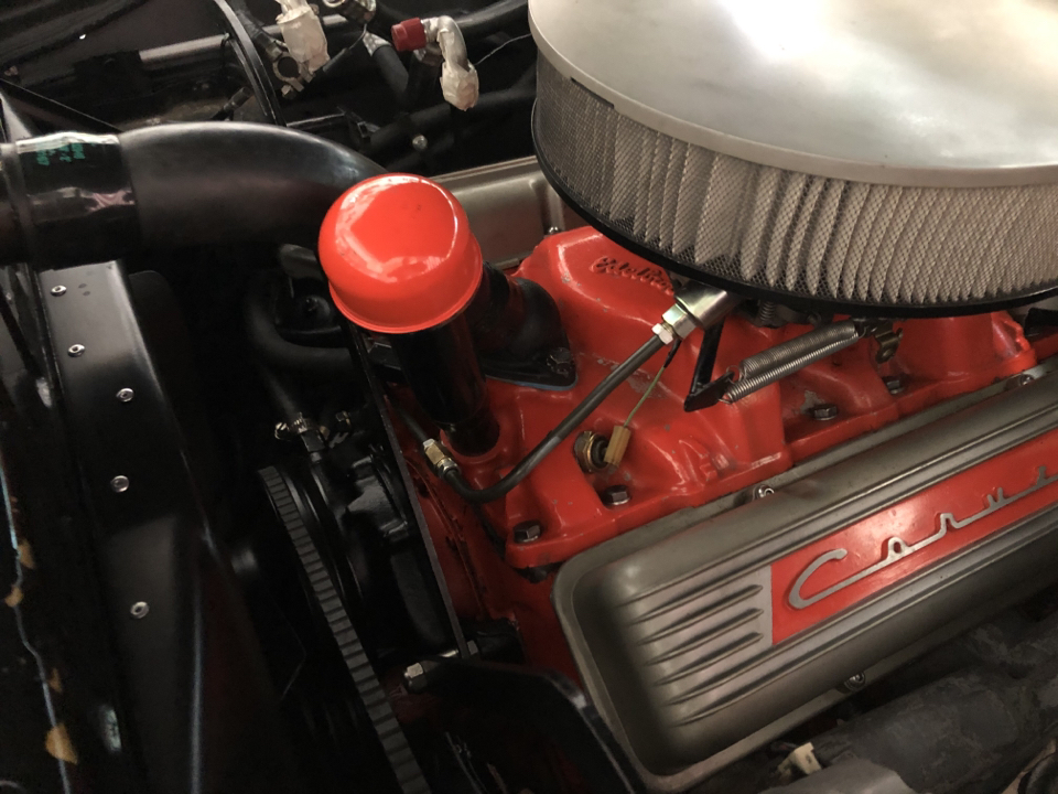

    Here is a picture of the "wiggle" I put in the oil fill tube on a C4B to clear a high mount alternator; I also had to change the one on my C3B and the alternator is on the other side; seems there is no winning.

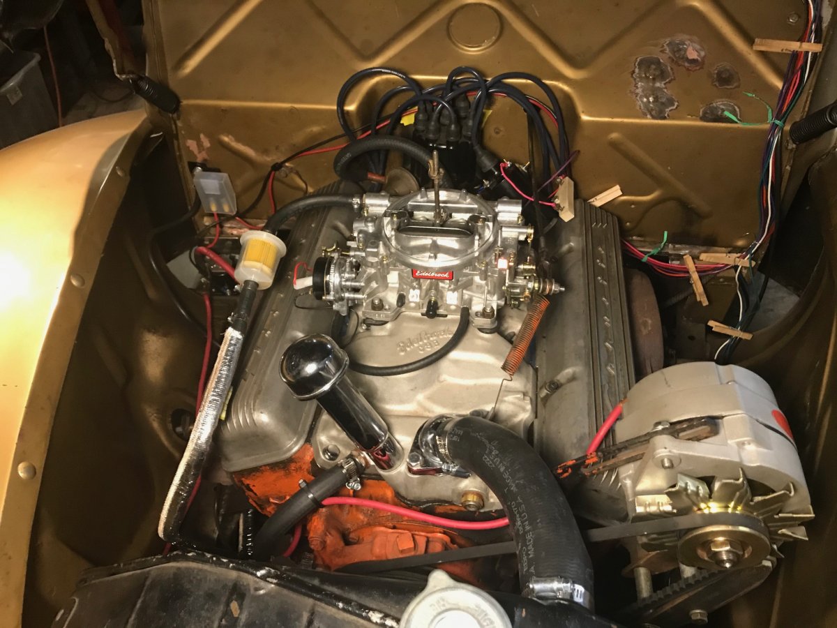

    This is the same manifold I have.
    And this is my oil fill tube.
