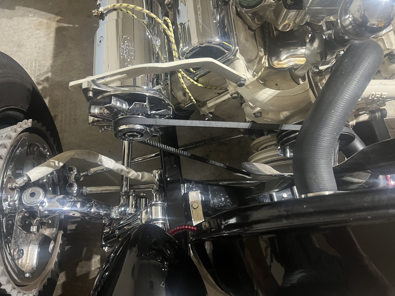

  1. The only thing that stands out to me is it appears the steering arm is below the scrub line, what happens if you have a front flat at speed? HRP

    If the box is ahead of the axle and the arm reversed it wont steer backwards. This is what I do on most builds where headers interfere. Moving the box ahead of the axle and reversing the pitman arm gives lots of clearance for the box and headers.

    There is no free lunch, now won’t you have to correct the Ackerman?

    Why would that effect Ackerman , tie rod & steering arms aren't changed ?

    How can the OP mount the steering box in front of the axle if his steering arms are behind the axle?

    You are correct, upon further review I see the tie rod is to the rear of the spindles.

    You asked about the geometry of the situation. It would be pretty easy to layout to scale to match what you have. The way I see it, as it turns right, the drag link will be pulling backwards at the same time the steering arm is wanting to go forward. Vice-versa for the other direction. The greater the angle, the greater this effect. As was mentioned; depending on the actual geometry, a full right hand turn could result in the steering arm and drag link being in line, trying to go over center. 53801208-EB43-4158-AAB2-2CE2CE823202.jpeg

    ^^^^ And there it is, right there. In a left turn, the rate of motion at the steering arm end changes and the leverage changes at the steering arm making the steering feel strange. The same thing happens on a right turn but the leverage at the steering arm kind of normalizes while the rate of motion at the steering arm changes. Again making the steering feel strange. Worst case scenario, the drag link gets to a position where it could over-center.
    A few cars came through my shop with the drag link not parallel with the tie rod but none were that far off. An inch, maybe two out of line is tolerable but that far out I would have recommended a change.

  13. As mentioned, it is possible to get to an over center between the arm and rod. That I suppose can be eliminated by a properly positioned turn stop on each side. Not defending what is there, just saying.

    No. Ackerman has nothing to do with pitman arm direction, or the drag link. My tiee rod is still in the rear normal location, and it's what affects Ackerman angles.

    Just like anyone does. You move the steering box and drag link to the front side, and leave the tie rod at the rear. It only requires a second arm on the off side spindle to attach the drag link to. Done this many times, and I like it much better than behind the axle.

    What confused me was when I looked at the photo you posted I focused on the flat steel, bolt on arm thinking you had put the tie rod in front. Had I looked to the left of the tarp in the photo I would have seen the tie rod. But regardless, is that a viable solution for a transverse sprung ‘32 frame like the OP is building?

    I see no reason the transverse spring would change whether the wheels could be moved from the front side of the axle, and not the rear? I did this for a friend's '35 Plymouth that was a chrome tube axle, (once transverse spring) that I converted to coilovers.
    The drag link and steering box up front still gets things away from the engine and the headers, and will work. The only issue would be if his car was open fenders and he didn't like seeing the steering box out front.

    In the end, it most likely would have been fine, but I would have hated to change it after the car was done. I have some new U-bends, I'm gonna move the box and build a new header this weekend. Not a huge deal.

  27. If you draw a line from the centerline of the kingpin on the right side, through the tie rod end, another line through both tie rod ends, and then another line through both the sector shaft end of the pitman arm and the tie rod end of the pitman arm... you'll see your working angles. Basically the spindle is a first class lever that is actuated by a rod. The most efficient action on a first class lever by the rod is 90 degrees. As the lever moves about the fulcrum (the king pin), this working angle gets greater or lesser. As this angle approaches 180 degrees, it becomes less efficient... i.e. requires more effort and produces less movement.
    If it approaches 180 degrees it may experience an "over center" situation... by actually going over center, or not actually going over center. (I've seen this on throttle linkages before. Yikes!)
    So there's that.

    Fordors
