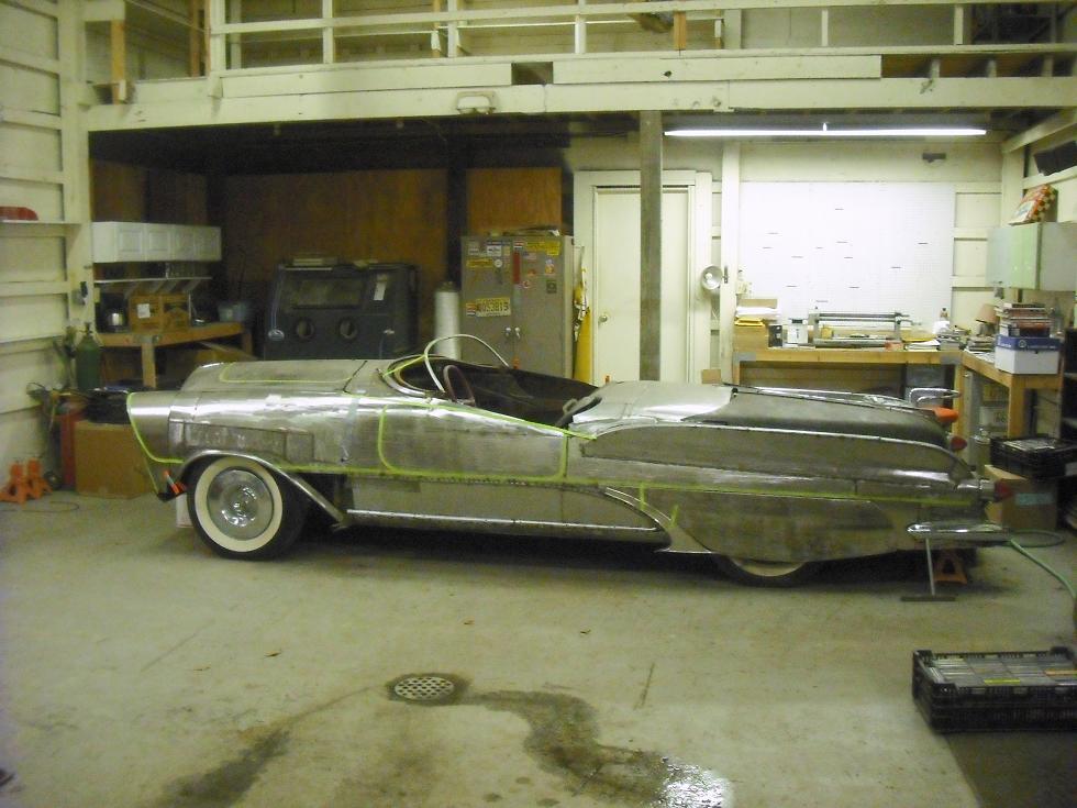

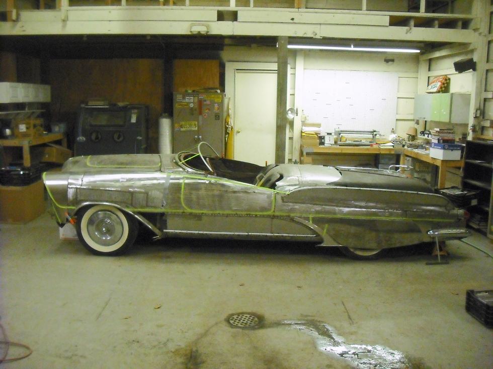

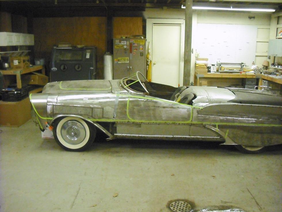

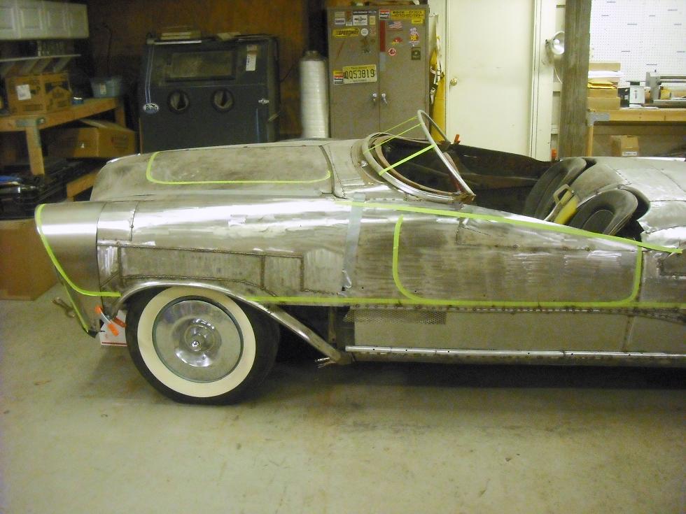

    been doing more pondering than welding these days,,,,,,i was mostly happy with the profile of the car, but something just didn't seem quite right,,,the first problem involved the headlight area, , at first i was thinking maybe they stuck out too far,,,then one morning i realized that the angle was the problem,,it was too straight,,i fabbed up a swept back angled "hood" for it, with an angle that complimented the other angles on the car (windshield, fin, quarter, rear of the cove),,,i feel like it flows much smoother now and doesn't work against the rest of the lines of the car,,,,,the second problem involved the curve at the top of the doors,,,,it didn't transition smoothly enough,,,,after a lot of trial and error with the masking tape.....the car now seems to flow with no "hiccups" to break up the lines,,,i will trim off the piece of metal showing above the tape line, make some filler pieces to tie the cowl in, and it should be good to go,,

    Maybe it's just the angle of the photo but is the seating position too low in relation to the cowl. In other words have you sat in it and can you see the road ahead?
