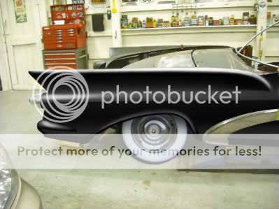

    today's progress,,,,finished sectioning the car,,,(the drivers door and drivers quarter needed to be done,,,),,,,played with the length of the fin,,i will extend them as seen in the pic,,,,,,,TIME TO WELD!!!

    Wow......did say wow?.....wow!!!! Awesome.

    Damn Jim!! I absolutely love where this is going...The fin tips and headlight pods are superb...I'd love to see the headlight pods welded in and the headlights moved inside and below them, almost giving it a quad light look, with some Lucas flamethrowers incorporated into the grille ends...Damn.......
