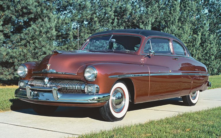

  4. Moriarity
    Joined: Apr 11, 2001
    Posts: 37,666
    Moriarity
    SUPER MODERATOR
    stock mercury
    nosed mercury

  6. Hey Mark,,,you know I’m not too good on this stuff yet.
    What year is that Merc ? The stock one,,,,and not trying to not pick,,,is that front bumper hung correctly ?
  7. Moriarity
    Posts: 37,666
    Moriarity
    SUPER MODERATOR
    the stocker is a 50 monterey. the custom could be a 49, 50 or 51....
