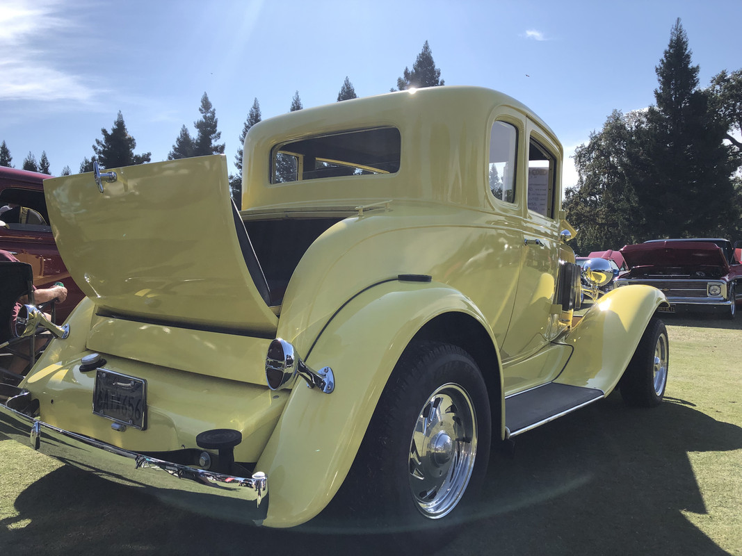

  10. Shitbox
    Joined: Oct 23, 2021
    Posts: 108
    Shitbox
    from Nor Cal
    32 today(yeah sorry about the fact it’s a street rod) at a local show.
    feel free to blur the billet or I’ll take it down if needed.
  11. nunattax
    Joined: Jan 10, 2011
    Posts: 3,390
    nunattax
    wheels are awful.be a very nice car with some steel wheels on it
    TFoch, Shitbox and Six Ball like this.
