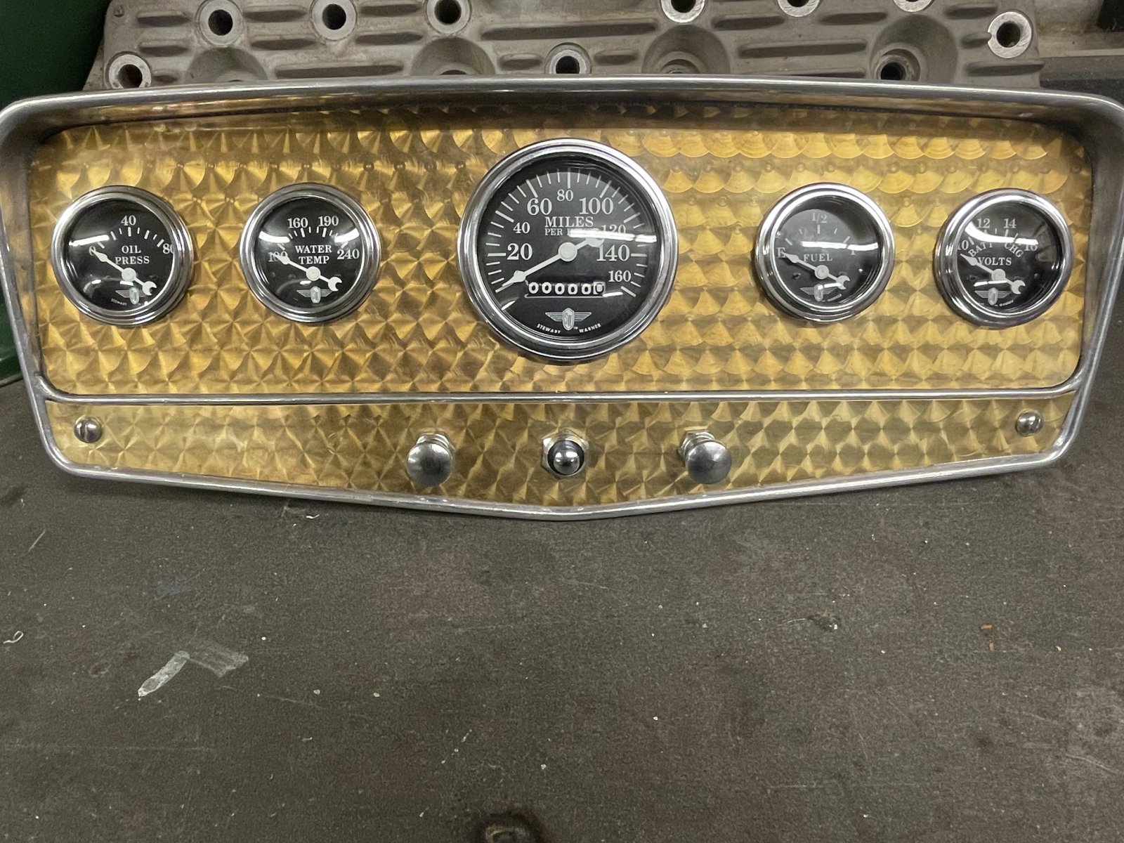

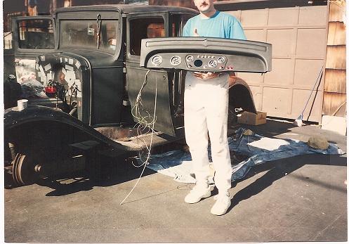

  1. Are you planning on using the center hole for your push start? First, I had a barrel key to turn on the ignition and used two red lenses to show that my fuel pump and ignition was ready to fire, then hit the black ****on to fire the engine as my photo shows. Seeing your instrument panel's great looks, I just ordered the silver engine turned sheet for my gauges - thanks to you sir!

    Yes sir I got the the switch in today. Wait so did you have an electric fuel pump? I thought about doing something similar. Original when I got my dash the guy had drilled 5 holes in it so I decided to get an insert. What are all the gauges you ended up running ? I looked at one of your photos from your thread and was trying to eee your dash lol
    Tim, Six Ball and 31chevymike like this.
  3. Yes, I was running a Carter fuel pump that I replaced with the Carter fp that was originally used in my '31 (from the late sixties). As far as the gauges, the Stewart Warner mechanical (not the Wings) are the originals in the coupe when built as a hot rod in the late sixties. The six gauge set were the Speedometer, Tachometer, fuel, amp, oil pressure and the water temp was the only gauge that I bought new, needing Stewart Warner to match exactly what I had originally. If and when I decide to go new, they would definately be the 6 gauge black set from Mooneyes.

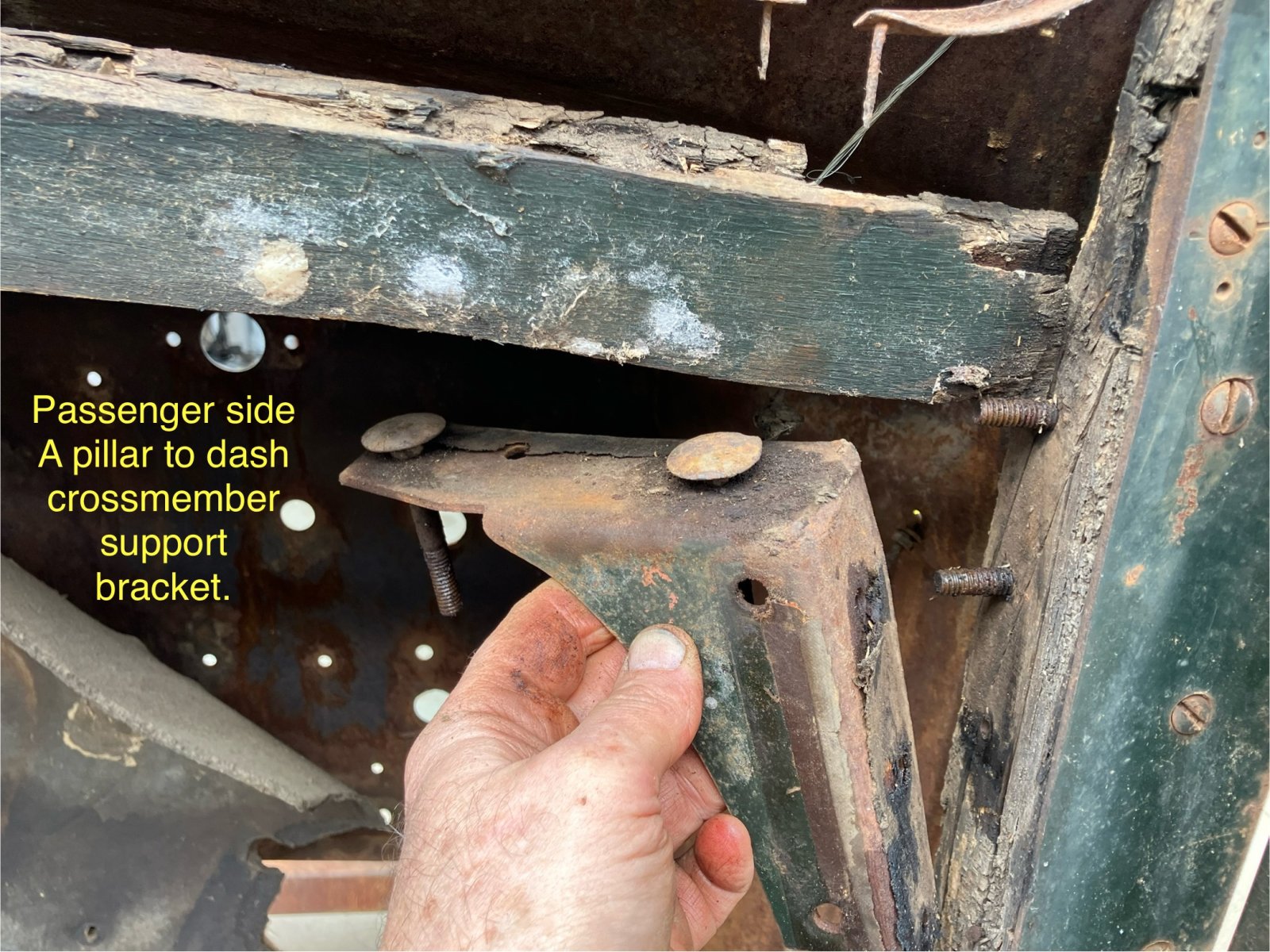

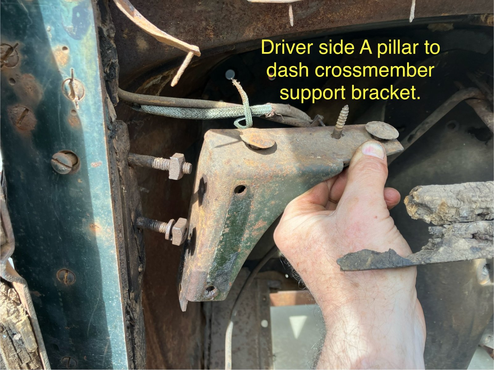

    Today is day #1 as I begin building a 1934 Chevy Master 5 window coupe.
    It was delivered to me 12/30/23. All I did up to today was buy wheels and tires so I could move it easier. I also bought door hinge pins so I could at least hang the doors.
    I had to finish another big project before starting on the 34.
    Included with my 34 was a wood kit. I wasn’t sure how complete it was, but there sure was a lot of wood!
    Today I drug out the wood and started figuring out what went where. A real puzzle. I got a lot of pieces figured out but I still have pieces that are a mystery.
    The pics show I have new framing for the interior of each door as well as DS and PS body A and B pillars and both upper door frames too. I also have the body framing for around the trunk. IMG_4467.jpeg IMG_4607.jpeg IMG_4366_Original.jpeg IMG_4605.jpeg IMG_4612.jpeg IMG_4337_Original.jpeg
    TFoch, 31 B'ville, Six Ball and 2 others like this.

    You are very fortunate to have all of that wood. It is also a good thing that by this time all of the bodies were made by Fisher. With some research you can find manuals showing all the parts and instructions on ***embly & repair. I wish this was true for my '26 roadster. We are having to create the manual. You can start here. If you decide not to use the wood there is someone out there who will. It is valuable! Every piece!

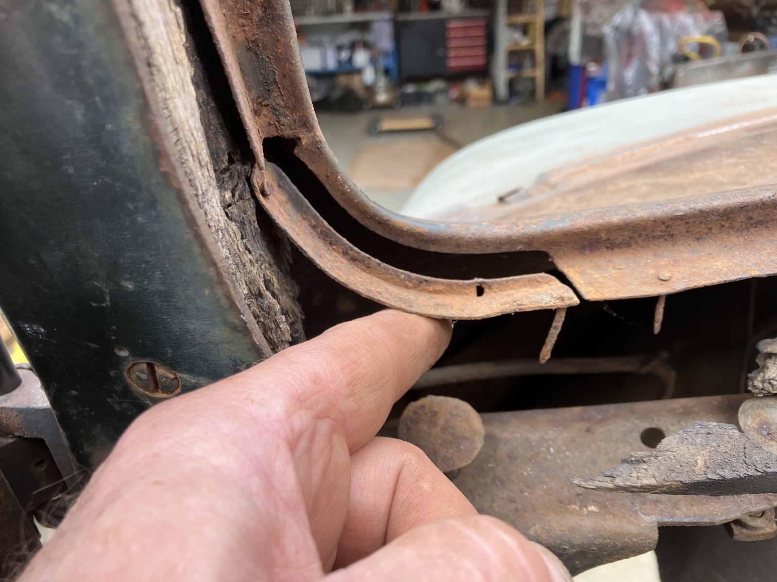

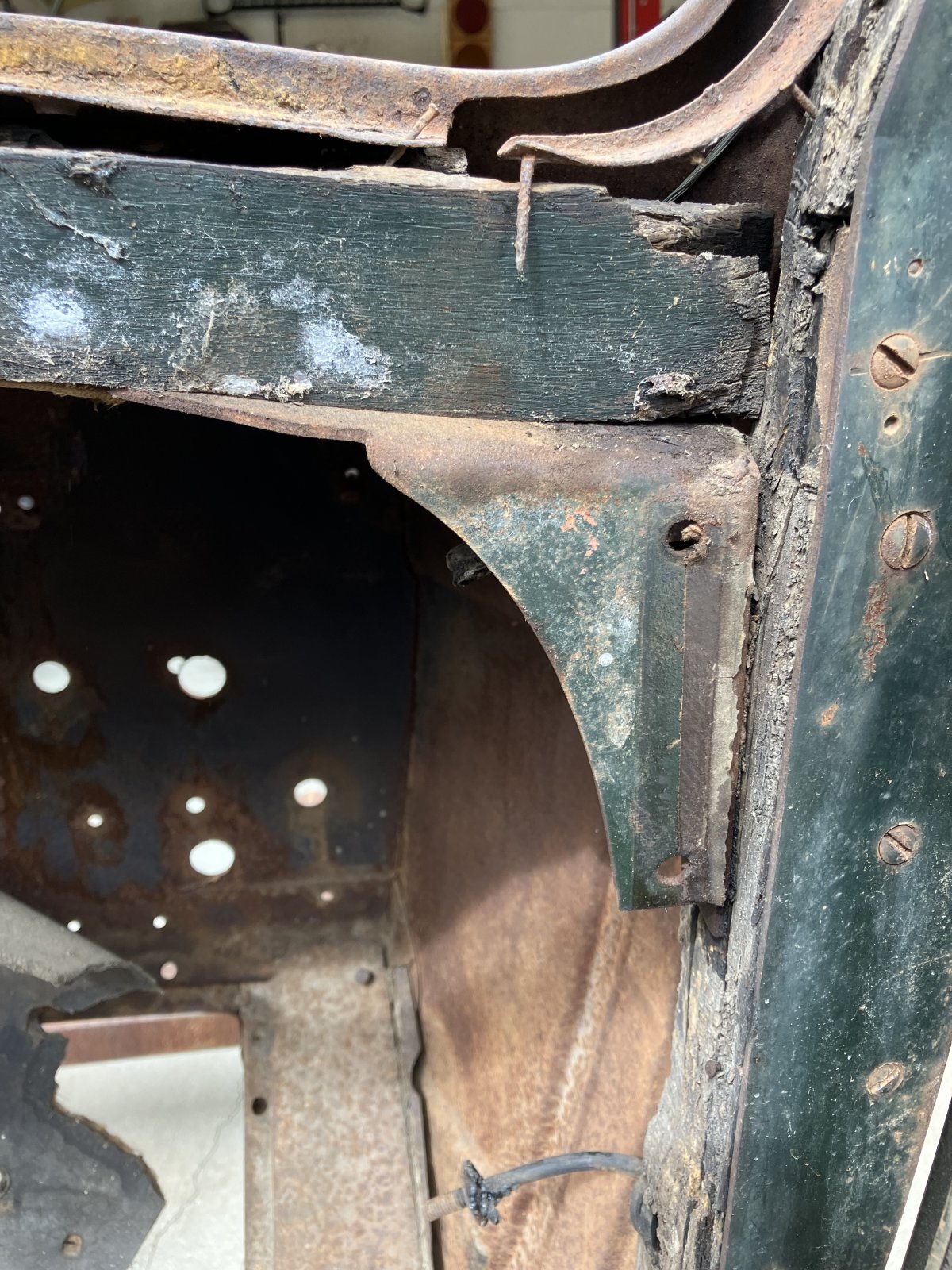

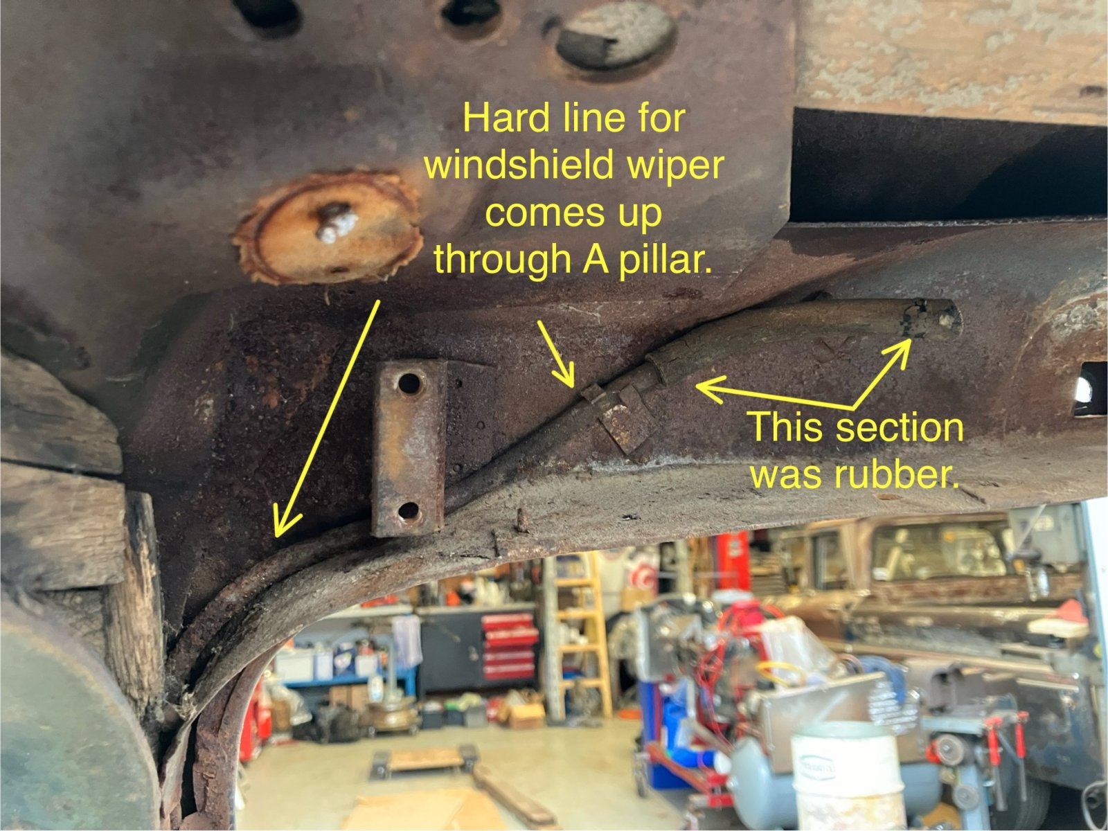

    Got plenty done today. Removed several pieces of structural wood above and below the dash including bracing. IMG_4595.jpeg IMG_4610.jpeg IMG_4632.jpeg IMG_4655.jpeg IMG_4645.jpeg IMG_4639.jpeg

    I like it! It looks like to has a lot of metal brackets where the wood pieces join. That will add some strength and give good alignment clues by using the screw holes for reference. We have found that the screw holes on the '26s we are working on have the screws in the exact same places and not just in a good enough place to hold them together. They must have had a jigging system.
