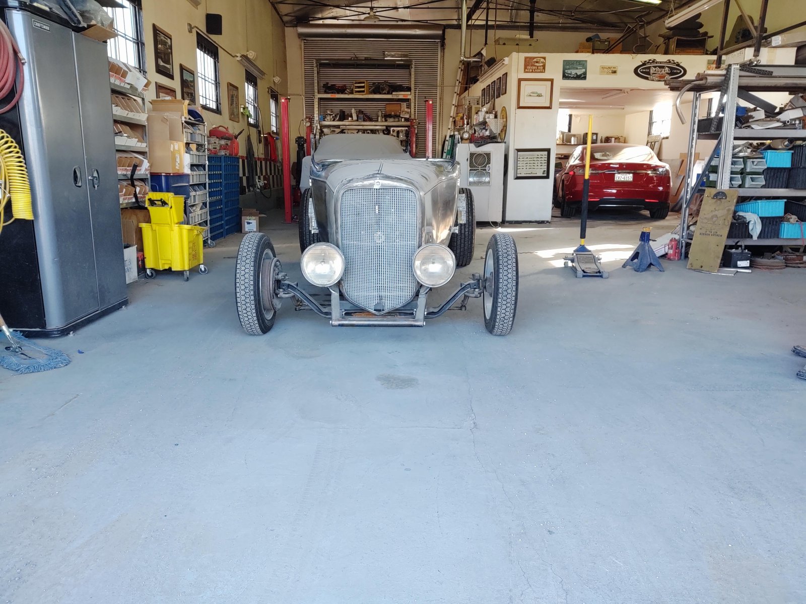

    Six Ball is right , it takes some work to get the Chevy's low in front. Mine was dropped by Sid and is 6" from spring pad to center of spindle, plus a couple of other tricks. Still the scrub clearance is safe... Roadster front 1 (2).jpg

    Normally that would be too much for me but it looks good there! It is hard because these axles already have about a 3" drop. Sid does a great job.

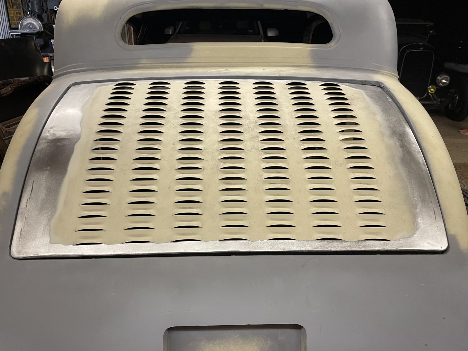

    Seen the post on a fb page, looks good. Buddy and I started working on my deck lid

    That thing has such nice lines! It is funny how our brains are programed to use Ford as the end all baseline for how a rod should look.

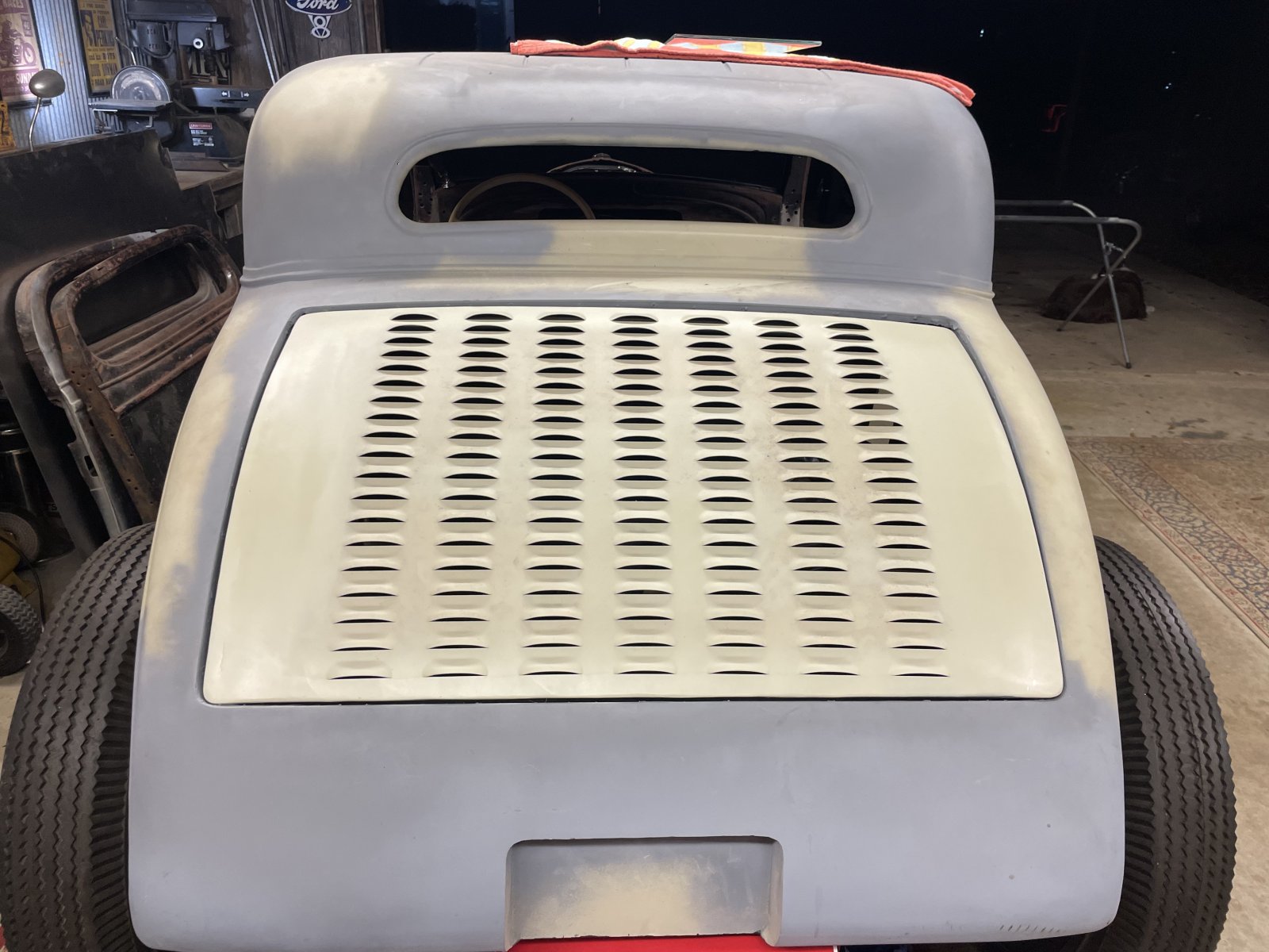

    Got the deck lid about done, have to do some planishing, running these 37’ Chevy hinges on the deck lid. Doors next

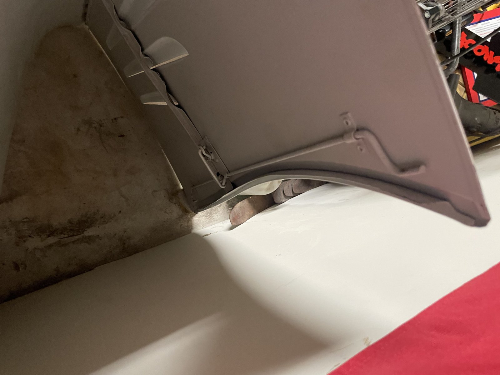

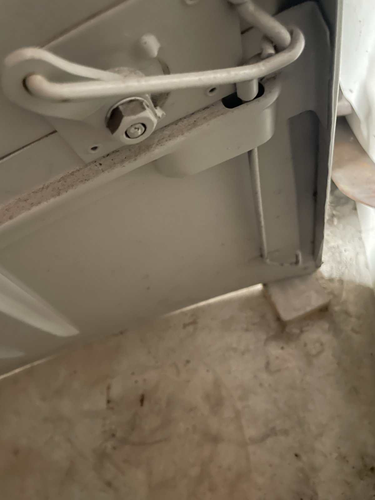

    as said above for the hood, there should be a rod connects to the handle on the hood that releases it. Let me see if I can find a pic of my hood

    Not sure if it helps lol

    Thanks for the pics. I think mine are intact. I’ll inspect them this weekend.

  26. I'm going to reverse my rumble lid and convert to a trunk lid by also using those type of hinges at the top. Was your decklid a rumble setup like mine? Also, when you have a chance, would you take a much-needed photo of the decklid latch on the bottom that locks it to the body? I've never seen one, also figuring that it may be very tough to find one (anyone know if this latch is reproduced?), but my search continues - thanks for any help! By the way, GREAT job on your trunk lid @snoop74!

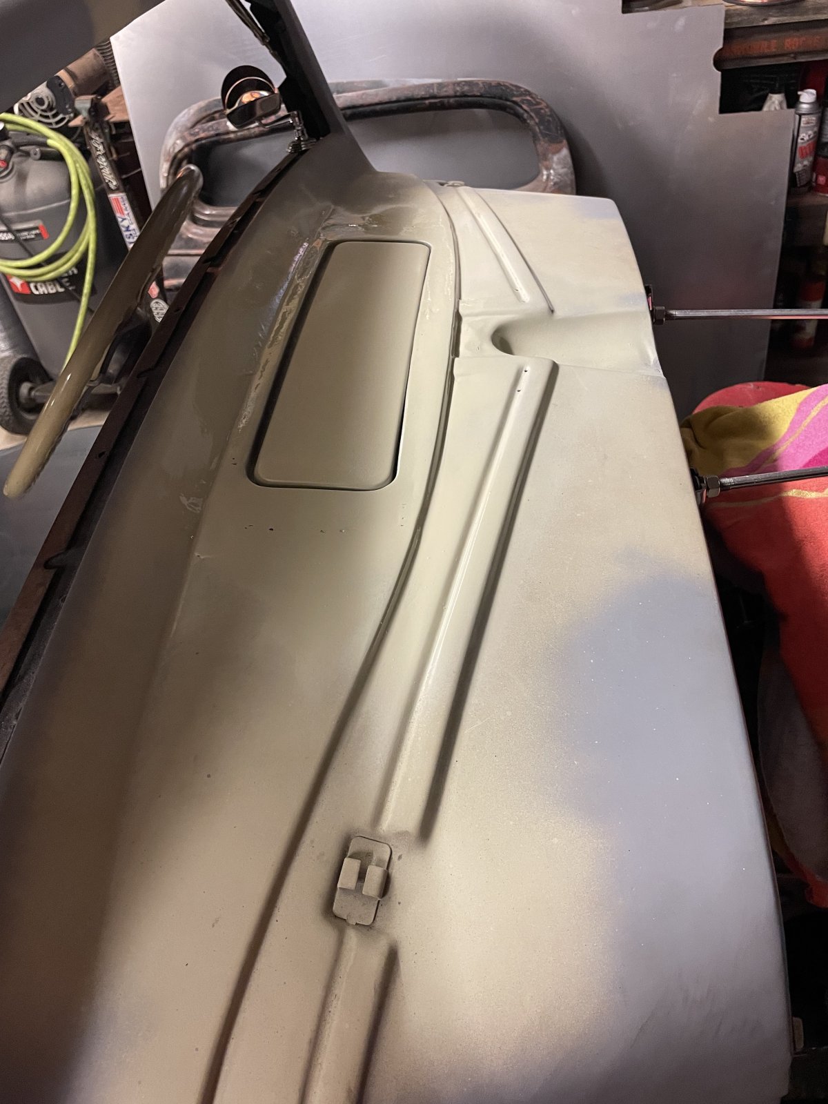

    honestly I don’t think mine was a rumble seat. Originally when I got the car it looked to be set up as a regular truck judging by the hinges I had in the box. I also don’t have a lock, not quite sure how I’m going to do my truck at this point. Maybe one of those VW “pop style” I don’t think I have enough space at the bottom for an actual handle. Thanks! Planished it out and got some epoxy on it

    That looks nice!
    I know you will both solve your trunk latch issues. There are a lot of latches out there new & old. My '26 has a trunk latch mounted in the lid that closes on a plate in the bottom of the trunk floor. It could be replaced with one of the Bear Claw door latches.
