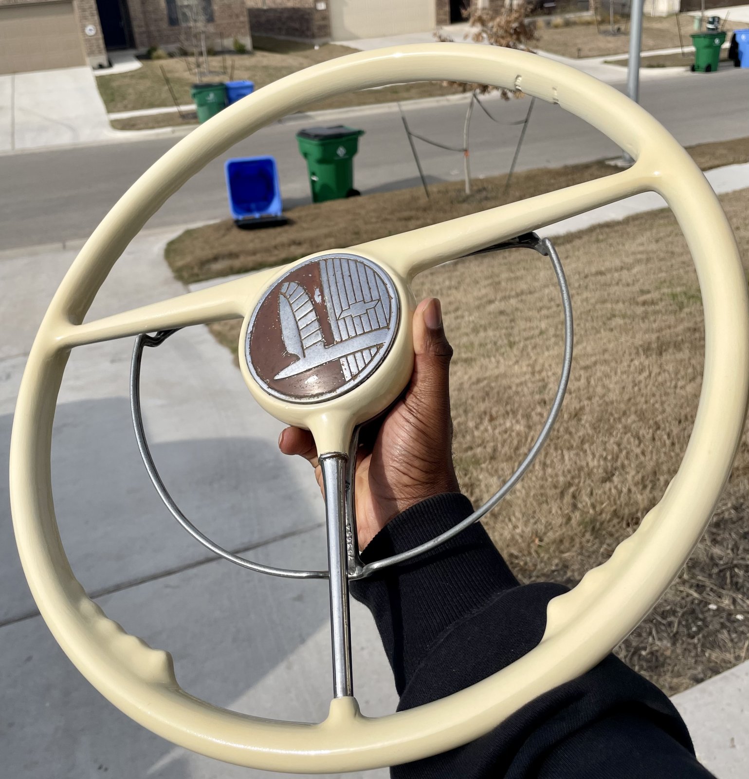

  6. That's what I'm talking about! That steering wheel will look awesome in your hot rod! Speaking of my own, my buddy Dale and his son David came over last weekend and we finished the brakes completely and very proud of them. When I straighten up my garage, I'll take some great photos to show here and on my thread!
    Shitbox likes this.

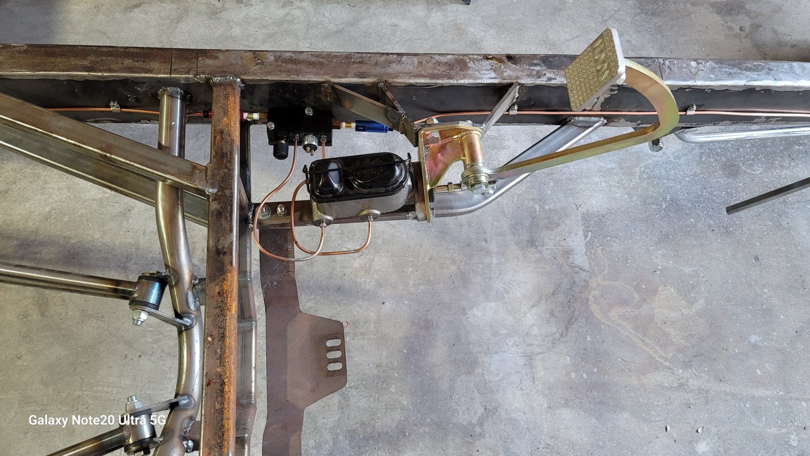

  9. Unlike your hot rod, I needed to add front disc brakes and residual valves to my brake system to help stop with that massive hemi... I had all Chevy brakes in the beginning, mostly '53 Chevy drum brakes in the front and rear '63 Chevy drum brakes in the rear as well - along with a scary single piston '53 Chevy mc. In this day and age, you do whatever is possible for safety!

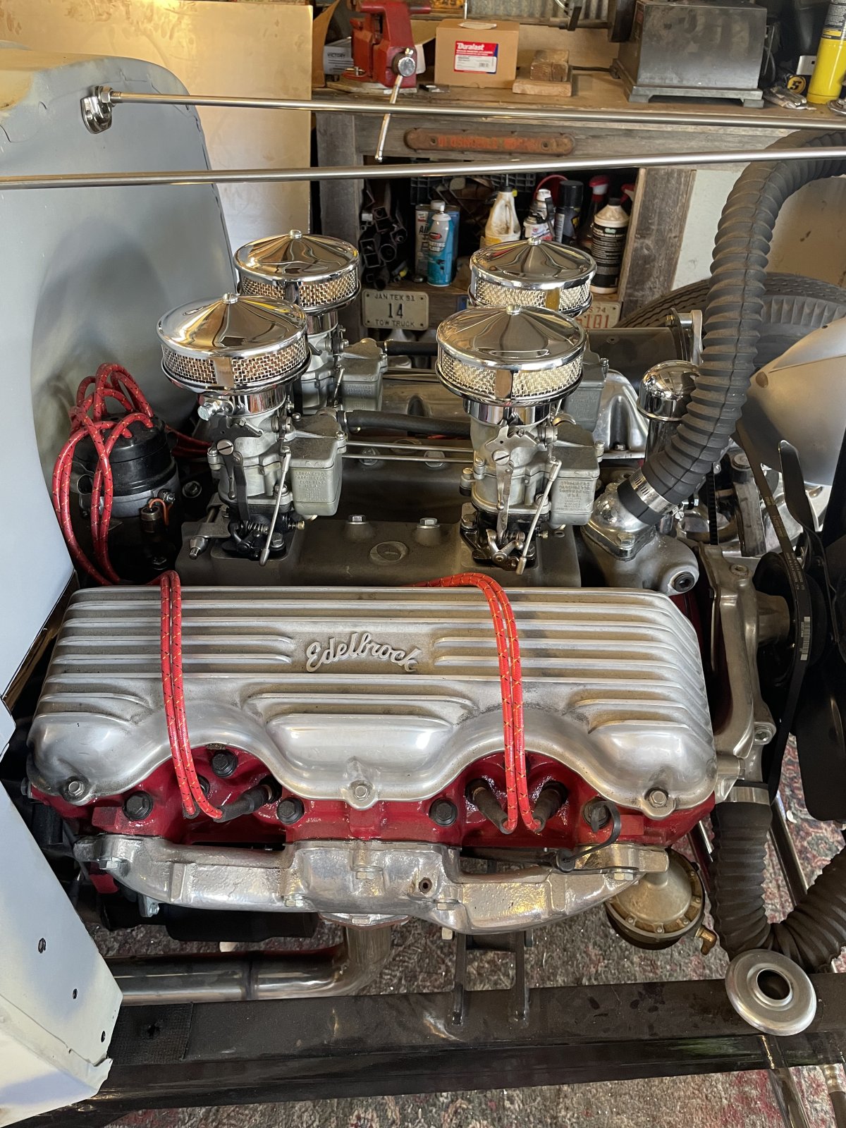

    What can be said more about running a big block 348/409 Chevy in a vintage Chevy hot rod? AWESOME!!!! Where'd you find those air cleaners? The parts you're purchasing and installing on your '35 continue to amaze me and others for sure!

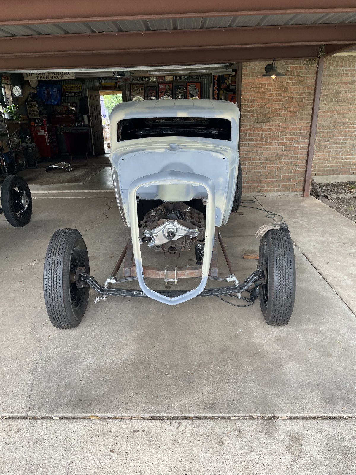

  10. Six Ball
    Joined: Oct 8, 2007
    Posts: 6,755
    Six Ball
    from Nevada
    That looks great! It is right where it should be.

    They’re grace & co, but hear drive remakes them now I want to say. I had those scoops on but wanted to set it apart a bit.

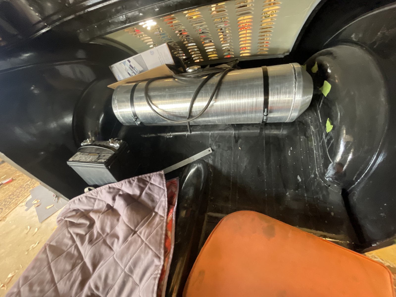

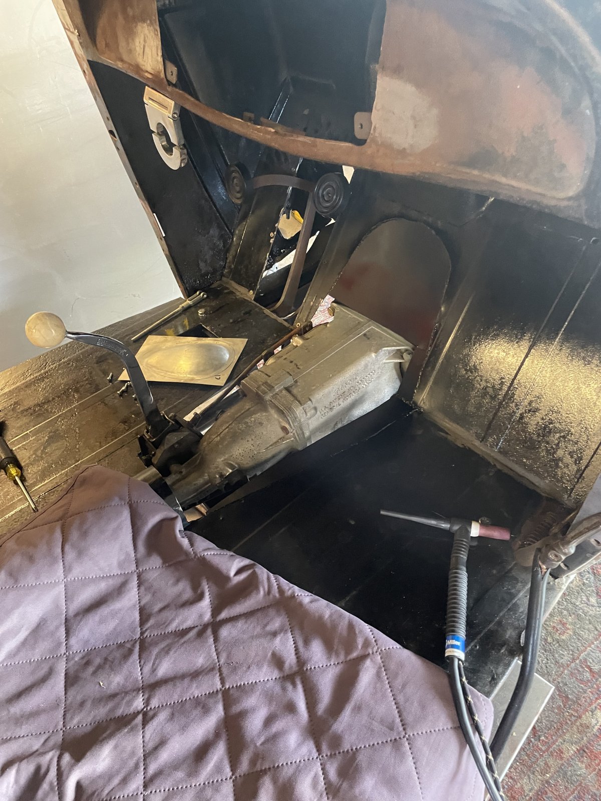

  12. snoop74
    Joined: May 29, 2022
    Posts: 400
    snoop74

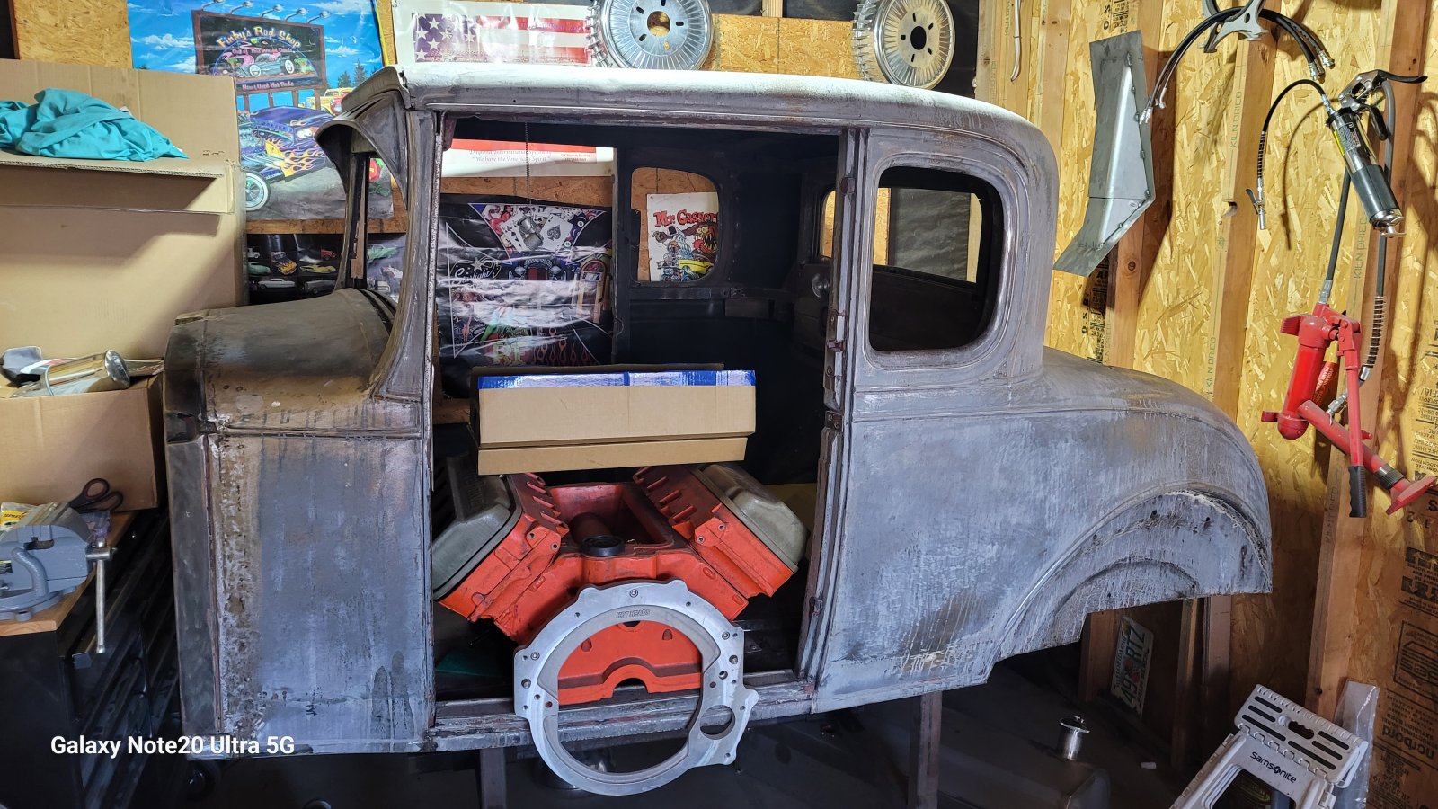

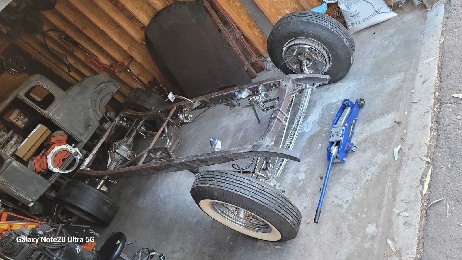

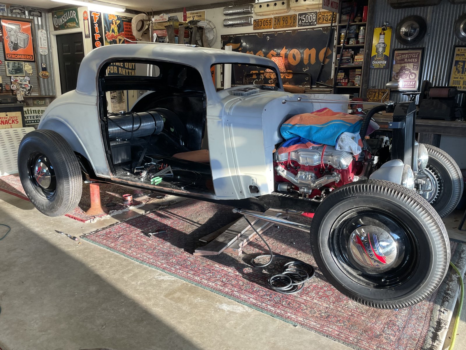

    Got some of the trans tunnel cobbled together(well the first part) and the panel for my pedals done and painted. Tank mounted as well as ground/hot cables ran. Made a battery box as well.
    floor will eventually have carpet so didn’t care too much how it looks. I should be getting my seat back from upholstery this weekend.
    Six Ball, GuyW, 41 coupe and 4 others like this.

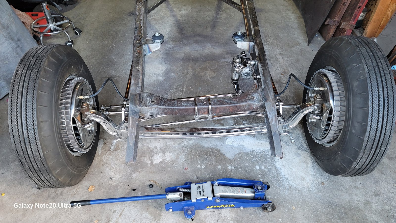

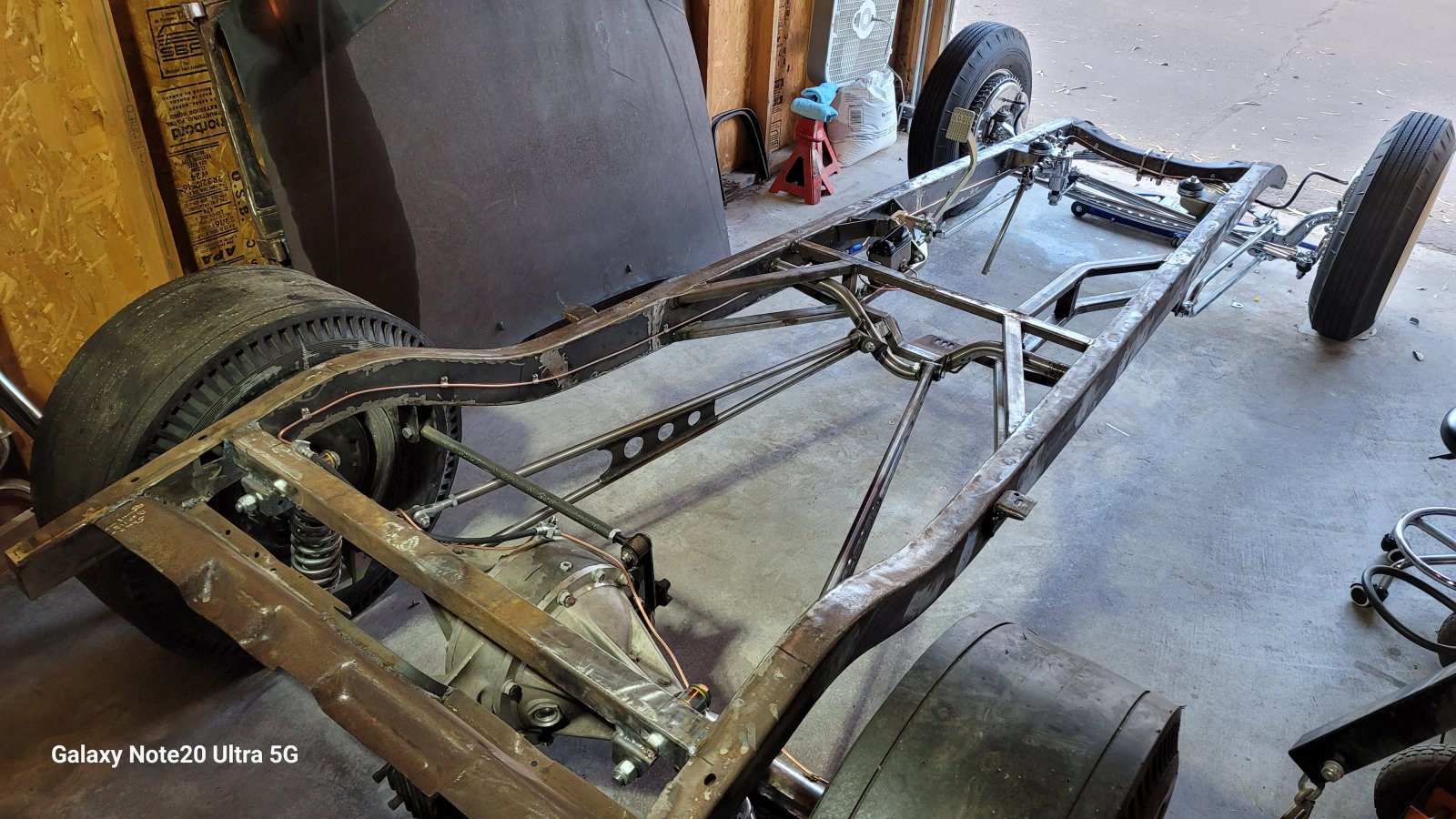

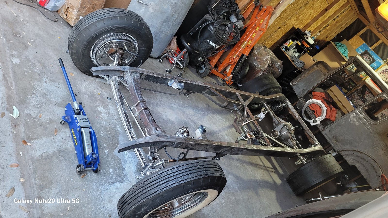

  14. Some photos of the brake system that was completed just recently...
    Passenger view of Complete brake assembly.jpg Rear view of detail of new brake lines  with x-member.jpg Winter's Quick Change view of new brake lines.jpg Body off with mock up hemi removed to finish new brake lines.jpg Detail view of MC with new brake lines, proportioning valve, residual valves, etc..jpg Front end view with complete disc brake system from So-Cal, new brake lines and front hoses.jpg Full frame shot with body off, showing detail of frame strengthening.jpg
    Six Ball, GuyW, snoop74 and 2 others like this.
  15. snoop74
    Posts: 400
    snoop74
    Muncie 4 (m21)
    31chevymike and Six Ball like this.
  16. snoop74
    Posts: 400
    snoop74
    Man that thing looks great, do you plan on painting the frame or powder coating? Are those rear ladder bars from rjays? I think I’m running the same one. I always liked how hairpins looked and wish I went with though.
    Whats the drop on that front axle ?

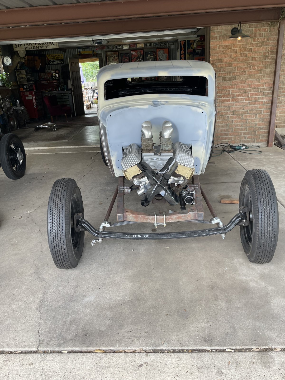

    31, Rethink you drive system and mount the Hemi sideways with a big chain! :rolleyes: The breaks look grid. Usually I don't like things that look like other things or that have to be hidden but you pulled off the front brake thing. I am finding that I am having to make concessions to get the '26 like I want it.

  20. I'm leaving the body and frame bare steel for the time being, hoping I can use some polisher (Eastwood from what I heard from Dale's son) to give the metal that smooth, even "brushed look" that I've envied all my life... The rear ladder bars are from Millworks Hot Rod Supply in New Hampshire and are really bitchin'! The Speedway Motors '32 Ford front axle has a 4" drop and MUCH MORE BITCHIN'! Remind me what front axle you went with on your '35.
    I'm glad that you feel approved about pulling off the front brake thing - thank you sir! Keep at it @Six Ball!

    I'm running a ford axle 33-36 axle. It's dropped axle I got at the round up last year.

    Maybe so but I really like the look of the pins. Ended up chroming them along with the backing plates.
    had to represent the chevys! Our paths will cross eventually. I plan on driving this thing every where.
