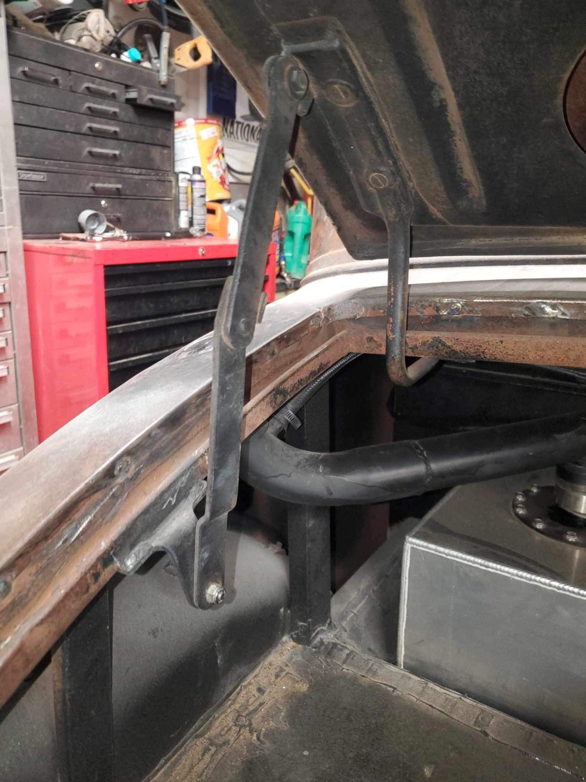

    The owner of a 1934 Chevy Master coupe on another forum shared this picture with me last evening. Now I understand everything. I am missing the piece of the hinge that bolts to the deck lid, and then wraps under to bolt to the body. It appears the elbow section of the hinge is intended to go slightly past 180°, and then interfere with the flange so that it acts as a stop to keep the deck lid open. IMG_4928.jpeg
  7. I will be hunting for this part that will help turning my rumble lid to a trunk lid as shown. Appreciate this photo bigtime!
