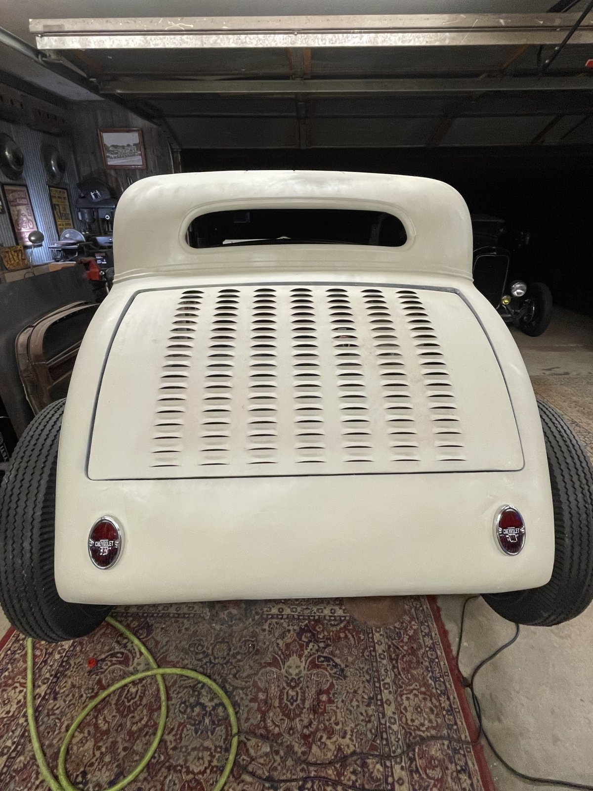

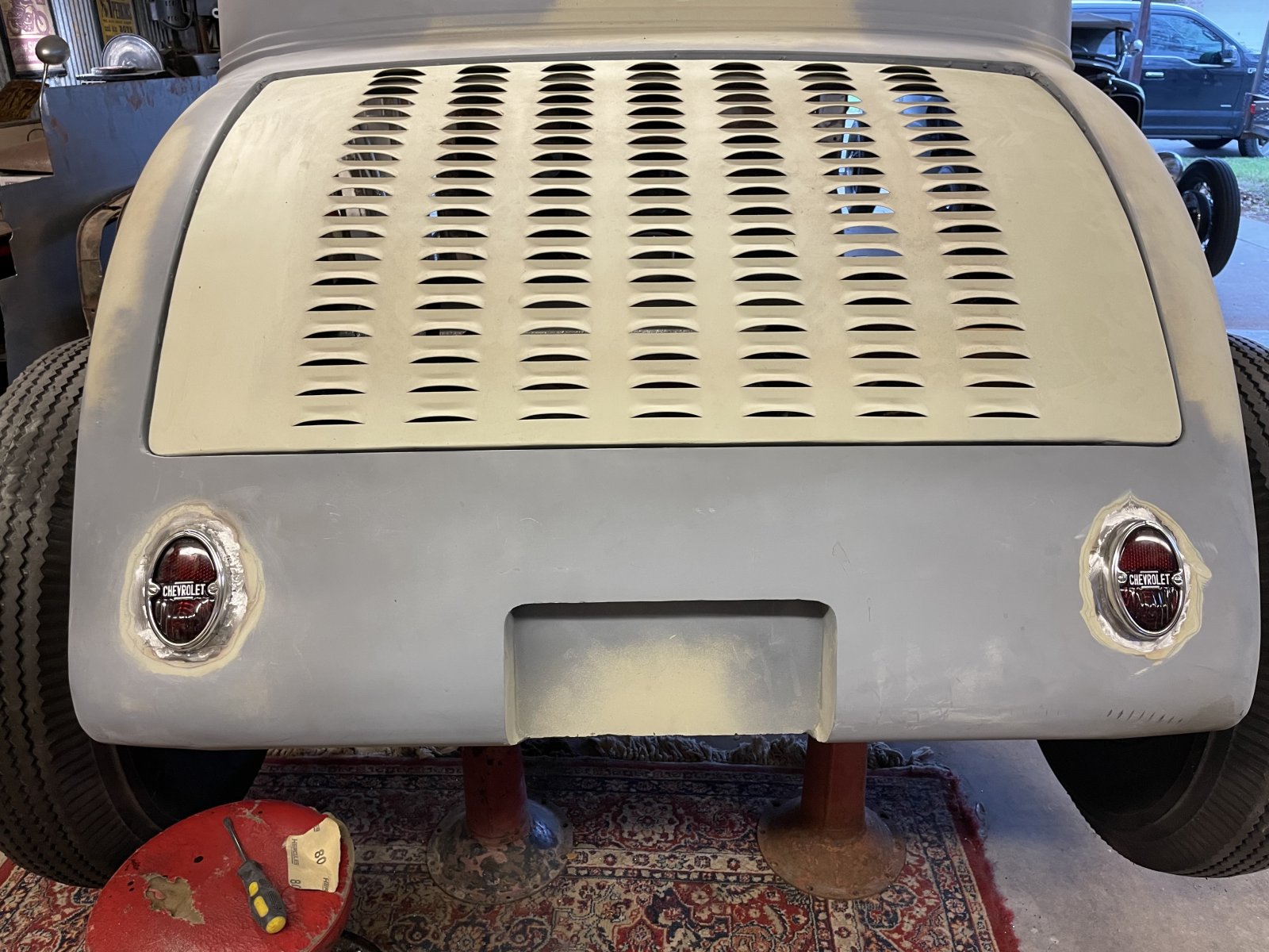

  2. 9 out of 10 hotrodders use those taillights on its own stand - mounting these taillights where they are is really neat! The Bowtie emblem is the crowning touch to these taillights! Wondering how you plan on lifting your trunk lid in the very near future?

  3. snoop74
    Joined: May 29, 2022
    Posts: 400
    snoop74
    Very true, but you’ve seen this car and knew we couldn’t do anything like anyone else! It’ll have hinges I just hadn’t got to those or the doors yet. I’d you’re referring to a handle of some shit I hadn’t really gotten that far. I have some ideas but I want to think on it a bit more

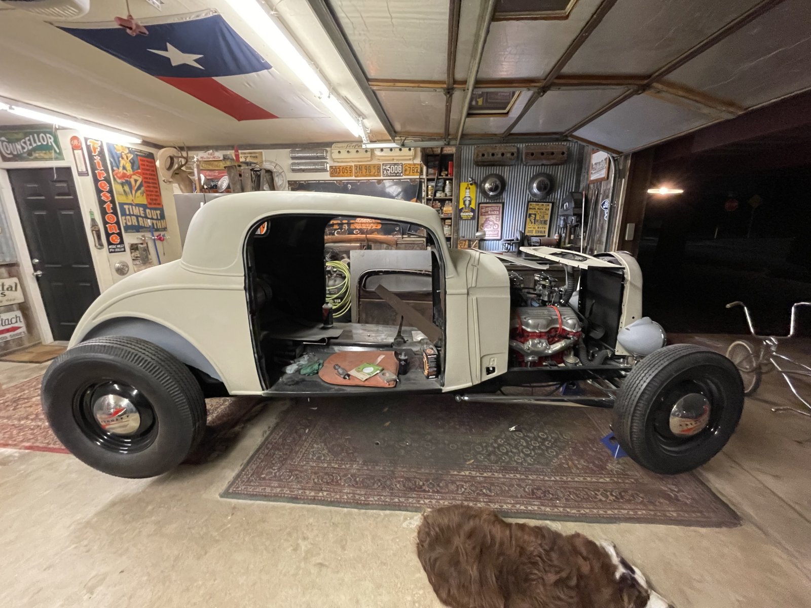

    Little by little . . .
    1934 Chevy Master 5W coupe IMG_5029.jpeg IMG_5035.jpeg IMG_5038.jpeg IMG_5034.jpeg IMG_5036.jpeg IMG_4969.jpeg IMG_5008.jpeg
    cactus1, TFoch, Countn'Carbs and 7 others like this.

    Got a little more done today. Wasn’t feelin the license plate bucket. Filled it in. fixed some dings in the grille shell and fixed the insert and got a lot of stuff in epoxy IMG_8554.jpeg IMG_8556.jpeg IMG_8557.jpeg IMG_8559.jpeg

  12. Closer, and closer... Body is looking smoother than a baby's ass! Glad you decided against the recessed license plate holder. Your vintage plate will be noticed much more with that outstanding Bowtie license plate holder!

    Oh yeah I see it! that's actually pretty cool. are you going to end up leaving the deck lid as a rumble seat? That's true too.

  14. I'm still set on converting my lid to a trunk, opening it from the bottom instead of pulling back. Once I remove the rumble stop as well, I'll have much easier access to my taillights for sure. I've had nothing but frustration whenever I had to change a bulb...

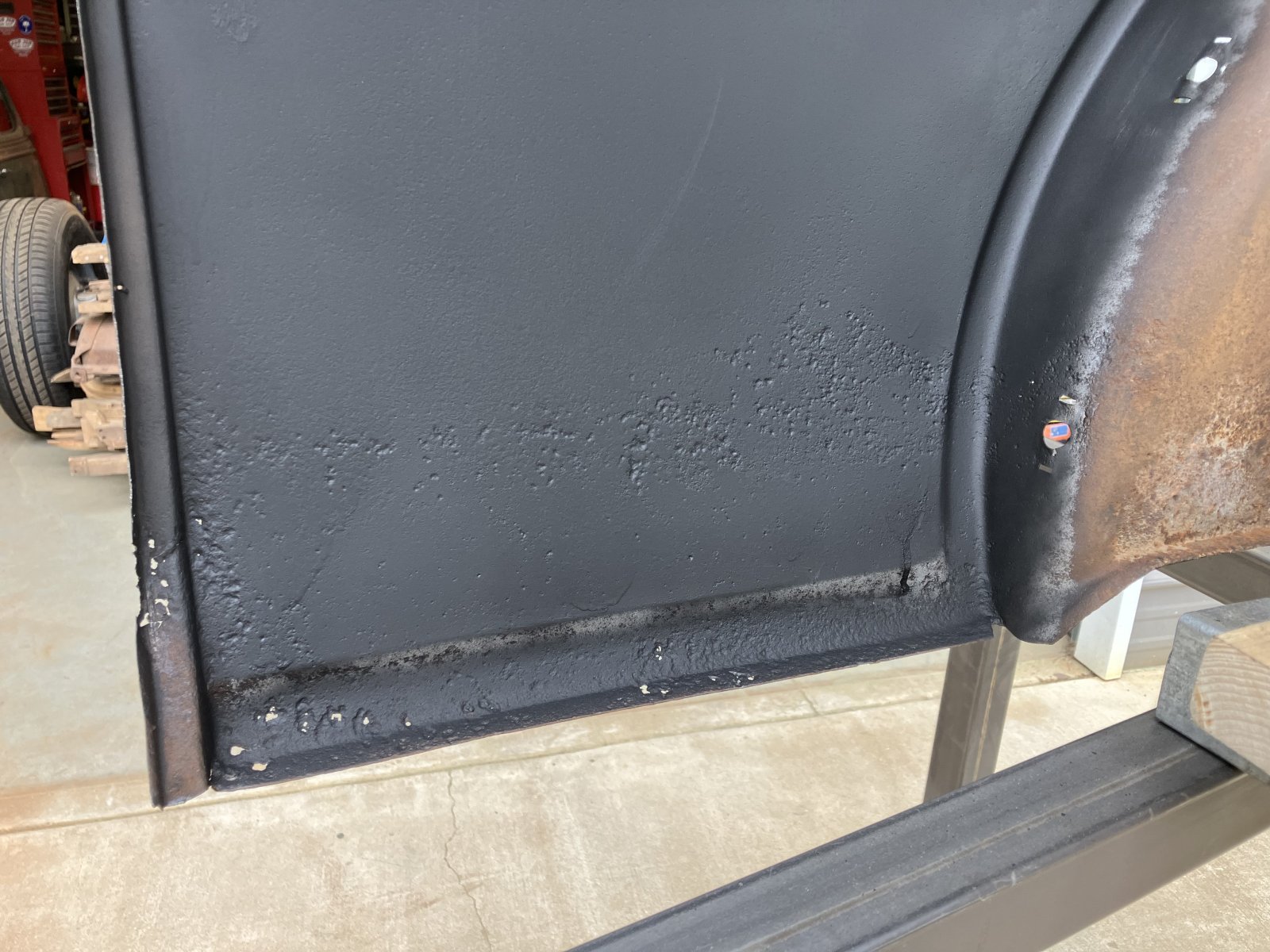

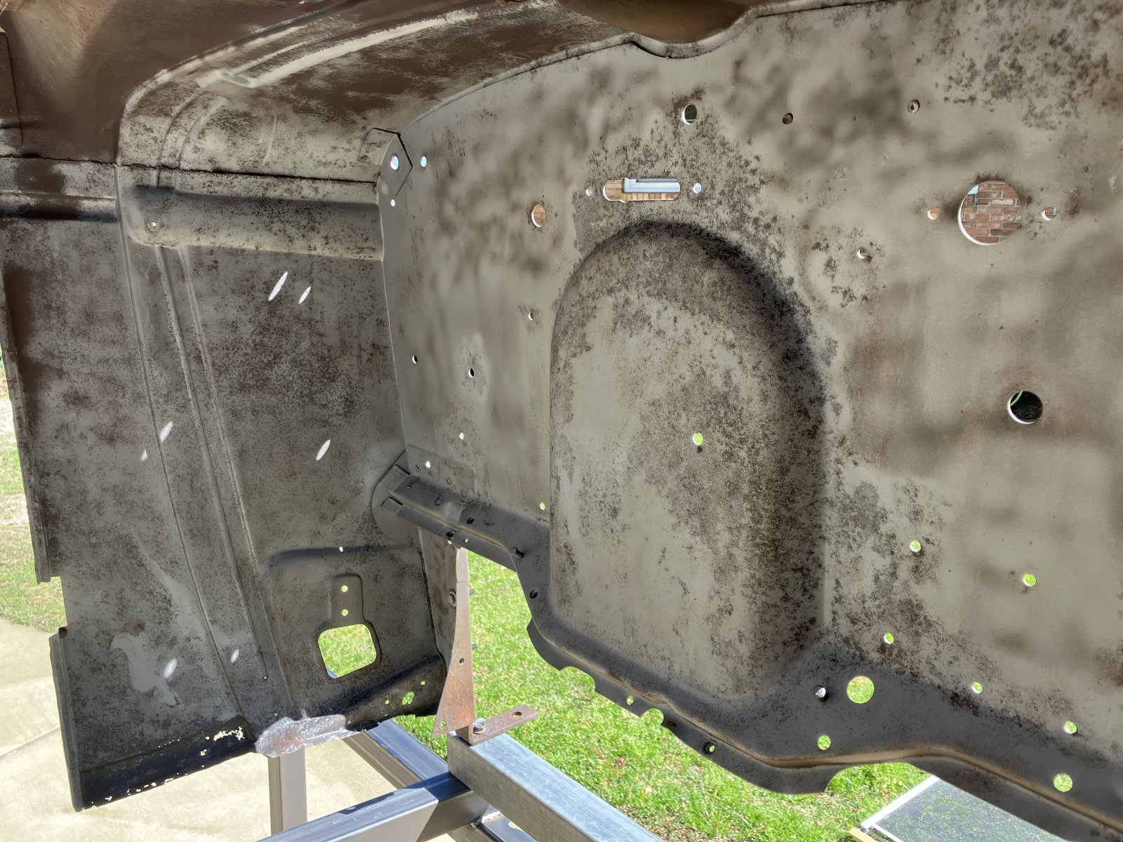

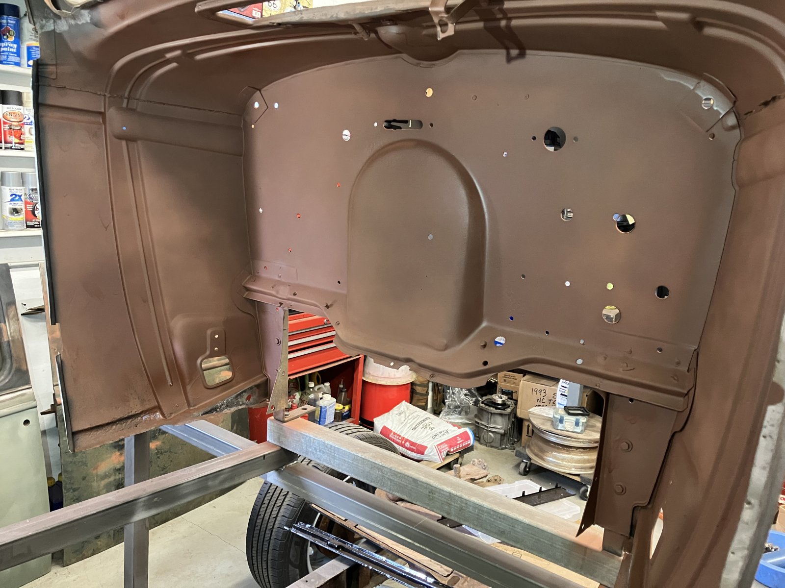

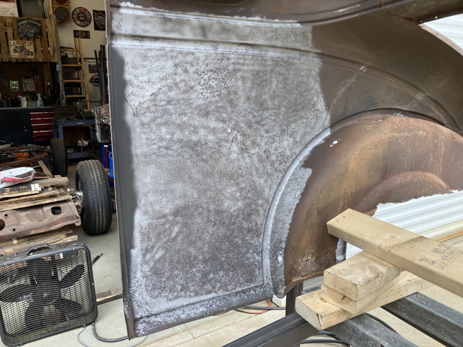

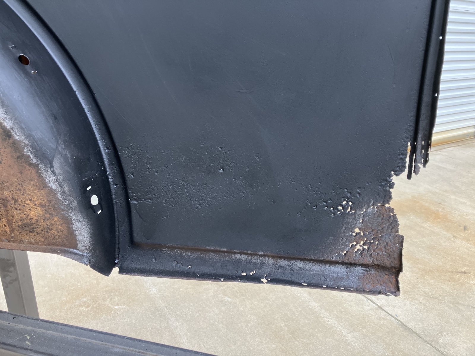

    I used POR-15 on the inside firewall and inside cowl because there were places it could seep in where I couldn’t sand. I thought it could seal things better. Then I applied oxide red over the POR-15. The rear quarters are getting a coat of Rust-oleum Rust Reformer to treat any minor rust. It’s supposed to chemically convert minor rust to iron oxide. Later I’ll spray a layer of epoxy primer to seal things up.
    You can see I’ll need patch panels behind the doors in front of the wheel wells.

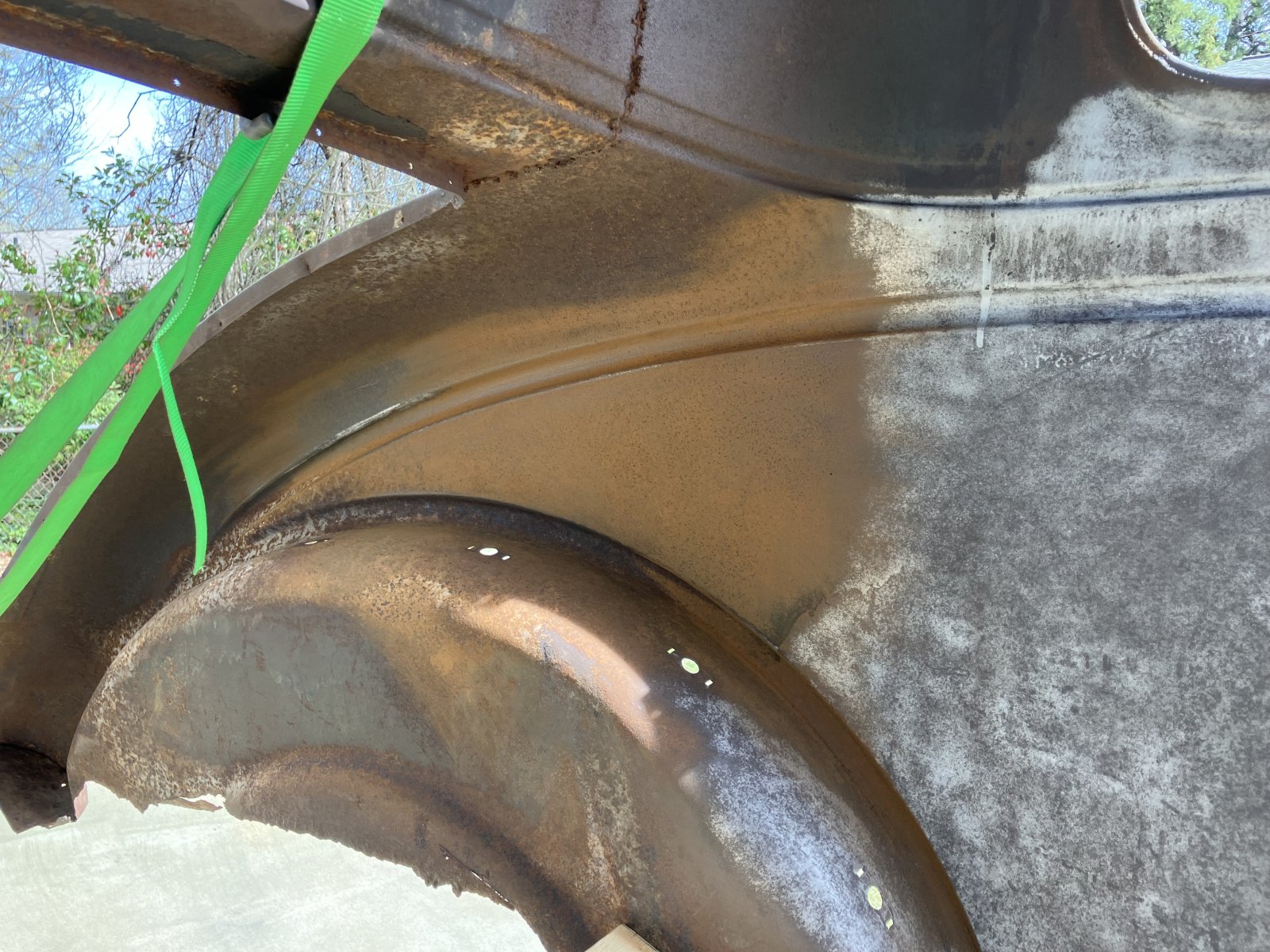

    I’m currently stripping rust from the interior of my 34. Got a little more stripped down tonight. Little by little . . . IMG_5052.jpeg IMG_5053.jpeg IMG_4270.jpeg

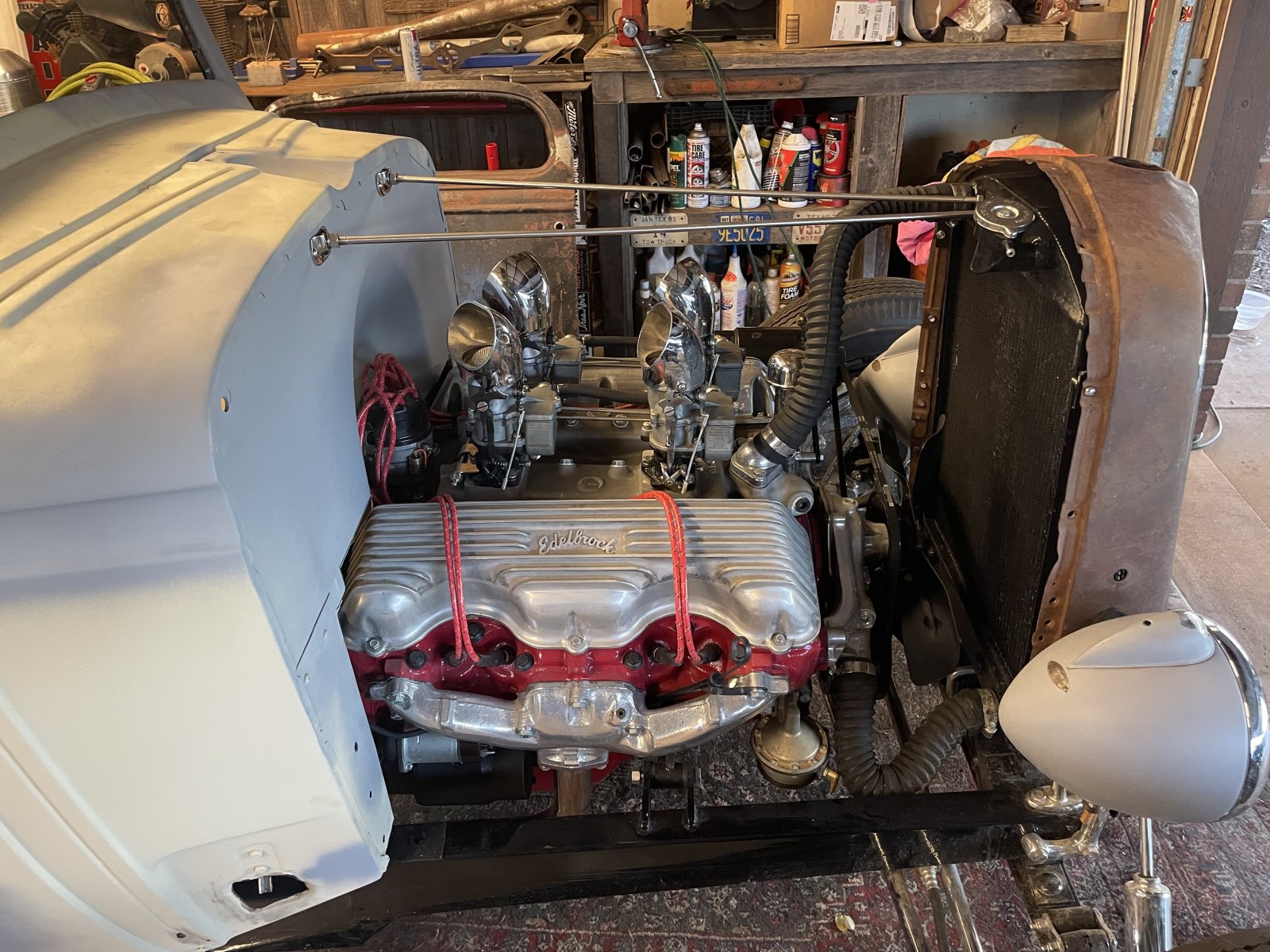

    What engine and tranny you got there?
