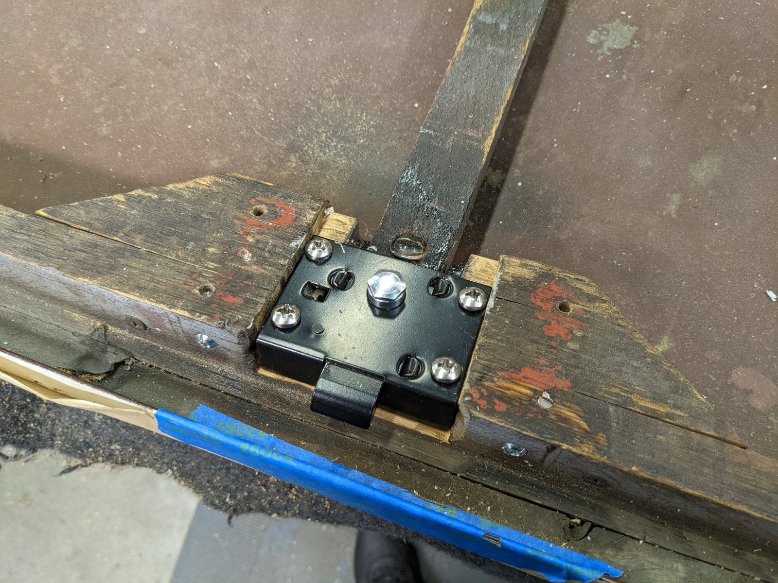

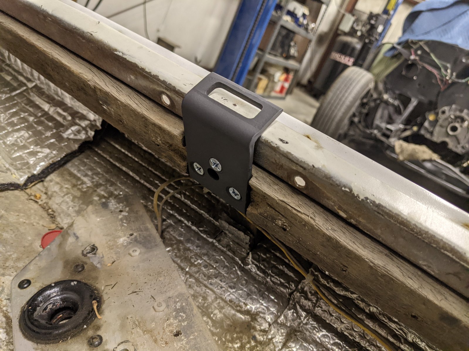

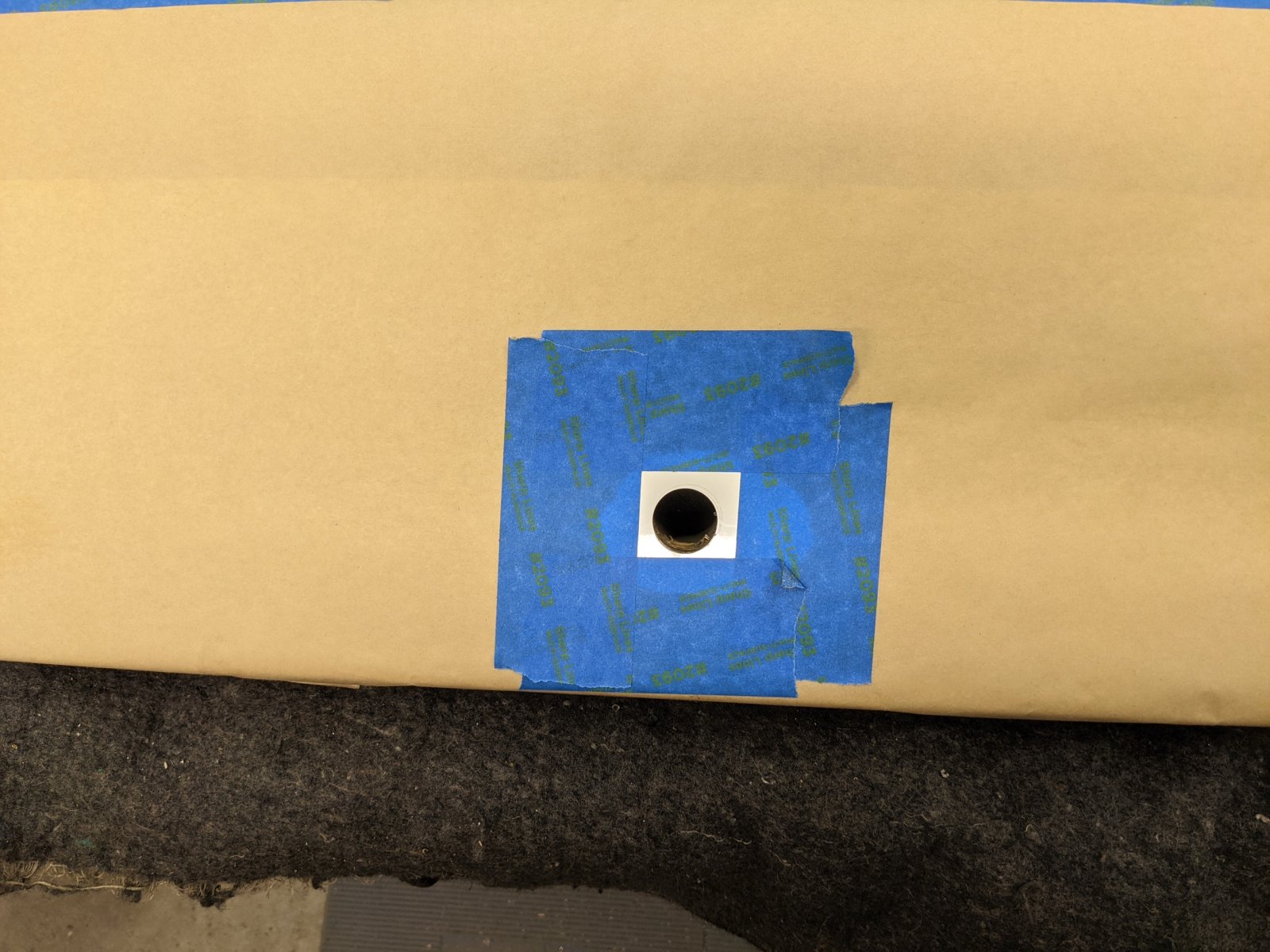

  2. Looking on the web today and found some repro trunk lid parts from I&I Reproduction. Can anyone with their original trunk lid still intact, looking at my 3 photos, show me your photos of these parts in your trunk lids? Then I can see firsthand what I need to do to modify my rumble lid to make it a trunk lid. Would appreciate this greatly for any help! Thank you!

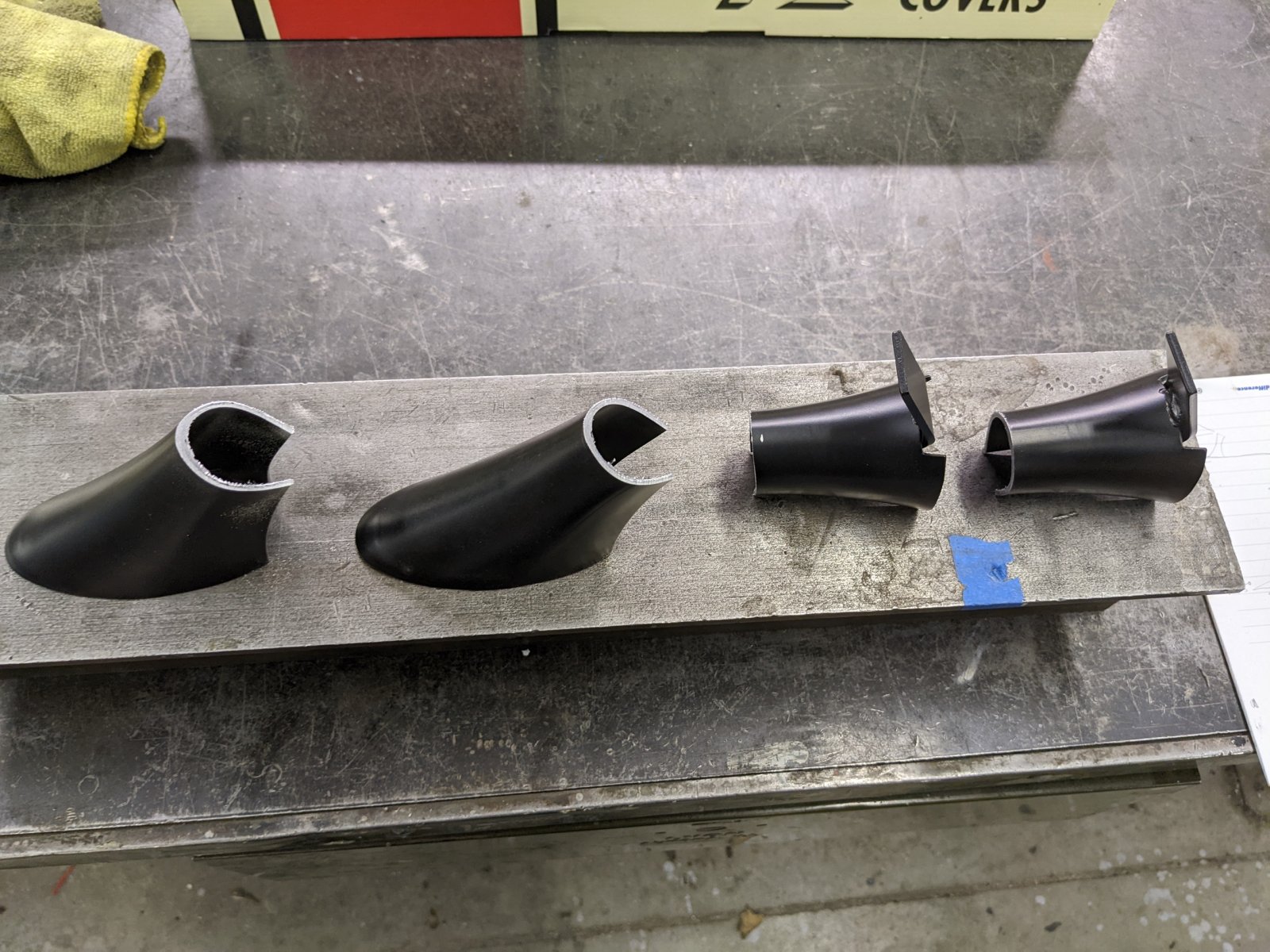

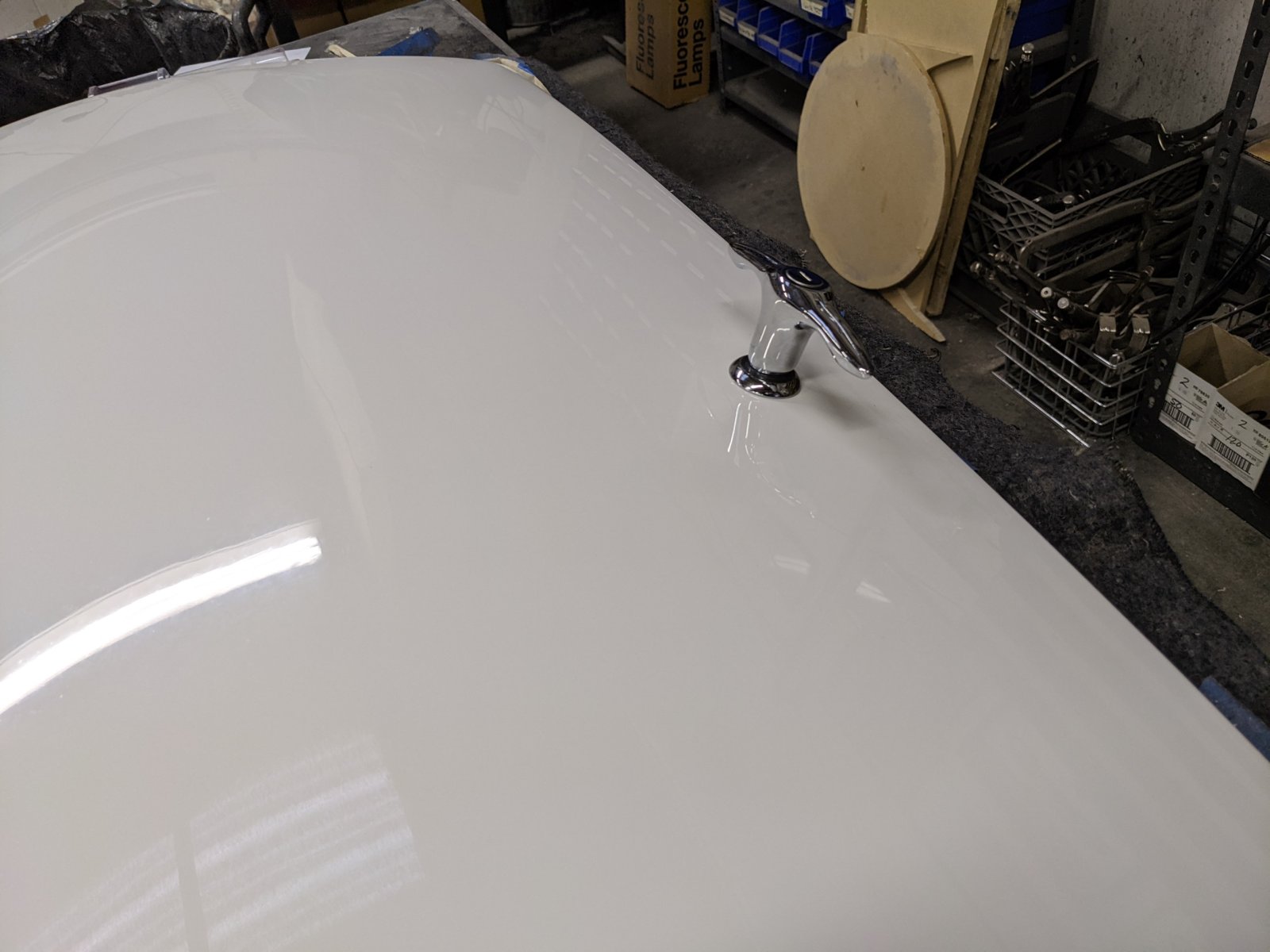

    Back in the early '80's I didn't have these parts when I built my coupe. I filled the handle hole and adapted a VW latch with a pull cable to actuate it. A couple of years ago when I was making changes to the coupe I decided to add the handle and latch. I bought these same 3 pieces from I & I. The wood had the holes for the striker plate and latch so that was a no brainer. The deck lid was more difficult but with a little measuring I was able to drill the hole in the correct position. I did have to modify the latch as it was not exactly correct for a '35. The latch was obviously meant to fit a deck lid with an inner steel panel and with the '35 it needed to screw into wood. I also had to sink the latch down into the wood. All in all it worked out great and I'm glad I did it. PXL_20221113_235552956.MP.jpg PXL_20221112_194032794.jpg PXL_20221112_214524842.MP(1).jpg PXL_20221114_003247998(1).jpg PXL_20221114_003256070.MP(1).jpg

  12. Appreciate your photos greatly - have an idea what I need to do... I'm leaning towards adding steel on the top of the rear panel under the trunk lid to make the lid close more solid.

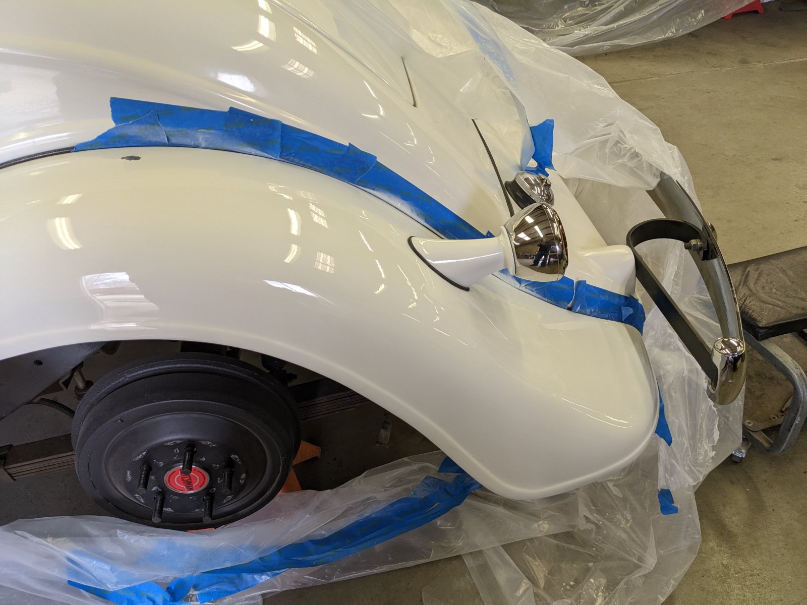

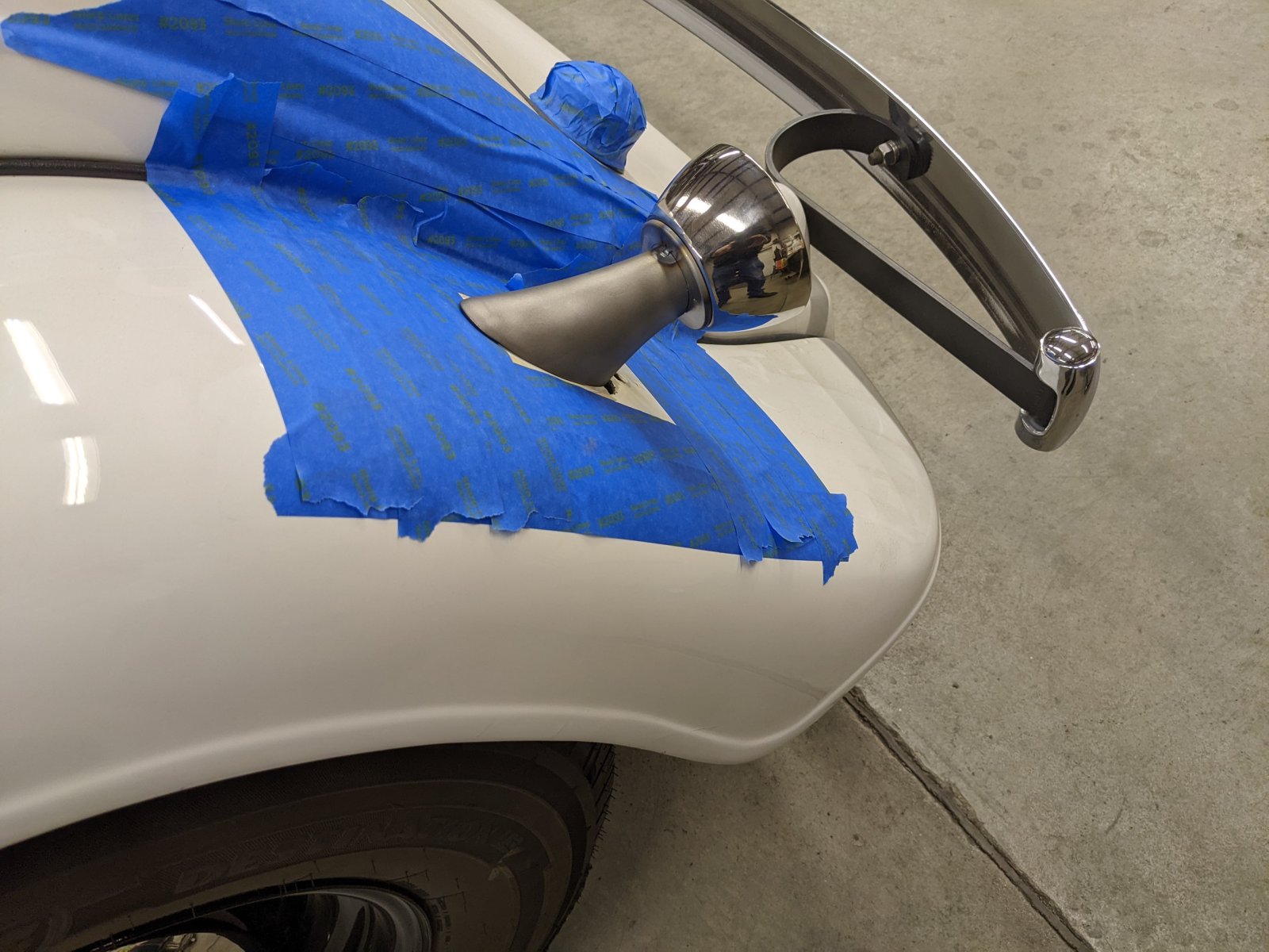

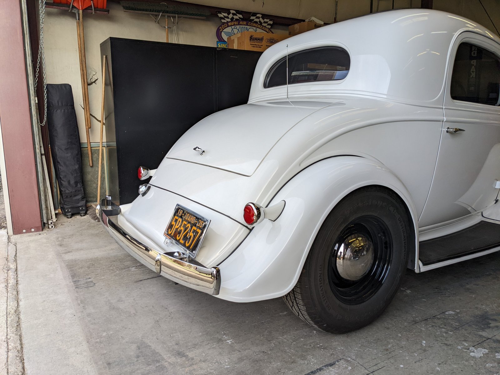

    I originally built this car with '39 Ford tail lights. (who didn't?) They point to the sky instead of the rear. I always kept an eye in the rear view mirror to see what the person behind me was doing when I braked. More often than not I noticed that they seemed to not see the brake lights. A couple of years ago I decided to make a change for safety. I got some repop '35 Chevy tail light stands and shortened them 2 5/8” and added '33 Ford tail lights. I patched the '39 holes, blended the paint and now am a little more comfortable with the cell phone addicted driver behind me. PXL_20221210_223926836.jpg PXL_20230322_230710749.jpg PXL_20221217_005448273.jpg PXL_20230416_000156334.jpg

  17. Holy Christ! Your '35 Chevy (Master or Standard) is so straight and clean, the alignment of your doors is exceptional along with the gaps - any car nut BESIDES Chevy enthusiasts checking out your car is going to think that the body is fiberglass! Us Chevy guys know that a repro body was never made for the Standards or Master series...
