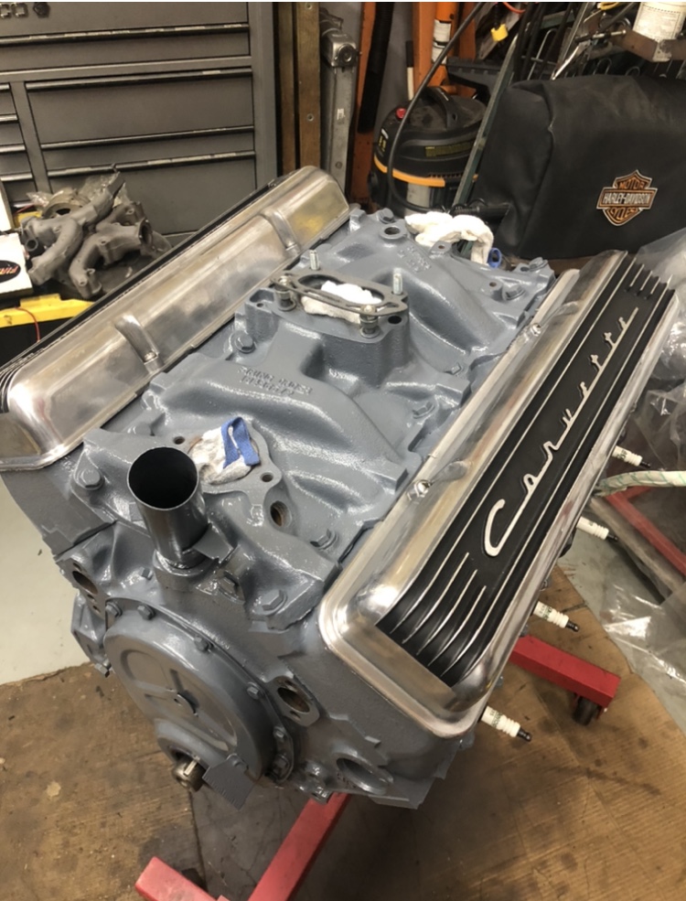

    I have zero experience when it comes to painting a car but I figured I can lay primer on the interior where it’s basically going to be a protective barrier/sealant. I mixed gray and black SPI epoxy to make my own custom gray for my 1965 Chevy C10 283ci trying to match the original truck engine gray.
    How do you like what I did to my valve covers? A Corvette purist would NOT approve but I think they look pretty good. upload_2024-4-15_17-34-49.jpeg

  30. Jay, your engine is looking good, you should think about coating those exhaust manifolds with Eastwood or POR-15 Hi-Temp Coating for exhaust manifolds (with up to 1400 degree protection) - comes in gray, silver or black. It's important that you prep the manifolds before painting and lastly, "cure" the paint - Once installed run the engine in a well ventilated area for at least 20 minutes to completely cure the coating.
