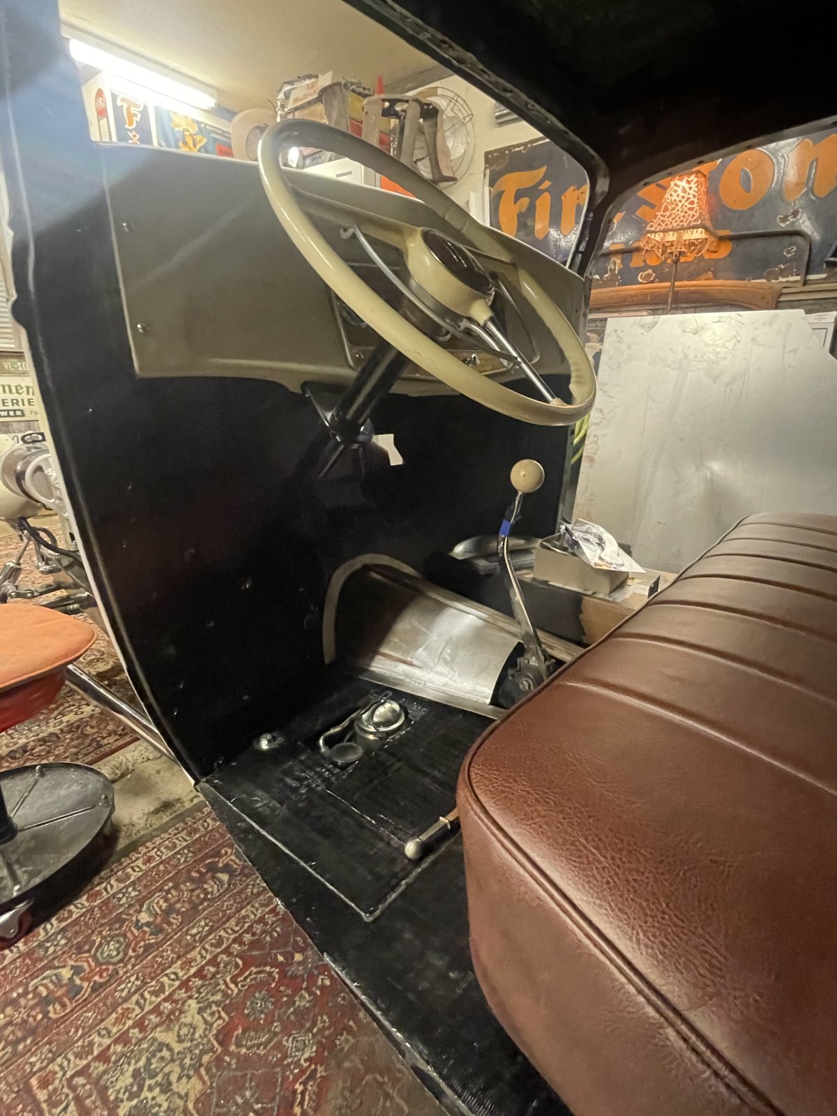

    It rides pretty good, it’s going to be a rattle trap with the doors but other than that pretty good. I did get a little death wobble on the first drive so I think I need to tow in the front tires a bit. Finished up the trans cover too IMG_8743.jpeg IMG_8742.jpeg

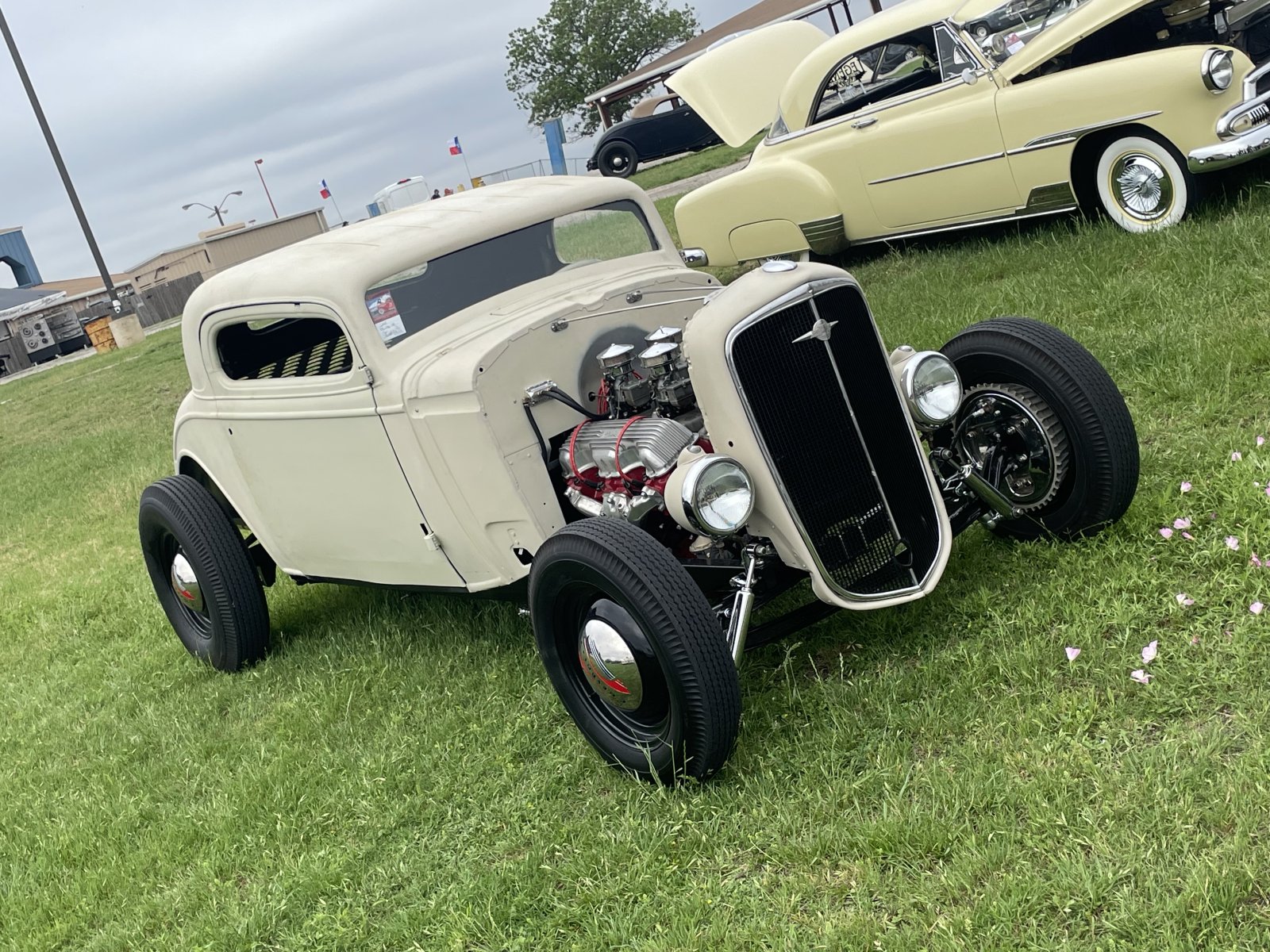

    My car somehow made it as a featured car at round up and got to park on the hill. IMG_8839.jpeg

  11. Countn'Carbs
    Joined: Nov 8, 2006
    Posts: 989
    Countn'Carbs
    from CO
    Awesome and Well Deserved!!!

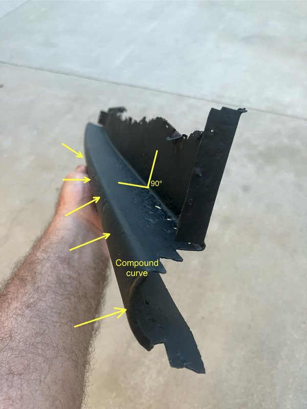

    Rocker fabrication will be a challenge. Compound curves. If I fail to make decent rockers from new sheet metal I will patch the ones I have. 1934 Chevy Master coupe

    The vertical part is completely rotten, but there are large pits and numerous pin holes on the horizontal section.
    I’m up for a challenge and will try to fabricate it from one piece of 18g. The compound curve will need both stretching and shrinking.
    If I fail I can at least use the lower 1/2 and just patch (replace) the upper half. That wouldn’t be too difficult.

  18. "SOMEHOW"? More likely that your hot rod is unique and stands out from all of the Fords in that show. A welcome entry for some of the past entries in the Round Up! Great job brother! Now let's see some pics!

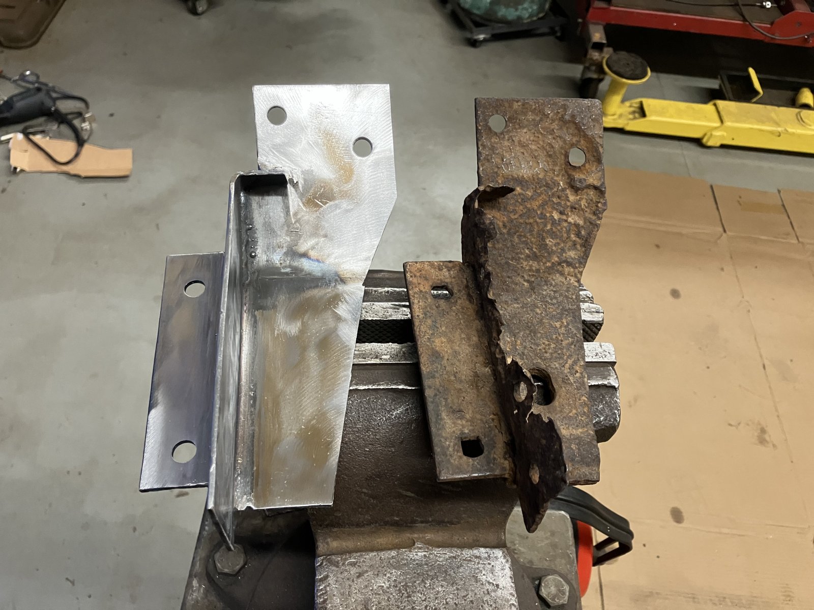

    Fabrication day. Bought some steel and it got me motivated. The passenger side rear body to frame bracket was too badly rusted to use again. The driver side is in decent shape. I used 11 and 12 gauge steel, like the original.

    Are you going to slot the holes like the original? That allows for alignment adjustments. Good work!
