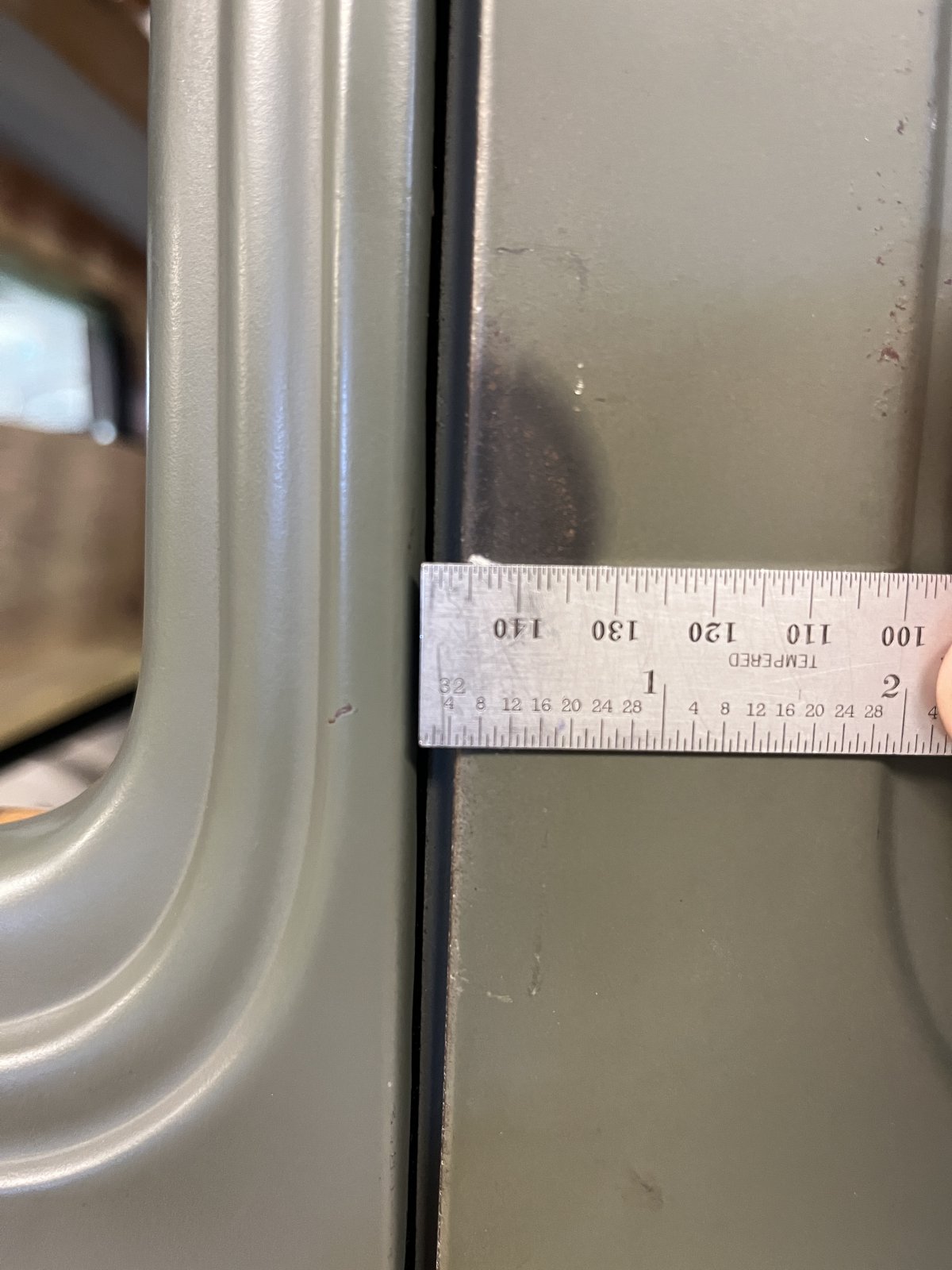

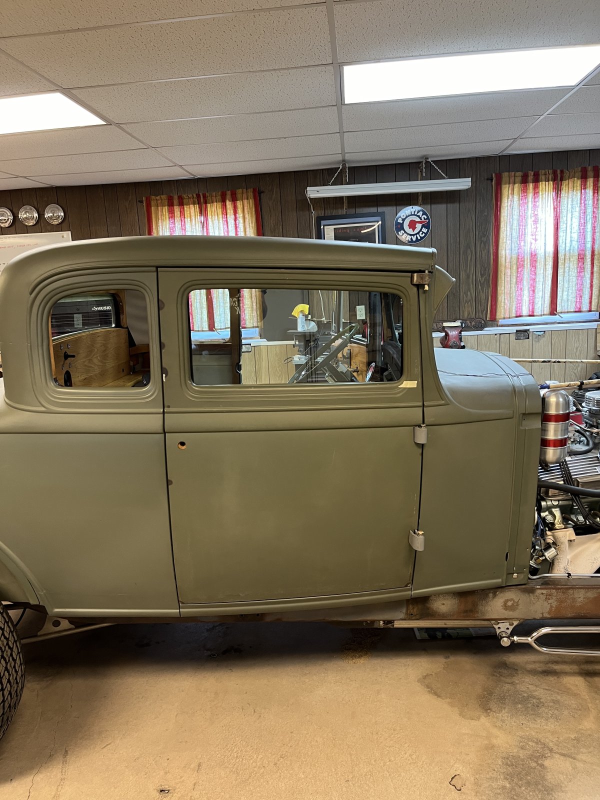

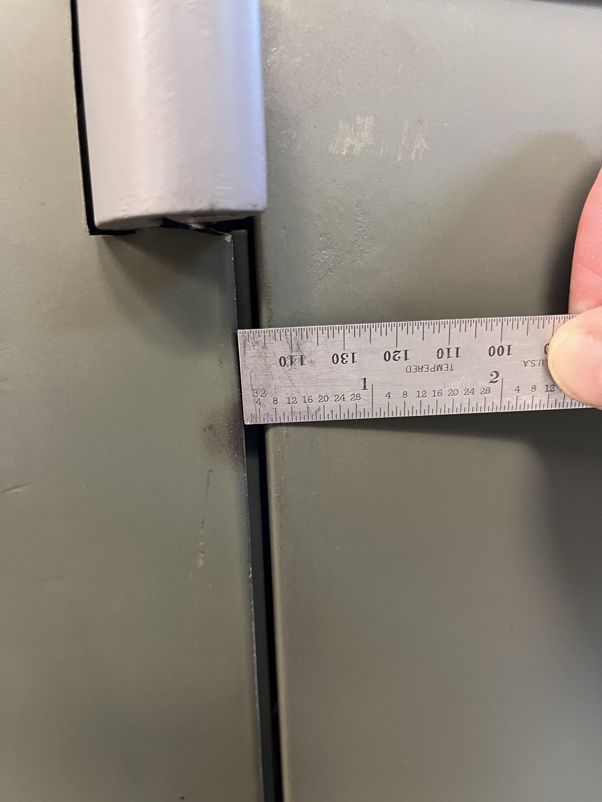

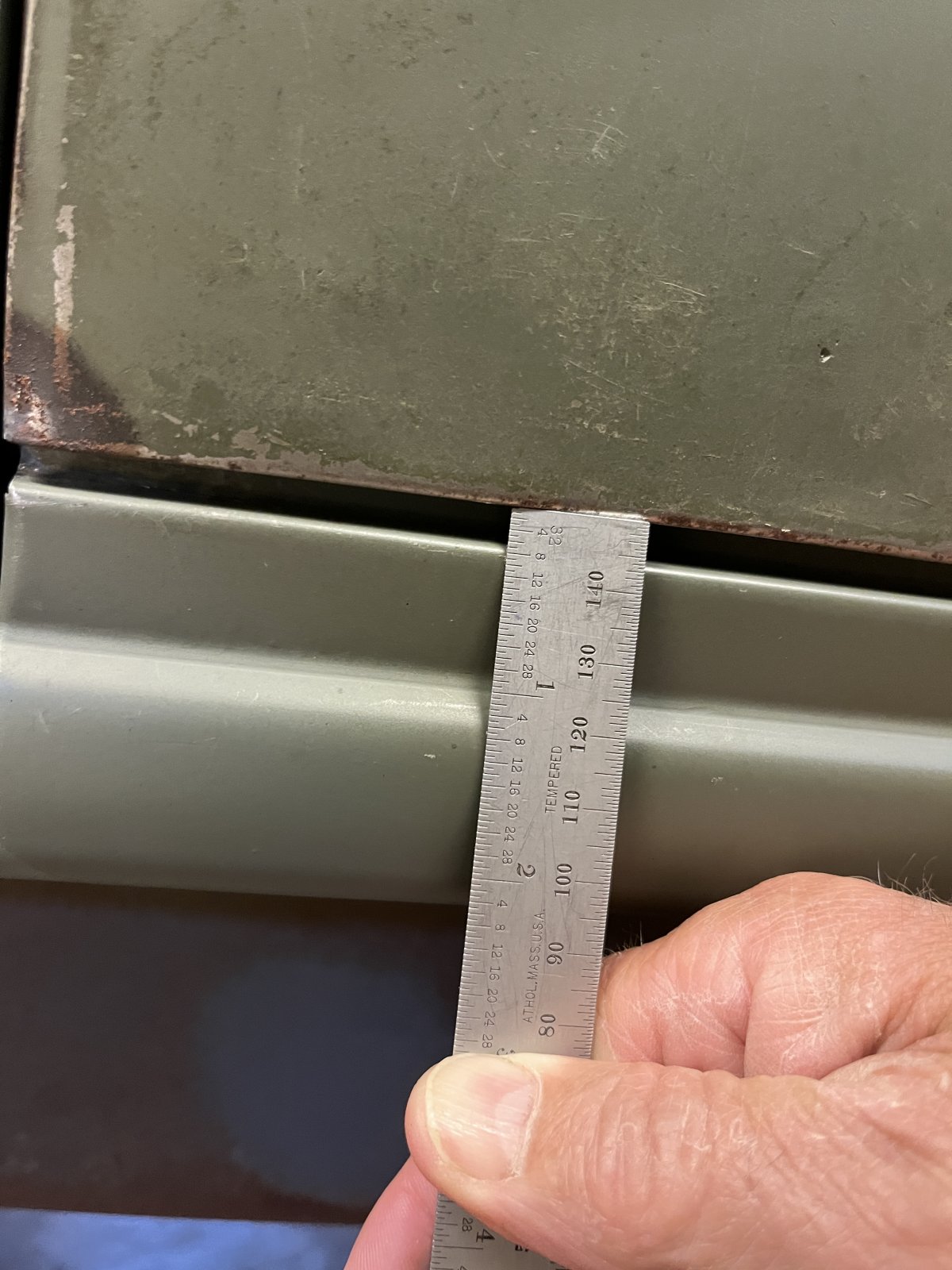

    My ‘31 Pontiac ( pretty much the same body from the cowl back) door gaps measure between 3/16 inch and quarter inch. IMG_8013.jpeg IMG_8014.jpeg IMG_8015.jpeg IMG_8016.jpeg IMG_8021.jpeg

    3” chop at the windshield and 2 1/2” at the rear window.

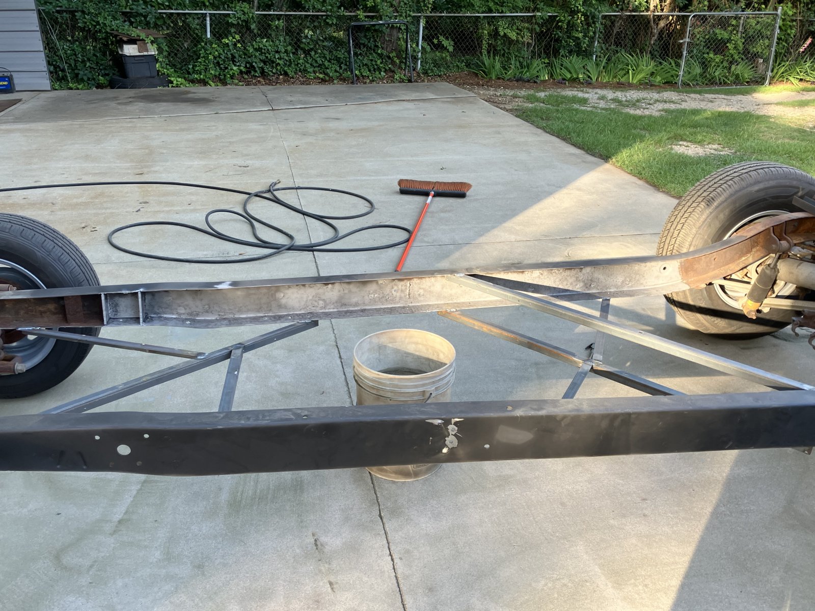

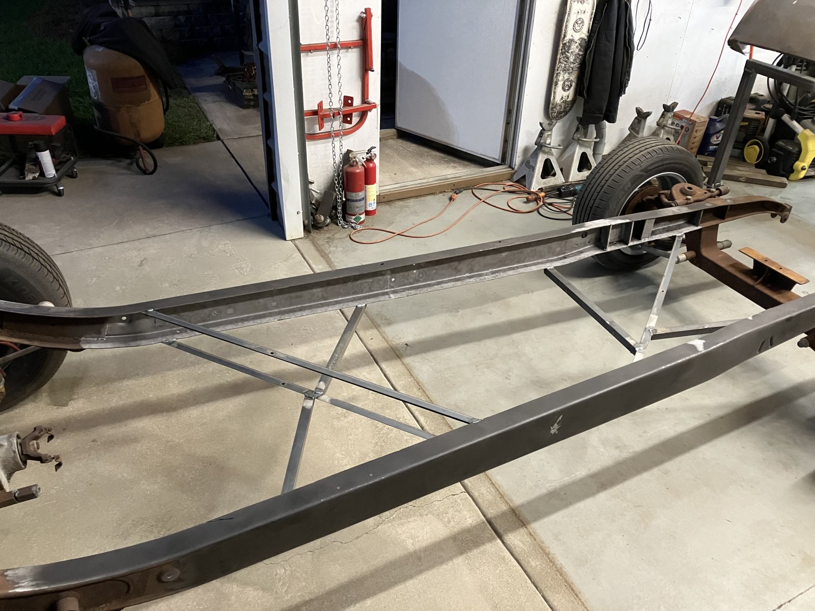

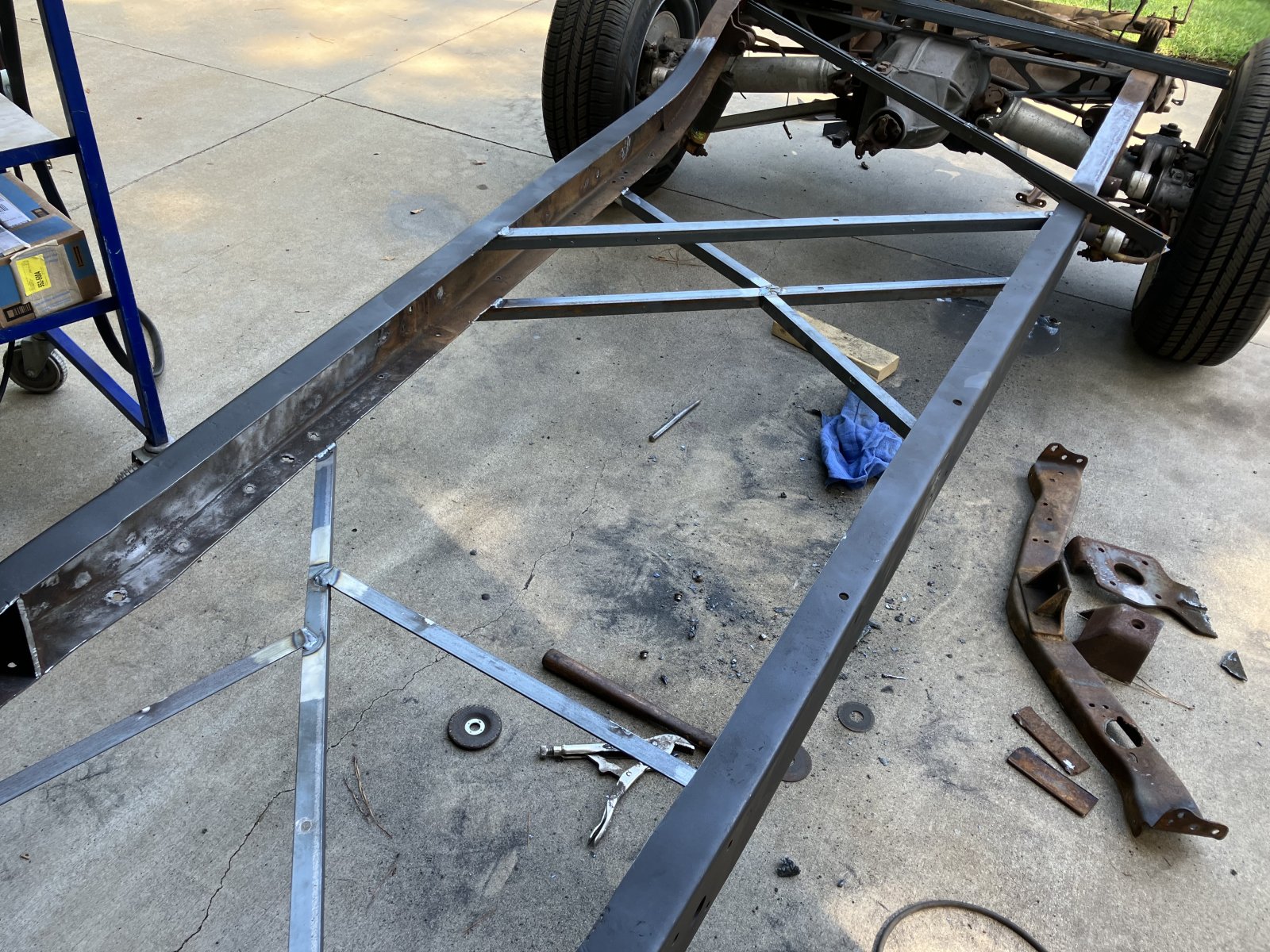

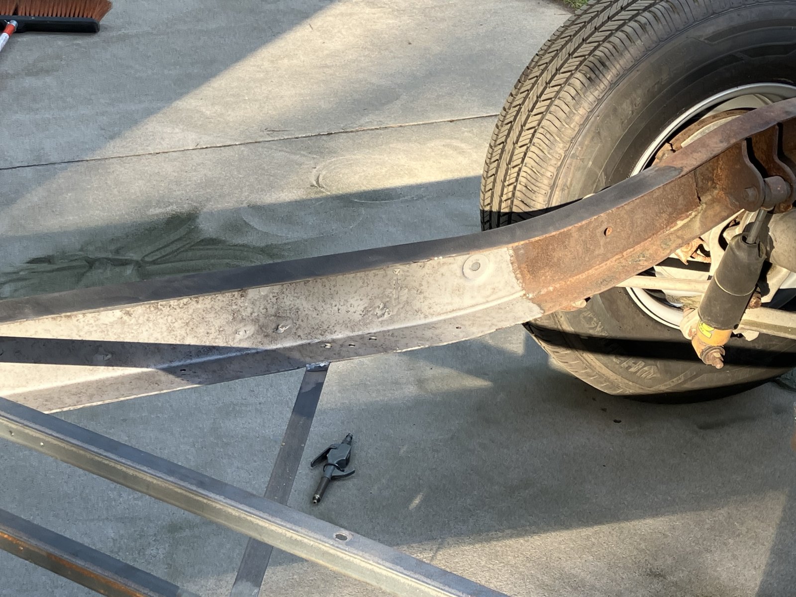

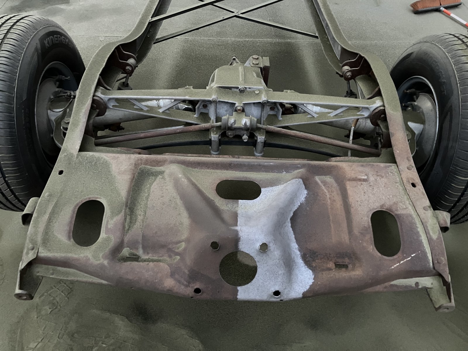

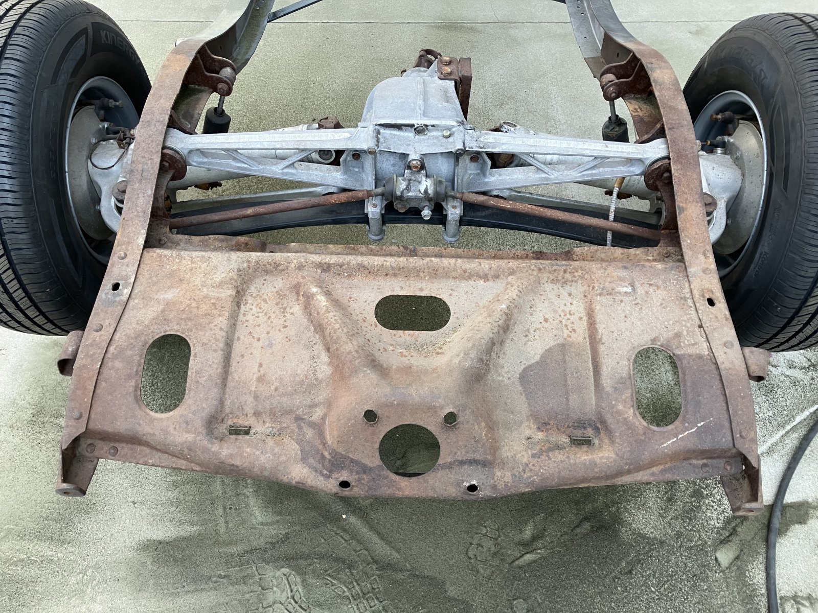

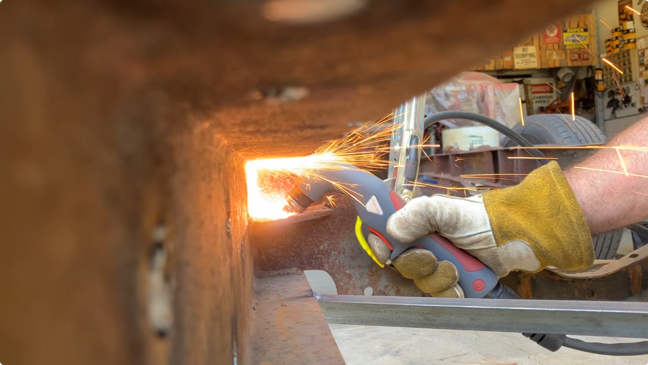

    Back to work on the 1934 coupe this week. Welded a few more frame holes closed. Then welded 14g angle iron bracing to the frame so I could remove the unneeded crossmember. Then some media blasting to the inside of the frame before I spray epoxy primer and box the frame.
    IMG_6048.jpeg IMG_6051.jpeg IMG_6052.jpeg IMG_6059.jpeg IMG_6060.jpeg IMG_6063.jpeg IMG_6065.jpeg IMG_6066.jpeg
  10. Your progress is going well Jay - did you indicate or keep track of the existing holes needed to mount the body back on? Should be 6, 3 on each side, maybe more.
    Six Ball likes this.
  11. Jay Altemus
    Joined: Dec 24, 2023
    Posts: 270
    Jay Altemus
    Nope, but I can still find them because I can still see the weld from the under side of the top flange. I kinda regret saving this frame and not just building a new frame. This is taking a lot of time because I need to undo what other owners have done.

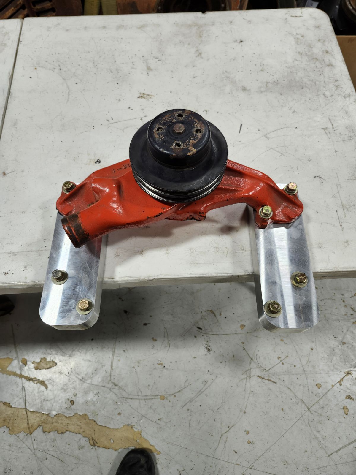

    Also have a machinist buddy building risers for my water pump to raise it up about 4 inches

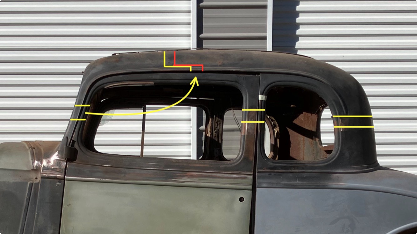

    Chopping the top of my 34 scares the *#%*<# out of me. I can certainly live with what I have.
    Not a severe chop. Just 2”.
    Reading and YouTube videos have helped me understand the complexities of chopping a car with slanted A pillars. The top needs to be stretched so the A pillars meet, or the angle of the A pillars tilted back. Plus there is the issue of making the windshield flange match top and bottom so the gl*** seals properly.
    I’ll share my thoughts hoping you will recognize I am a newb at chopping a hot rod.
    This photo explains what’s in my mind as a POSSIBLE way to chop.
    I would choose to elongate the roof.
    The open roof would make it easy to Z the roof above the doors.
    I’d use the 2” chopped out piece from the A pillar (after a little reshaping) to fill the bead line above the door since the bead shape is nearly identical. Door would get the same treatment using the section removed from the door B pillar.
    The Z at the roof line would require a 1-2 inch strip of sheet metal shaped with an English wheel. A donor roof panel would be spliced in to fill the open roof. Appropriate roof bracing as a final step.
    The advantage to this method is that the A pillar and windshield flange remain the same. The risk is that the roof is weak and caves downward.
    I’m ready to listen to advice.

  18. 270ci
    Joined: May 17, 2010
    Posts: 485
    270ci
    Have you seen Kyle's video of him chopping a 33 Chev coupe?
    He's kind of a goofball, but he actually knows what he's doing and does a great job.

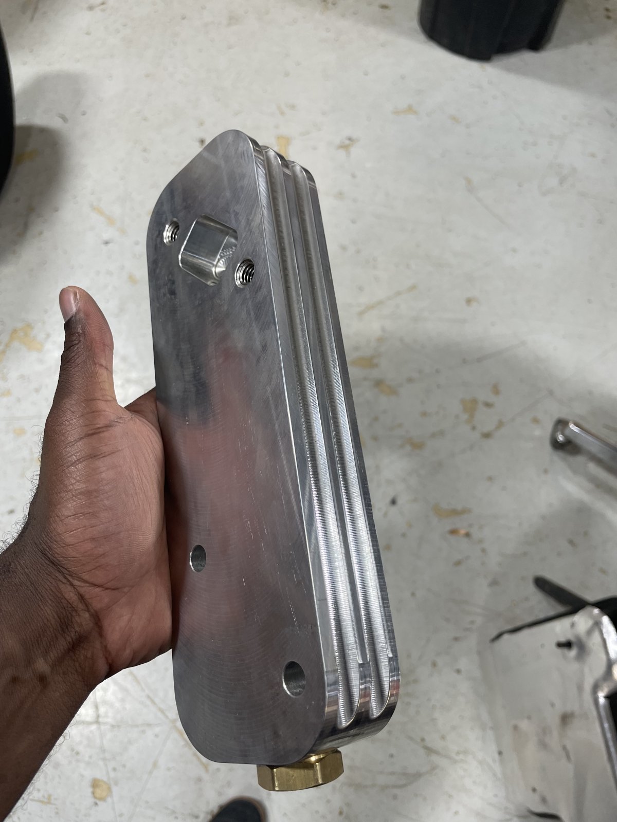

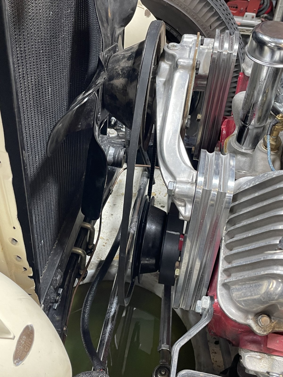

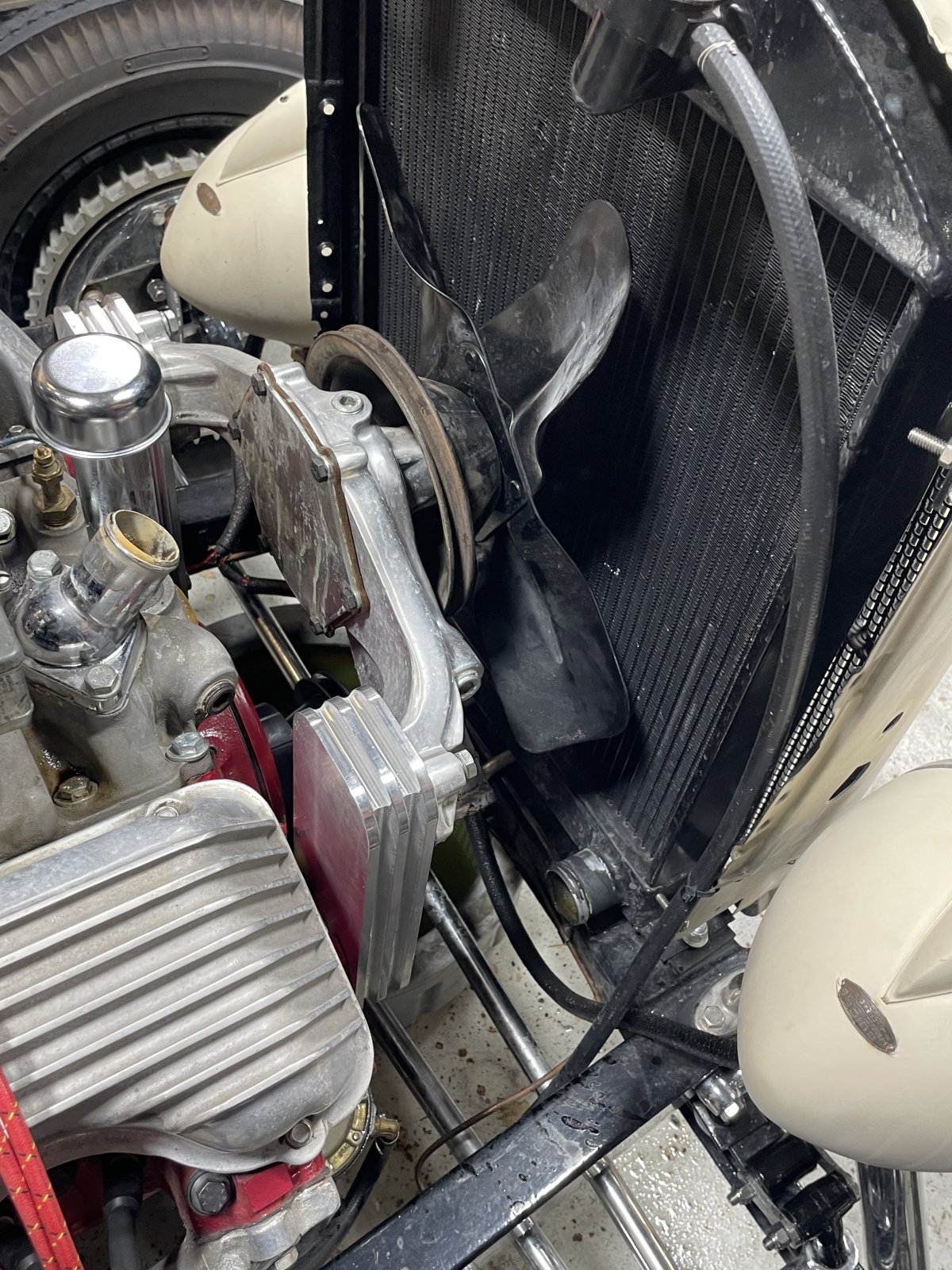

    IMG_9307.jpeg IMG_9310.jpeg IMG_9309.jpeg Buddy made some risers for my waterpump, car was running hot due to fan placement.
  21. Very impressive ingenuity brother - Look into this engine coolant in case the need arises, because this coolant will be flowing in my system in the very near future:

    I actually did read about that stuff at one point. Just ****s cause you’d have to spend like 150-200 on fluids

  26. 270ci
    Posts: 485
    270ci
    Great solution with those risers @snoop74! What water pump are you using?
    It appears to be aluminum and have a smaller profile.
    31chevymike and snoop74 like this.
  27. snoop74
    Joined: May 29, 2022
    Posts: 417
    snoop74
    It is aluminum but I think it’s of the same profile, I have a cast one too and everything lines up about the same. aca9bb48-de44-4d06-bf36-ea4b0b9b5cbd.jpeg image000003.jpeg image000002.jpeg

  28. Brother - Possibly look into this "Super Cooling" water pump replacement, grind down the "Edelbrock" logo so it resembles a factory water pump and paint it Chevy Orange afterwards - no one will ever tell the difference (damn thing is very PRICEY):
    Fits 1958-65 B/B Chevy 348/409 "W-Series" engines. Satin Aluminum Finish. The "super cooling" water pump is computer-designed to deliver more flow at a higher velocity. They're the ideal choice to prevent overheating in any street machine, street rod, truck, or any performance vehicle. Precision cast powdered metal impellers have extra large vanes for the maximum flow rate possible, ensuring adequate pressure and volume even at lower engine speeds. Factory replacement for Revolver Serpentine Kits..

    I’ve watched a good chunk of Kyle’s video. Goofball or not, I like that he knows how to edit a video. I think his goofiness is just his attempt at trying to make it a bit more entertaining to watch.
    I noticed he lengthened the roof. I found it odd that he did the doors first. I can only presume that he did some t******* of the A and B pillars to fine tune things to get the doors to fit the way he wanted.
    It also appears that he lined up the A pillars and then worked out the gap difference at the back window. That’s why he needed to cut the side window corner to move it forward.
    I’ll watch the whole thing several times.
    I research everything before I start something. It slows my progress, but I make fewer mistakes (hopefully).
