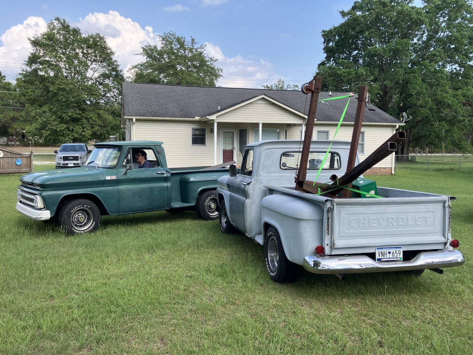

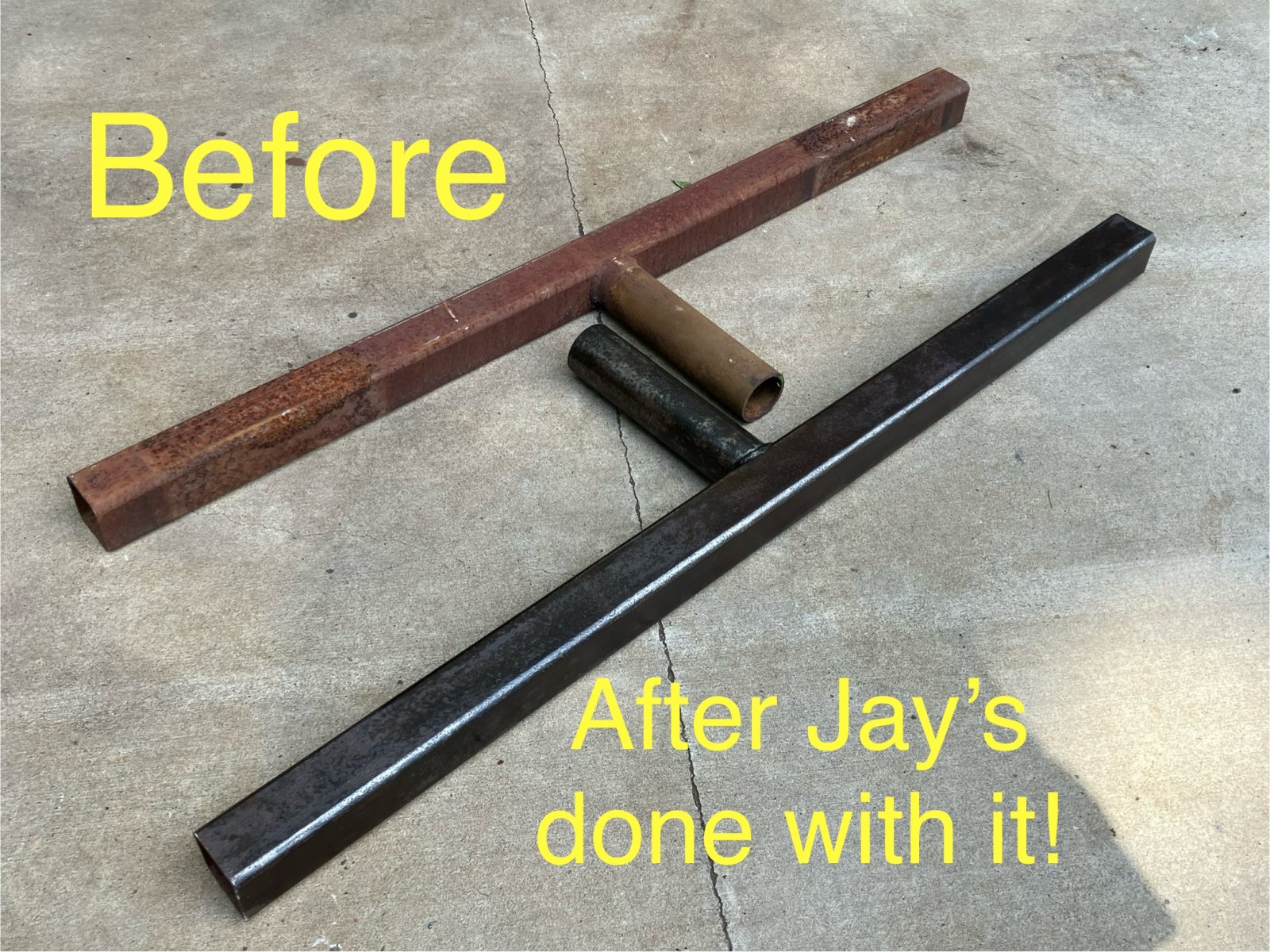

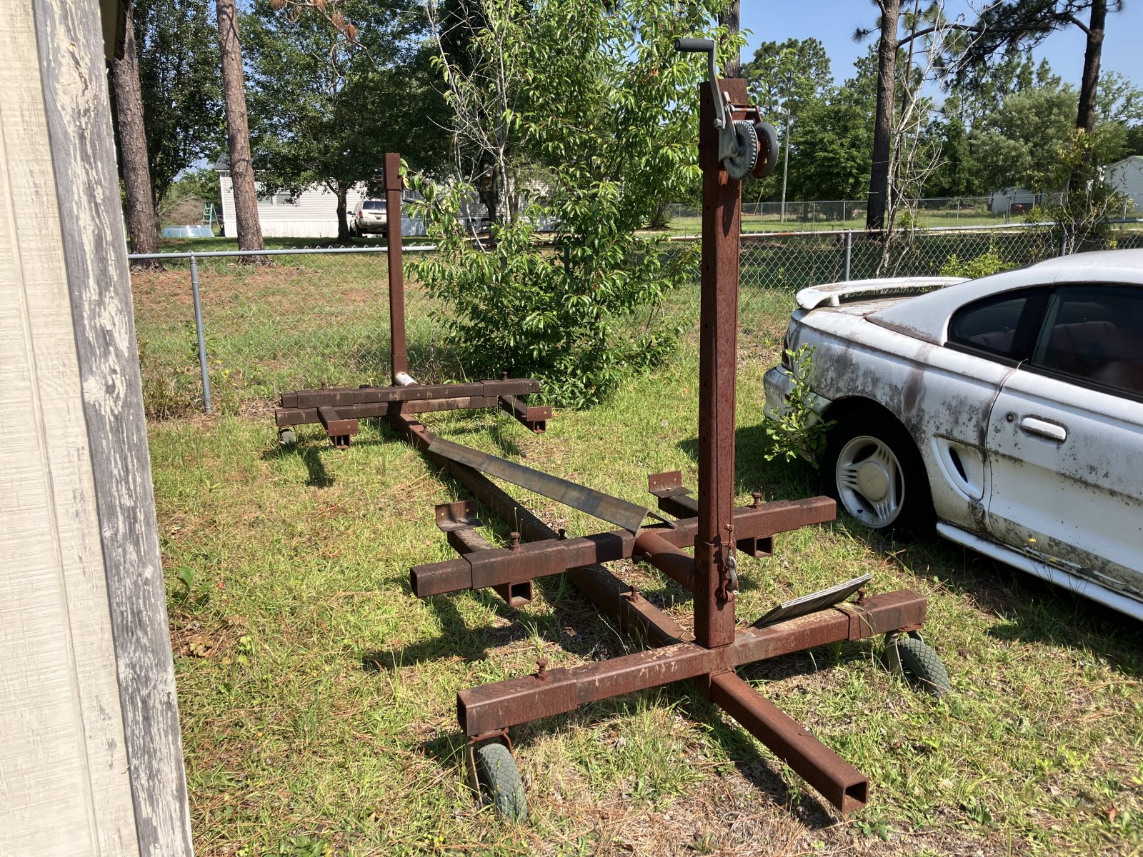

    I was going to make my own small rotisserie for my 34 frame so I could work smart, and not work so hard as I media blast the frame. I mentioned this to my friend, and he offered to loan me his rotisserie. (I didn’t know he owned one.)
    I went to get it the other day and it’s a monster. The lower horizontal beam connecting the two ends was 17 Feet long, so I cut it in half to get it home. This rotisserie is strong enough to handle just about any size car.
    It has been out in the weather for 11 years, so I’m giving it the attention it needs. I should have it ready to use within the next week or so.
    My friend and I both own 1965 Chevy C10 half ton stepside trucks. His green truck is all original and mine has undergone a few upgrades.

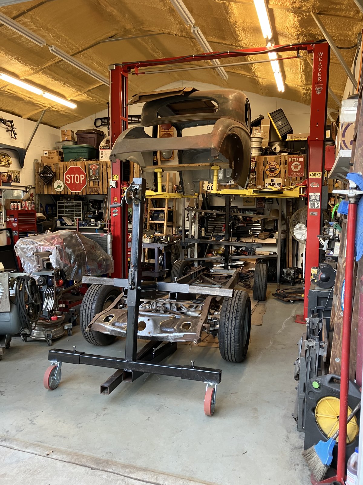

    Jay Altemus

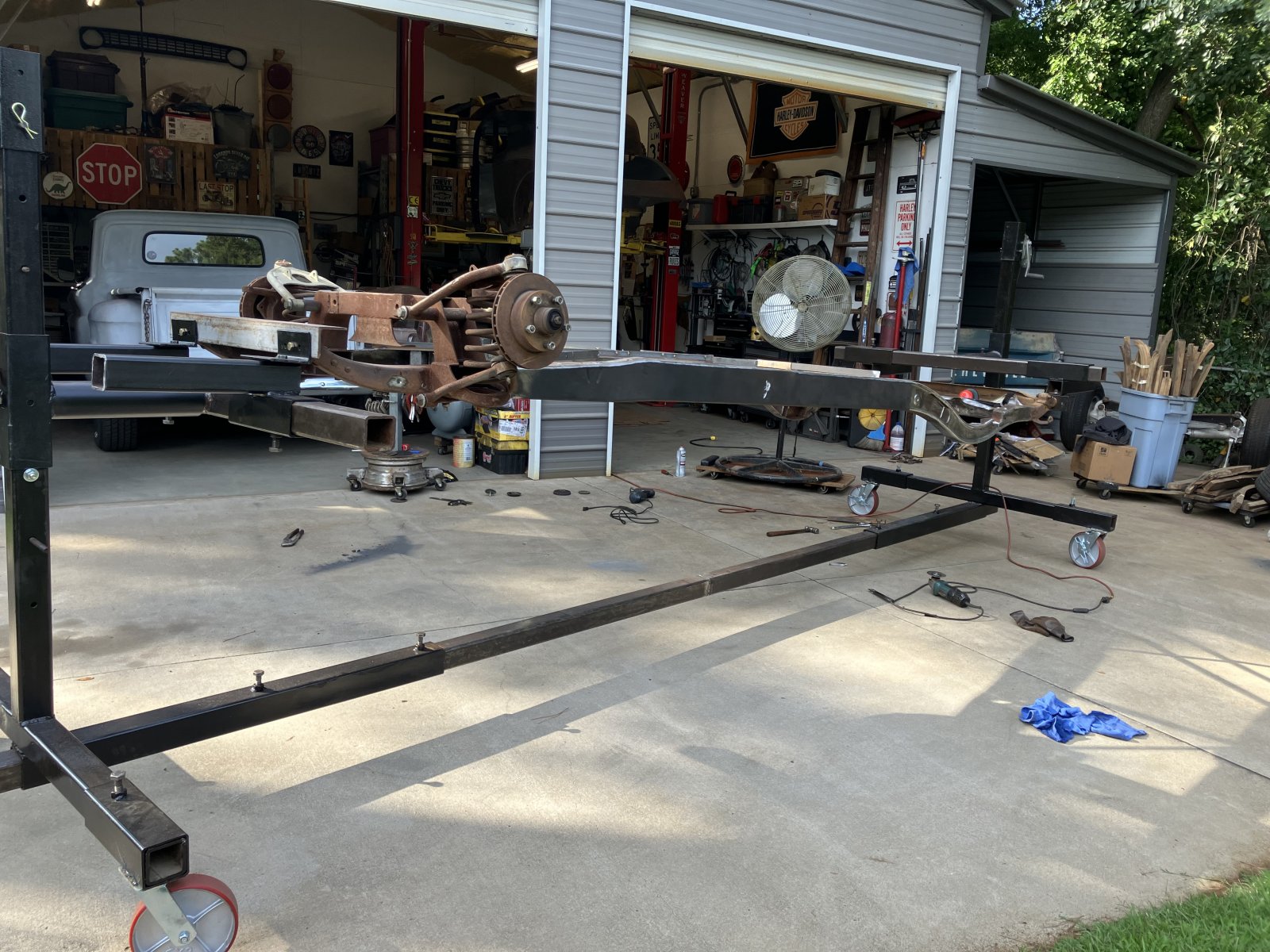

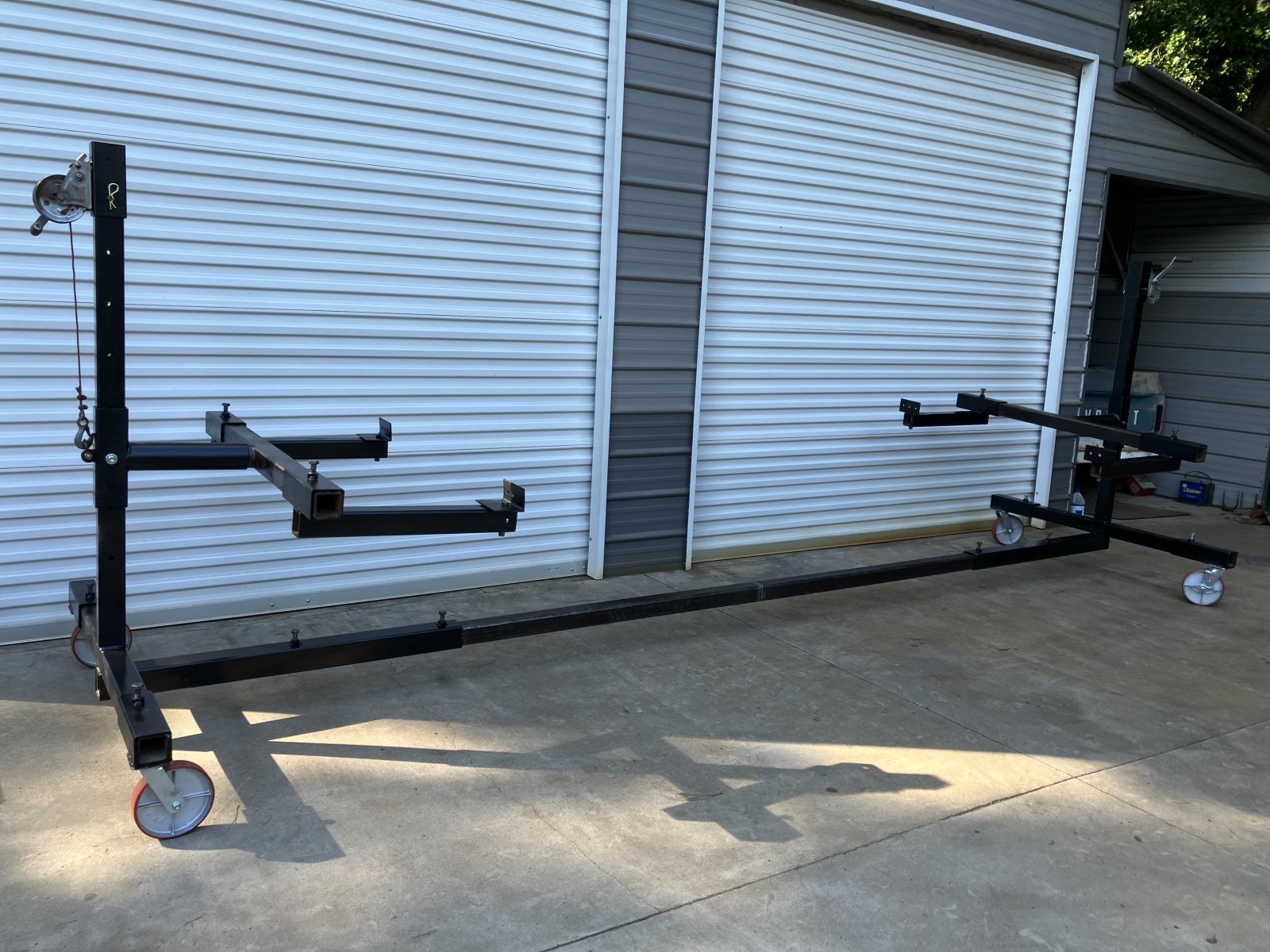

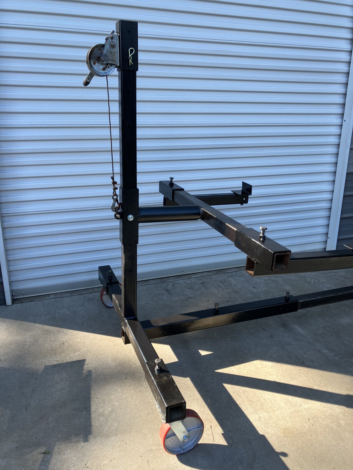

    Well, it’s DONE!
    Brought this rusty rotisserie home Monday 6/17/24. Cleaned and made it ready for service. New 8” wheels welded on today.
    I’ll mount my 34 coupe frame and finish cleaning and media blasting the frame.
    Had to get creative with shop space. Body of the 34 had to come off the dolly and onto the lift so the rotisserie could fit in the same bay of the shop.

  8. Jay Altemus
    Joined: Dec 24, 2023
    Posts: 270
    Jay Altemus

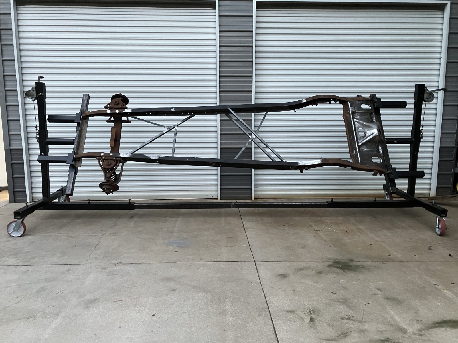

    Frame is on the rotisserie. C4 rear axle is off. IFS comes off next.
    Top heavy on the rotisserie. Guess I’ll have to fabricate something to center the weight on the axis of rotation.

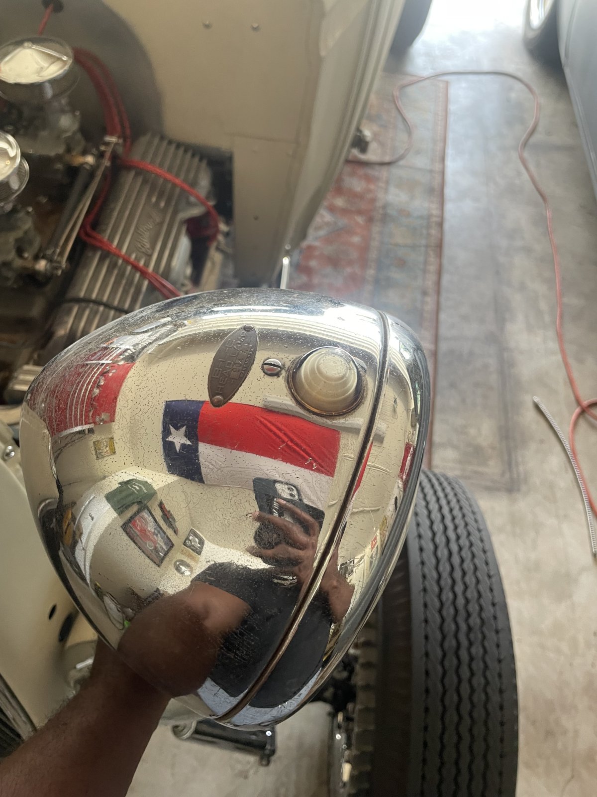

    Finally found a set of 904-A chrome headlights to run instead of the 682-C

    I’ve been looking for a set of these 904-A’s for awhile.. which do yall think I should run. Both are 7” the 904s are a bit more rare; seems like everyone is running 682’s. The 904 is a little shorter as well IMG_9383.jpeg IMG_9382.jpeg

    They are both nice. I think I'd run the 904s.
  15. Jay Altemus
    Posts: 270
    Jay Altemus

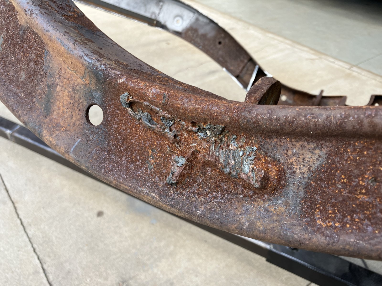

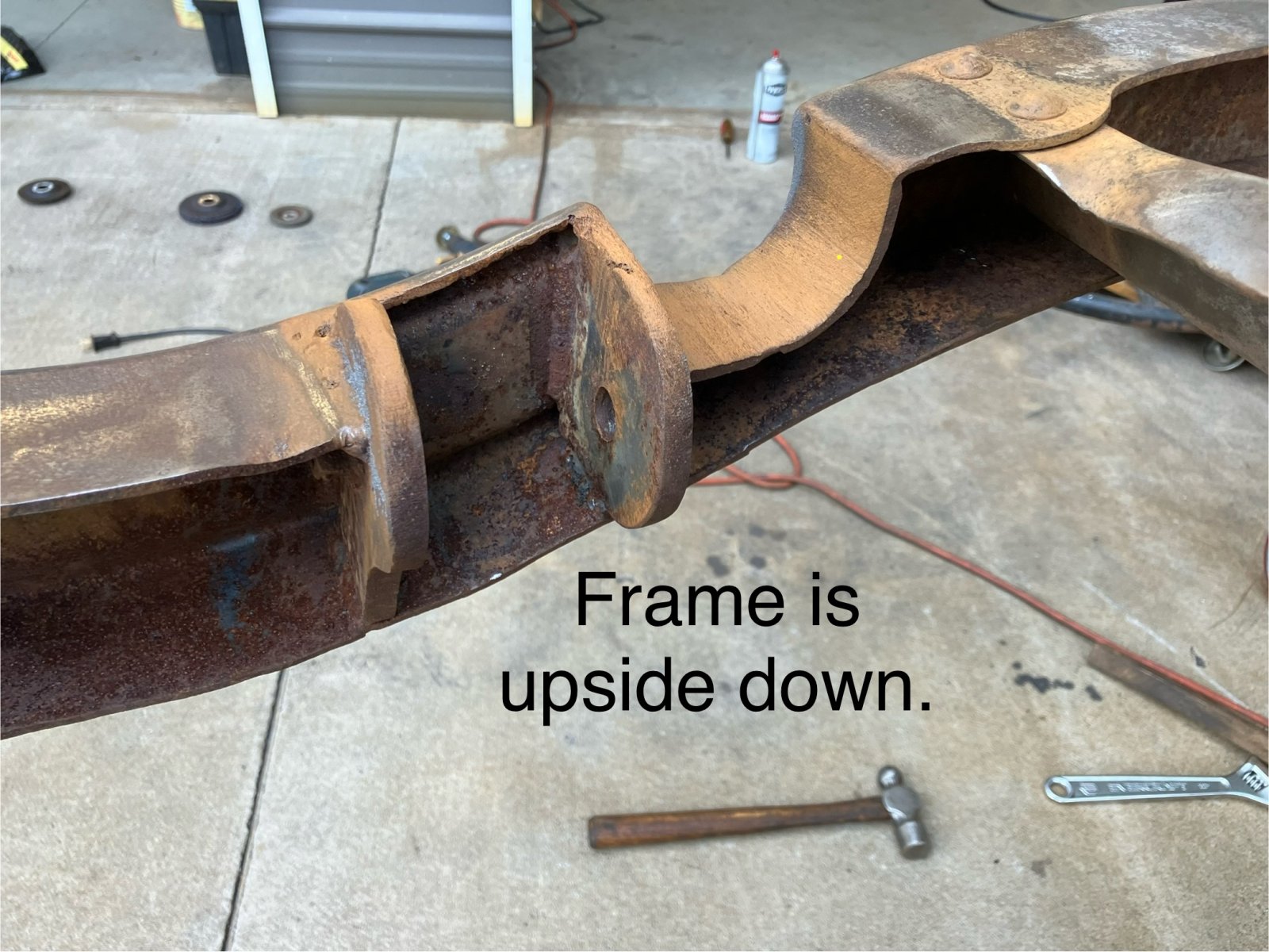

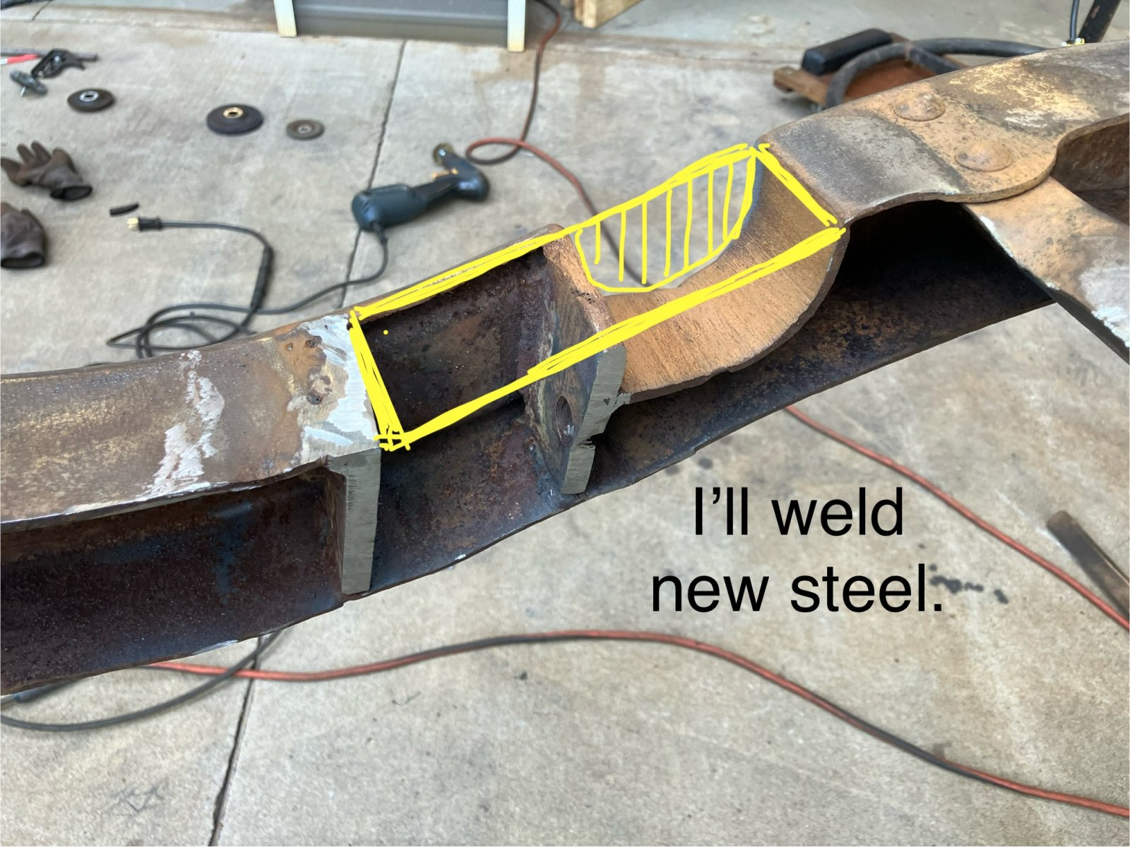

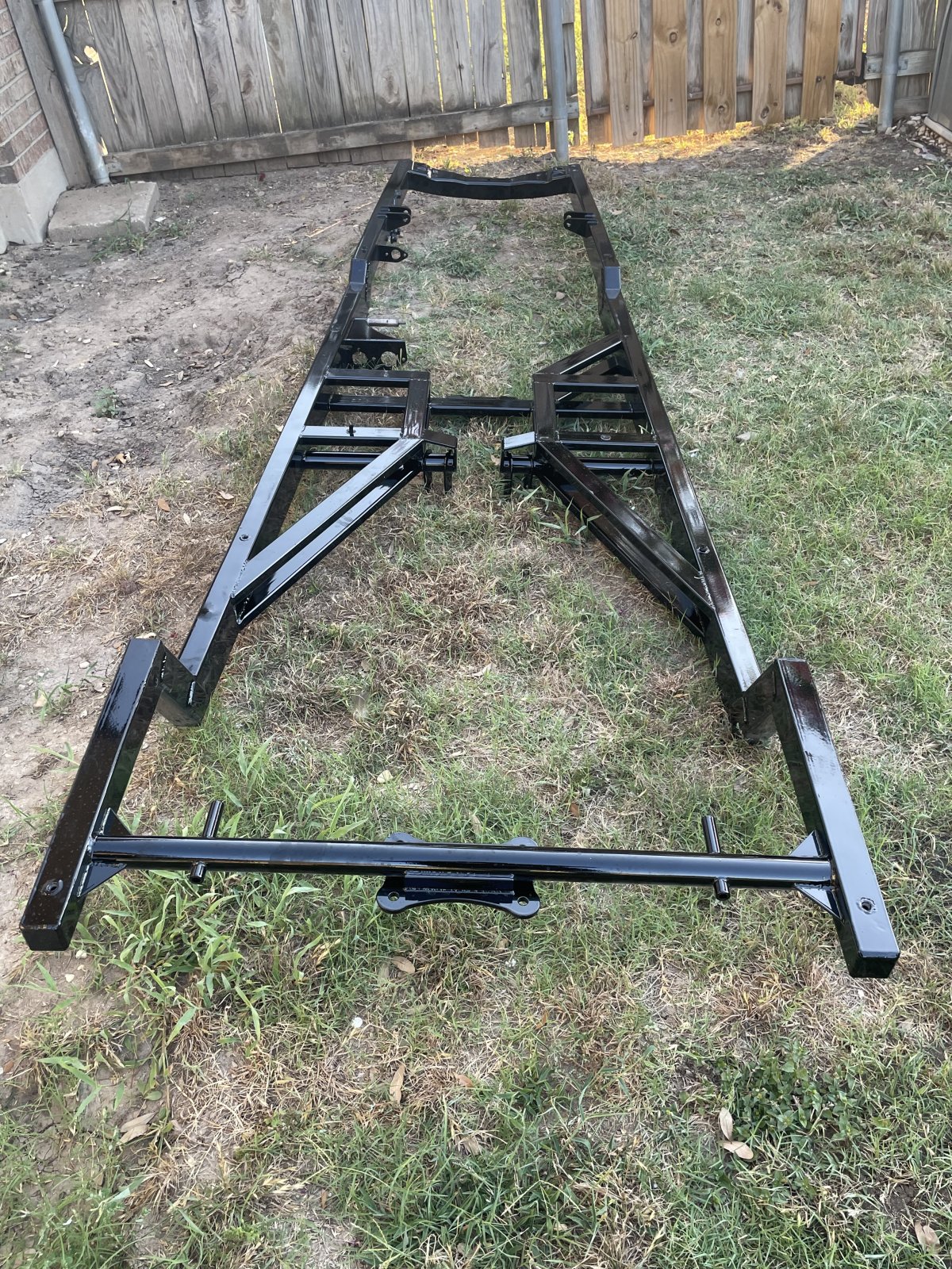

    Today was grunt work day. Nothing fun about it at all. The rotisserie made it more bearable. I cut out the frame modifications done by some previous owner. I’ll weld in new steel where they C notched the frame for the C4 rear axle that was installed.
    I was able to balance the frame on the rotisserie by flipping the front mount. With the front of the frame slightly below the axis of rotation and the rear slightly above, it’s perfectly balanced.

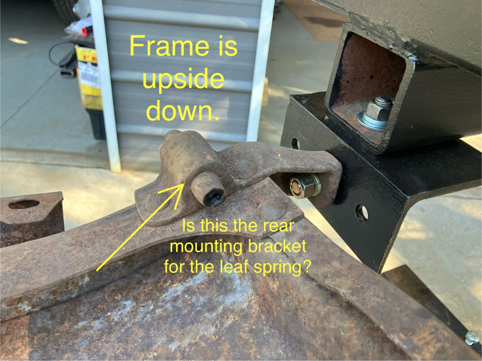

    I’m wondering if the rear bracket in the pics is for the leaf spring.
    Is that flat bracket for the fenders?
    IMG_6269.jpeg IMG_6270.jpeg IMG_6271.jpeg IMG_6248.jpeg IMG_6249.jpeg IMG_6245.jpeg IMG_6244.jpeg IMG_6268.jpeg

    Yes that is for the spring shackle. That center piece probably screws out if you can get it loose. The other bracket I don't know. Too new for me. :D

  17. Your better off removing those original brackets and purchasing a new rear leaf spring mount kit from Speedway or other suppliers:
    Adjustable Leaf Spring Perch, Pad, Shock Mount and U-Bolt Kit
    • Multiple adjustable keys are included which allow you to fine tune the position of your rear axle housing up to 1/4” forward or 1/4” rearward from center
    • Allows you to properly center the wheels and tires in the wheel well of your car or truck for maximum tire clearance
    • These leaf spring lower shock mounting plate is made from steel with a zinc finish
    • Speedway Motors Part #9100151 for $116.99
    Jay Altemus and Six Ball like this.

    the bracket in the rear is for both the rear splash apron and fender

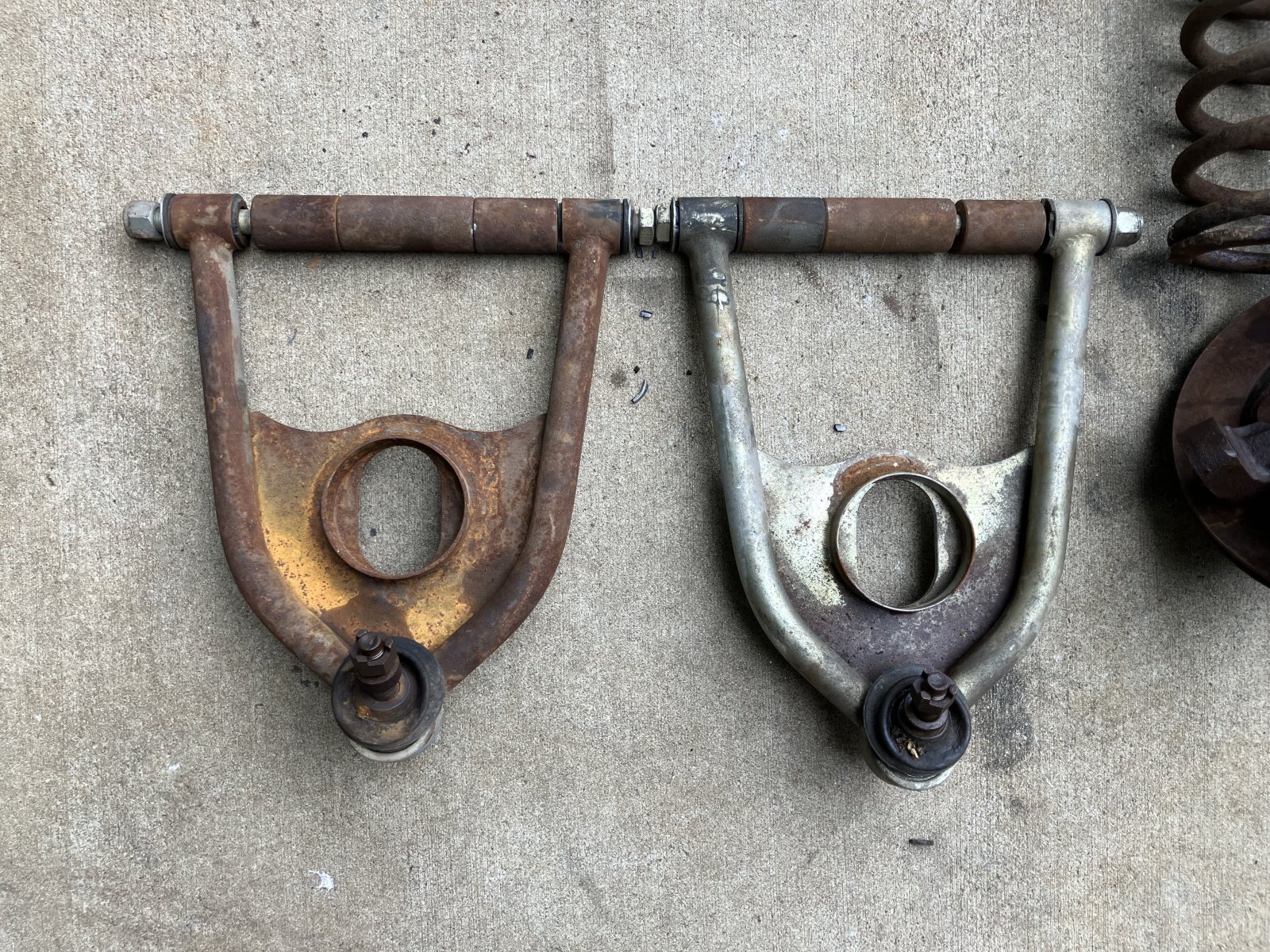

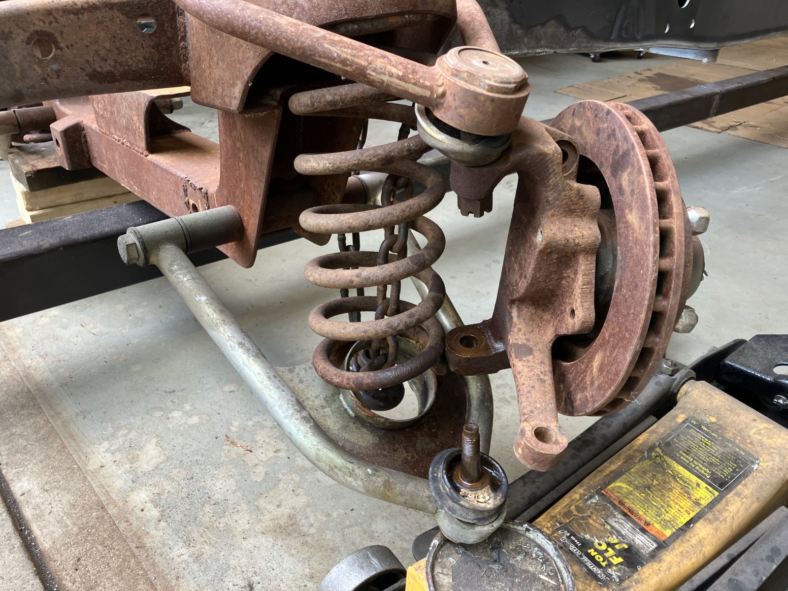

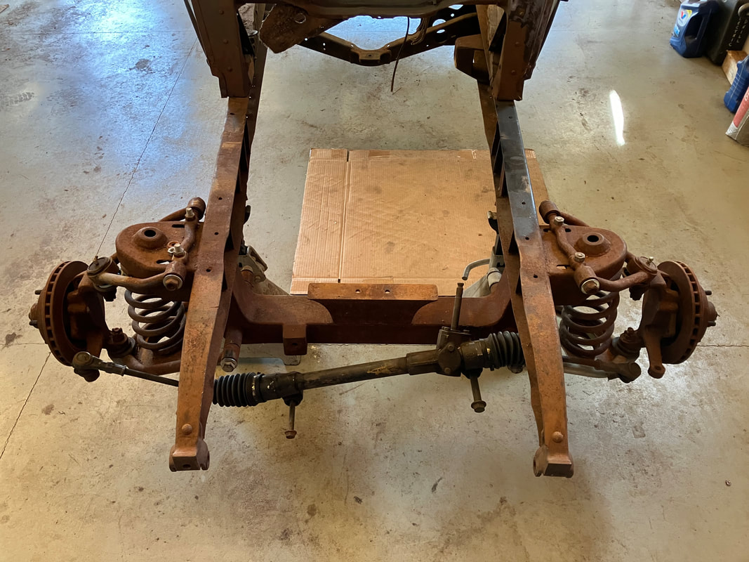

    The M2 front suspension is going bye-bye!
    Whoever bolted this on was either not paying attention, didn’t know what they were doing, or both. Maybe I should give them the benefit of the doubt and say they were just mocking up suspension so they could move the vehicle. I don’t know, but long before today I figured out why the p***enger side tire had positive camber. It has a shorter lower control arm.

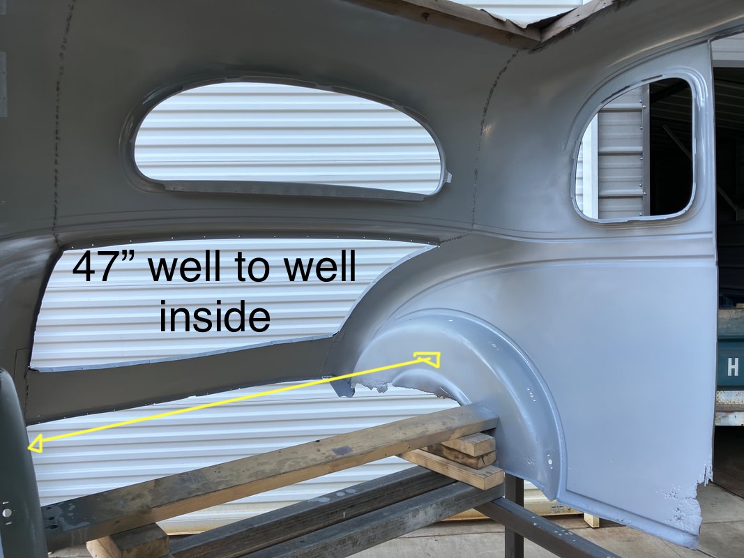

    I’ll start looking for a 10 bolt rear axle (or other) that has a wheel mounting surface width of approximately 62.5 inches. Something with a 3.08 gear would be nice.
    I measured between the rear wheel wells. I got 47” – 49”. My wheels with tires mounted need at least 5 inches of backspacing. That brings me to right about 59”. Add a few inches for axle movement.

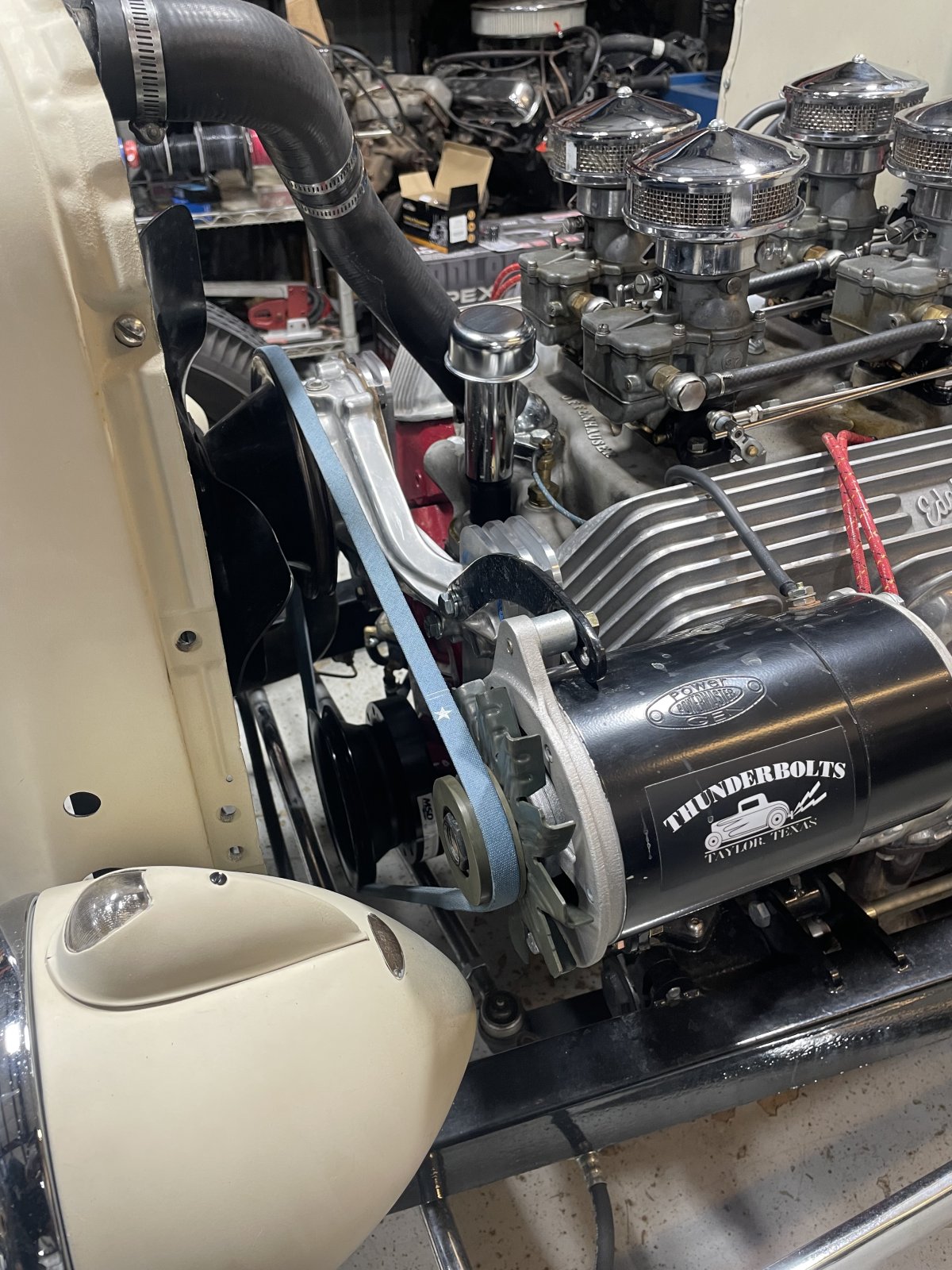

  22. Hey brother, you haven't got back to us about your '09 engine temps with your new spacers - any improvement on the road?

    few of us went on a short cruise this weekend and it held up well in 100+ temps. I think the main issue I always had was at a standstill which most cars do with no shroud. But now it takes a lot longer to raise temps; and the fan is closer and higher. When really beating on the engine I'm around 180-190; just putting around 170ish.
