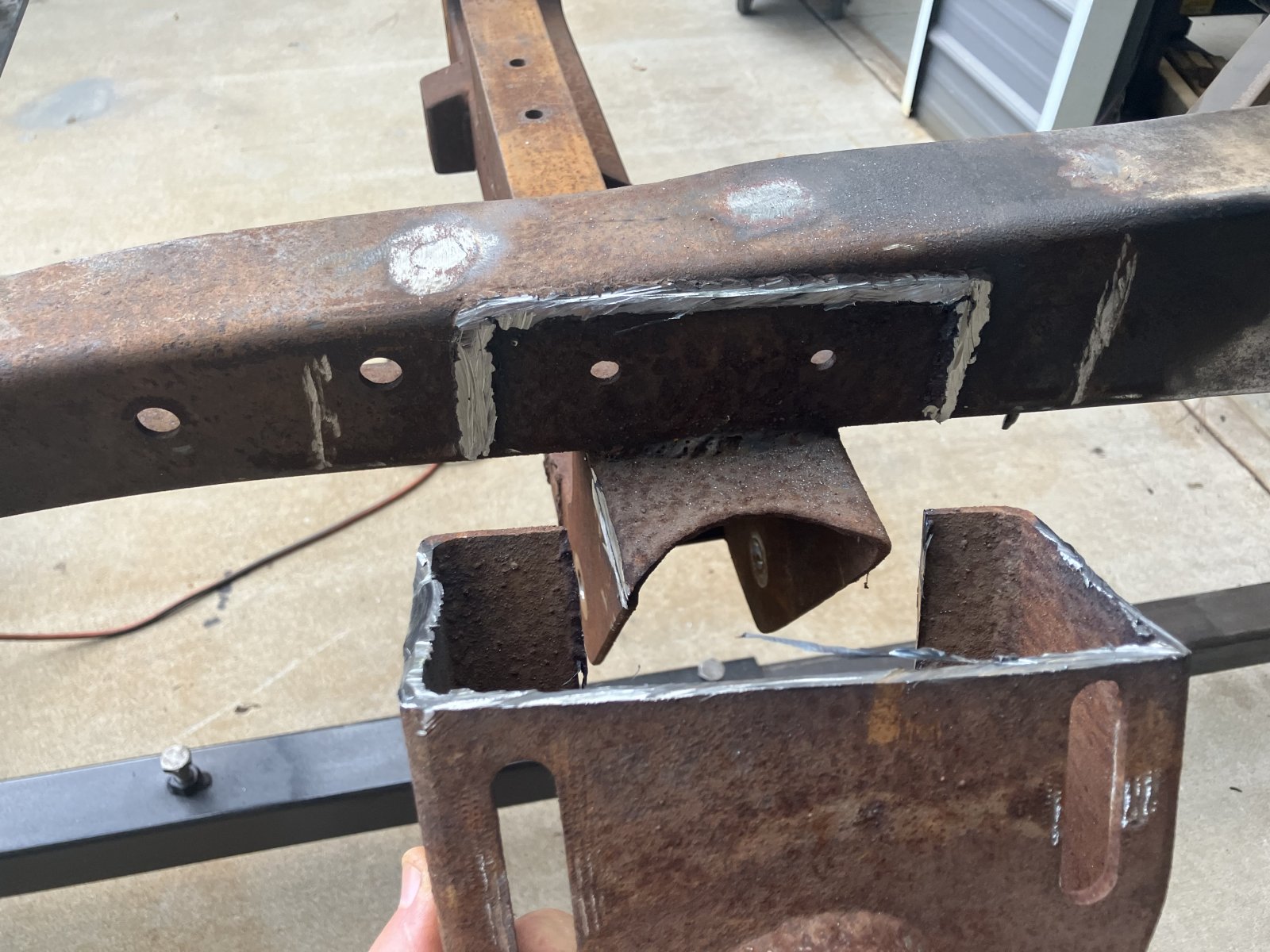

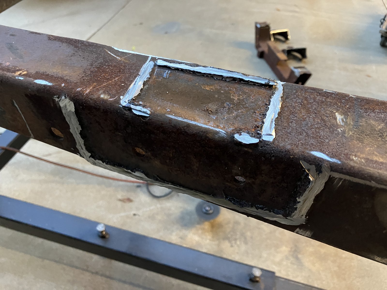

    Can you tell I’m working hard?
    Tonight after work I removed the final pieces of the Mustang ll suspension. I was very, very careful not to cut into the frame. The frame was a little “wiggly“ even BEFORE I removed that front crossmember. It’s a lot worse now, so I have to be very careful.
    After I finish media blasting the frame, I’ll take the frame off the rotisserie and put it on supports and square it up. Then add more temporary bracing. Then I’ll box the frame.
    I’m looking for advice about boxing the frame. (Specifically, how to position the plates in relation to the frame flanges.)

    Jay, excellent work! Wondering if you settled on the early Ford style front end with the springs on the top of the axle? If you did, you may need to extend the end length of the crossmember a few inches. My '31 Chevy frame is wider than the Ford crossmember, possibly your frame may be the same as mine, you'll see down the road. It's up to you, but I would recommend that you extend the width of the crossmember so it locks into the channel until it meets the vertical area of your frame for extra strength. You need not to be concerned with caster angle because it's built in to the Ford crossmember at 7 degrees (at least on mine).

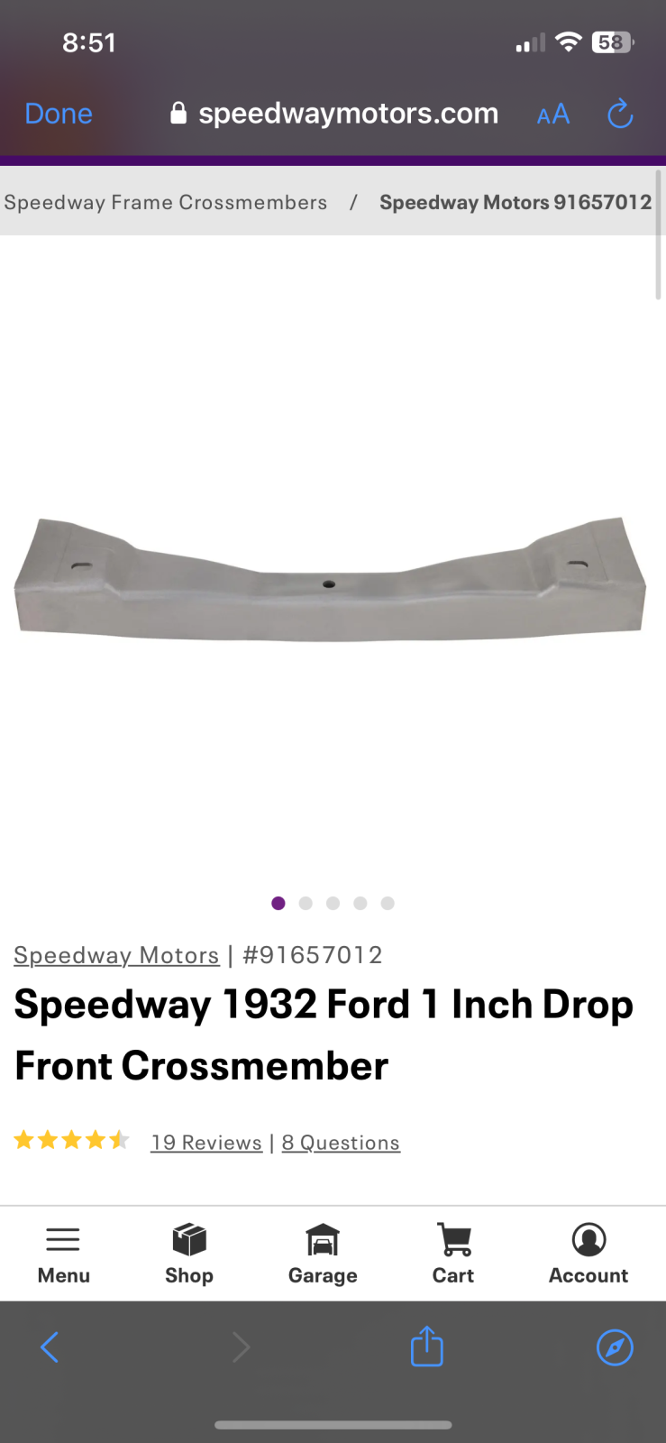

  3. Jay Altemus
    Joined: Dec 24, 2023
    Posts: 186
    Jay Altemus
    Are you saying THIS crossmember will not be wide enough to fit my 34 frame?

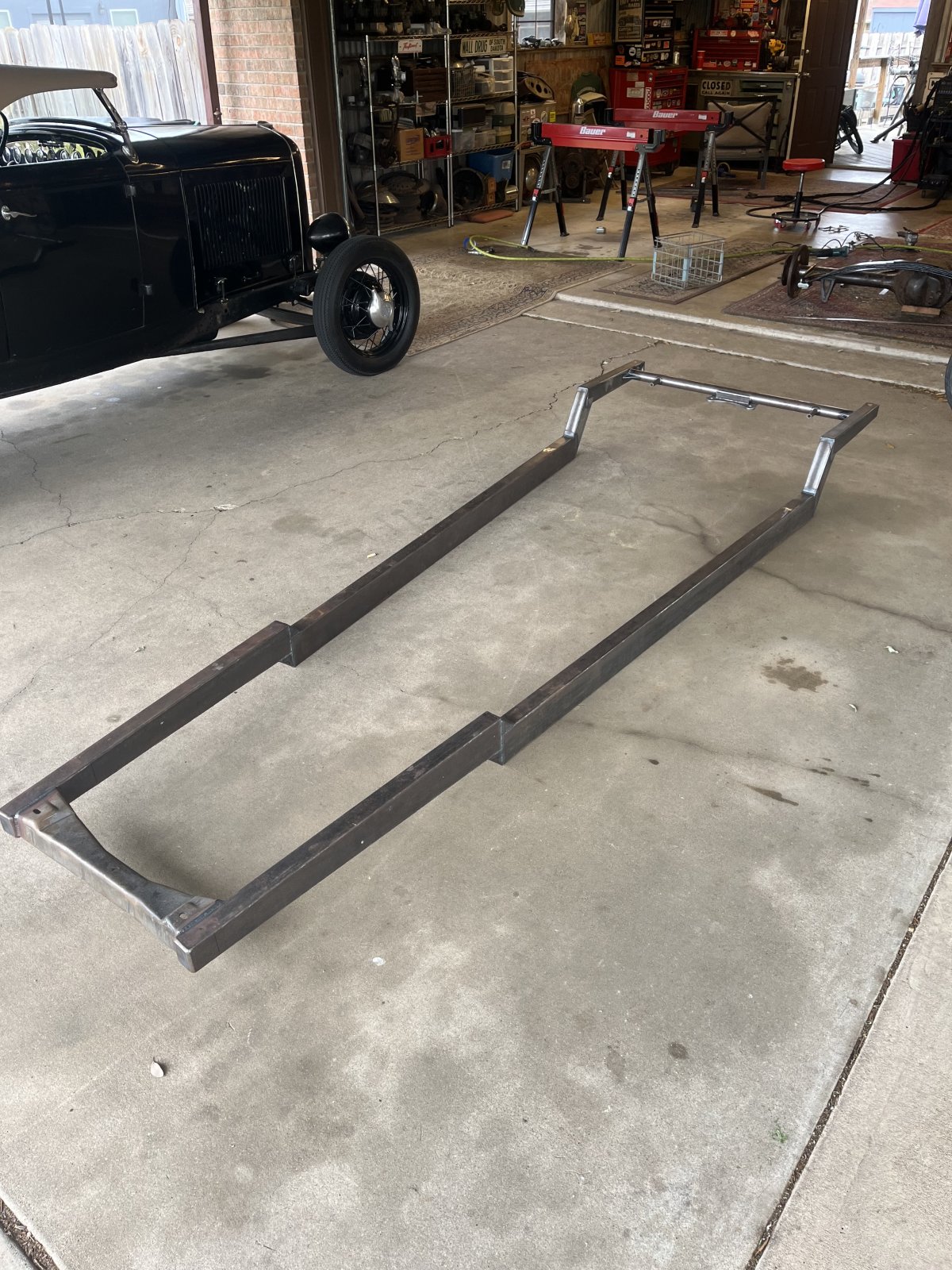

    since I built my frame it was just easier to go that route
    Six Ball and 31chevymike like this.
  10. 31chevymike
    Joined: Feb 9, 2008
    Posts: 1,441
    31chevymike

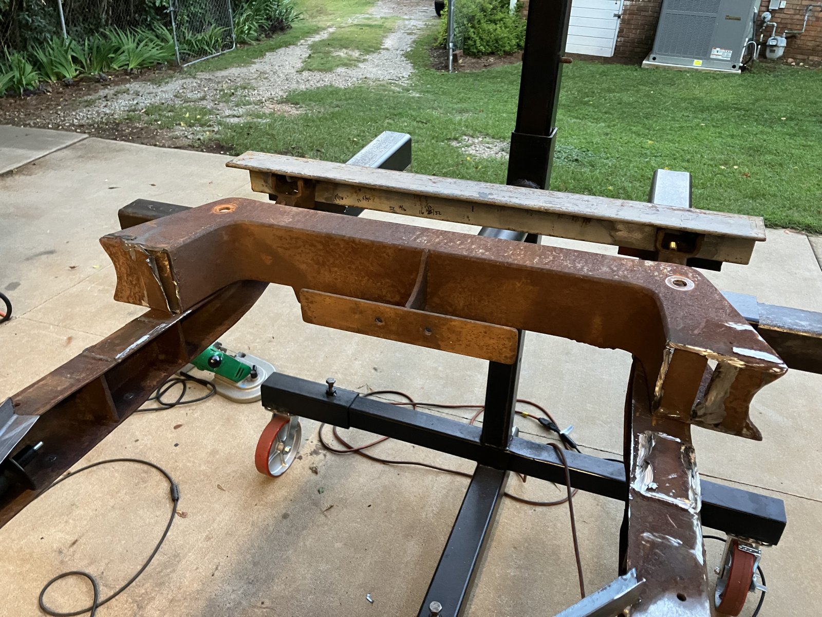

    I caught my error Jay; I meant to say that our frames are wider than the Ford crossmember. Without knowing what width your frame is where your old crossmember was, I'm betting your frame is wider than the Ford crossmember, like mine. Check your width to see where you're at. I locked my crossmember completely into the C channel once I had added a few inches to my crossmember. You don't have to if you plan to weld yours directly to your boxed frame rails - choice is yours. Here are some specs on an example of an early Ford front crossmember from Speedway:

    I believe you have two choices - you can either "step box" them by positioning the boxing plates about a 3/8" or so inward from the top and bottom of the C channel to allow for running your brake/fuel/wiring, etc. Or make the boxing plates flush with the top and bottom C channel. Your chassis book will explain this in much more detail.

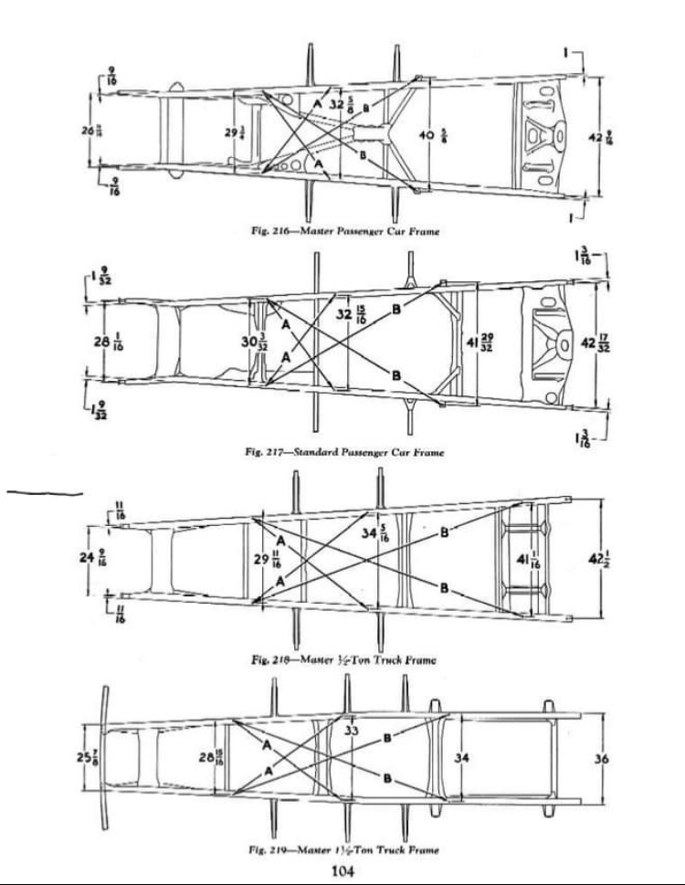

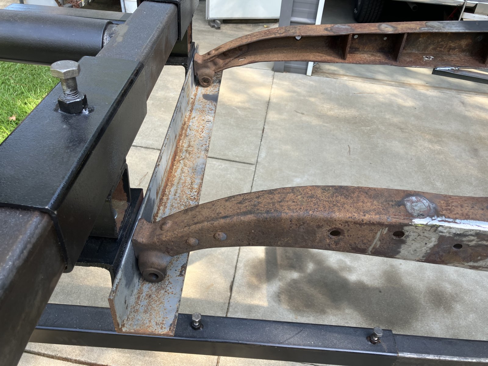

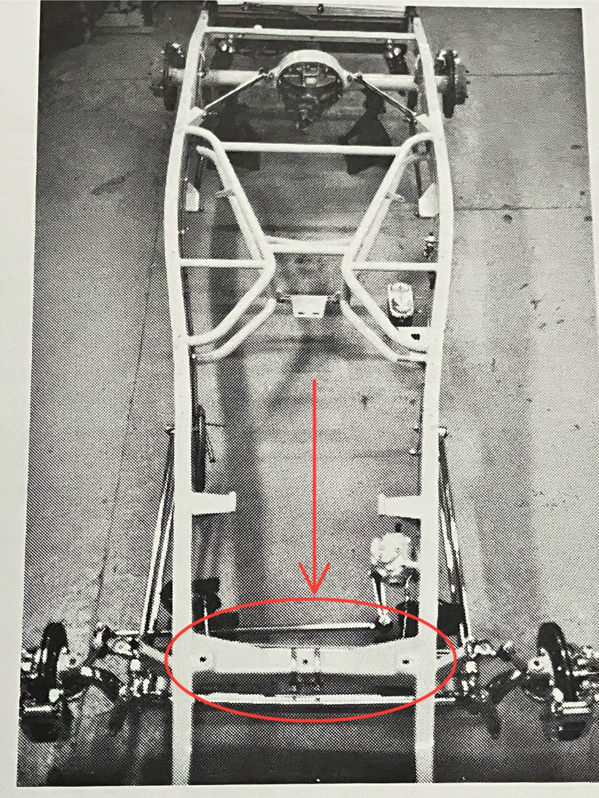

    Before I mounted the frame on the rotisserie, I bolted a brace of heavy steel across the front frame horns to lock them in place. See picture.
    I wanted to keep it from spreading because I was going to remove the front crossmember.

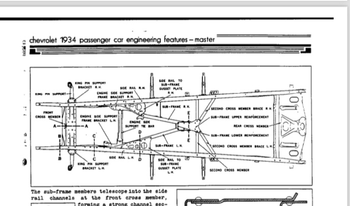

    Since then, someone sent me a schematic drawing (first one) showing measurements of different frames, (but please note that nowhere on the drawing does it indicate what year we are looking at). It’s possible that this frame is not for a 1934 Chevy Master coupe. However, I think there is strong evidence that it is. The rear crossmember looks exactly like the schematic drawing for a Master. The 2nd drawing is from GM archives info for a 1934 Master but doesn’t show dimensions.
    I think some of my measurements don’t match the schematic drawing because prior owners pinched the frame to install the Mustang ll front crossmember. The width at the rear of the frame matches the diagram, but the front of the frame doesn’t match.
    That being said, what would you do with the frame at this point? Would you try and return the dimensions to the original? IMG_6350.jpeg IMG_6349.jpeg IMG_6351.jpeg IMG_6083.jpeg

    yeah just stitched them to the rails. Originally I was going to run model a horns so I could run a fog light but that changed.. looked cleaner without
    31chevymike and Six Ball like this.
  17. 31chevymike
    Joined: Feb 9, 2008
    Posts: 1,441
    31chevymike
    Jay, your frame is in GREAT condition... The most important factor here is that you have a nice steel body that bolts down to your straight frame. Returning your frame dimensions back to original makes no sense, more so that you are focusing on building a traditional hot rod. Looking at your frame in the front, you will need to grind down those original rivets that hold the leaf spring mounts and punch them out to remove them. Honestly, I would save them in case someone "tiquers" may have a use for them. Remove the rear leaf spring mounts for the front springs as well. I hope you have the steel apron for your gas tank. I just searched the net to find a "Master" steel tank and been coming up short for the most part. Holy Christ - I did find a stainless steel tank for a '34 Master and wait for it... $1,200!!!

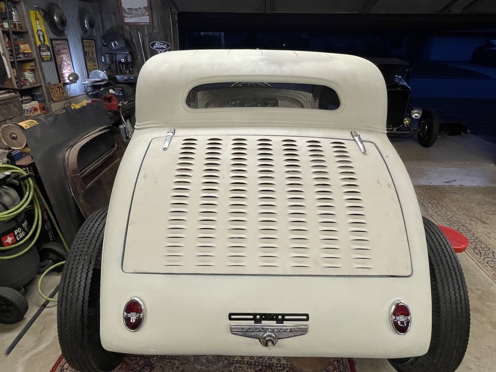

    That rear end is awful wide for a '34. I have a 2 wheel drive S10 under my '34 Master. It barely fits 9 inch rims inside the fenders. Too wide of a rear end on a fender less ride puts the tires too far from the body IMO.
    Six Ball and snoop74 like this.

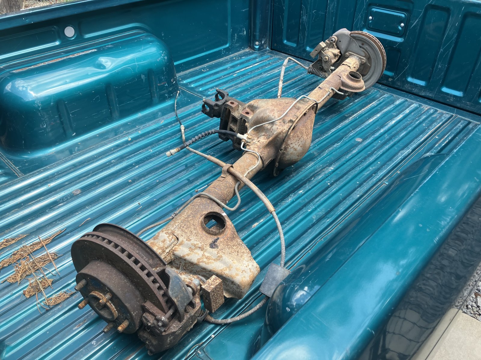

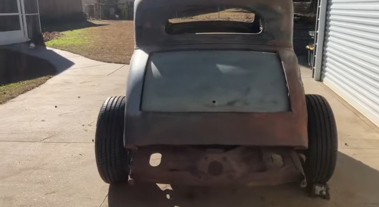

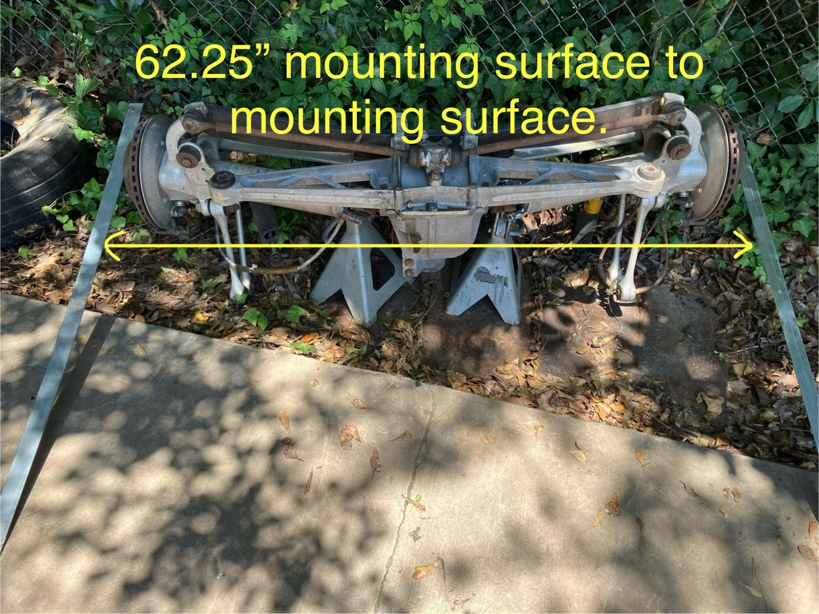

    It depends on backspacing. My wheels have 4.25” of backspacing and with tires mounted it comes to 5”.
    Here are 2 pictures of my 34 when it still had the Corvette C4 rear axle with a 62.25” WMS width. I thought it looked fine. If I think this rear axle is too wide, I can get something else later. https://youtu.be/SbTOs_mFW0o?si=2EUD5AnAdDBR6U4o

    Wheel backspacing is a very important factor.
    Snoop, Would you mind measuring the width from inside one rear TIRE to the opposite TIRE? Based on pictures you shared, I’d say your wheels don’t have as much backspacing as mine. Just sayin’.
    31chevymike likes this.
  30. snoop74
    Joined: May 29, 2022
    Posts: 346
    snoop74
    Jay from inside tire to tire it’s about 53 inches.
    I’m running 40 wheels on the front and back. 16x4.5 on the rear and 16x4 on the front.
