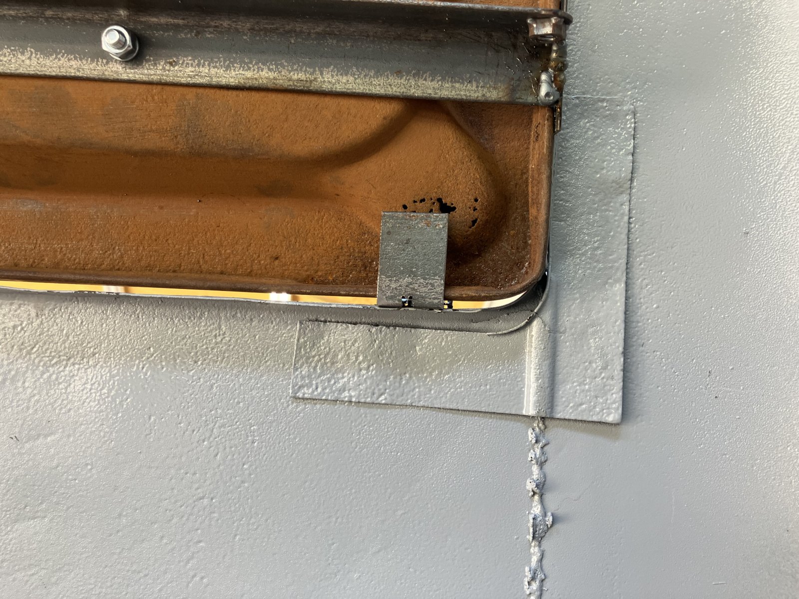

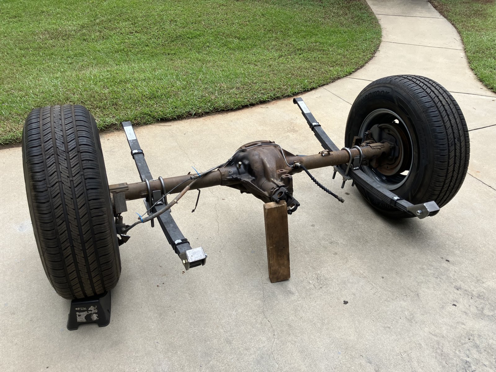

    Question:
    Do the leaf springs need to be mounted perfectly parallel?
    My frame is slightly more narrow where the front brackets mount, so it might be good to make an outrigger bracket to keep the spring mounts the same width front and back.
    Mocked up rear axle and suspension today. Just a test fit. I’ll call Posies Monday to figure out the orientation of this shackle bracket. Not sure if I’m holding the driver or p***enger side in the last pic. Not sure I’ll even need them.

    @Jay Altemus I measured my 33 and the front of the springs measure 38" outside to outside and the rear measures 44.5". So the answer to your question is they don't need to be parallel. Here's a pic that shows it the best I can. Rear Leaf Springs.jpg

    The springs don't need to be parallel but I think the shackle bores do. Just a matter of aligning the perches.
    Jay Altemus and TFoch like this.

    I agree 100%. That was my plan.

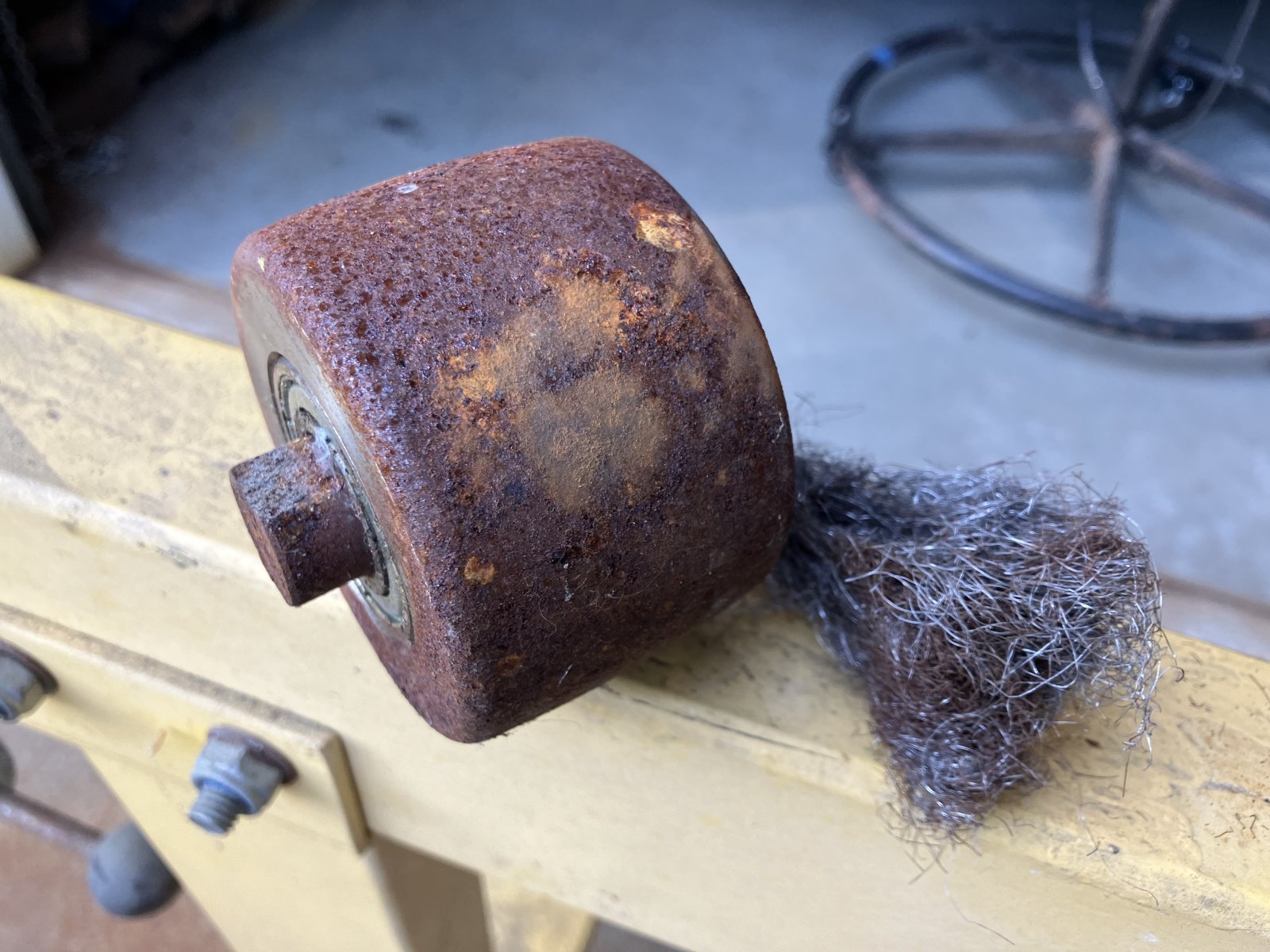

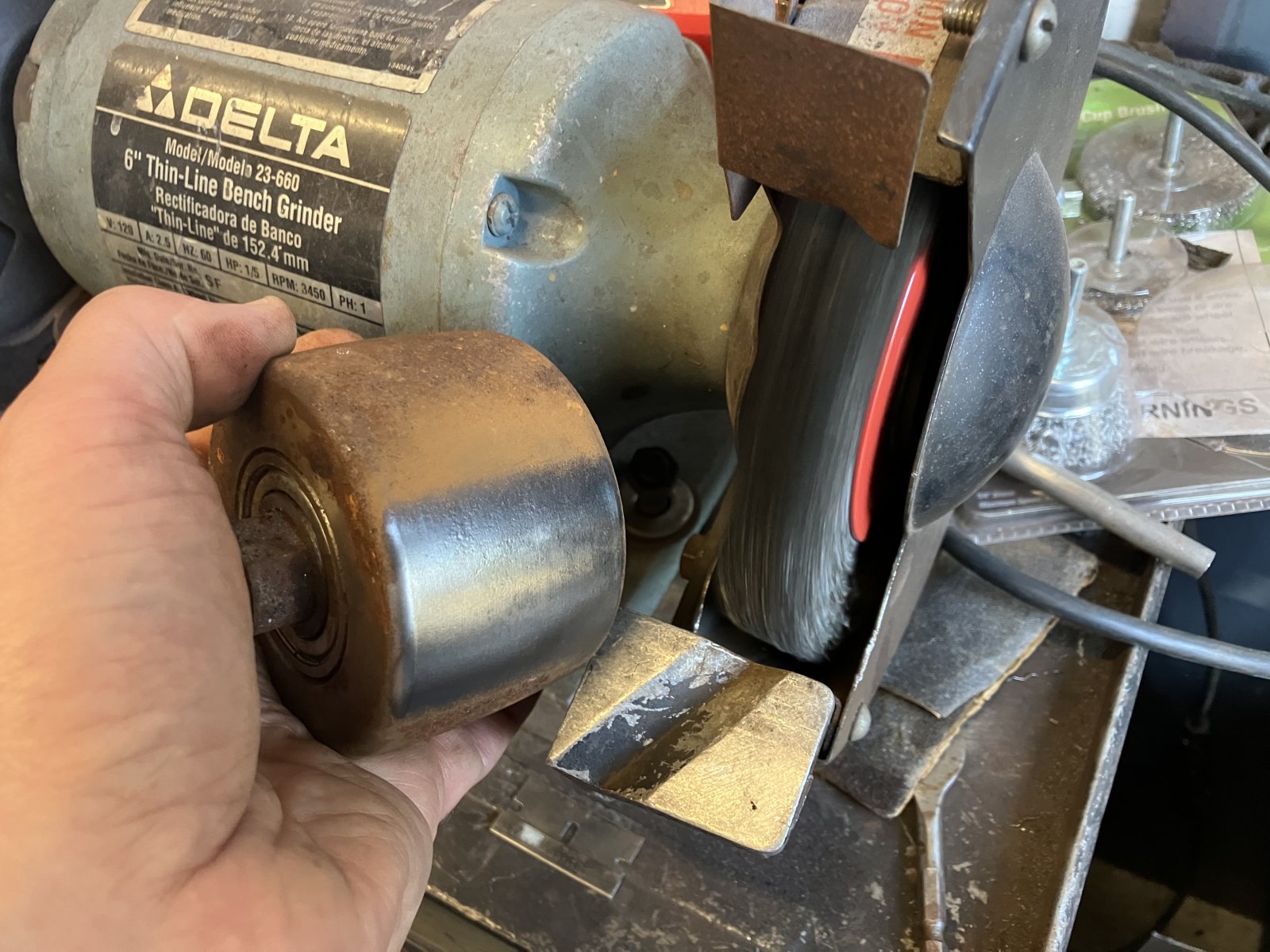

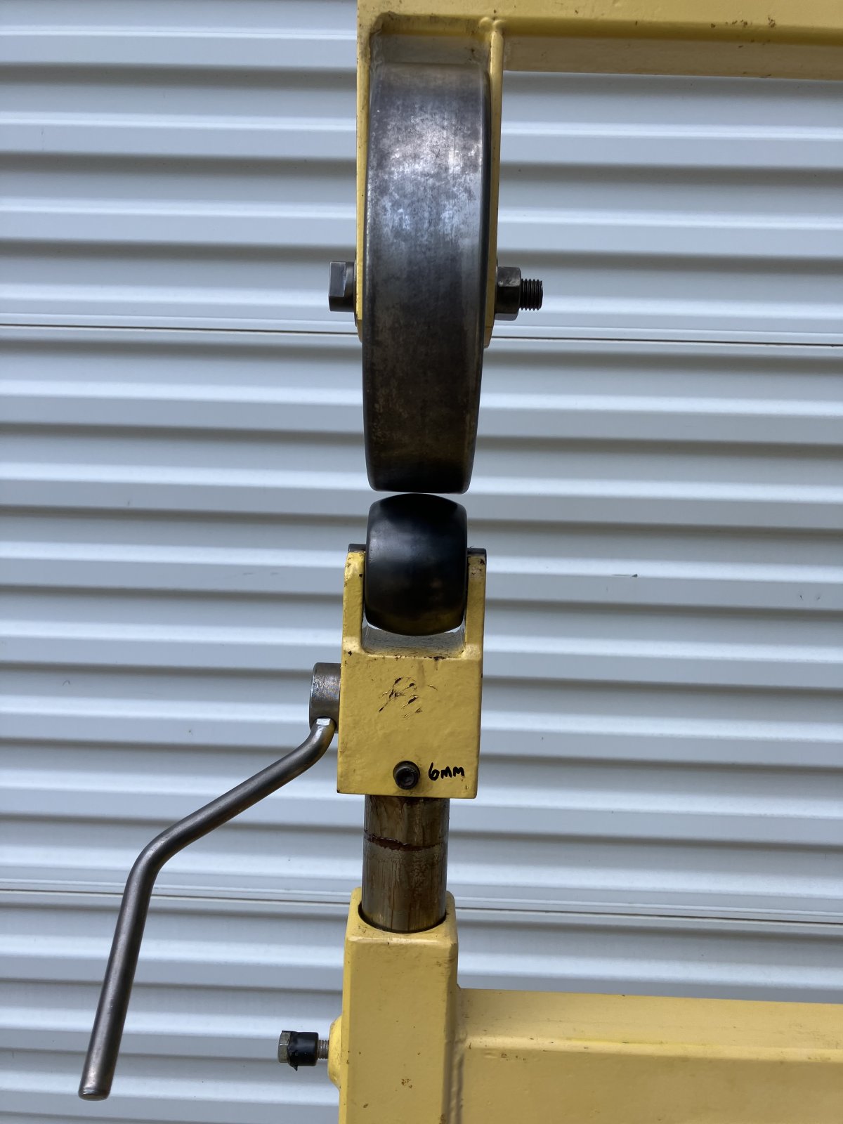

    A few diversions have slowed my progress. My youngest son is visiting this week, and I bought a used derelict English wheel that badly needed cleaning.
    Finished cleaning up the English wheel tonight. It’s ready for service but I still need to find a way to move it around easily.

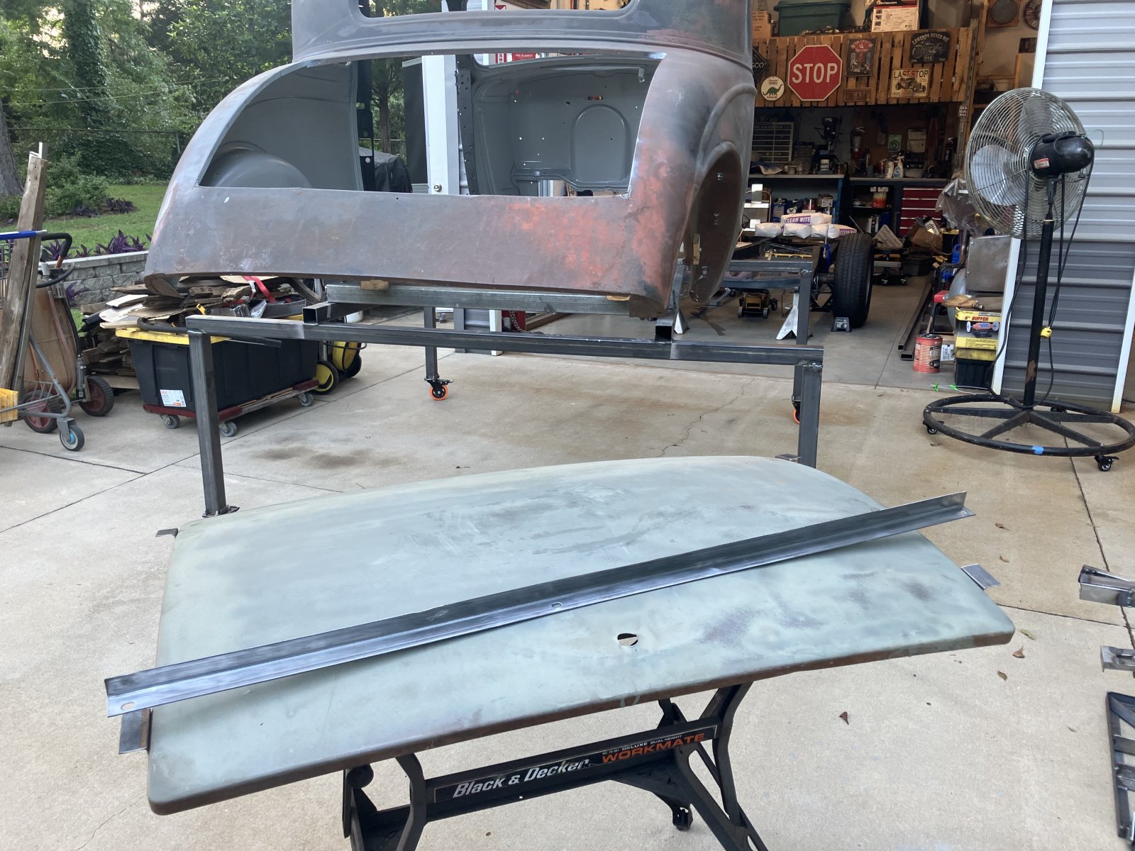

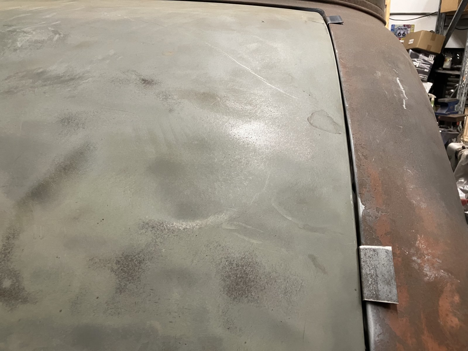

    Before I set the body on the frame, I need to add some sort of structural bracing to the horizontal body panel right below the deck lid. It’s really floppy. So tonight I fabricated a simple hanger support for the deck lid so it stays in place without falling down through the hole.
    Now I can see what shape to make the bracing for that lower panel.

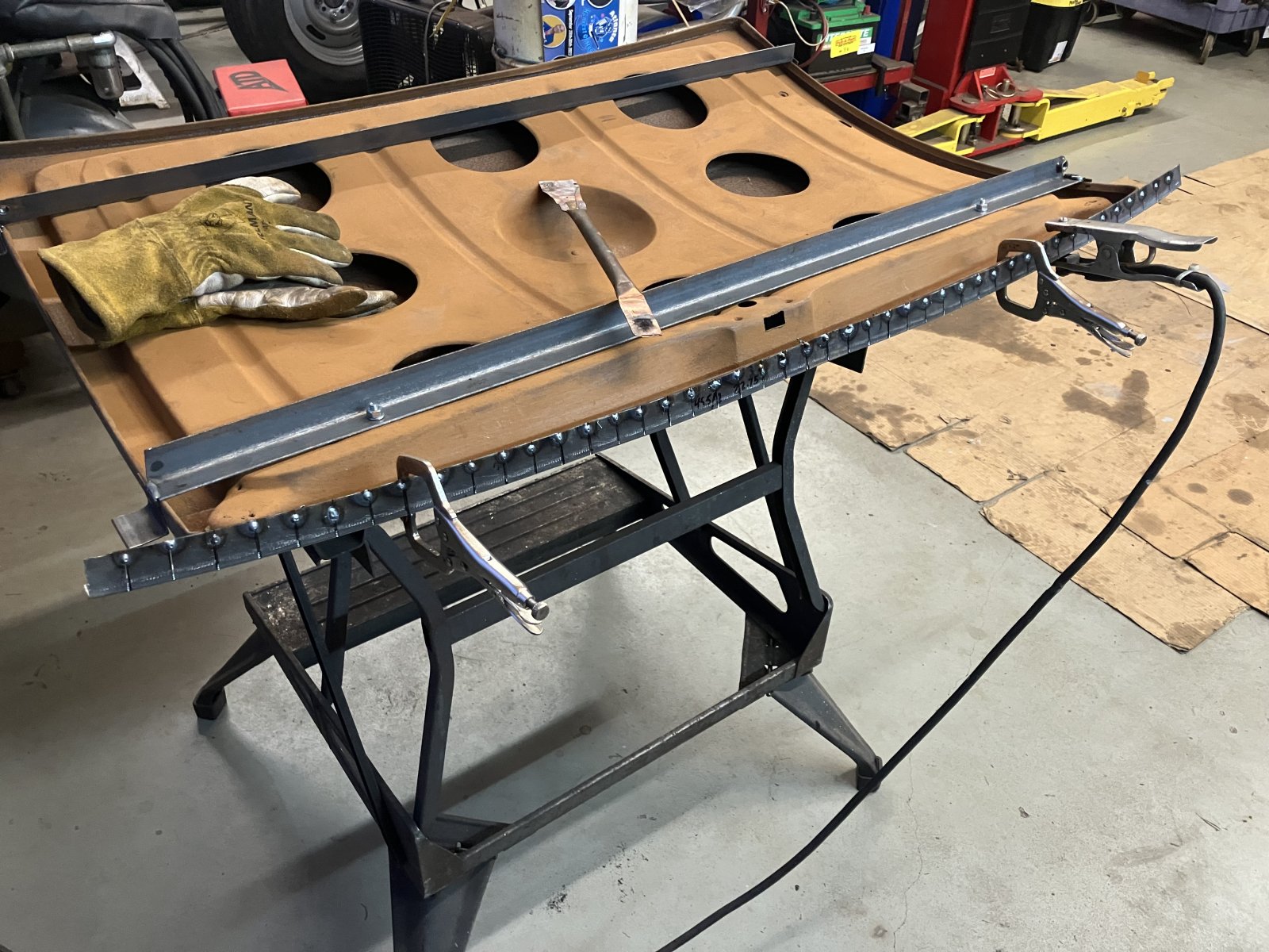

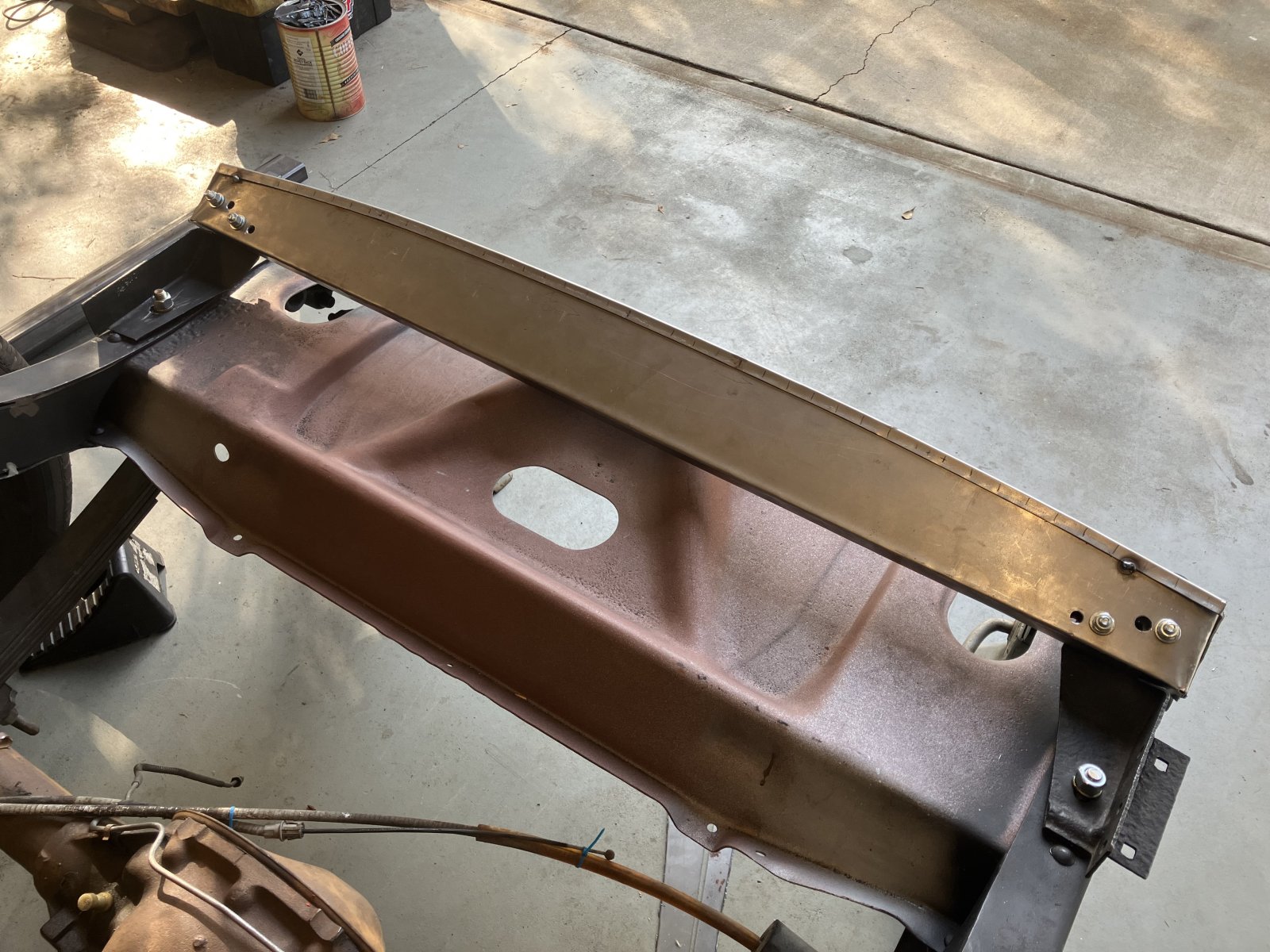

    Tonight was a flop. I’ll need to use thicker gauge steel next attempt. Either that or just fabricate the whole panel with new steel.
    Made a brace with angle iron tonight. Too thick for the shrinker so I made relief cuts to shape it then tack welded to retain the curved shape. Alas, the brace piece isn’t stiff enough to hold the panel in the proper shape.

    If you welded a piece of round stock along the edge or in the angle?

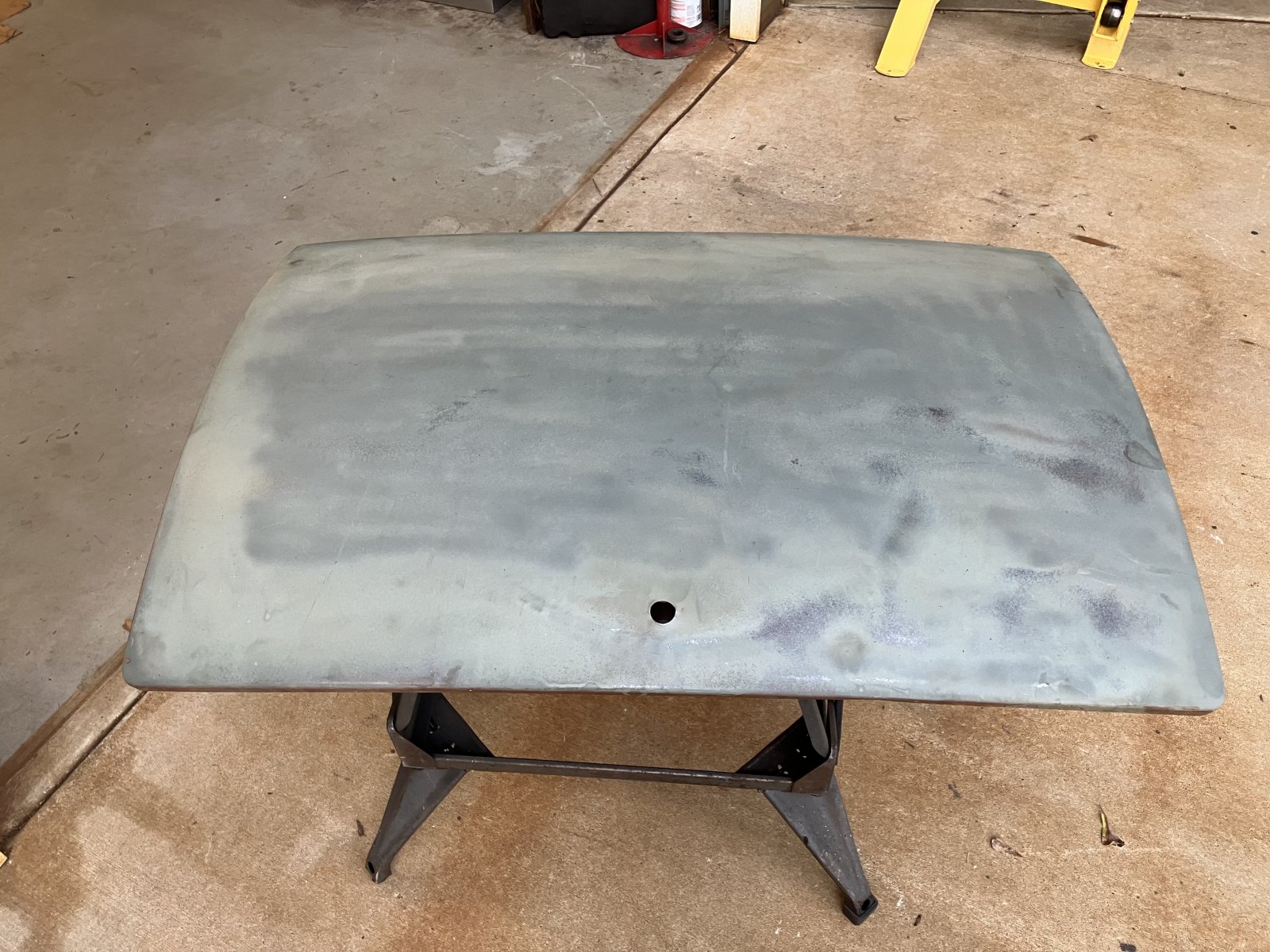

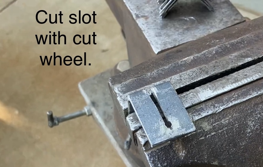

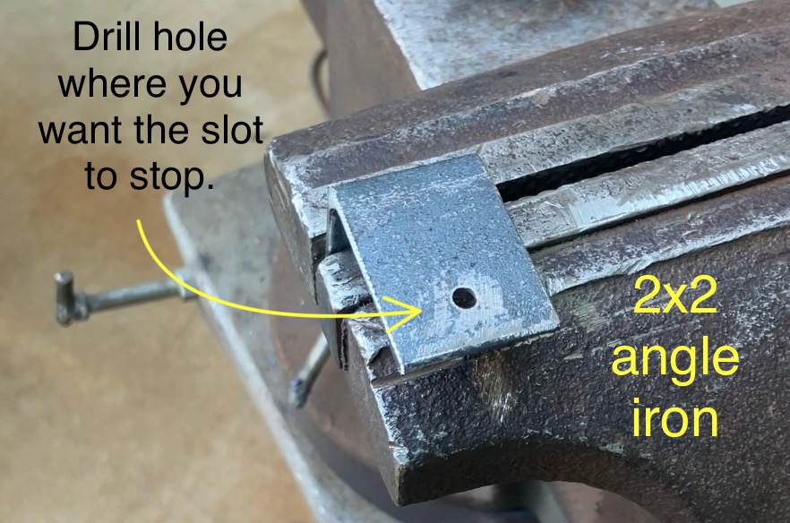

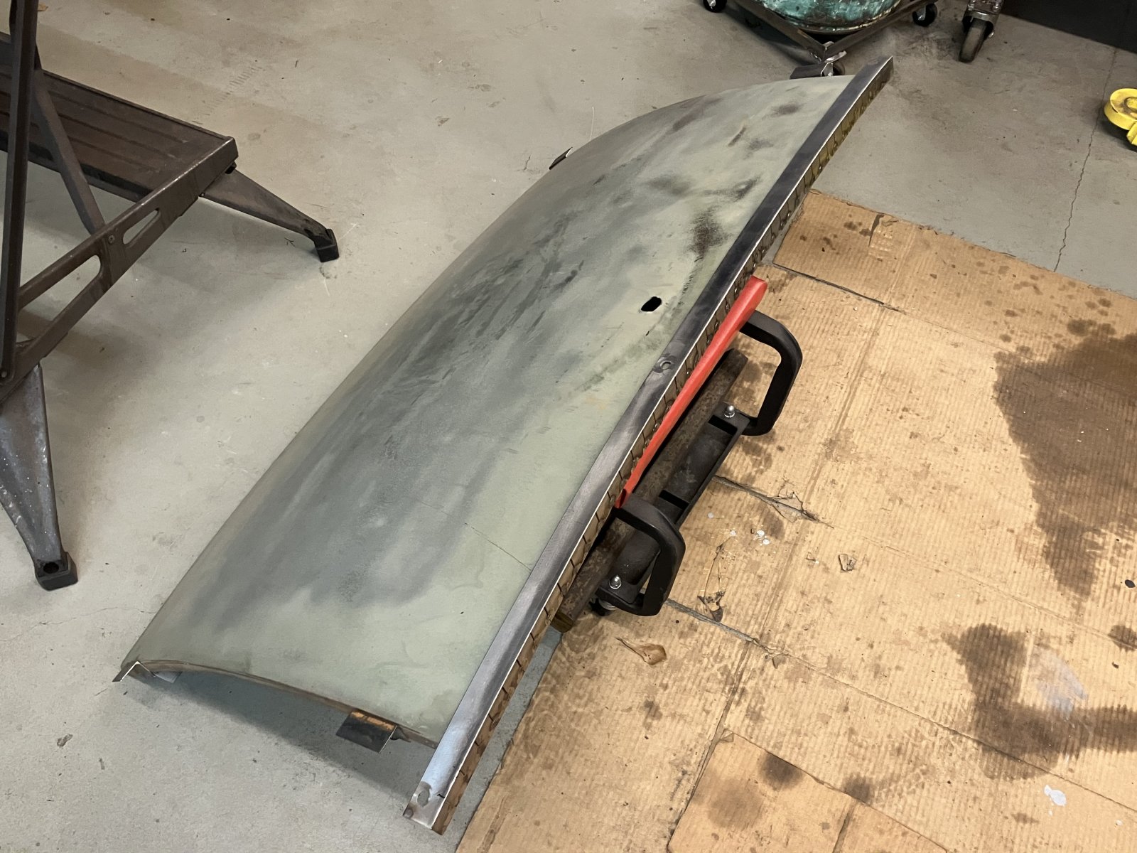

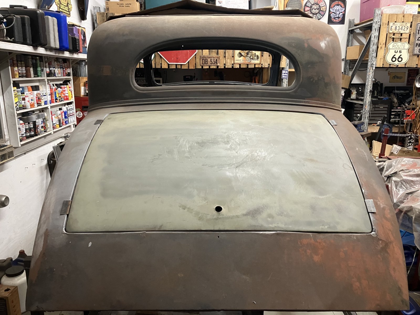

    Current problem solved. I now have the deck lid properly aligned. Here’s a video I made explaining how I made a few simple alignment jigs. Now that I have it properly shaped, I’ll add some bracing to keep it that way.
    VIDEO LINK

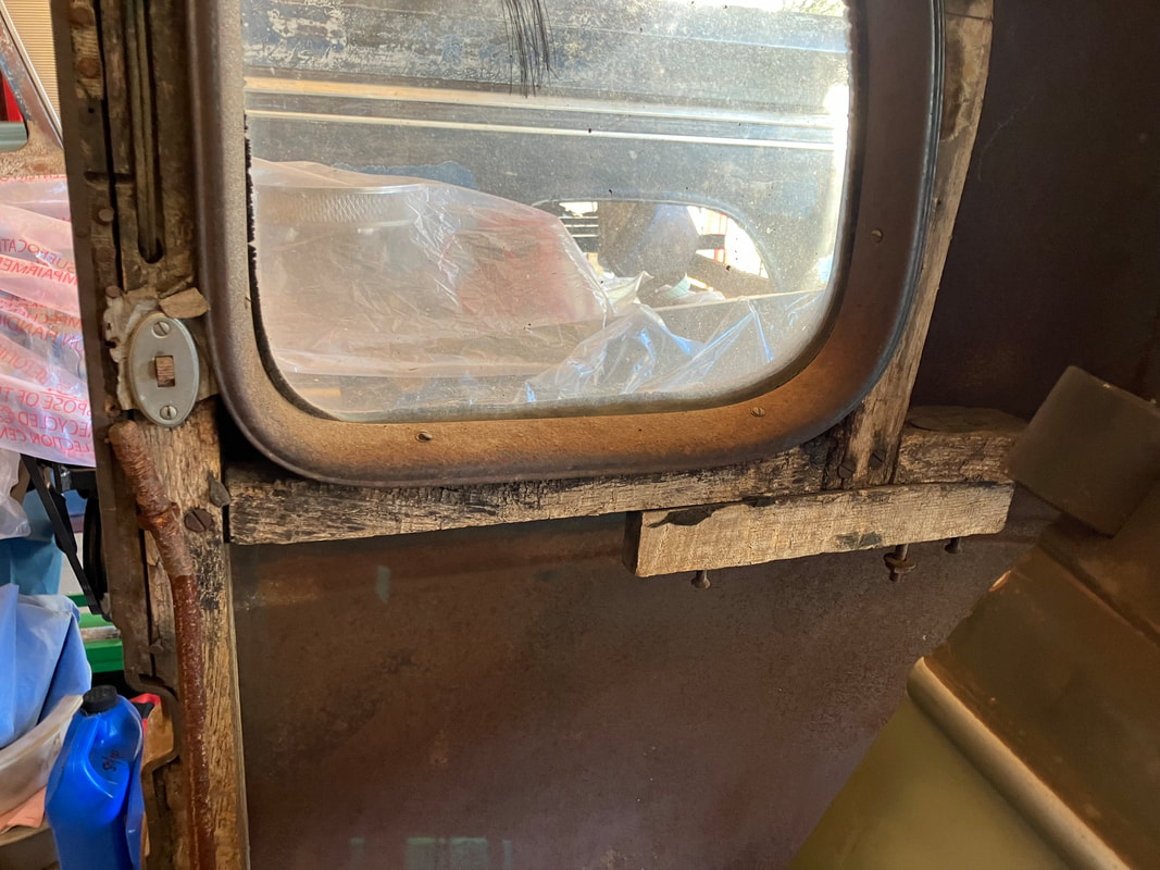

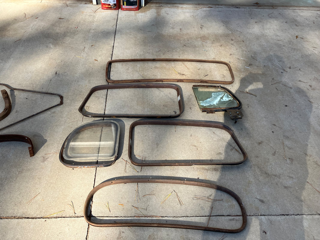

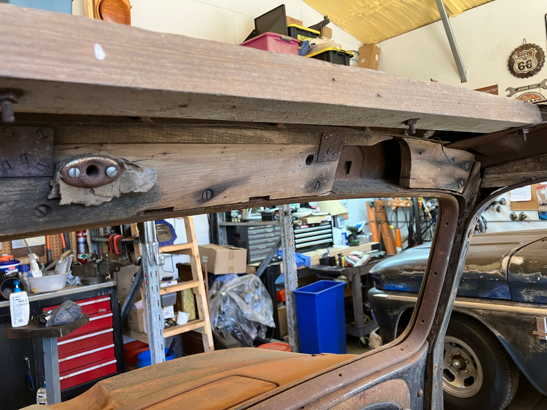

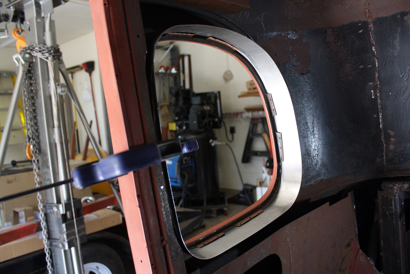

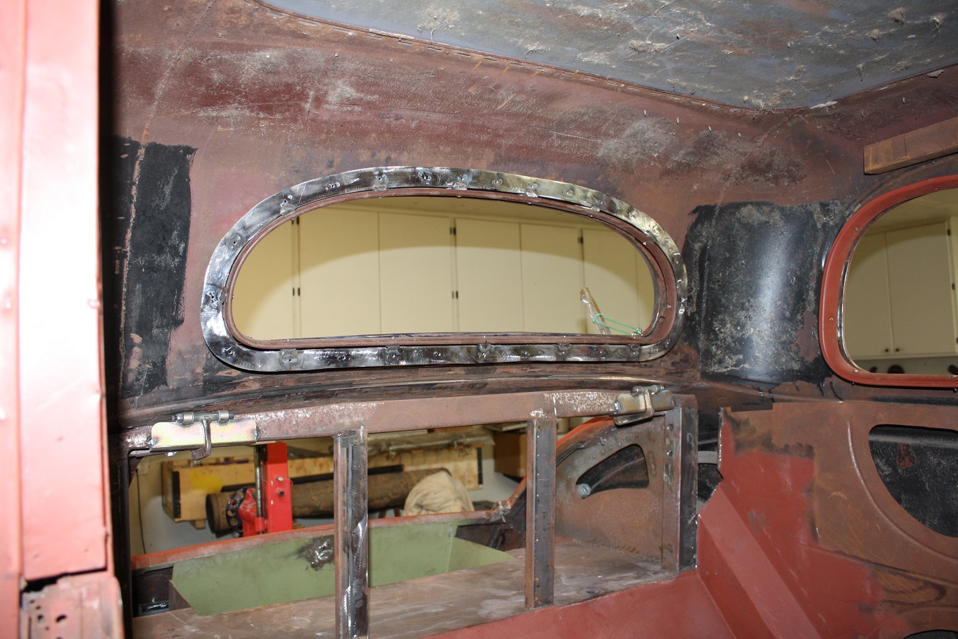

    Jay- question for ya. I remember you blowing your car apart and it had the garnish molding. Did it all screw directly to wood? Or was it wood and metal ? Trying to figure out if there was holes in my doors and if they were tacked up
    31chevymike and Jay Altemus like this.

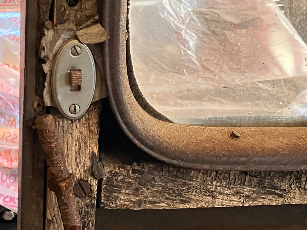

    These are the pictures I can find quickly. I’ll look for more. The quarter window garnish looks like it was nailed to the wood. The inside windshield garnish was screwed down. The rear garnish was already removed and wood was gone IIRC.
    Door garnish looks like nails as well.

  16. snoop74
    Joined: May 29, 2022
    Posts: 417
    snoop74
    That’ll work for me. All the wood has been replaced on mine, but you can see where the tack strip would be. May be easier to just screw it into small pieces of wood

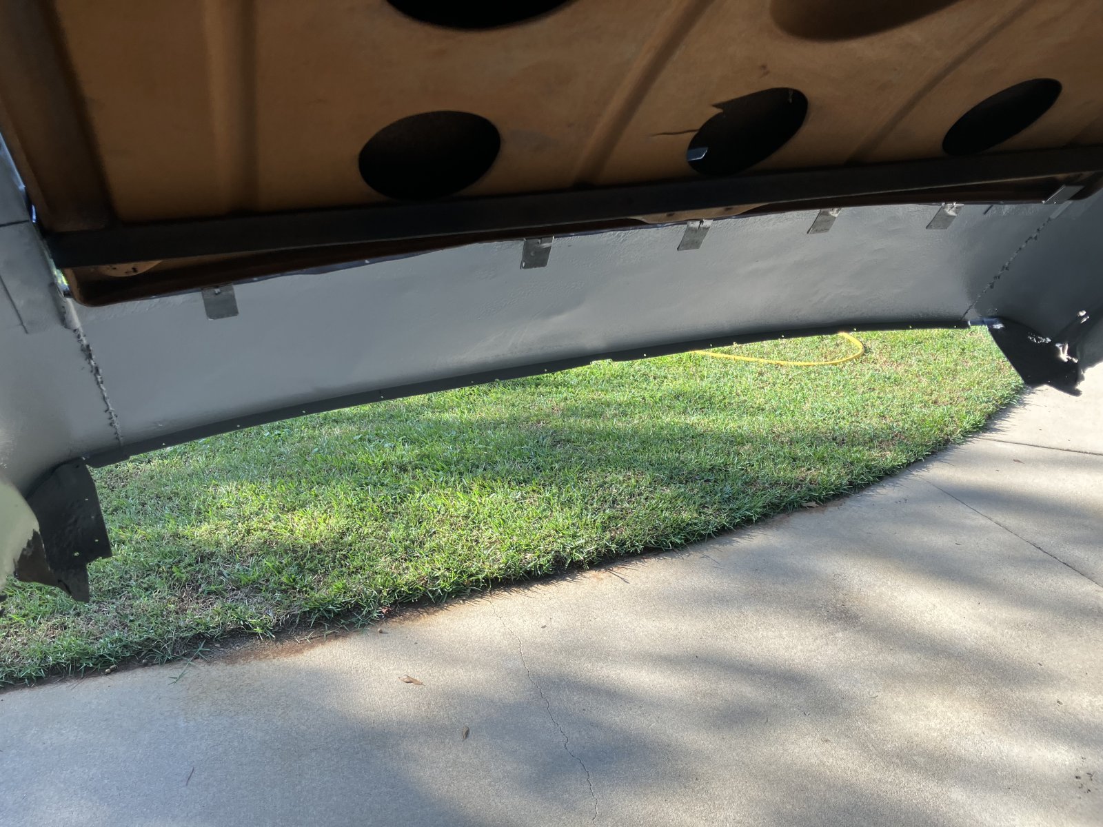

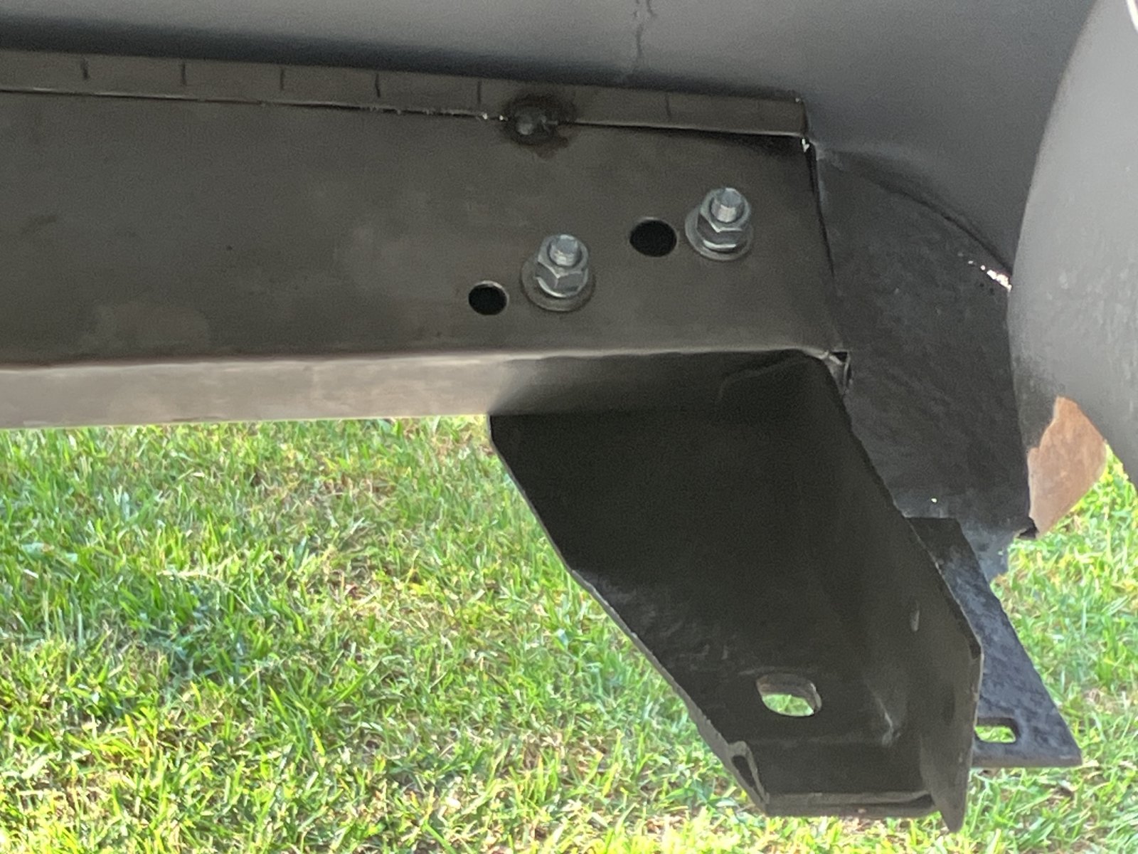

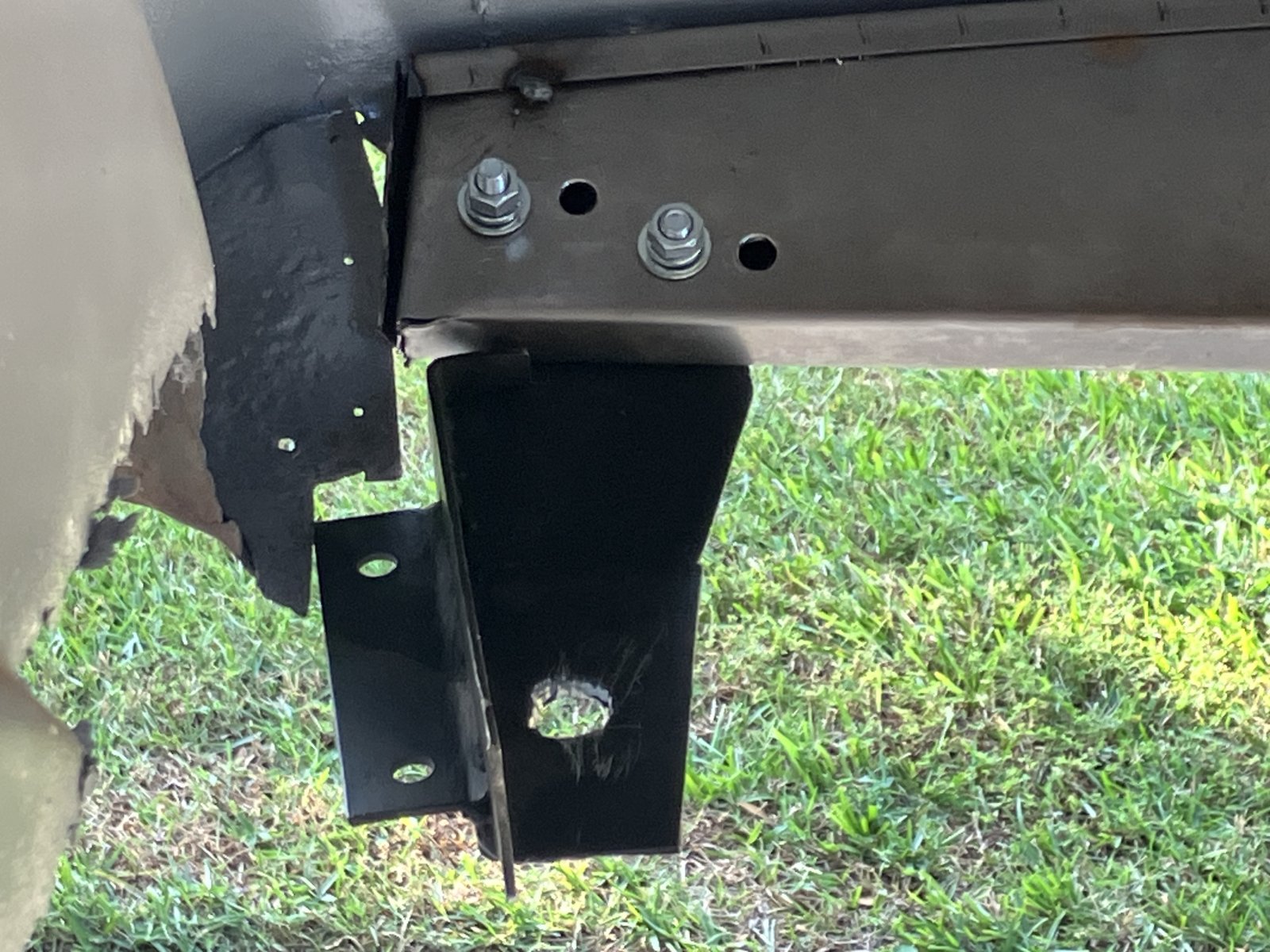

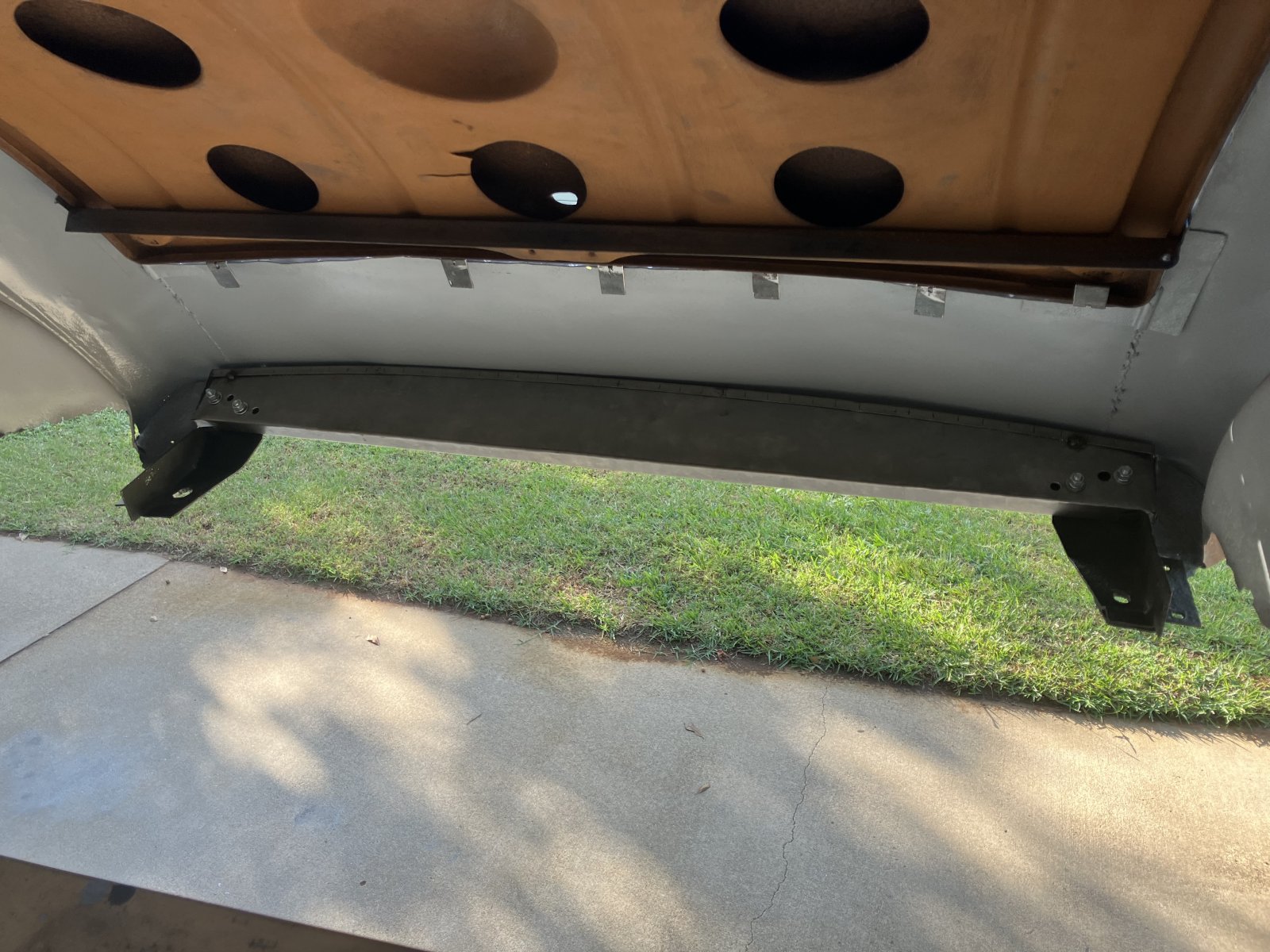

    I hope to put the body on the frame today. Only a test fit. First I’ll need to tack weld this rear body to frame support to the lower rear edge of the tail panel.
    That piece used to be wood nailed in place. I hope it goes well.

  18. Noticing that "switch" next to the p***enger side quarter window... Was it used to turn on the center dome light? Never saw anything like it Jay! Neat!
    Six Ball and Jay Altemus like this.
  19. Looking at those rear body to frame supports, what are the two holes on the outer edge used for - rear fender brackets? Also, did you happen to mount the rear leaf springs to your frame yet? It appears that you have, but not sure if this setup is still in "mock up" stage...
    Jay Altemus likes this.
  20. Shitbox
    Joined: Oct 23, 2021
    Posts: 108
    Shitbox
    from Nor Cal
    That’s exactly what it’s for. Your 31 would’ve had one as well.

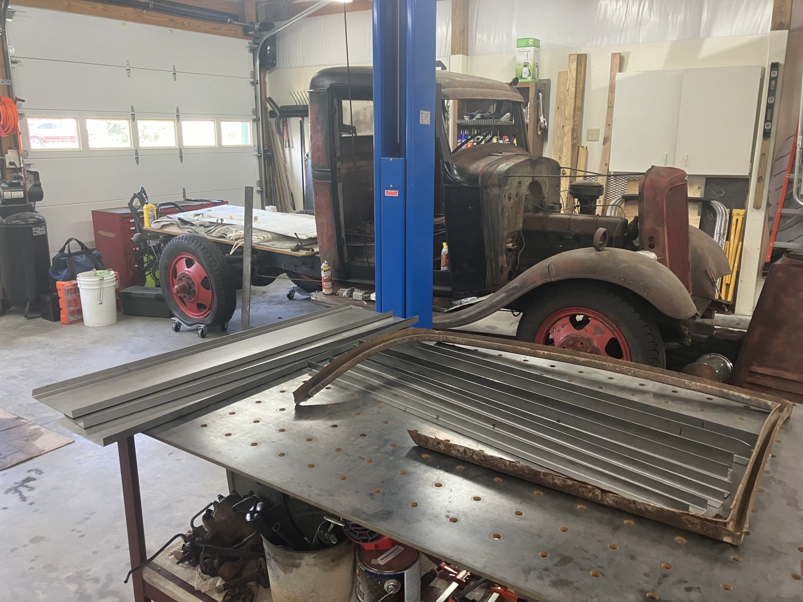

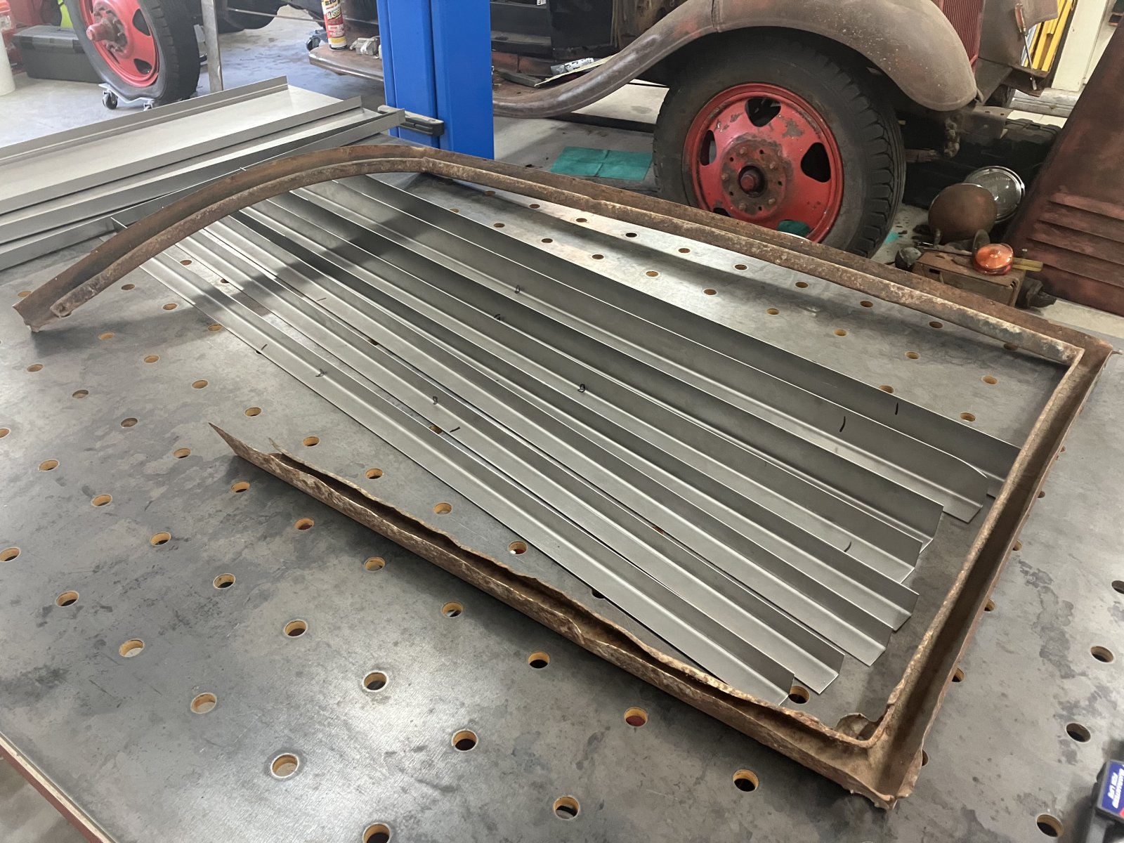

    I spent Labor Day morning at my friend’s shop. We cut and bent some new 18g steel. His 1934 Chevy 1.5 ton truck is in the background. The rusty piece on the table is the deck lid rain gutter for my 1934 coupe. Pieces on the table will be used to make a new one. We also made a piece for a new tail panel below the deck lid in case I need it. Still undecided about that.

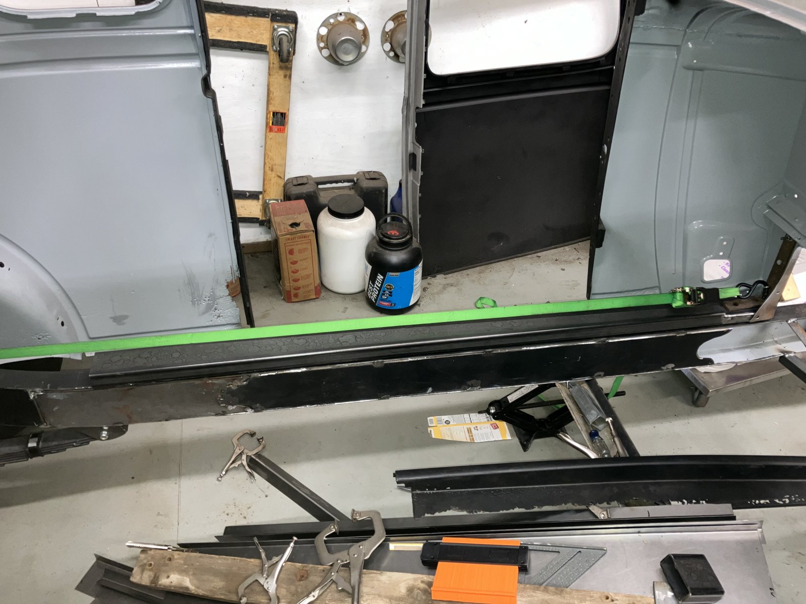

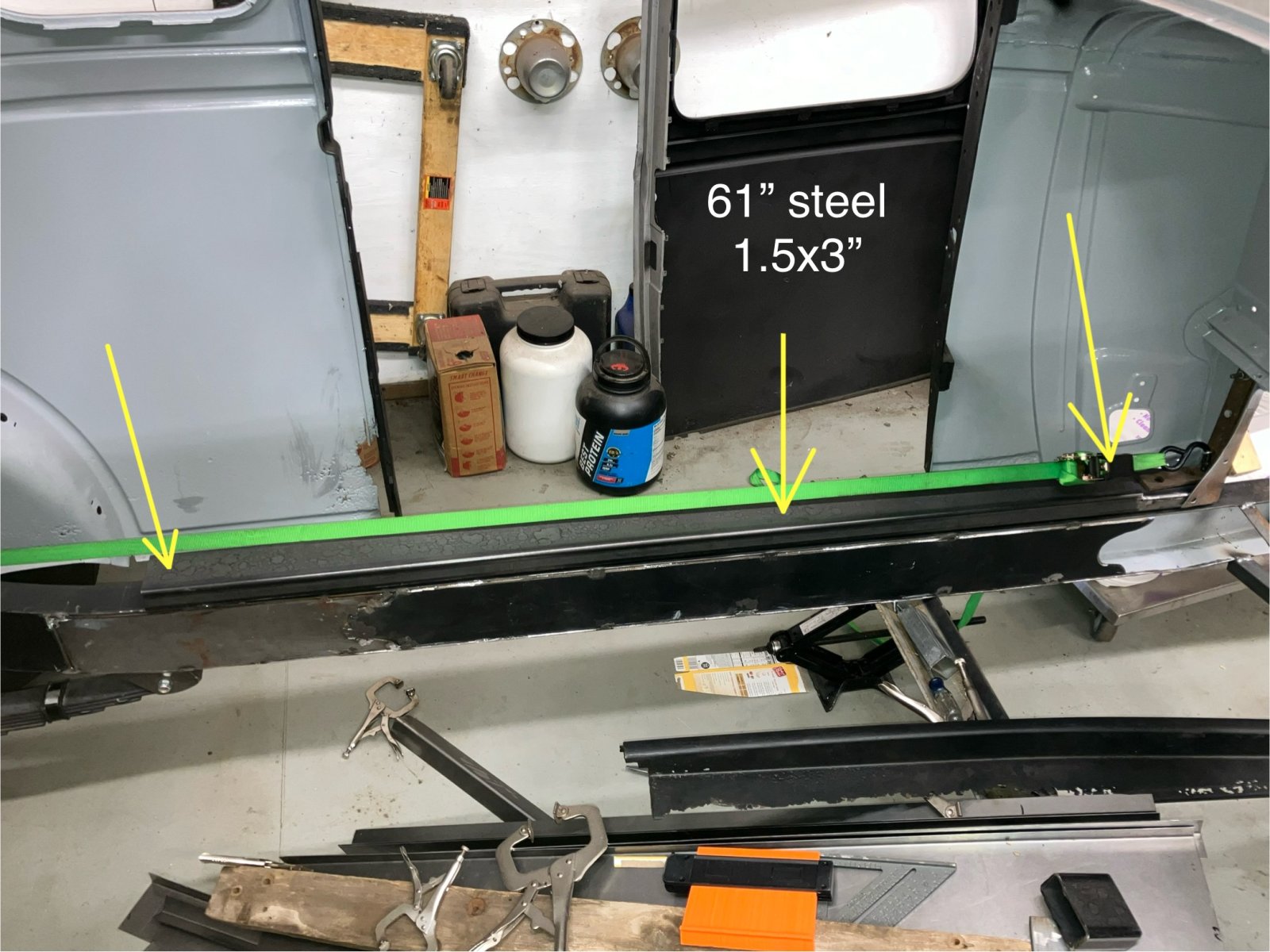

    I’m lining up things. I have the rear of the body firmly mounted to the frame with brackets AND in the correct location. I used ratchet straps to pull the front section back so the door gaps are approximately correct. I used the original rocker panels to double check the distance at the bottom of the A and B pillars.

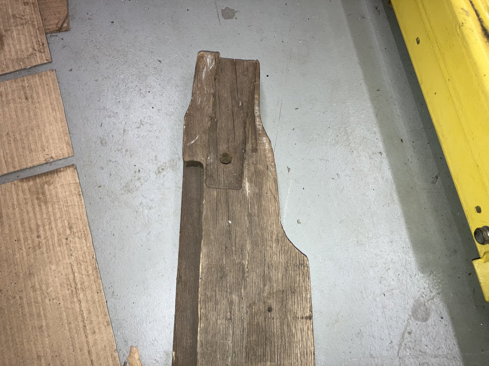

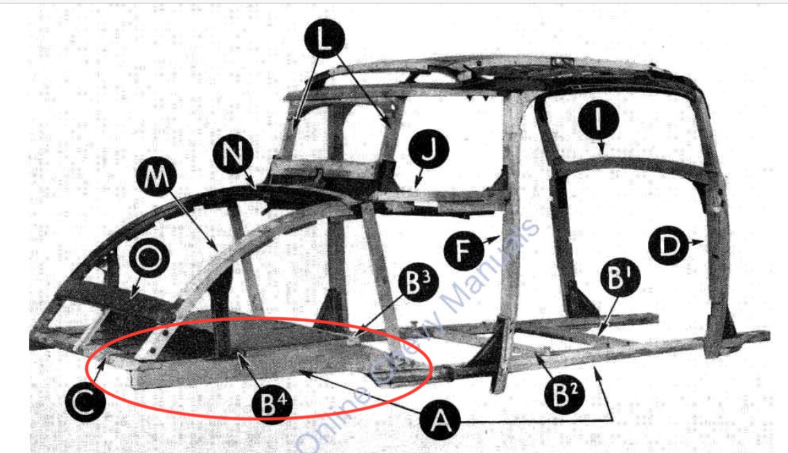

    I need some advice here please. In what order would you do things regarding constructing a floor and door frames?
    I’m trying to recreate the body rails that were originally wood using 1.5 x 3 steel tube. This wood piece I got with the purchase is for the p***enger side of a 34 Standard. So it’s NOT correct for mine but it’s very similar to the rotten piece I took out of mine. The 90° iron bracket that was riveted to the firewall sits in the front slot.
    The wood at the slot is 1.25” thick, so I duplicated that 1.25” at the front of both 61” beams. From what I understand, I’ll need to bolt those beams to the frame.
    My near future plans are to fabricate front and rear door frames/pillars with steel tube so the body can have some rigidity. Nothing will be finalized until I hang the doors and confirm good fitment. I have the original brackets that connect the bottoms of the A and B pillars to the floor.
    IMG_7088.jpeg IMG_7091.jpeg IMG_7093.jpeg IMG_7094.jpeg IMG_7095.jpeg IMG_7096.jpeg
  27. tb33anda3rd
    Joined: Oct 8, 2010
    Posts: 17,588
    tb33anda3rd
    once you get the sills fabricated and bolted to the frame, I would get the doors fitted and swinging on the A pillar THEN fit the rear of the body to the doors. the gaps and bead alignments will tell you where to anchor the rear. of course tilting the cowl forward or back will change the angle of the body so having the A pillar only tacked in is important

  28. Jay Altemus
    Joined: Dec 24, 2023
    Posts: 270
    Jay Altemus
    I ***ume that you are referring to the “sill” as the bottom of the door frame. I’m new at this and sometimes I need to double check terminology.
    Someone suggested that I frame the perimeter of the floor and run beams left to right across the frame instead of running the 61” beam directly ON TOP of the frame rail. That makes sense. Today I’ll try to temporarily brace the body so the door opening is correct at the bottom. That way I’ll have more confidence fabricating the A and B pillars.
  29. mixerman
    Joined: Jun 23, 2021
    Posts: 241
    mixerman
    "snoop74" I met you at the last Lonestar roundup and I have a 33-5 window and I have my window garnishs installed without wood. I know it would be a bit of a hike to come out to the College Station area, but you're welcome to come out and see how I did mine.

  30. tb33anda3rd
    Joined: Oct 8, 2010
    Posts: 17,588
    tb33anda3rd
    yes, by sill I mean the 61" beam you refer to. the sills would be the perimeter "frame" of the body. it would be best to have them made, braces connecting them and bolted solidly to the frame. welting can be added under them [evenly] after the all the fabrication and paint is done. this will give you a solid base to build the body on. starting at the front and leveling and fitting as you go back .
