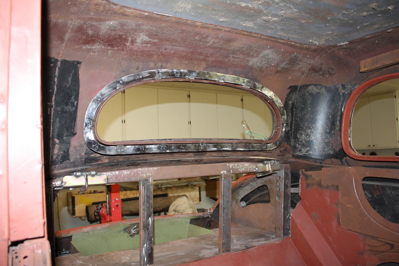

  3. @Jay Altemus that's great advice by @tb33anda3rd Here's the only picture of mine I could find. I had the original wood sills and copied them. I also added cross pieces that I could mount my seats to. Keep up the good work!
  4. Six Ball
    Joined: Oct 8, 2007
    Posts: 6,455
    Six Ball
    from Nevada
    Tom, Are the front pillars wood?
    31chevymike and TFoch like this.
  5. No I copied the wood ones I had that were in rough shape and made them out of sheet steel.

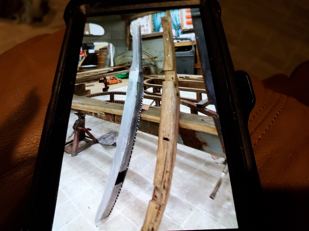

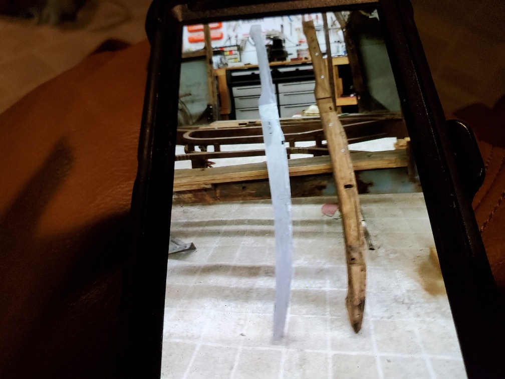

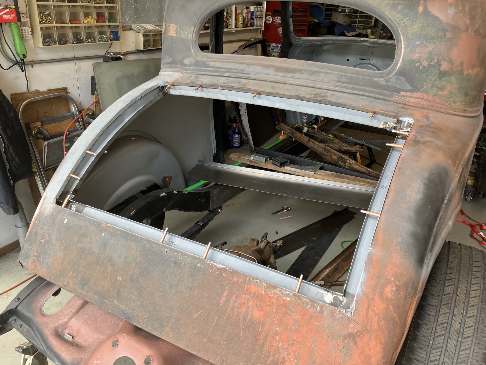

    Yesterday was “eat humble pie” day. I had a really nice time yesterday making deck rain channel. Got to use my shrinker/stretcher. My plan was to make an exact duplicate of the rusty channel I had. (Bad idea). What I made doesn’t fit.
    I need to install the pieces inside the car individually FIRST, and only then should I join them. Oh well. I cut what I had in half at diagonal corners for a test fit anyway. My assembly plan was not thought through and as a result I’ll probably do this all over again. I know I shouldn’t let “perfect” be the enemy of “good enough” but I now have a plan that will give a much better result and the cost of materials was $10.

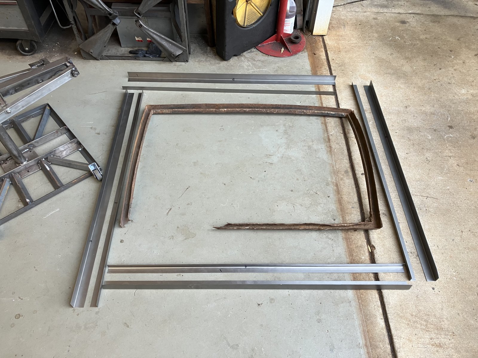

    Here is pictures from my 1933 Chevy Master Town Sedan "A" and "B" pilars duplicated in 16 gauge sheet metal boxed to match contours. Very pleased with results after finishing all wood replacement in the car !

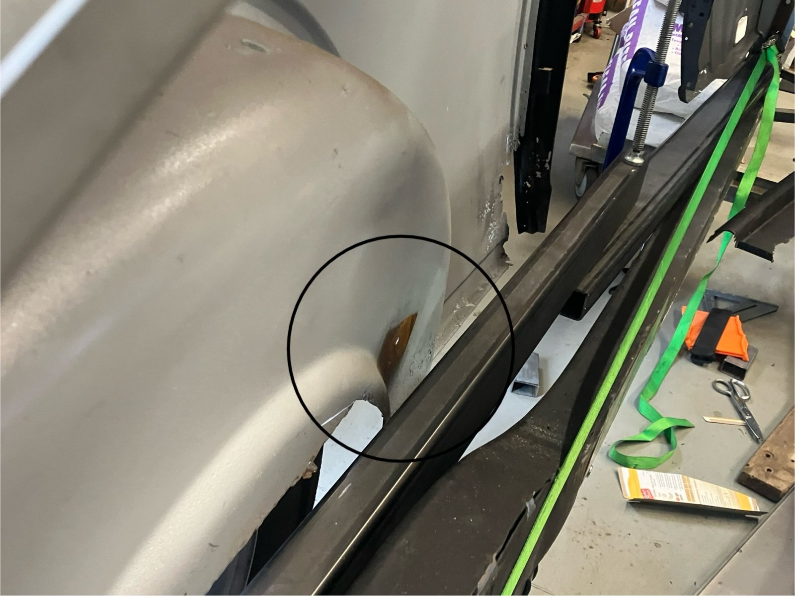

    There are factory holes in the rear fender well (circled). The rectangle of rust is where I had placed a brace while I was media blasting the body interior.
    Question. Was there a bracket there that mounted to the wood framing (now steel)?
    I’m thinking that a bracket there would help support the wheel well and weight of the rear fenders. Clearly the rear fenders mounted to the wheel well using the holes at the top perimeter of the wheel well.

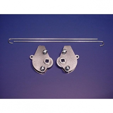

    Nice work. I have my original 1934 door latches for the B pillar but I imagine there might be other, possibly better options for door latches.
    Can you share details about what latches you used?
  15. snoop74
    Joined: May 29, 2022
    Posts: 346
    snoop74

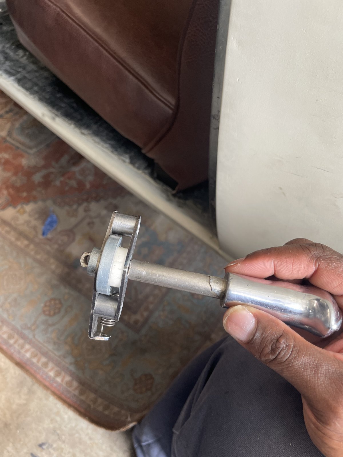

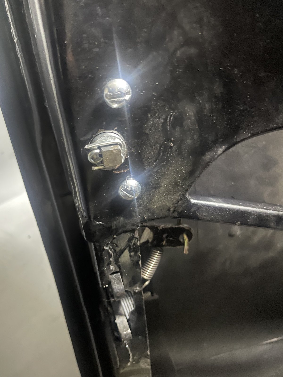

    I ended up just using the speedway bear jaw latches. Then I think it’s like Carolina customs makes the spring loaded mechanism for the shaft. Which I had to cut down to fit my inner door a bit and relocate the spring

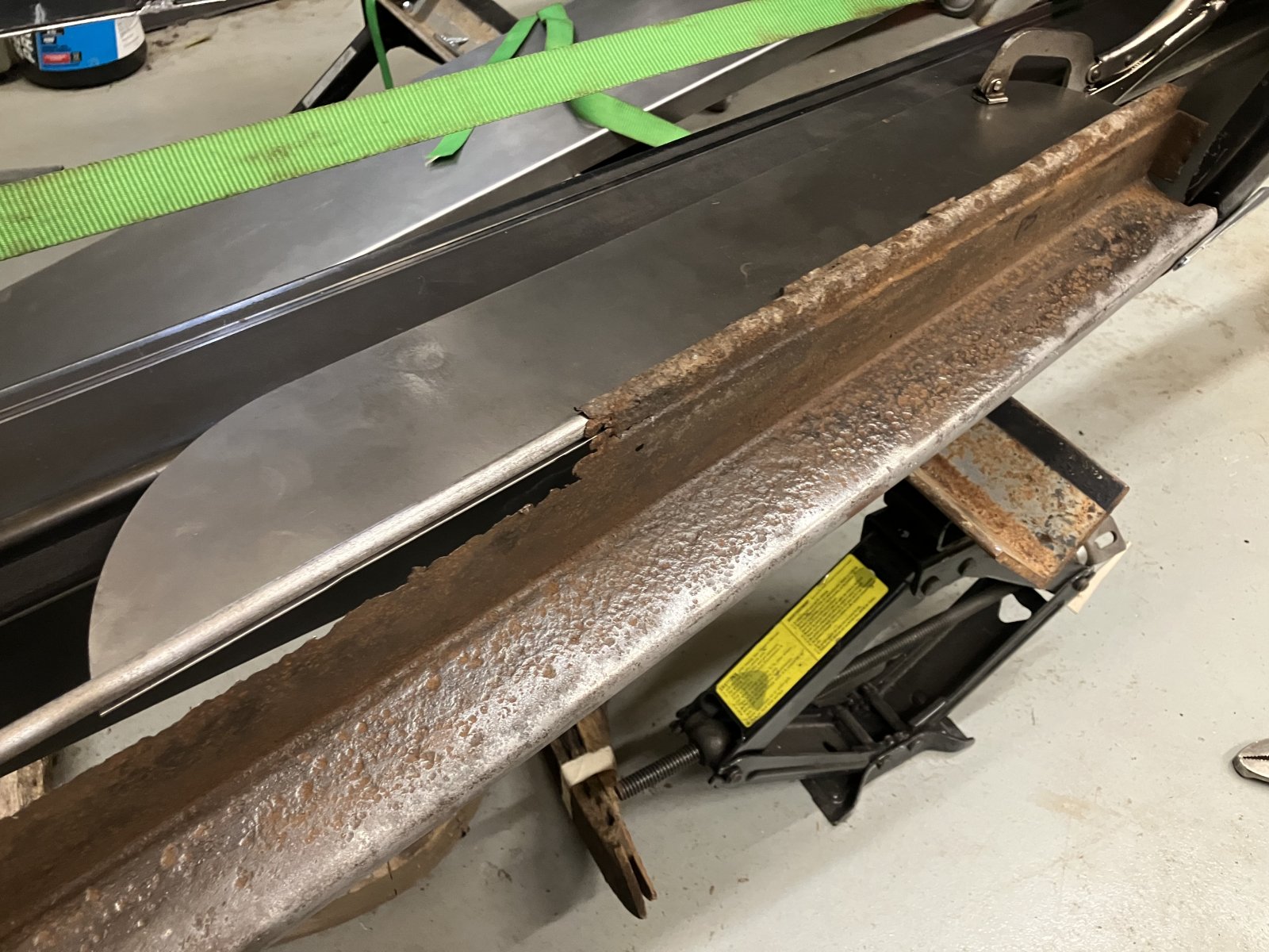

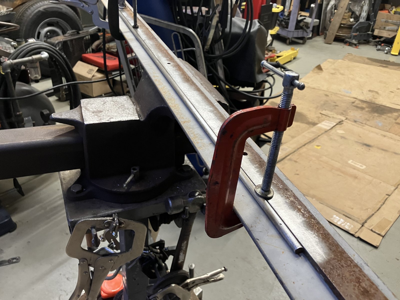

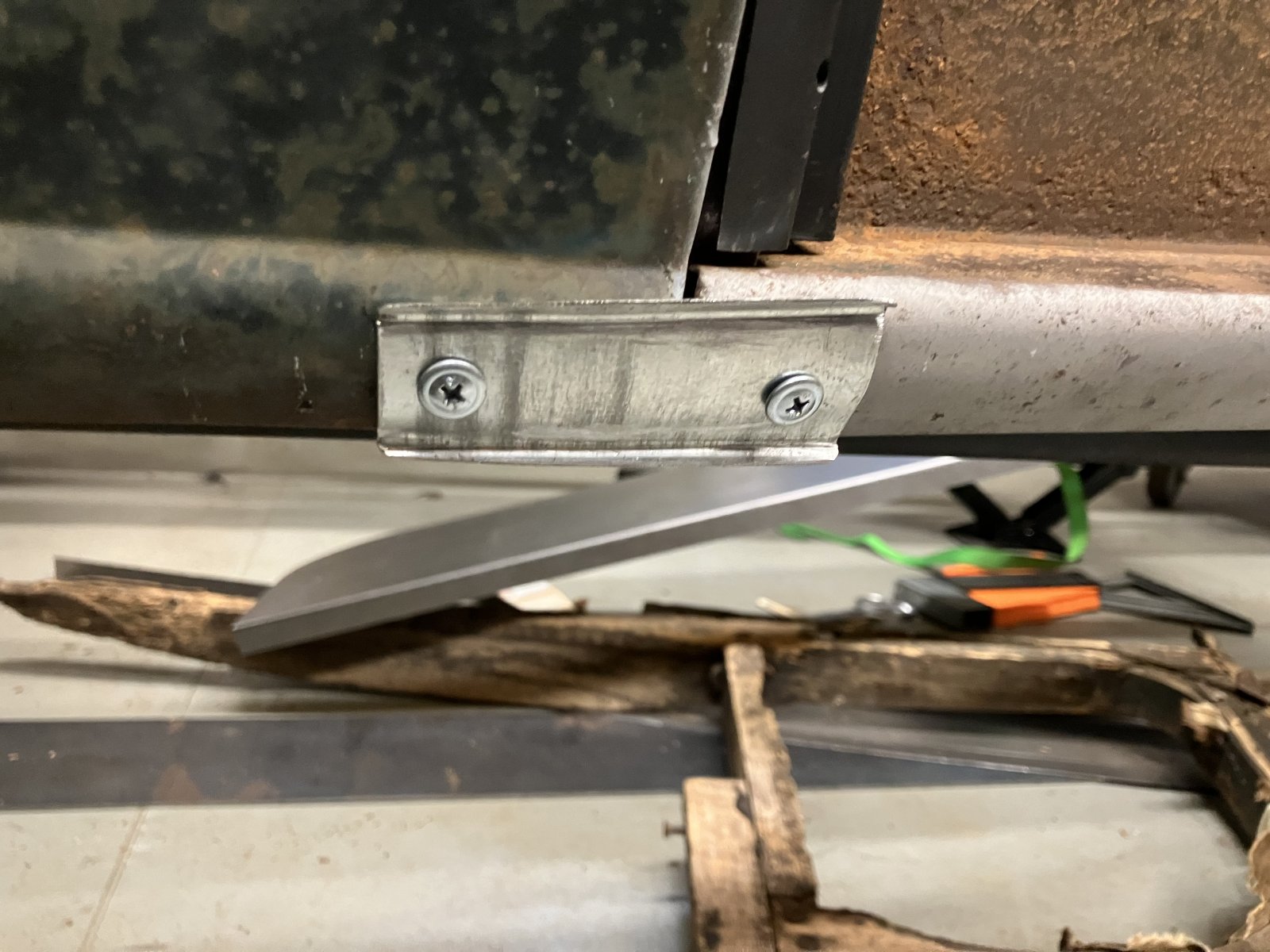

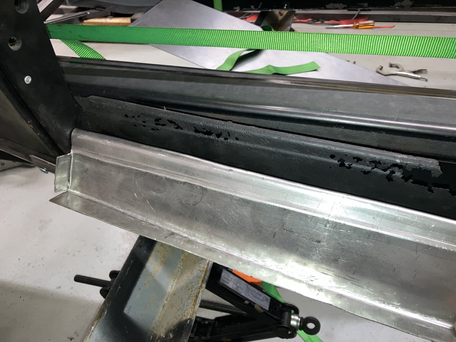

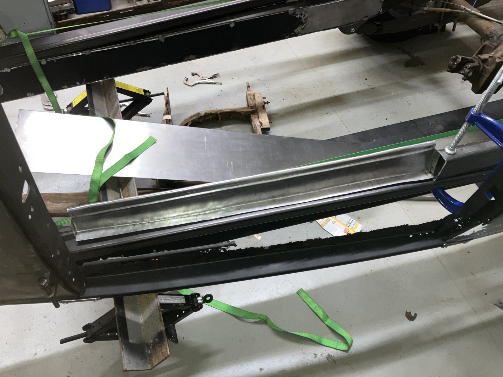

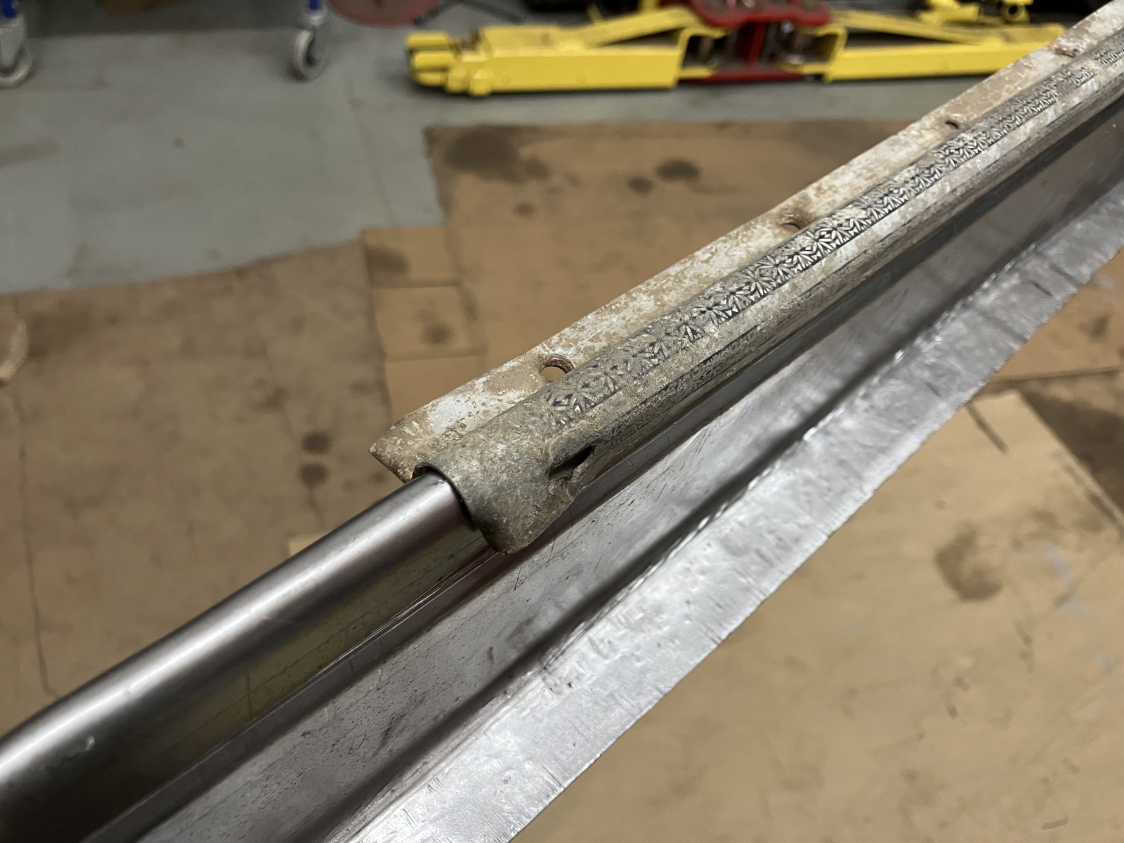

    Big day. Screwed the rockers in place using metal straps. The 5/16” rod (incorrectly said 3/8” in the video) is the top of the rocker at the sill plate and it lines up nicely with the floor beam.
    I also finished the top radius of a rocker patch panel I made. That 5/16” rod was welded to flat bar and used as an anvil to roll the top edge over to finish off the top of the rocker like the original was. The original sill plate fits like a glove. VIDEO LINK

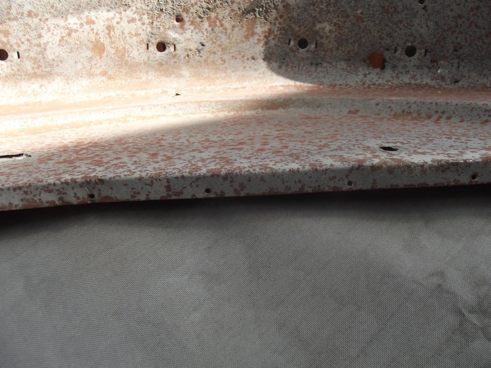

    I was asking on FB about these holes in my rear wheel wells. Sensible answers were few but it seems to be a hole for a brace connection, perhaps the cross brace labeled B3 that goes across the frame, or the diagonal (mostly vertical) brace just a few inches forward of B3.
    Anyway, someone contributed pics of some rear wheel wells that were not rotted at the bottom.
    It looks like the bottom edge of the wheel well had a flange that nailed to the underside of beam A at the rear of the car. Since that area would stay wet the longest, it would rot first. Mine are completely gone of course. Here are some pics if you are interested.

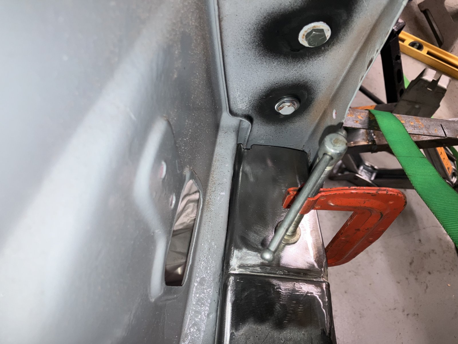

    Things are making more sense now. The main floor beam from the firewall extends back and stays parallel to the rocker. The main beam from the rear frame crossmember extends perfectly parallel to the rear wheel well and the flange on the bottom of the wheel well nails to the underside. I should be able to reproduce the shape in steel. Today was a good start at doing so. VIDEO LINK
    Here are a few pictures from today.

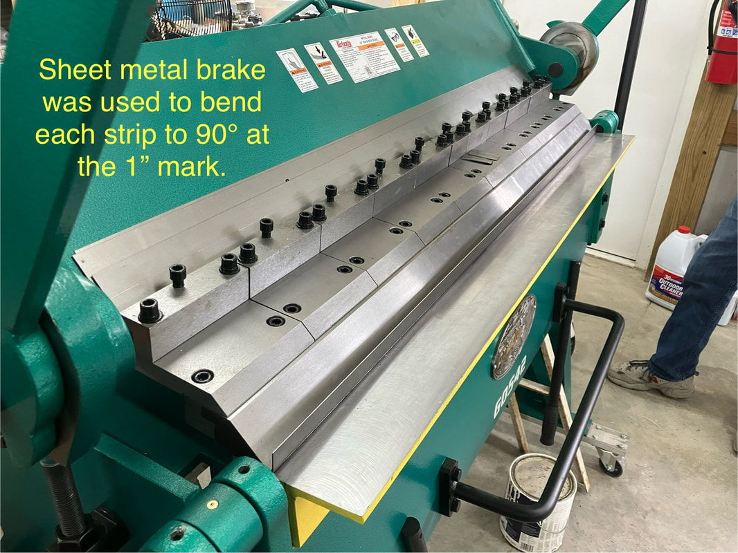

  25. @Jay Altemus I think it's if you want to bend a small hem. Sheet Metal Hem.jpg
