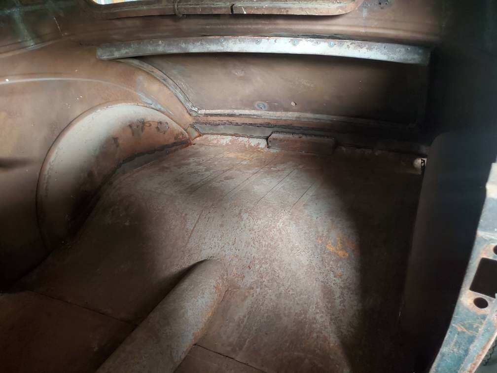

    I don’t have a ton of high quality pictures of the chop but here are some I found.

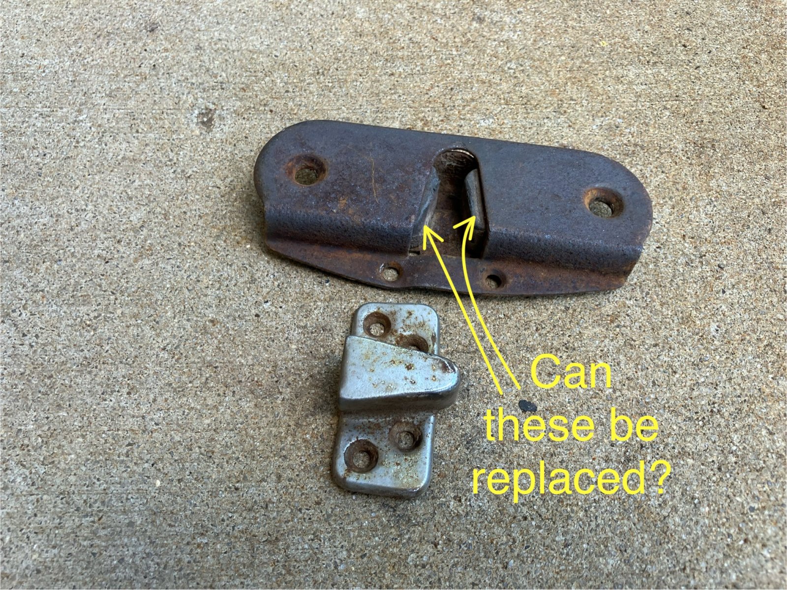

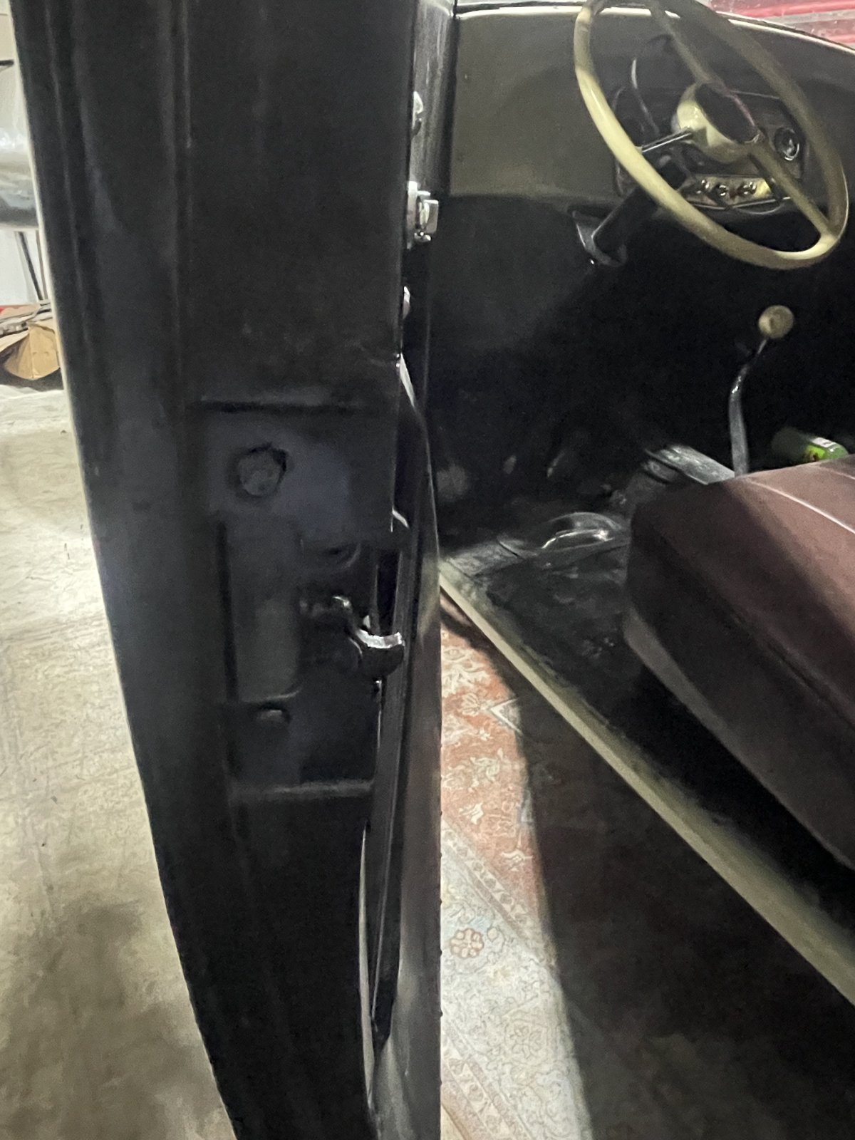

    Jay Altemus

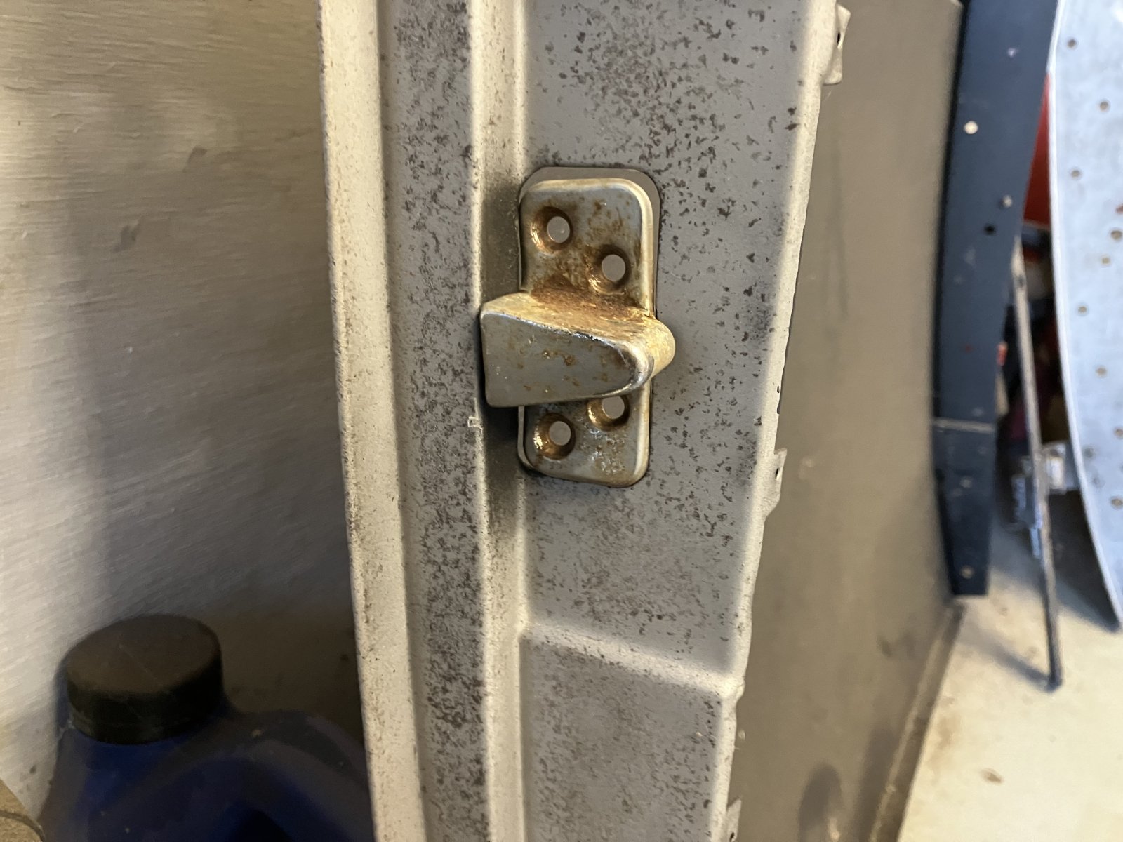

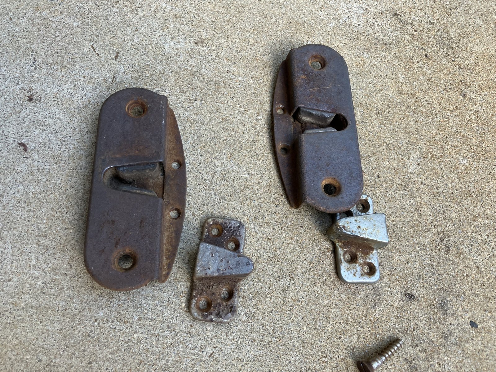

    Advice please.
    I’m fabricating the B pillar in steel. I’ll install bear claw door latches. The original B pillar face plate has areas that are only needed for the original style latch.
    Modifying the face plate by smoothing out a few areas will make fabrication of the B pillar easier. I’ve included pics of the original door latch to more clearly show how things were factory designed.

  7. snoop74
    Joined: May 29, 2022
    Posts: 417
    snoop74
    I’m not sure if these pictures will help at all jay, but I’m using bear jaw latches and most of the original inner door structure. My main concern was the body lines, I made sure those were good on the outside and then figured out where to put the sticker ect.. IMG_0035.jpeg IMG_0036.jpeg IMG_0037.jpeg IMG_0038.jpeg
  8. Doug G
    Joined: Jul 30, 2015
    Posts: 134
    Doug G
    from Manheim Pa
    Recommend keeping alignment wedges and upper and lower rubber bumper recessed areas. Best choice for proper alignment of doors and avoid paint chipping issues in the future. This is what I did on my car and very happy with results.
  9. Jay Altemus
    Joined: Dec 24, 2023
    Posts: 270
    Jay Altemus

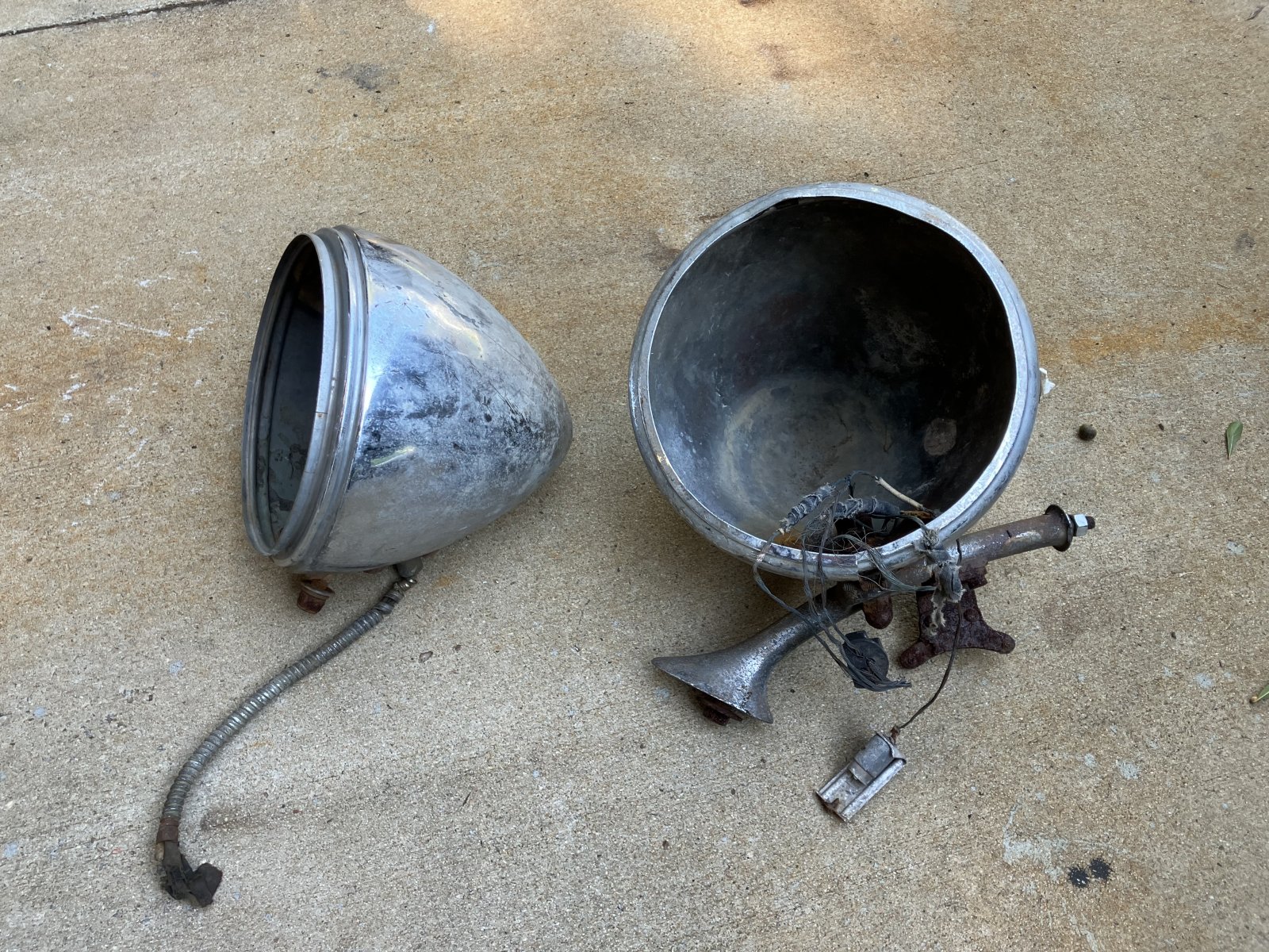

    I think I found a source for the door wedge rubber pieces and new rubber door stops. Since those parts are available, I’m agreeing with keeping them intact.
    Cleaned up some stuff and took some inventory today. Found my original door wedges. These headlight buckets are kinda beat up. Are they 1934? I sure can’t tell.

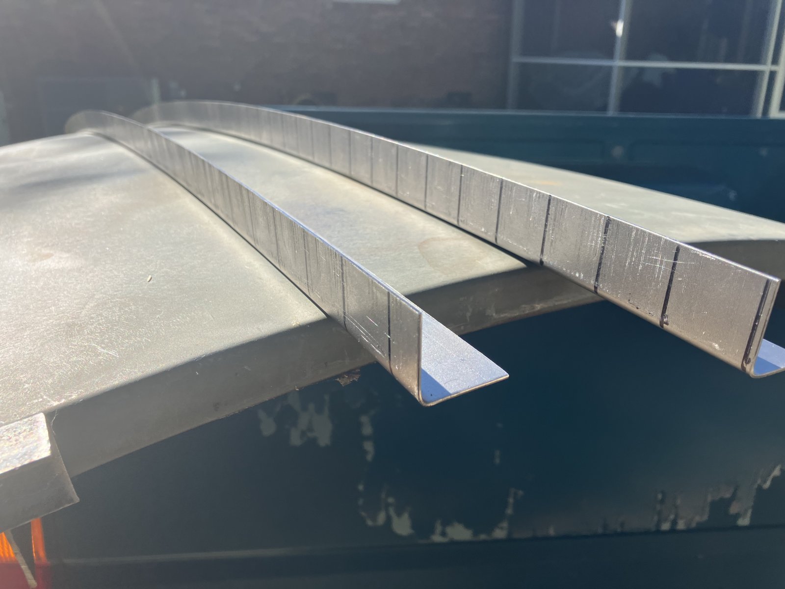

  10. Jay Altemus
    Posts: 270
    Jay Altemus
    Finished the initial mock up of the deck rain channel. My first attempt was a flop. This attempt taught me even more lessons but my results are satisfactory this time. VIDEO LINK HERE.
    IMG_7396.jpeg IMG_7397.jpeg IMG_7378.jpeg IMG_7377.jpeg IMG_7370.jpeg IMG_7368.jpeg IMG_7371.jpeg IMG_7352.jpeg IMG_7348.jpeg IMG_7349.jpeg
  11. tb33anda3rd
    Joined: Oct 8, 2010
    Posts: 17,587
    tb33anda3rd
    I wouldn't weld that in till the body is all aligned. it will be easier to get the body aligned if that isn't holding its shape and consequently trying to get the body aligned after may put a twist in the frame and throw the lid alignment off.
    31chevymike, Six Ball and Jay Altemus like this.
  12. Jay Altemus
    Posts: 270
    Jay Altemus
    Totally agree. It’s sitting on the shelf waiting for the deck lid to be installed at a later time. Plenty of body work to do before I’ll touch it again.

  13. tb33anda3rd
    Joined: Oct 8, 2010
    Posts: 17,587
    tb33anda3rd
    regarding the door posts, I would leave the face plate as original as possible. run a square tube up the inside and leave the space for all the original rubbers and alignment parts. a full tube is not even needed if the face plate is welded to the outside , an inner plate welded from top to bottom and a rear plate welded to create a post. a triangle bracket from the back of the post, running along the belt line and up to the package tray area to reenforce the latch [simular to the original] really stiffens up the latch area

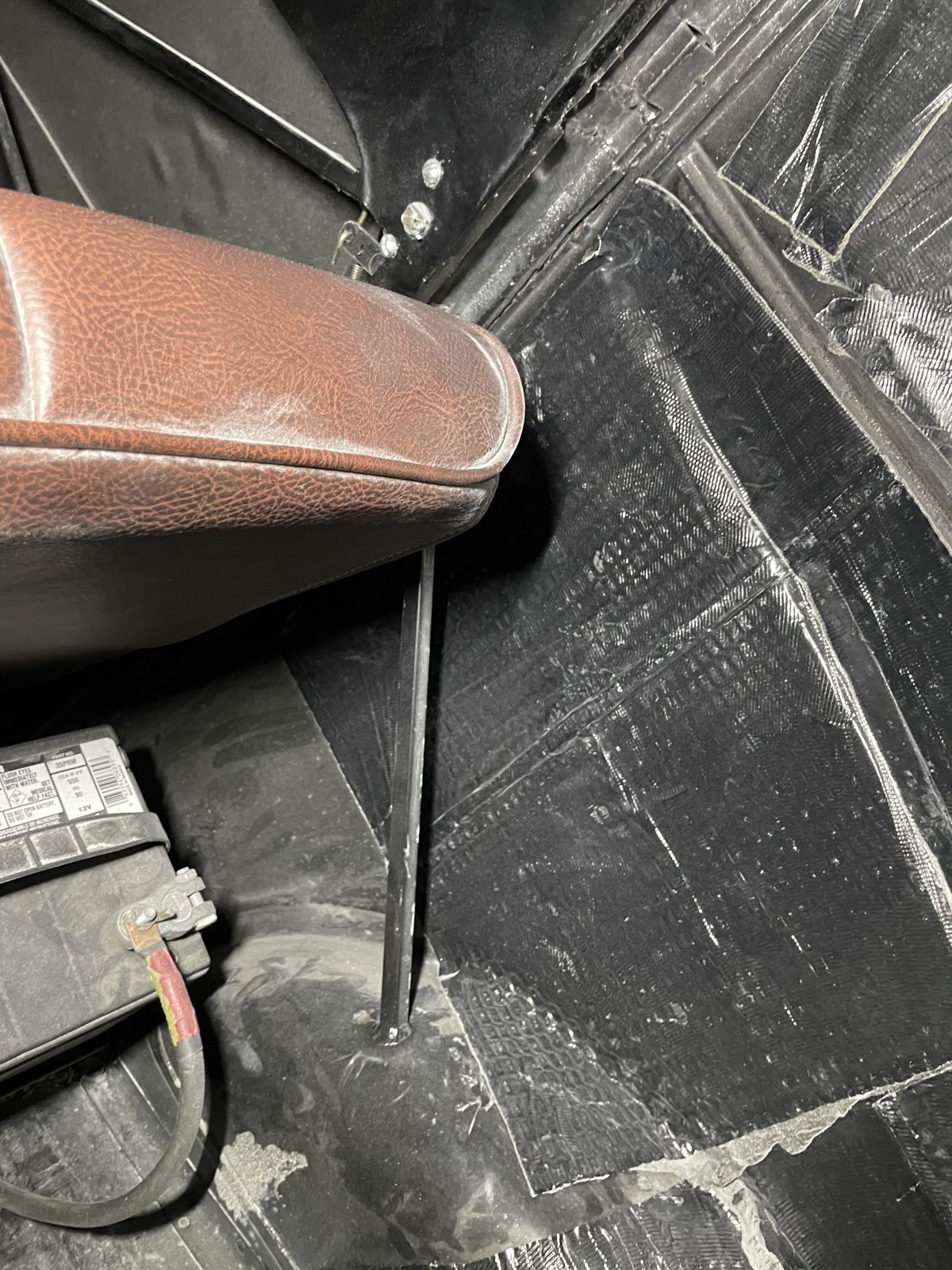

  14. snoop74
    Posts: 417
    snoop74

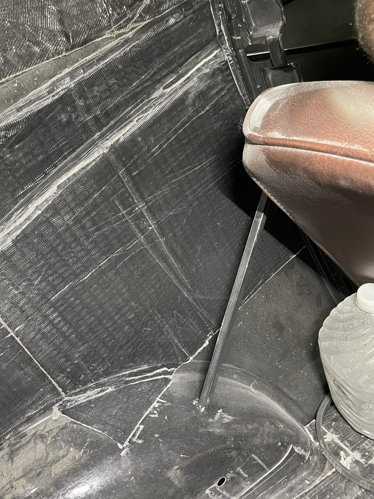

    I ran some square tubing from the top of the wheel well to the back of the structure to support it IMG_0064.jpeg IMG_0065.jpeg

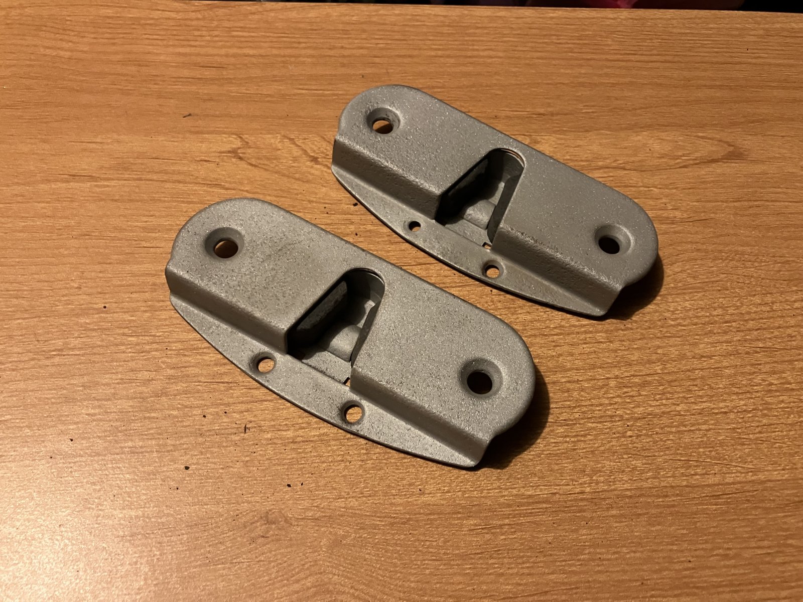

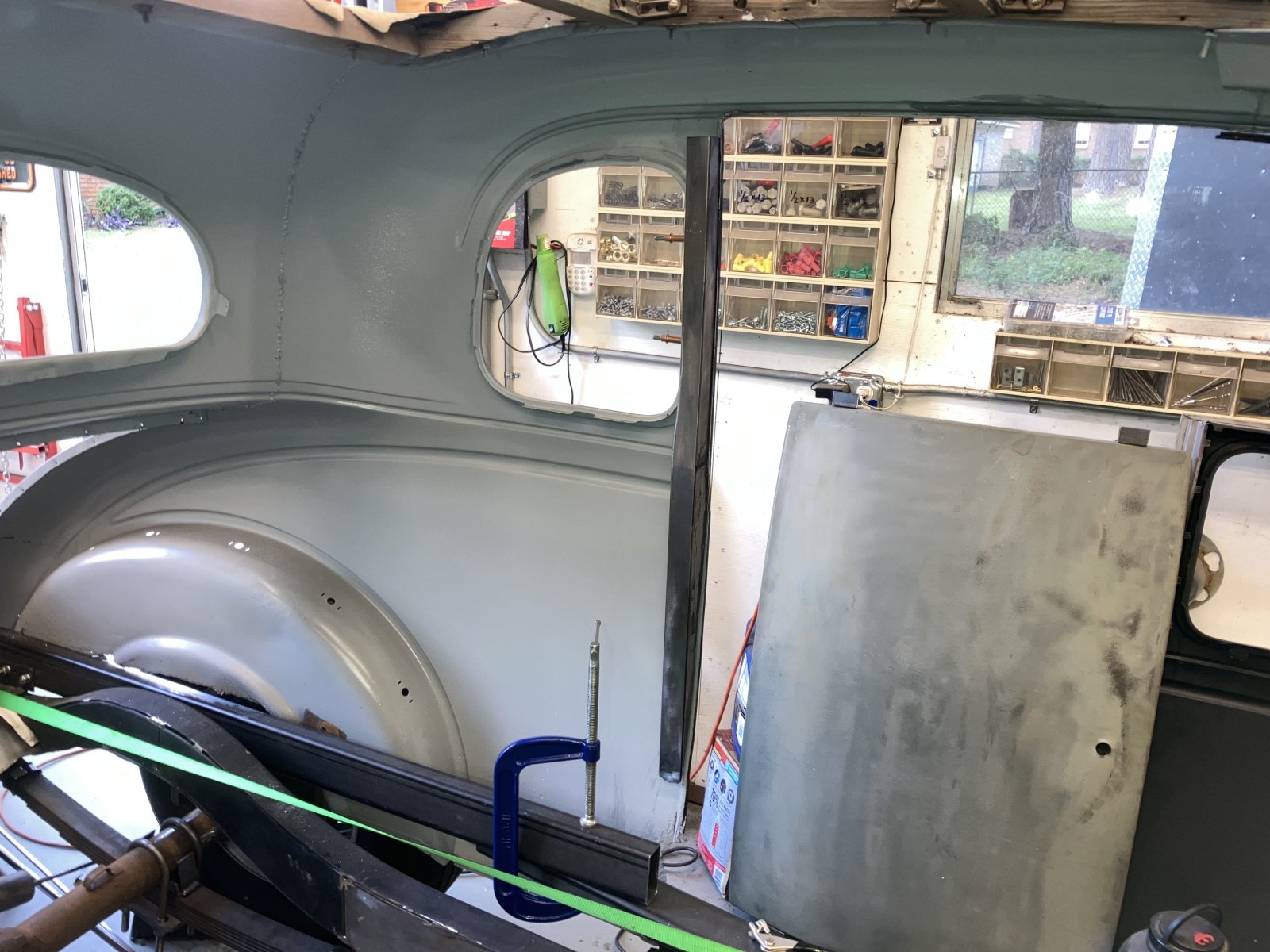

  20. Jay Altemus
    Posts: 270
    Jay Altemus
    Nice work @snoop74.
    Correct. Media blasted those parts in my Skatblast cabinet.
    Today I did a lot of fabrication. Used 1.5” square tube 14 gauge to make a B pillar. Only half way done. Had to narrow the top 14” to 1.25” by cutting a kerf and then squeezing it closed until it was 1.25”. Then weld it. The top half is done but I’ll add more to the lower 20” later.

  22. snoop74
    Posts: 417
    snoop74
    Thanks, jay did you figure out how you’re going to brace that inner structure
    31chevymike and Jay Altemus like this.
  23. Jay Altemus
    Posts: 270
    Jay Altemus

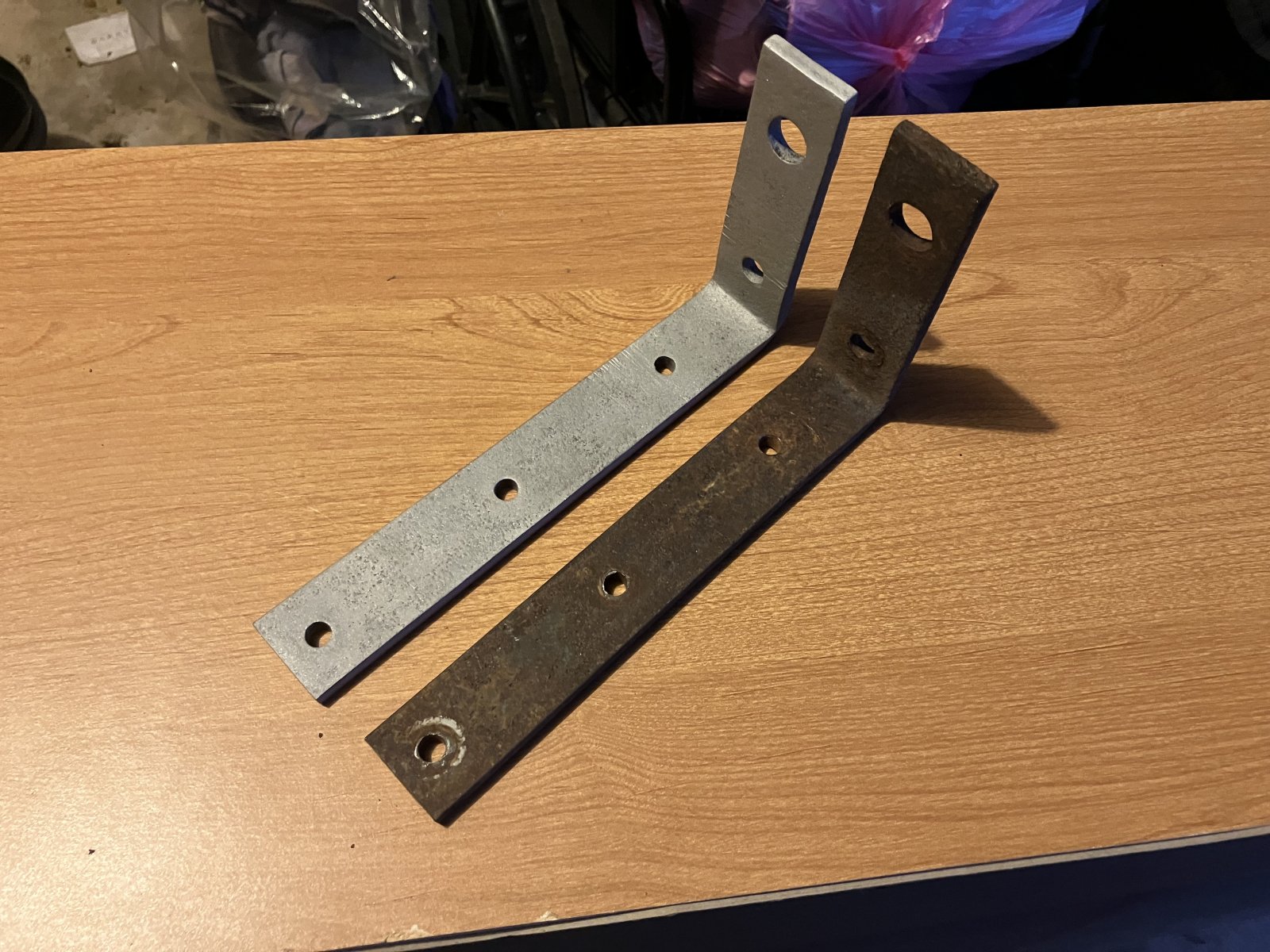

    The B pillar will connect to the floor outer frame beam. That’s how it was done with wood and I have the original brackets for the A and B pillars. I must first finish the bottom of the B pillar.

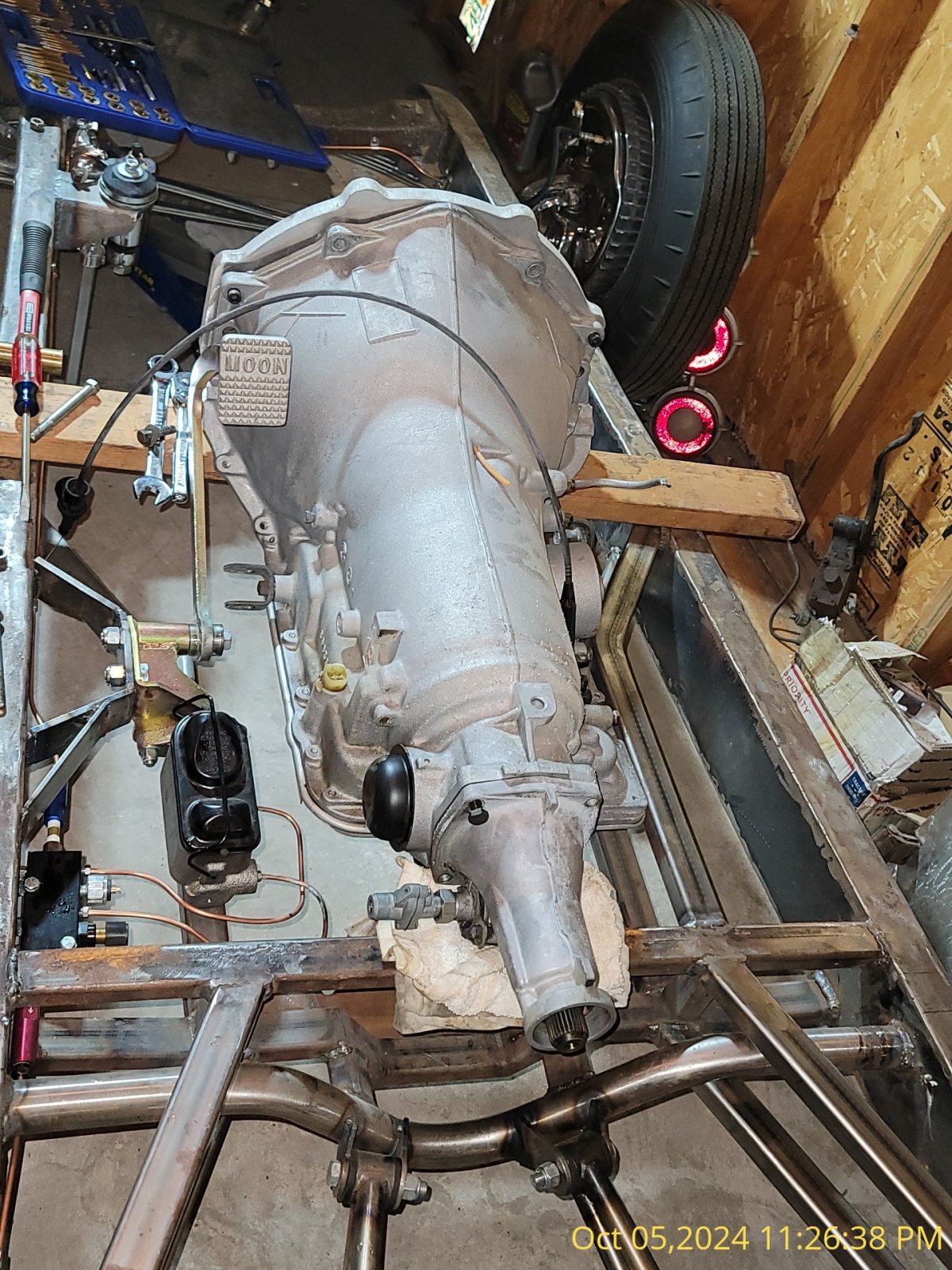

  25. Just a couple of pics to show some progress on my hemi install prep...
    Jay Altemus, Tim, tb33anda3rd and 3 others like this.

  27. Thanks brother! Now I can sit on my stool comfortably and begin to attach the trans adapter/spacer, torquing the bolts correctly. Replace the old seals and gaskets on the front pump and rear tail housing on my transmission. Slip the torque converter in place (3 clicks) and finally get that big *** hemi within my rails - we're talkin' a huge smile on my face for the ages!!!

  29. My hopes on getting her back on the road is sometime next year, my 30th anniversary of ownership (purchased in 1995!) Crazy huh? Not going to place the body back on till I size up a new driveshaft, purchase the right electric fuel pump, bend hard lines for the fuel system, polish the entire center section of the Winters QCR (redo the brake lines on the rear as well), etc. Nice work on the rear exhaust system re-routing on your '35 - what's your next show that you plan to attend?
