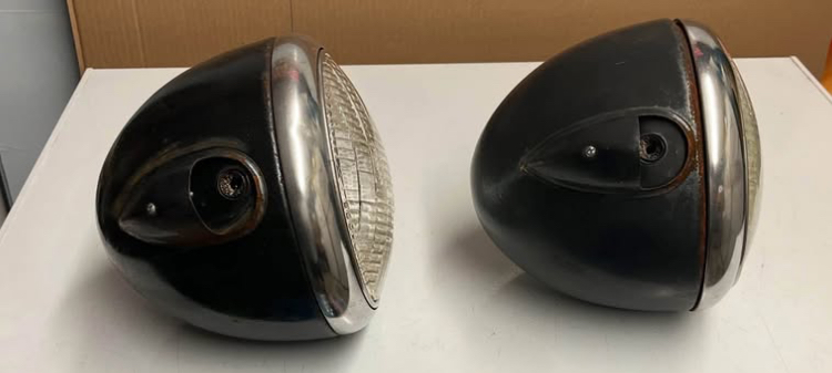

    These sealed beam headlights are near me. Pretty nice condition overall. Any idea what they were from? Seller doesn’t know.

  13. They're called, "Guide" headlights from the 30's. I believe that the bulbs were common 5 -7" in diameter, easier to purchase than the original headlights that were larger in diameter. Had a pair on my '31 way back in the beginning years of ownership. The headlight "eyebrows" were common in the fifties (did I nail that 50's look or what?). They're perfect to run turn signals on hot rods instead of those cheesy aftermarket ones that look way too modern on a nostalgia hot rod.

    These are guide 682-C’s I was running these in my car before I switched to 904a’s IMG_9358.jpeg

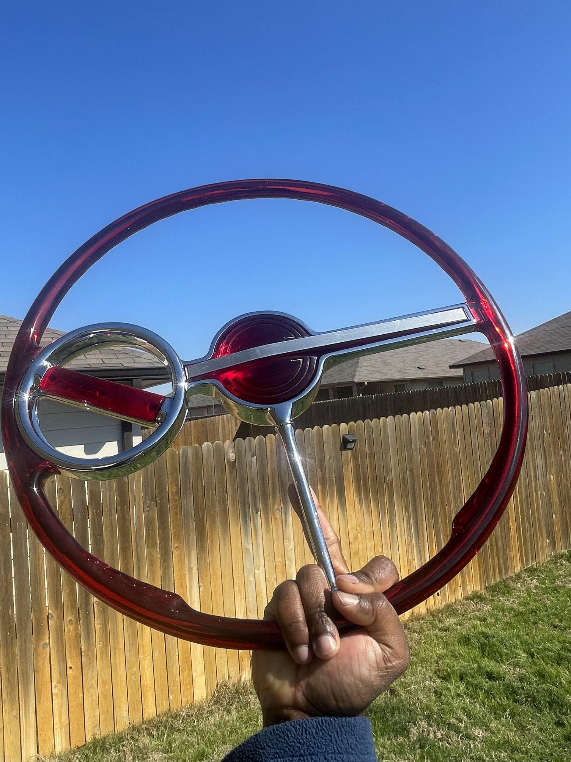

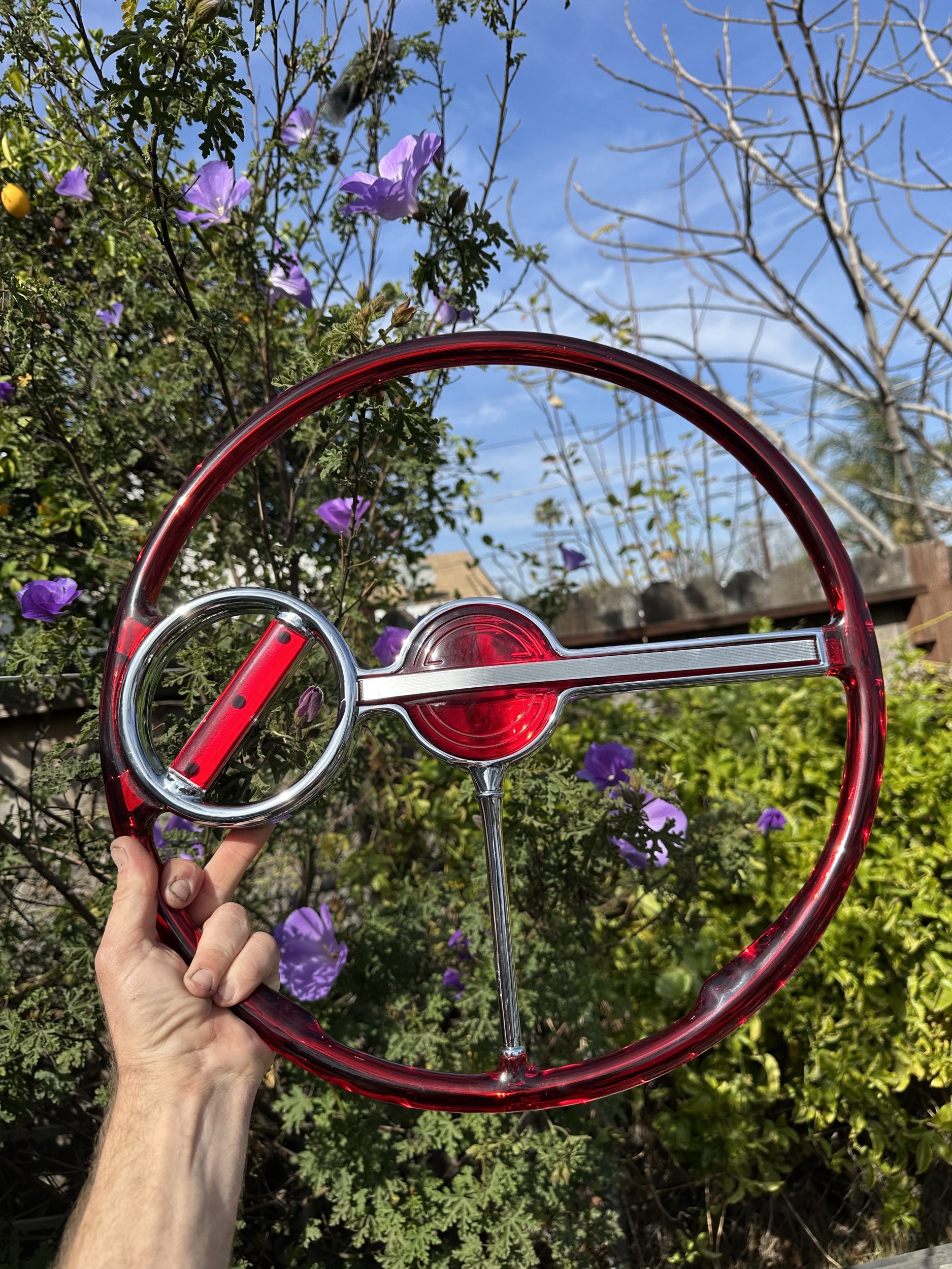

    snoop74
    It’s a 1940 Chevrolet special deluxe… or “spinner”,”fatman” wheel. Yeah it was rechromed and remolded in a translucent red. Done by steeringwheelbykris out of socal

  20. That steering wheel is stunning... Talk about ****ing your eyeballs right out of your sockets when viewing a true vintage hot rod interior...
    Jay Altemus, Six Ball and snoop74 like this.
