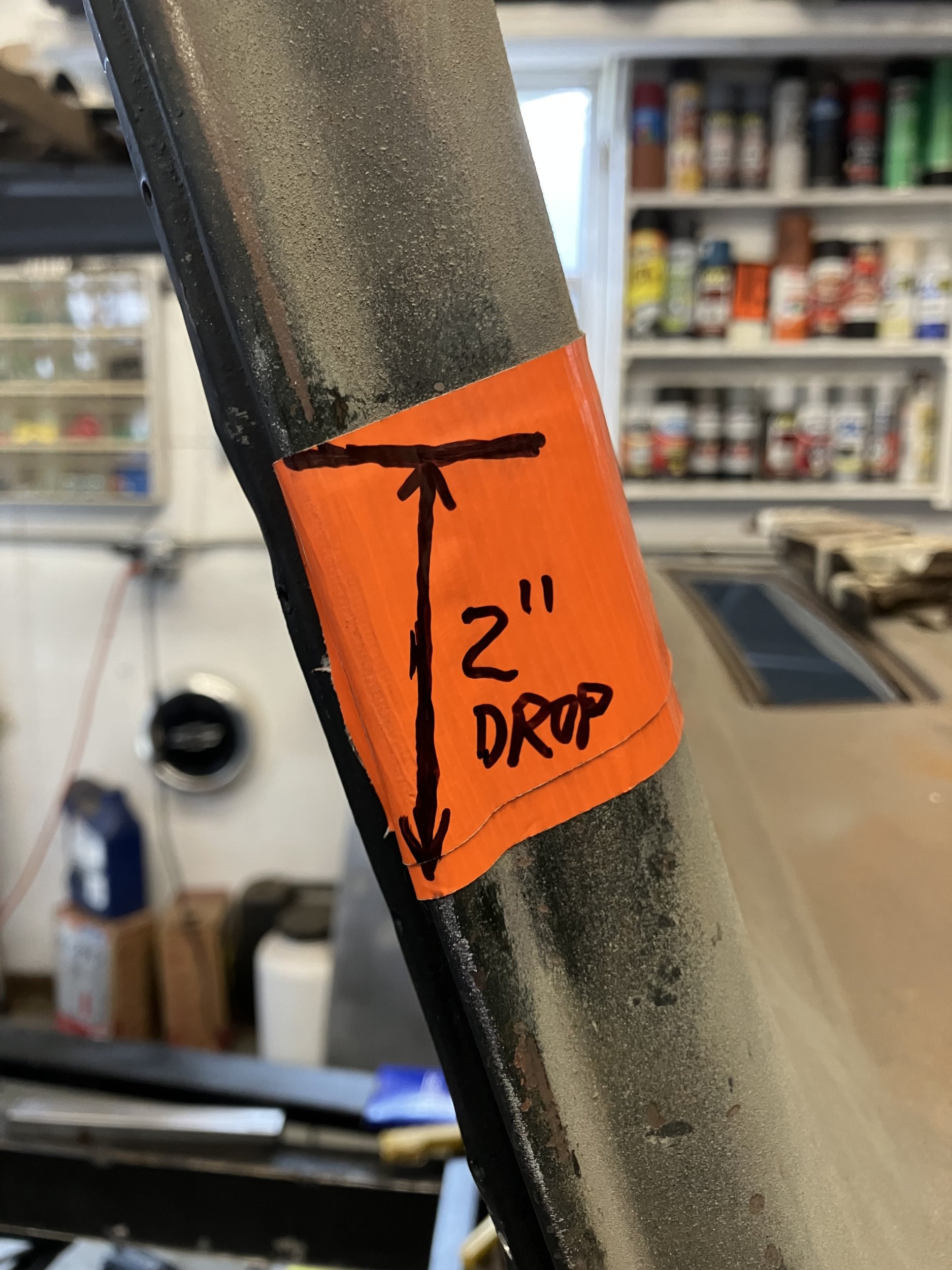

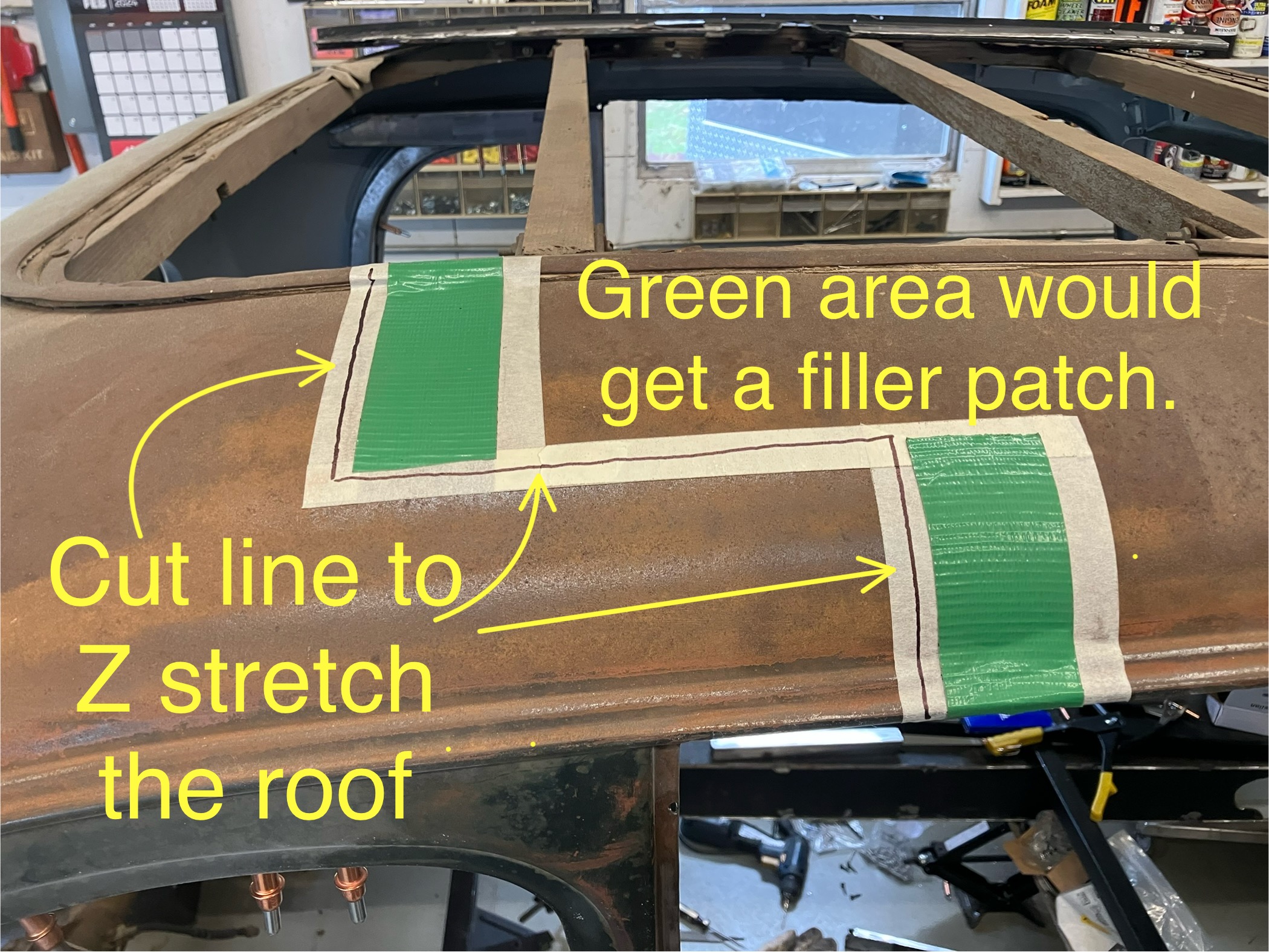

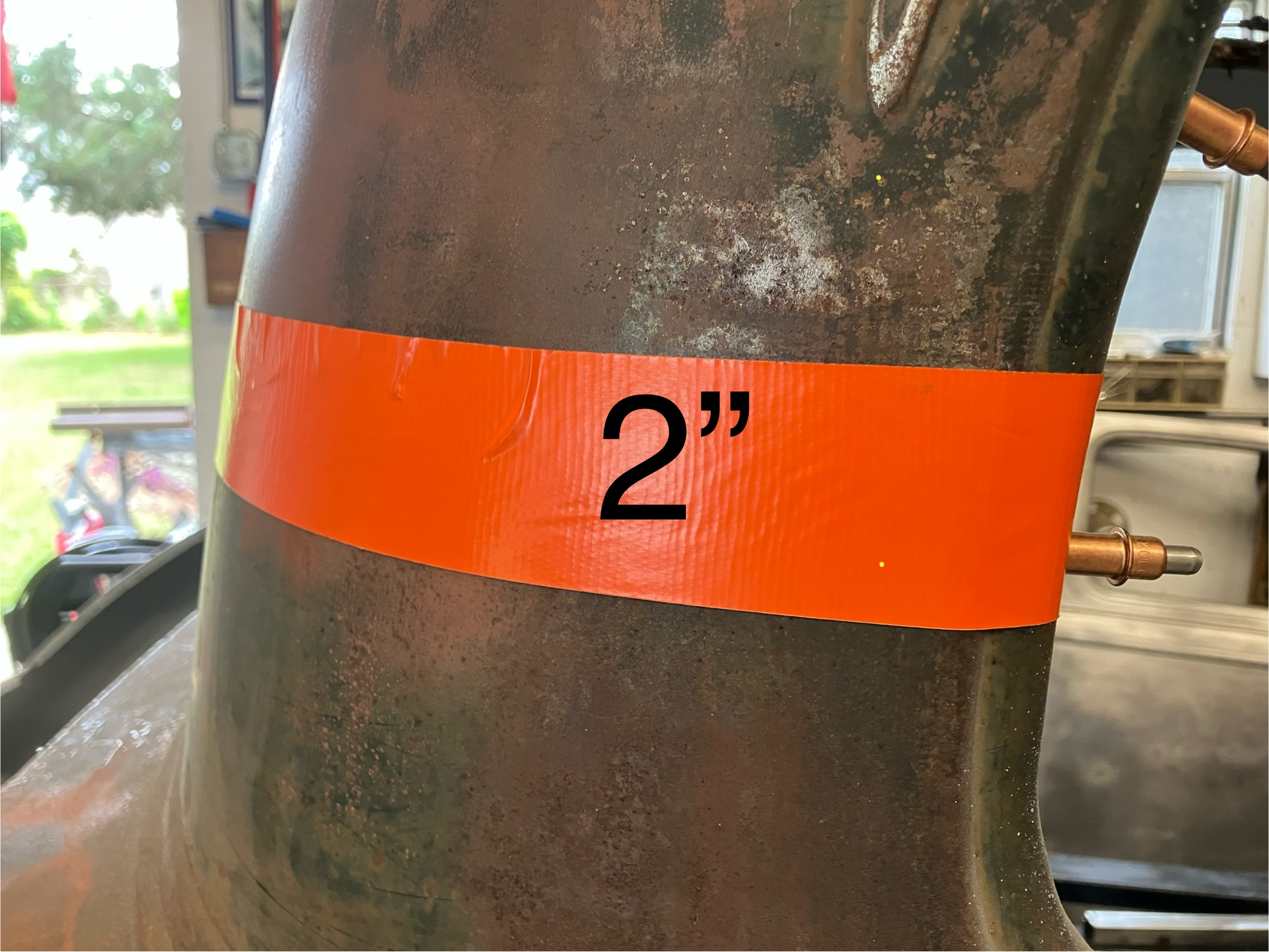

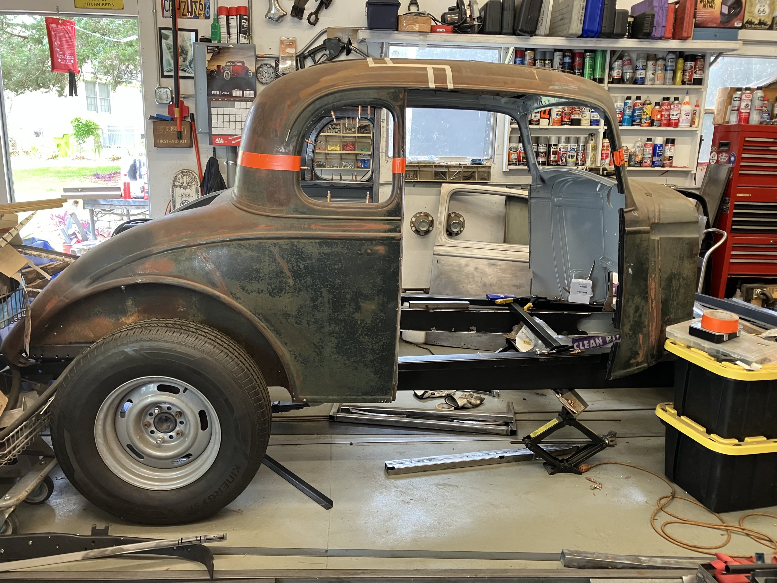

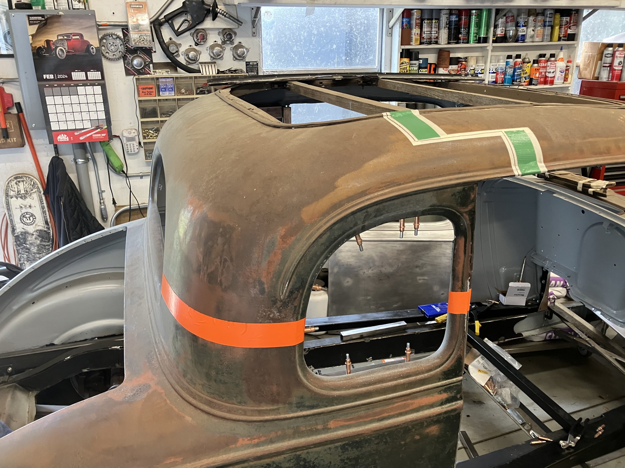

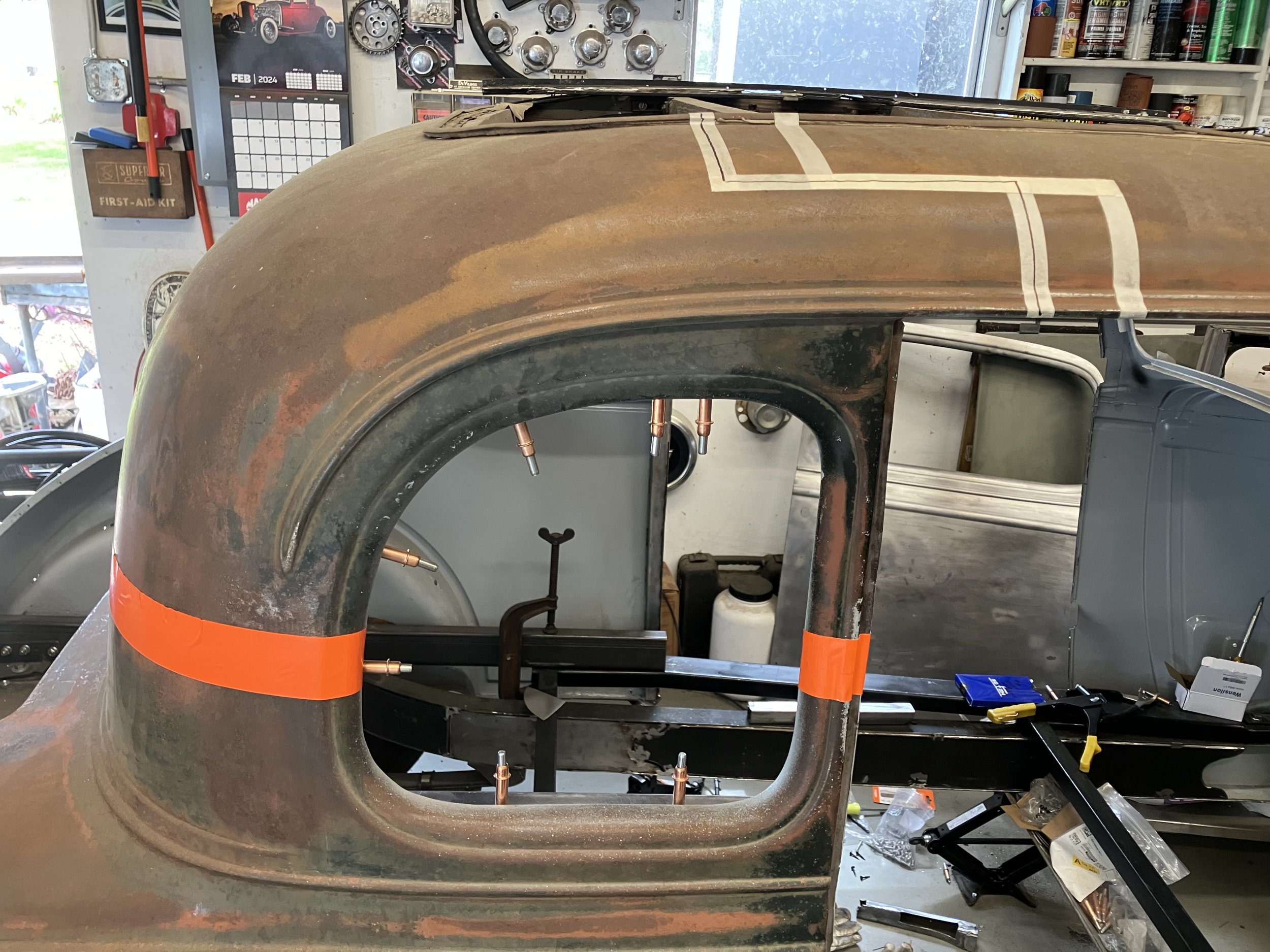

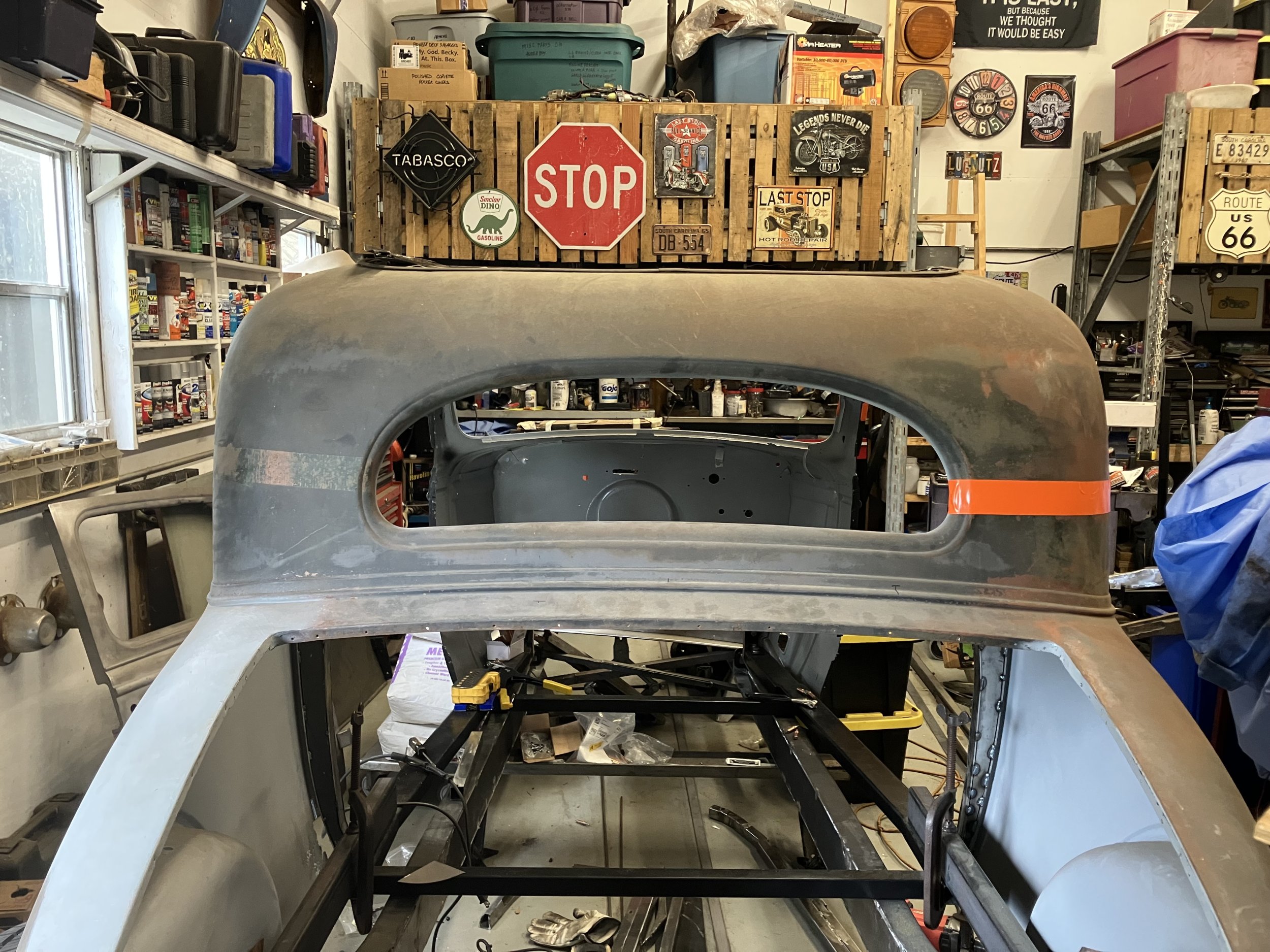

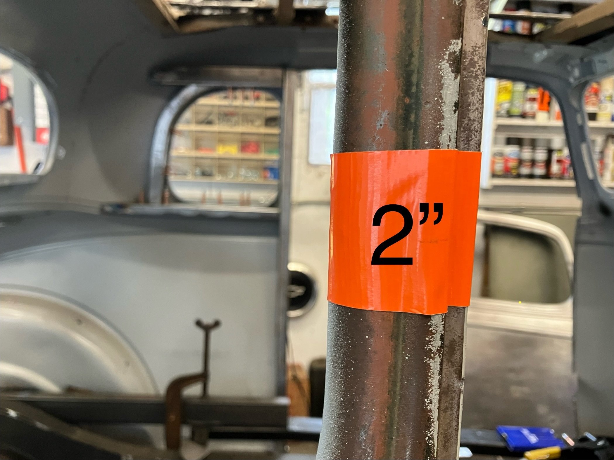

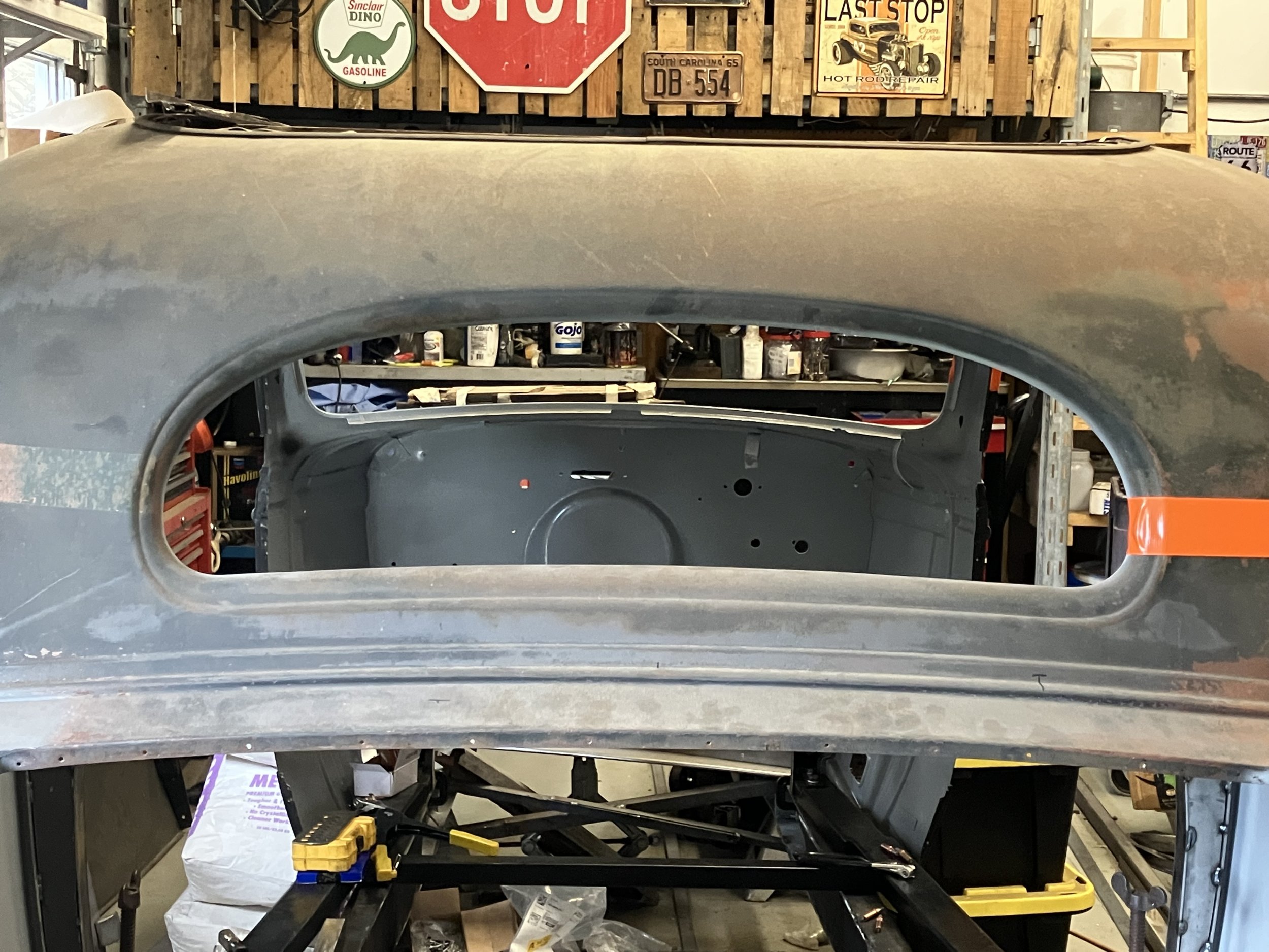

    Fabrication of my front and rear door frame pieces has gone very slowly because of other things in life that get in the way.
    As of today, I have fabricated all four pieces. Next, I’ll secure the front and rear door frame pieces to the flooring subframe.
    Now is the time for me to answer the question “Chop or no chop?“
    I’ve watched a lot of videos showing how to chop a roof. Please look over my plan.
    I think a 2” chop will look really good.
    I hope to Photoshop a photo so I can get a better idea of what it will look like before I start the chop. I found a local guy who was recommended who can help me. I’ve never done this. (The rear axle is not properly positioned yet.)
    IMG_9193.jpeg IMG_9192.jpeg IMG_9199.jpeg IMG_9198.jpeg IMG_9194.jpeg IMG_9196.jpeg IMG_9200.jpeg IMG_9197.jpeg IMG_9201.jpeg IMG_9195.jpeg

    hell man you are starting out with a very nice car.dont bother your **** chopping it.you cant improve on perfect .improve your brakes and lights finish it up and drive it

    Hmmm. Not surprised you recommend the chop. What do you think of my plan?

    I think it's a good start mine was done the same in the rear. are you planning on putting in a roof panel or putting in the wood structure?
