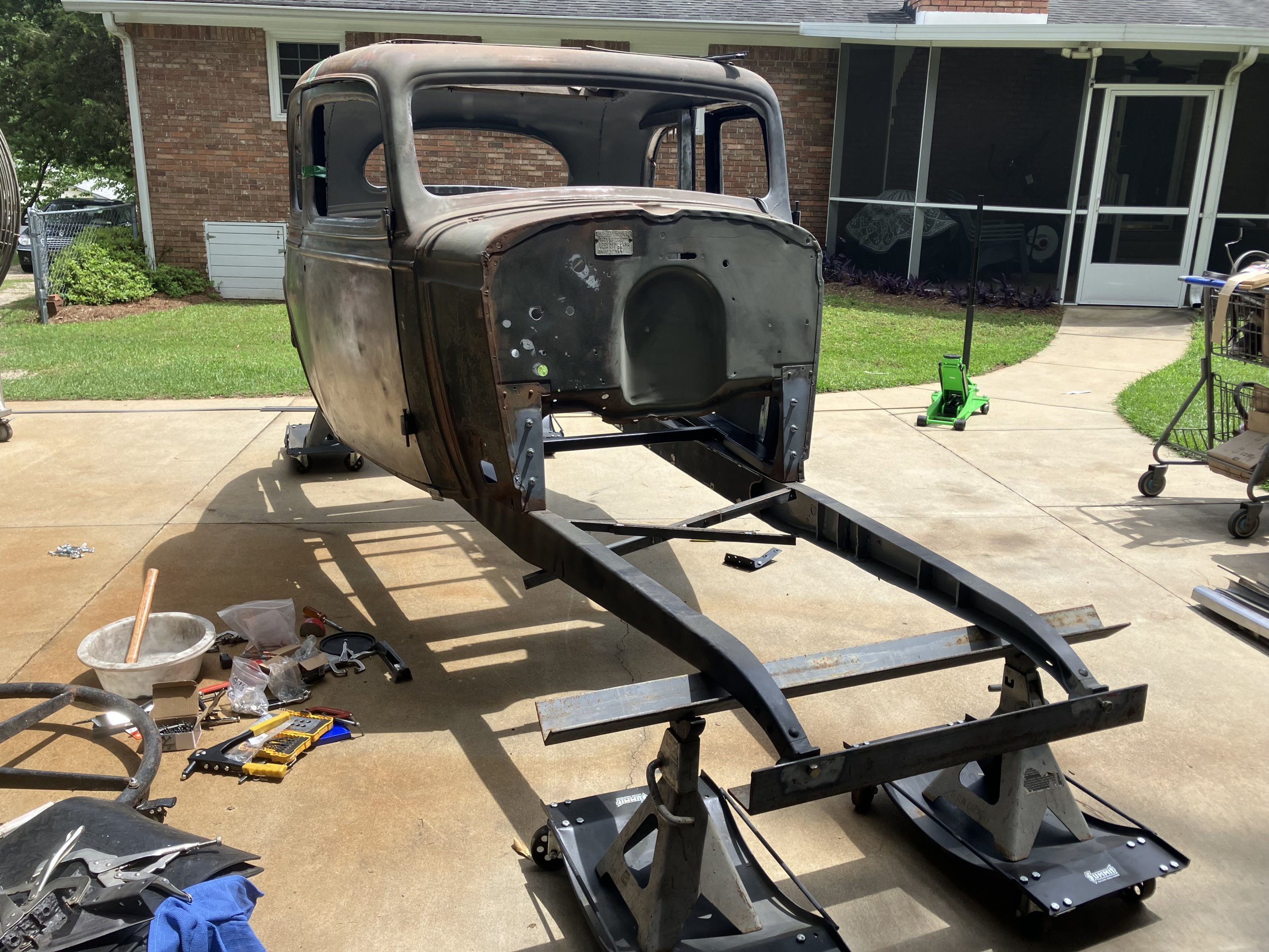

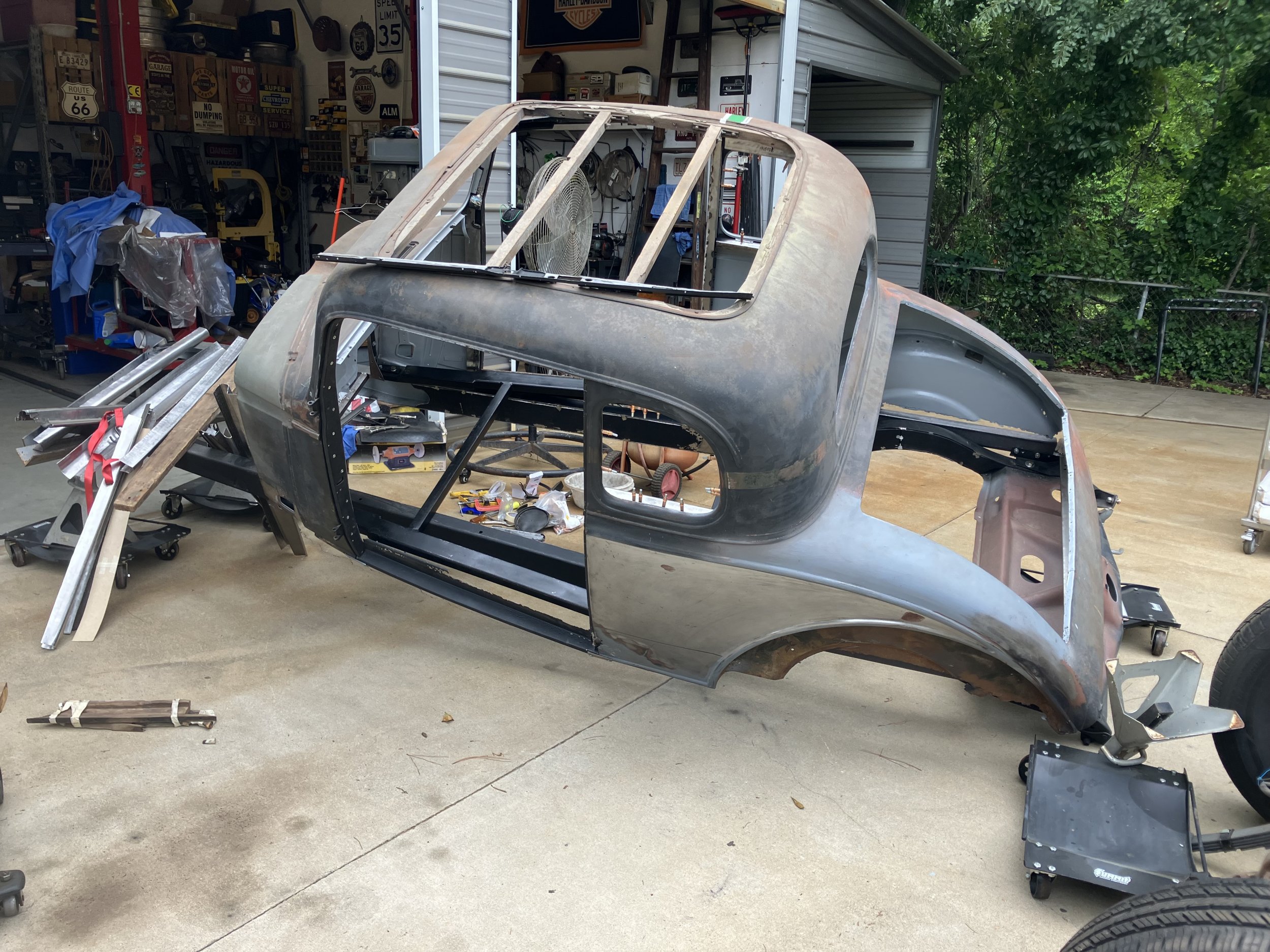

    Got the door pillars installed to the sheet metal. Doors align pretty well. It’s coming along. The jack stands are just temporary.

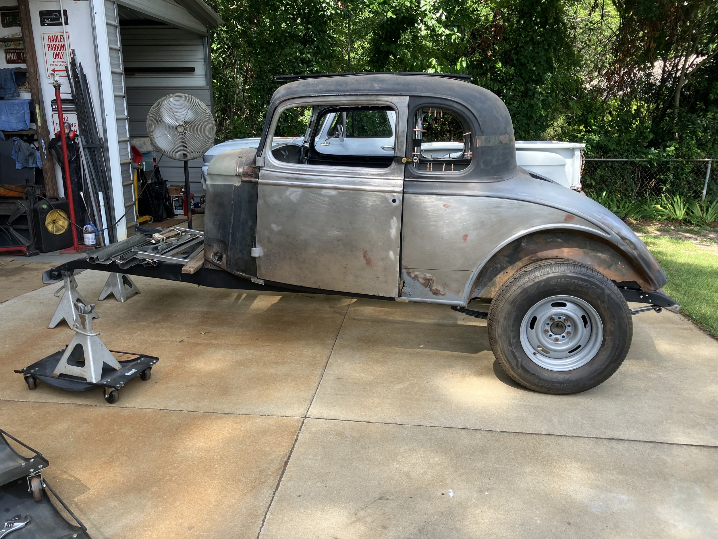

  18. Jay Altemus
    Joined: Dec 24, 2023
    Posts: 270
    Jay Altemus

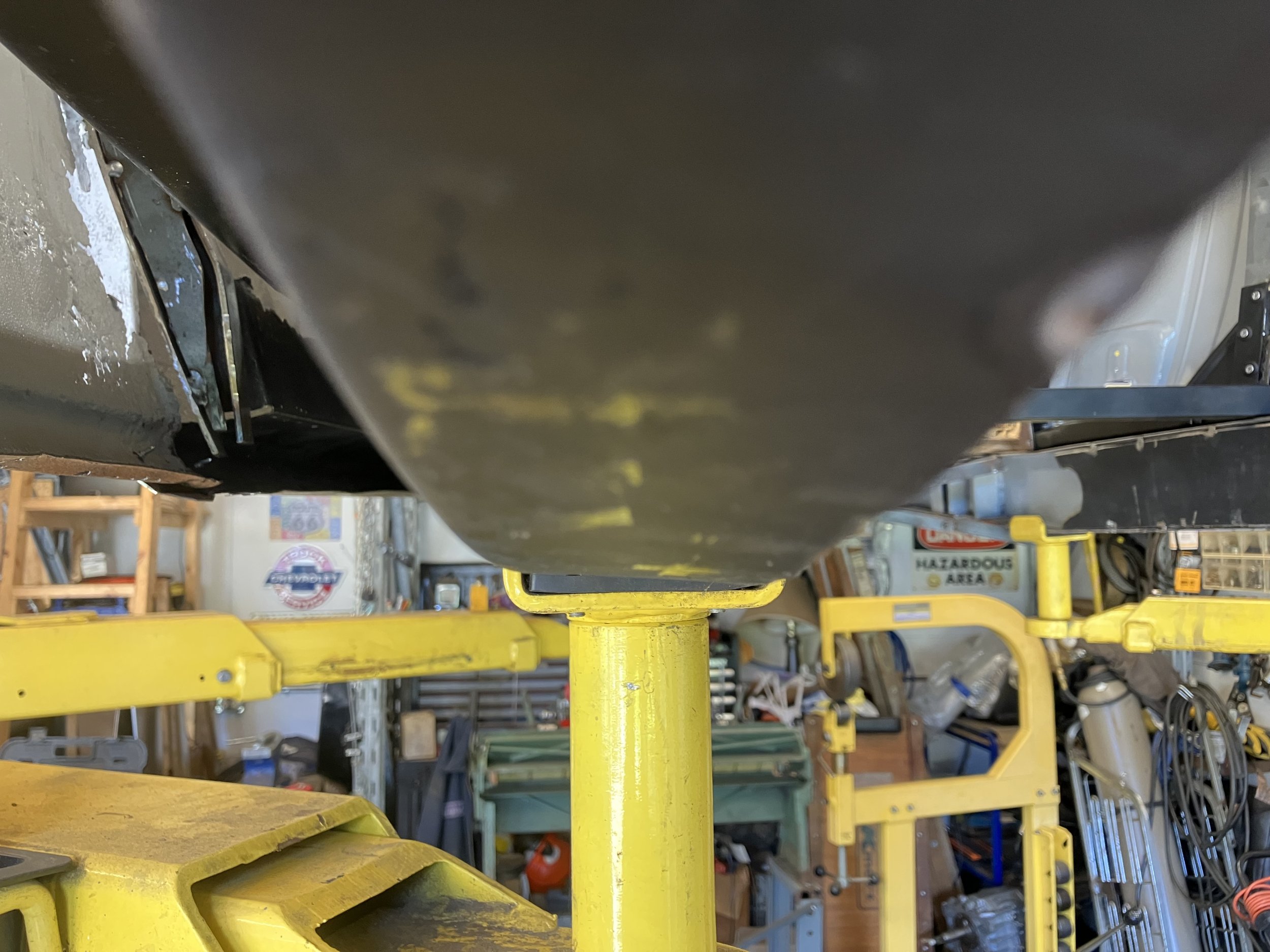

    You mean THIS pic?
    Well, . . . . Now that you mention it. Yes, that was MY coupe. Operator error. Not equipment failure. One dolly was up against a tire and I kept pushing. Slow graceful tip over. Zero damage. Back up on the stands 5 minutes later.
    The precarious “jack stands on dollies” is a VERY temporary solution. I needed some walk around room so I could square up the doors and door frames and my shop is too cramped.

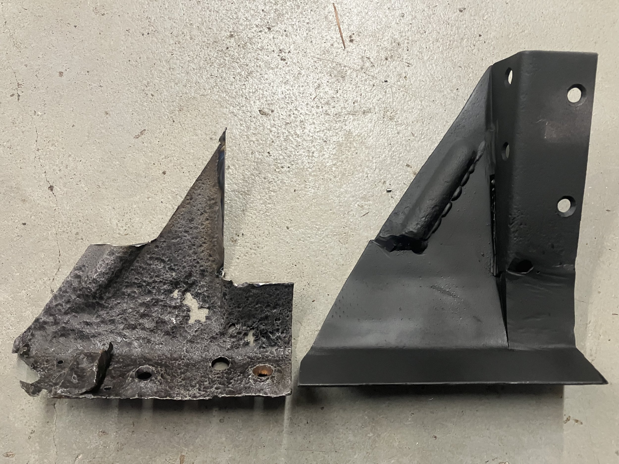

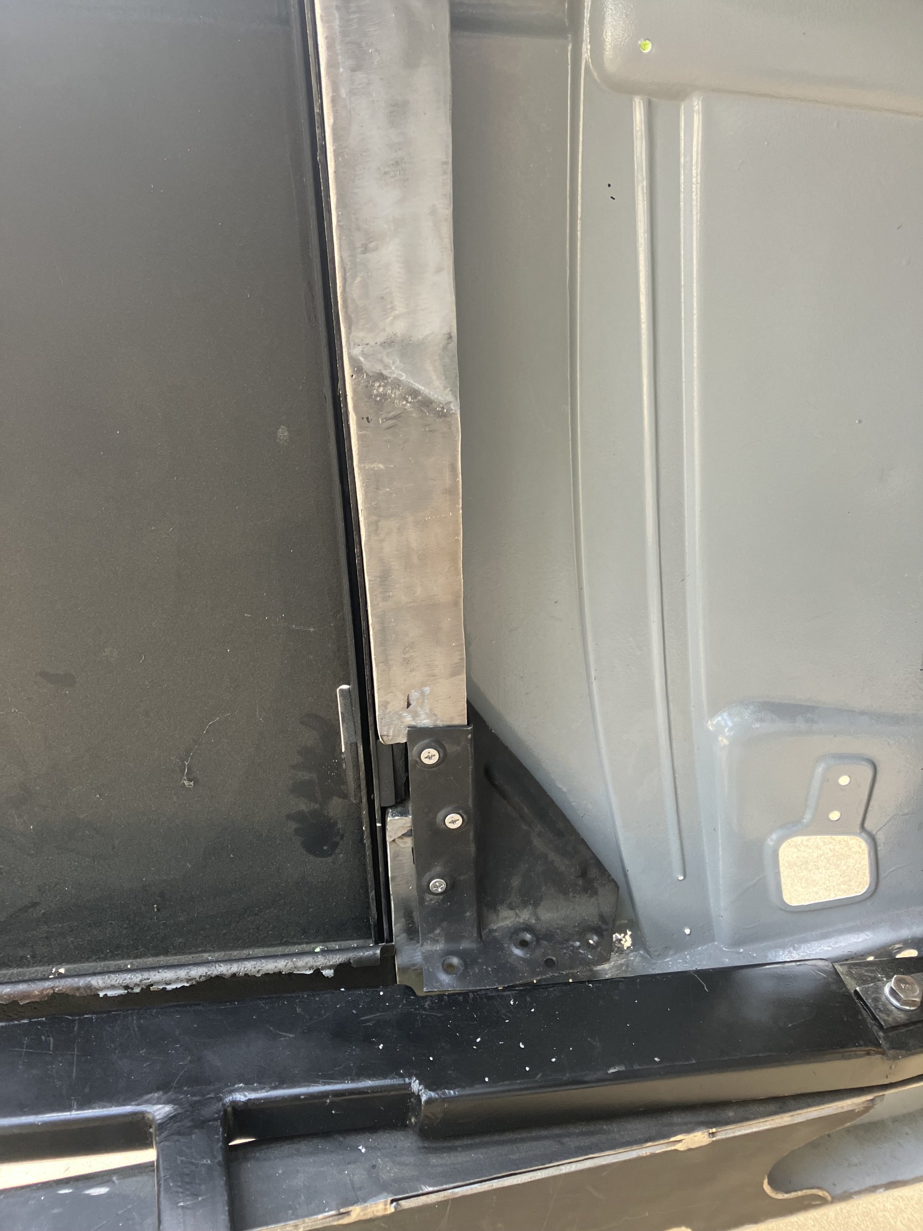

    Just so you know I’m still working on my 34 coupe . . .
    I patched this original DS rear door frame support bracket this weekend AFTER returning from a weekend of Chevy truck fun in TN.
    I hope to square up the door frames and doors this weekend.

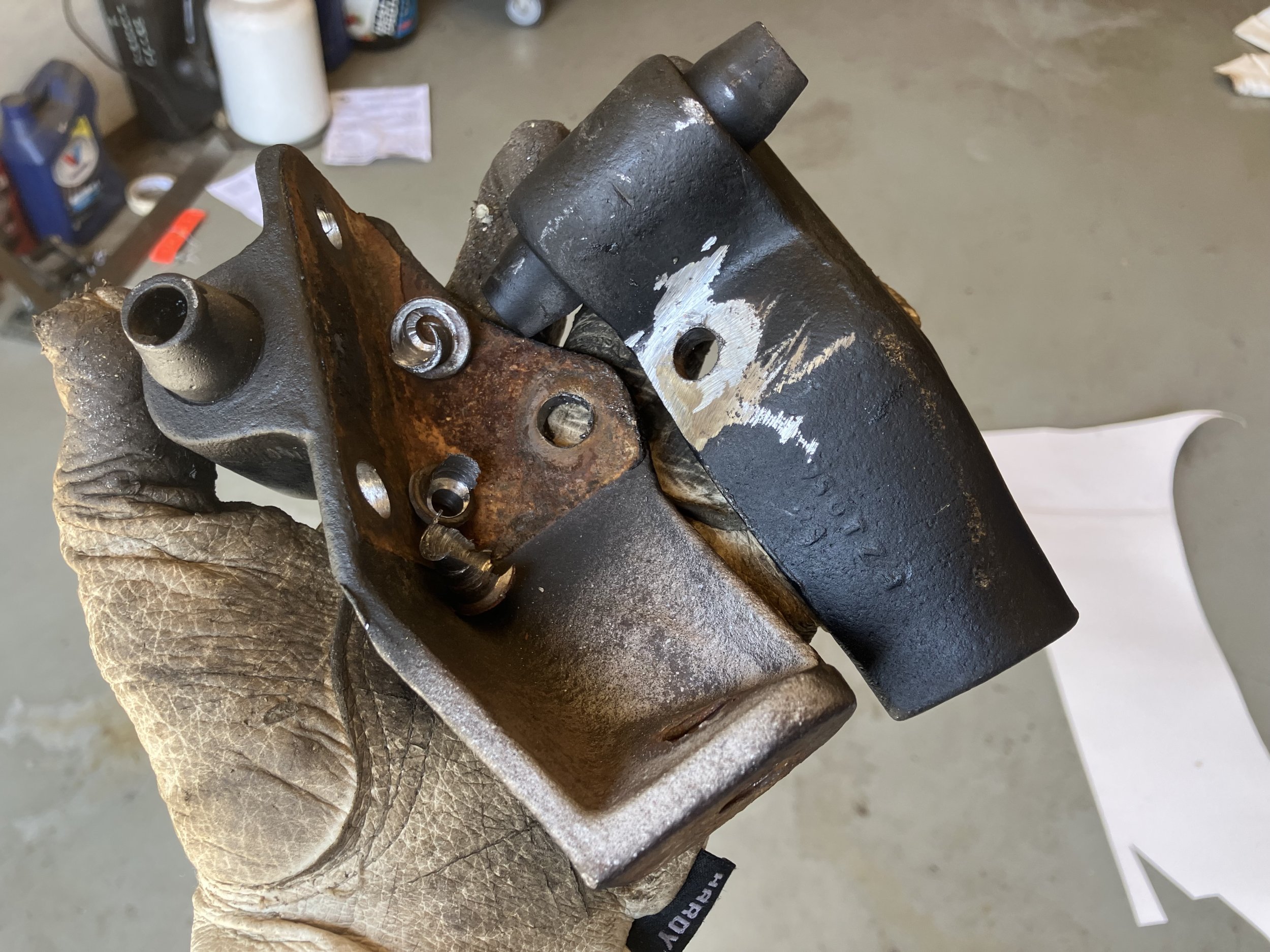

  24. Jay Altemus
    Posts: 270
    Jay Altemus

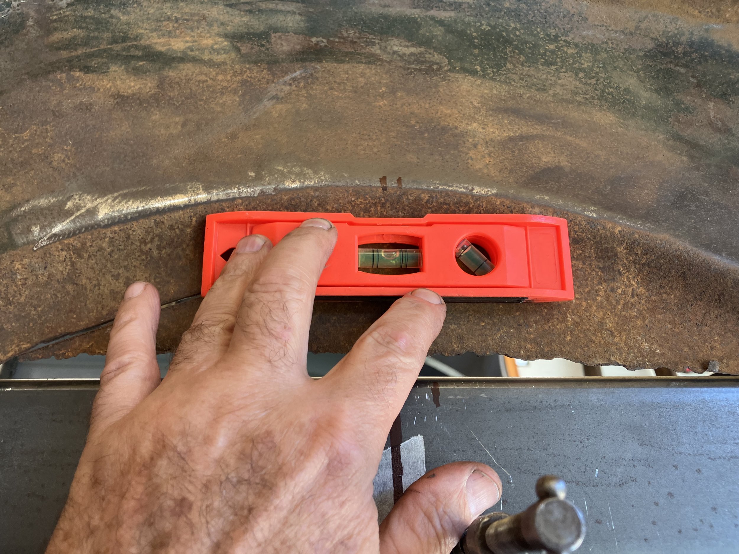

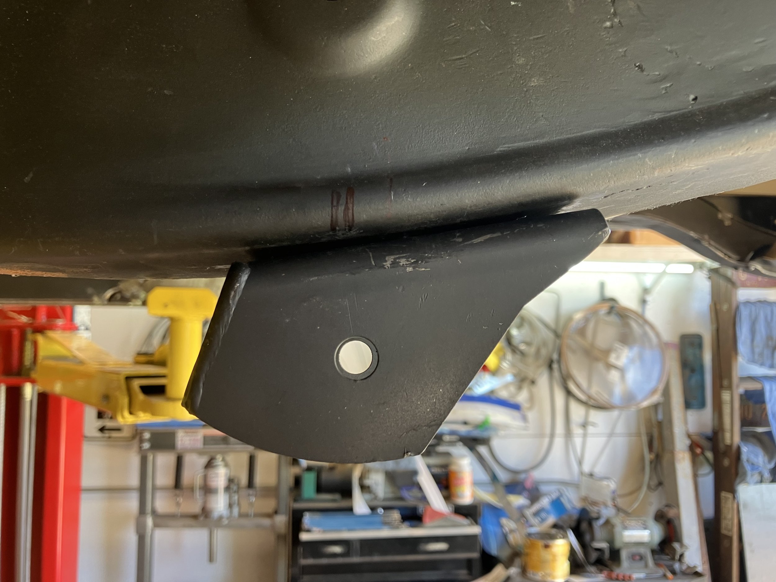

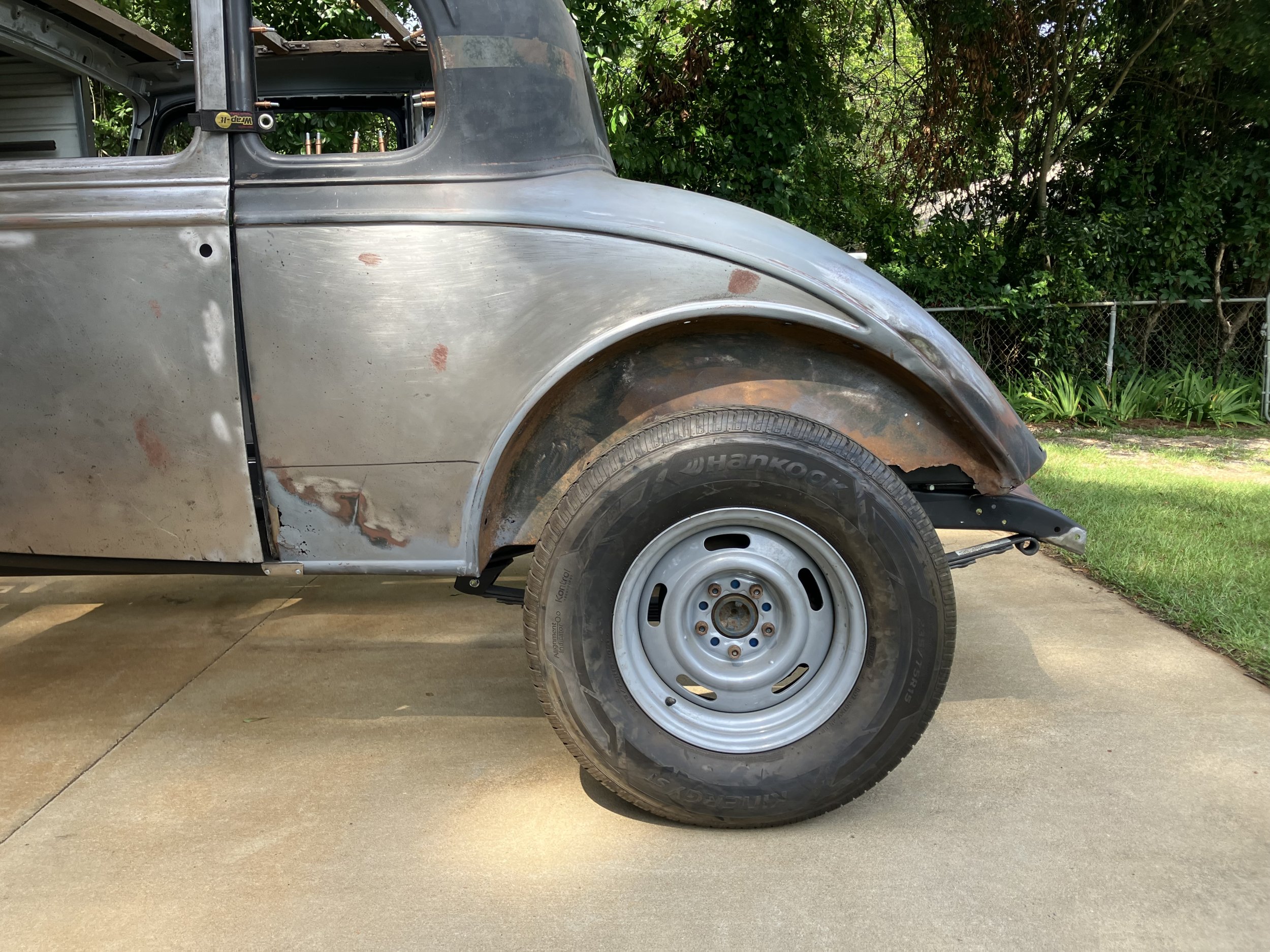

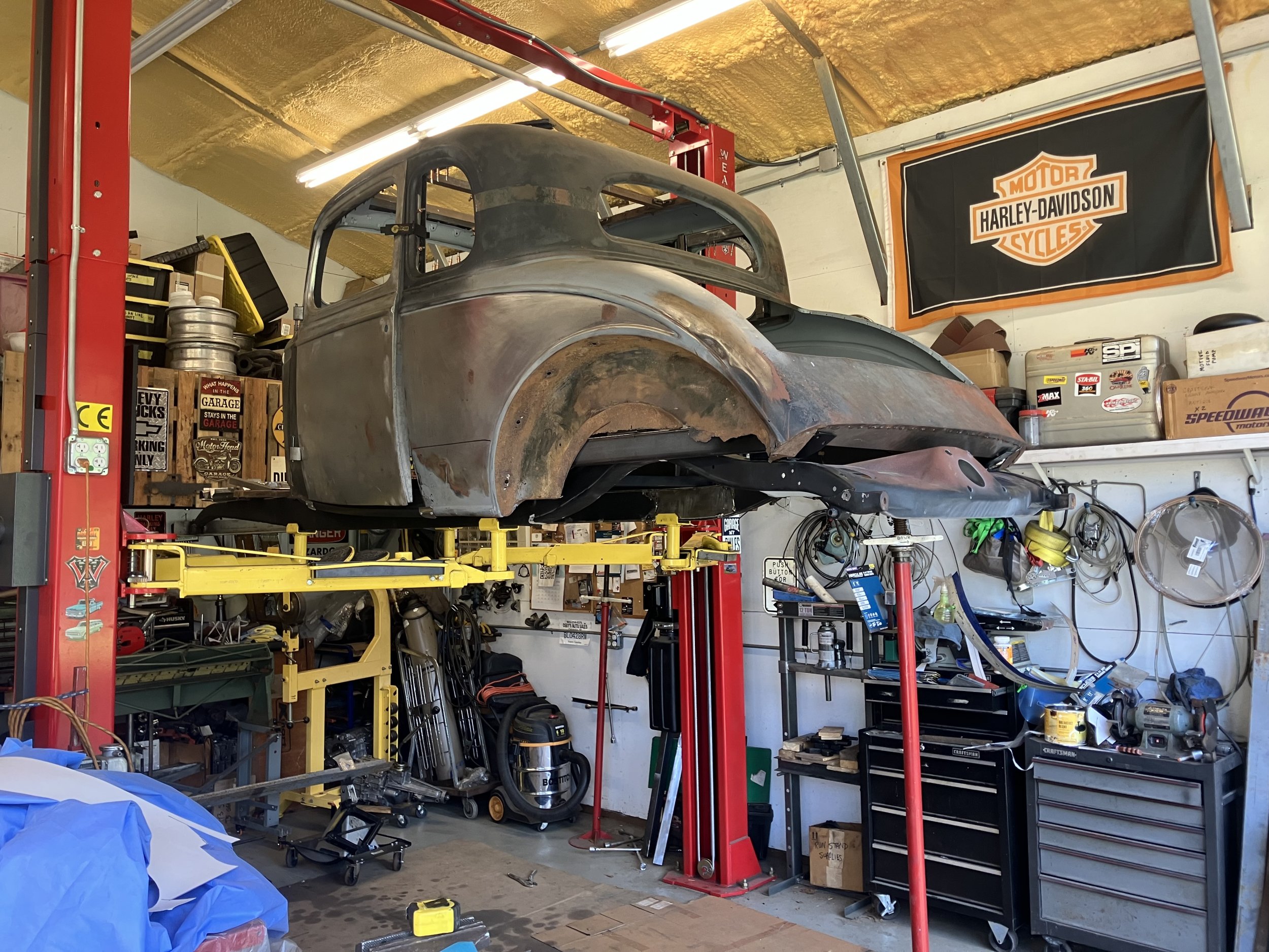

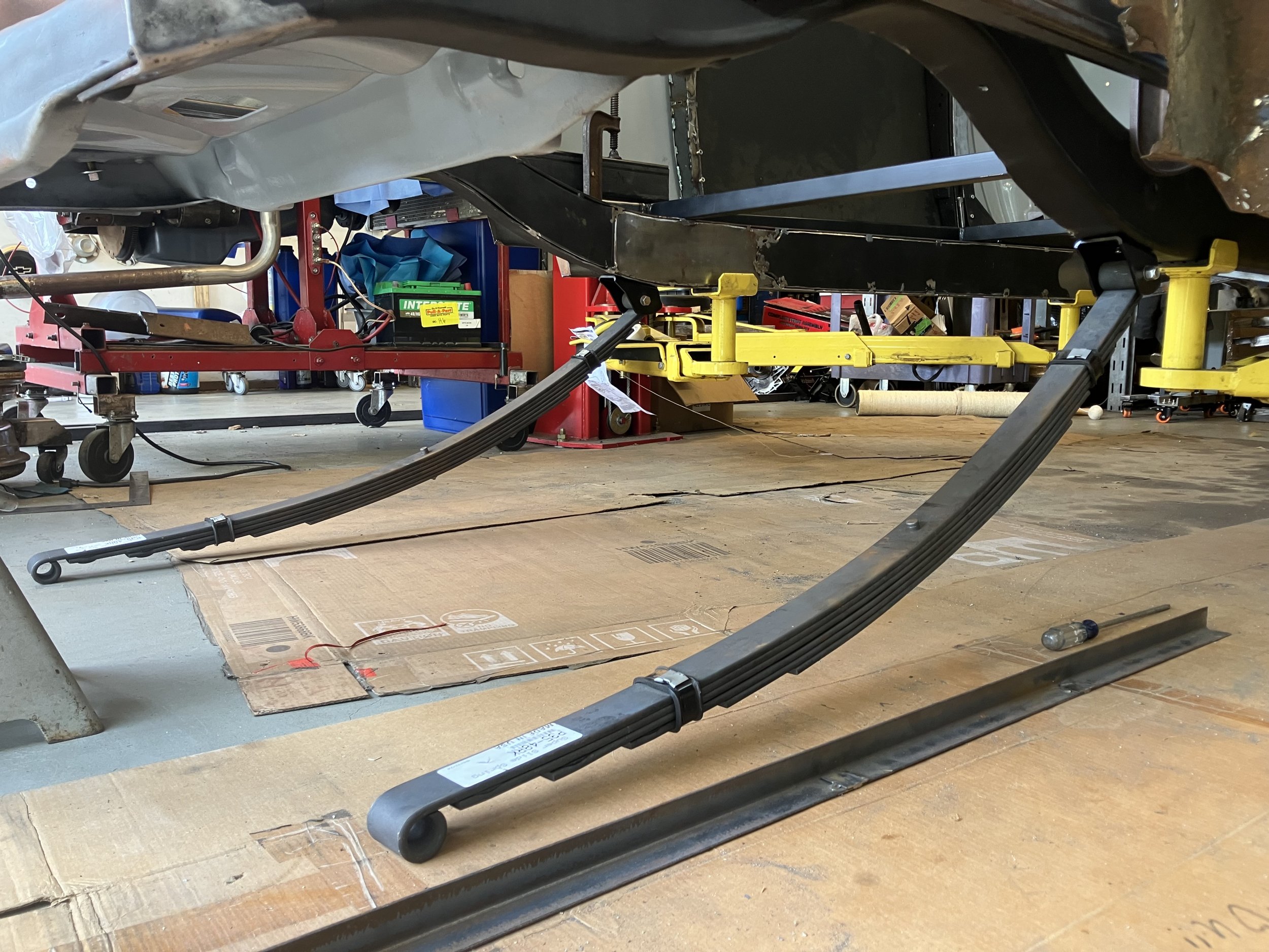

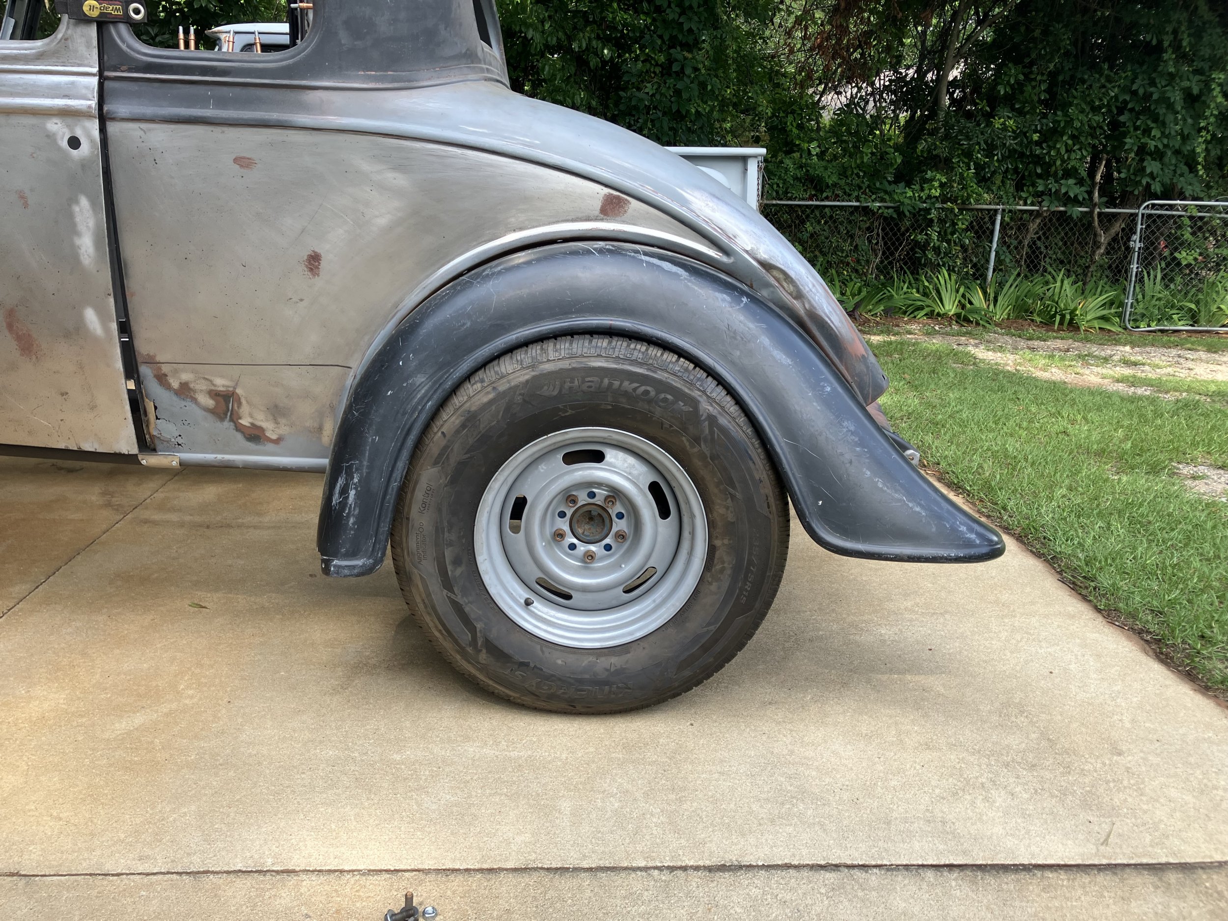

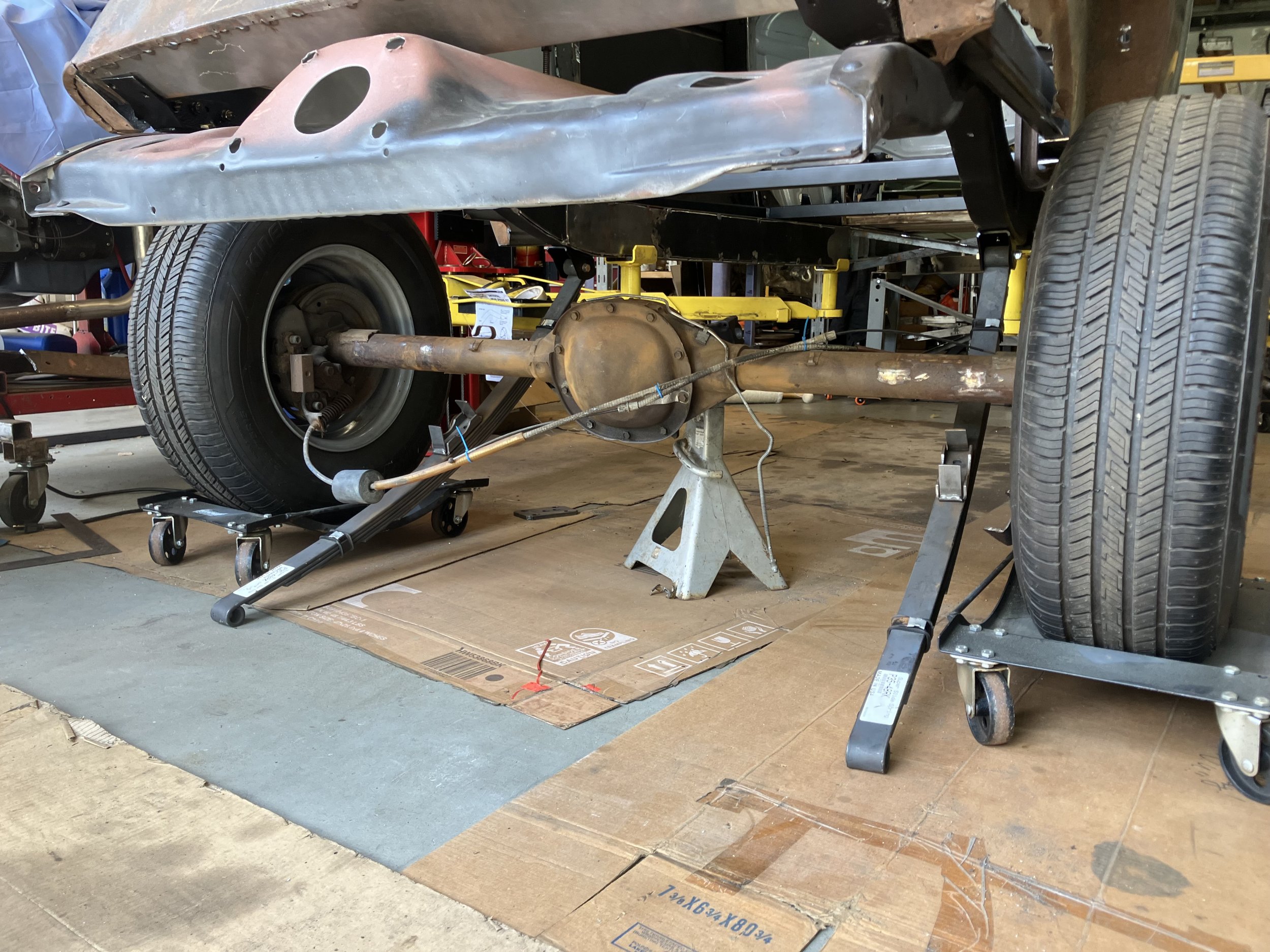

    I had a productive day in the shop. I had planned to square up my doors and door frames. I decided to mount my rear leaf springs and axle instead. The rear frame brackets had to come off because they interfered with the planned location for the rear shackles.

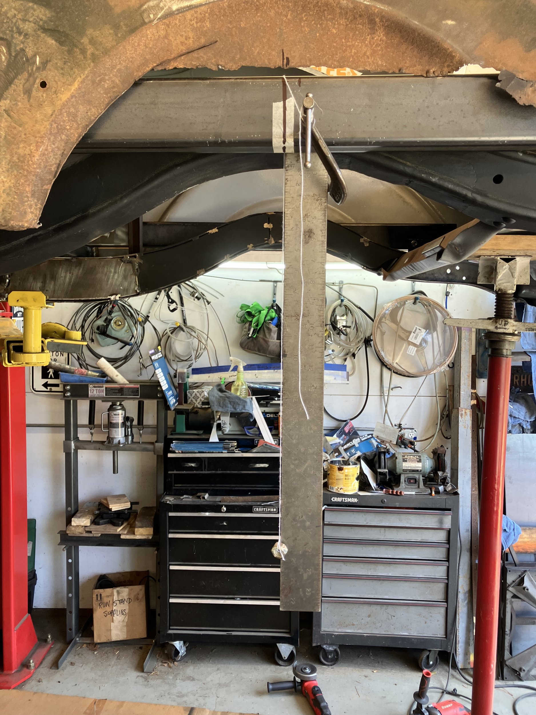

    I used a small bubble level to find the highest point of my frame arch. The body is pretty much where it should be. The highest point of the wheel well lined up with the frame arch which was what I was hoping for.

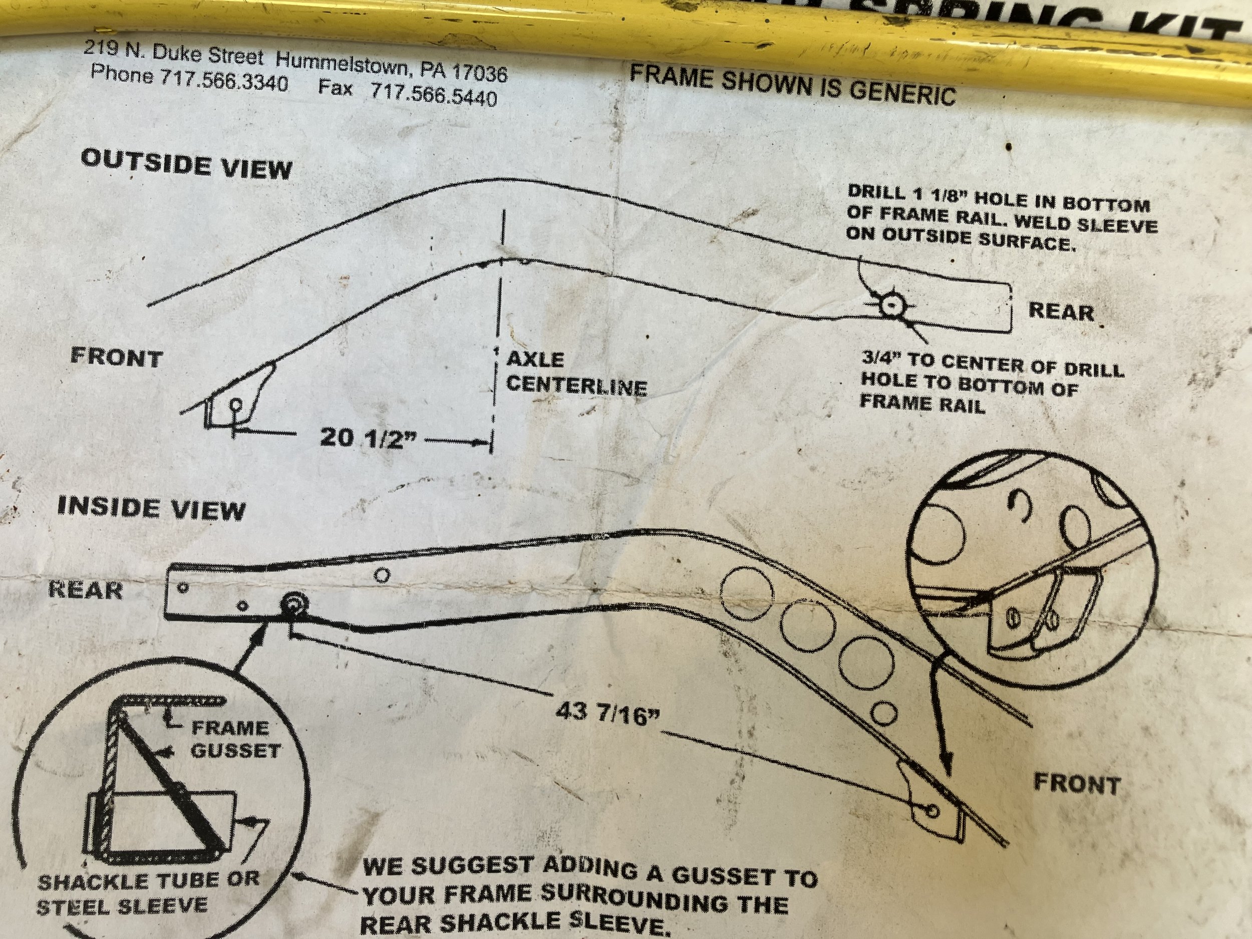

    I dropped a plum line and lined up a carpenter’s square with the plum line. Then measured according to the instruction sheet. The front brackets were mocked up with a single screw so the bracket can swivel. I’ll tack weld the front brackets in place AFTER the rear shackles are attached to the frame. That way I can be sure the front brackets are perfectly lined up with the rear shackles.
    I think the axle and tire look centered in the wheel well. I am pretty happy about that. If anything has to change, it might be that the body might move forward 1/4” - 1/2” max.
    My 87 Camaro rear axle is too wide. So I might search for an S10 4x4 axle which is supposed to be just right. I like the 3.23 Camaro axle gear and disc brakes, so I might have it narrowed.

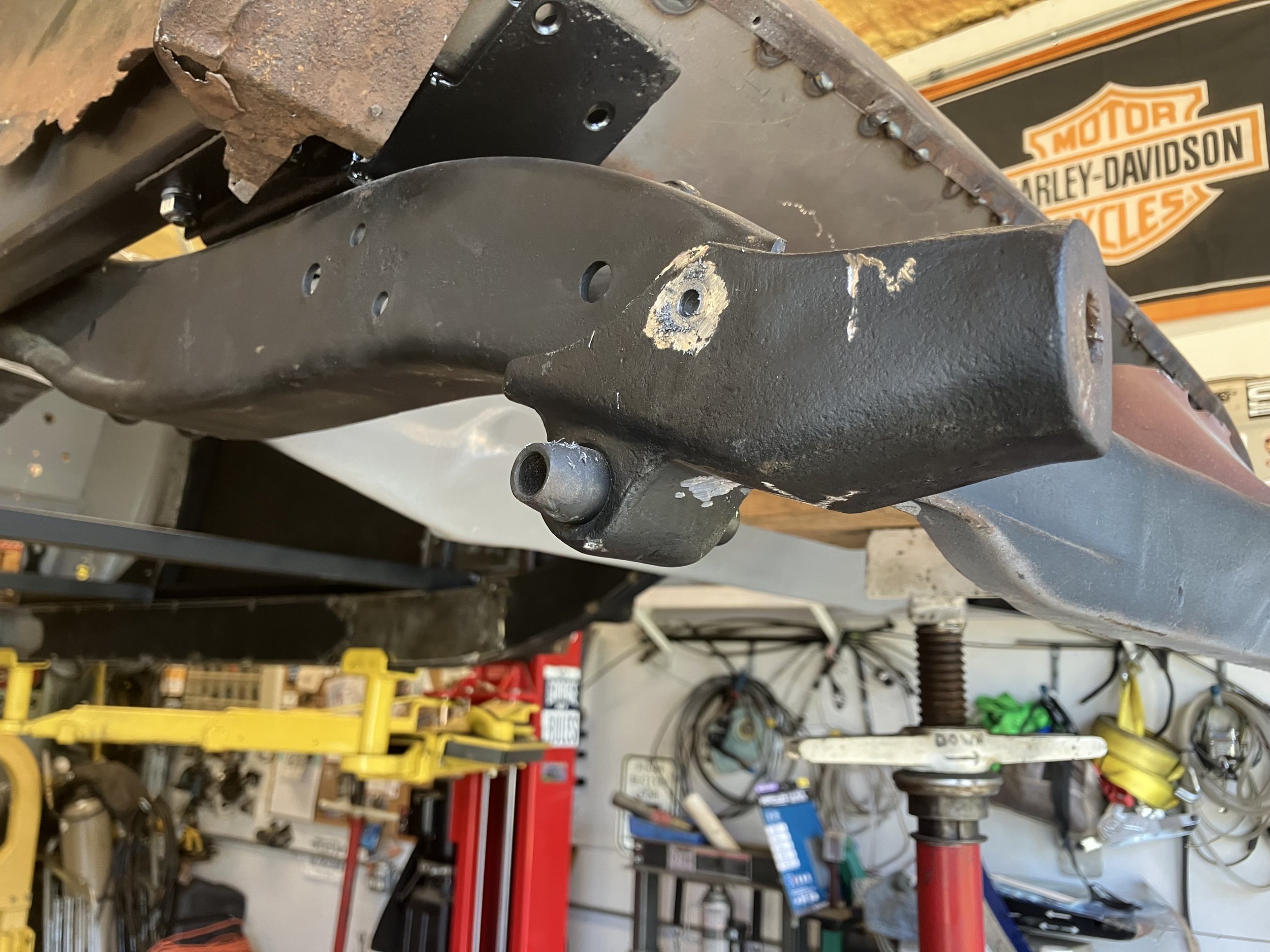

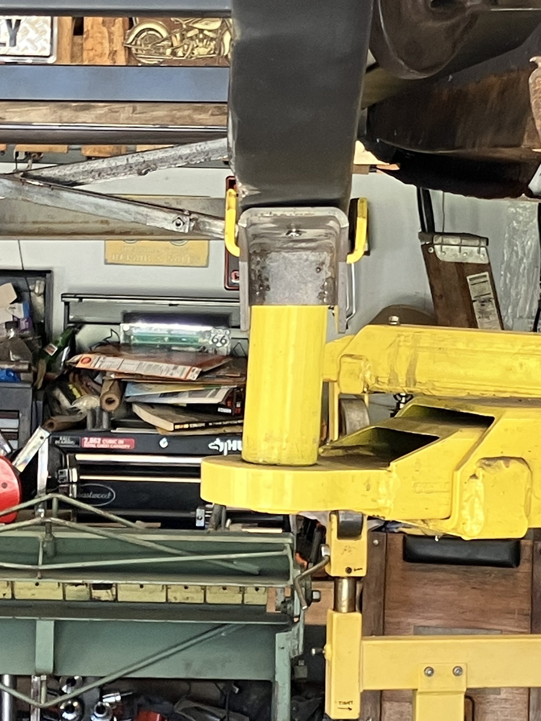

  25. Jay Altemus
    Posts: 270
    Jay Altemus
    Here’s a technical question.
    The bottom flange of my frame is not perfectly parallel to the earth. Therefore the leaf spring front brackets are not parallel to the earth. Do I need to add a shim to make them level?
