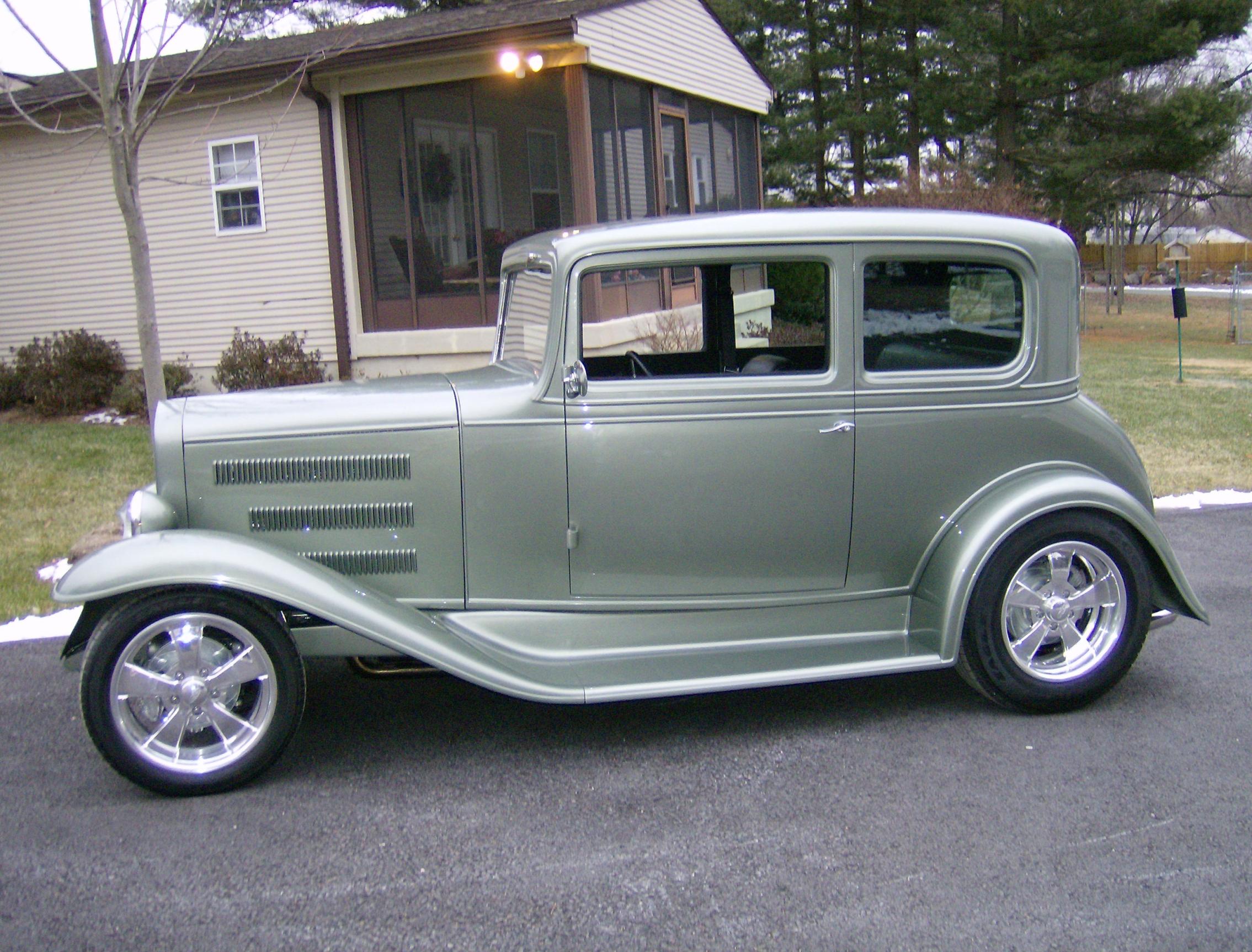

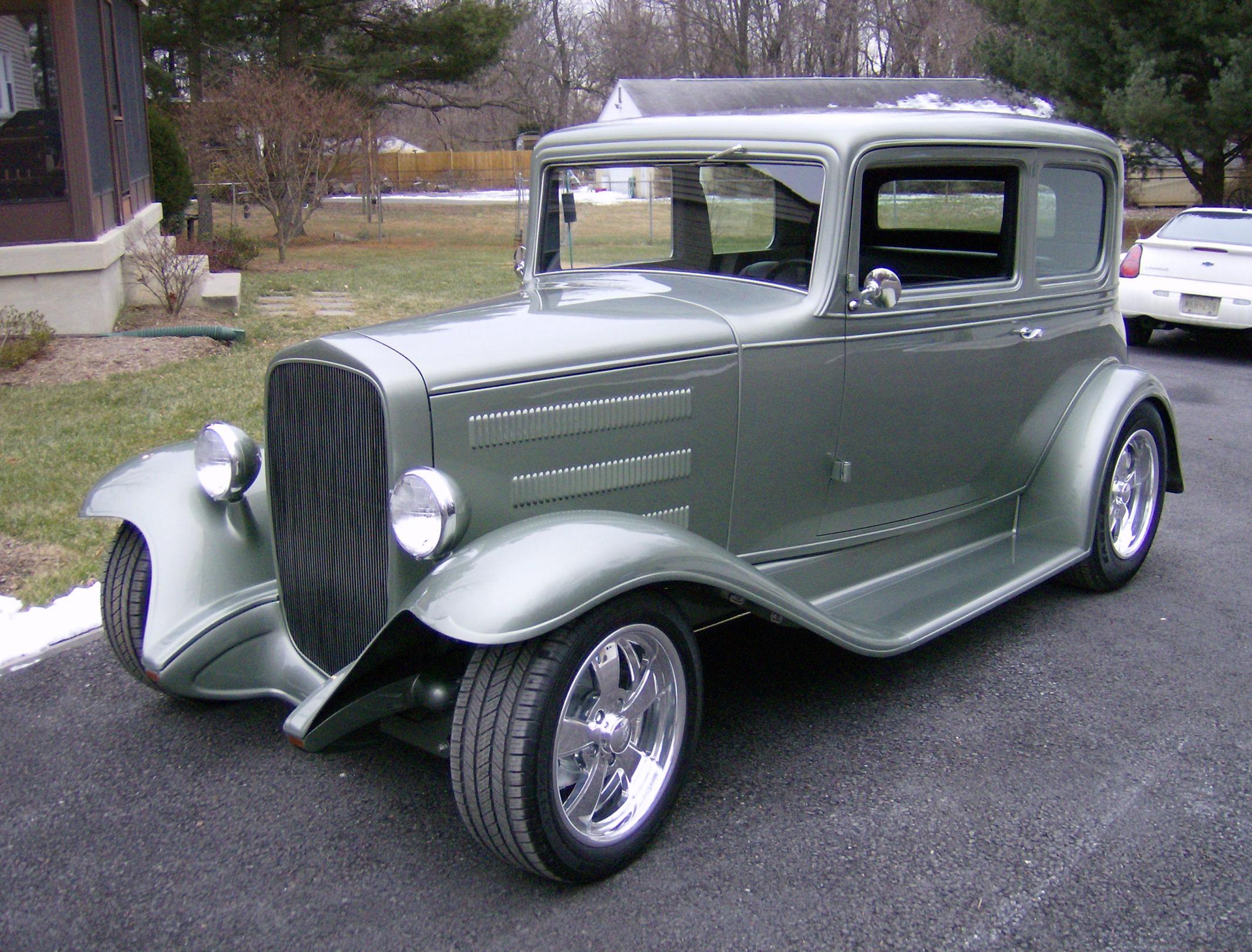

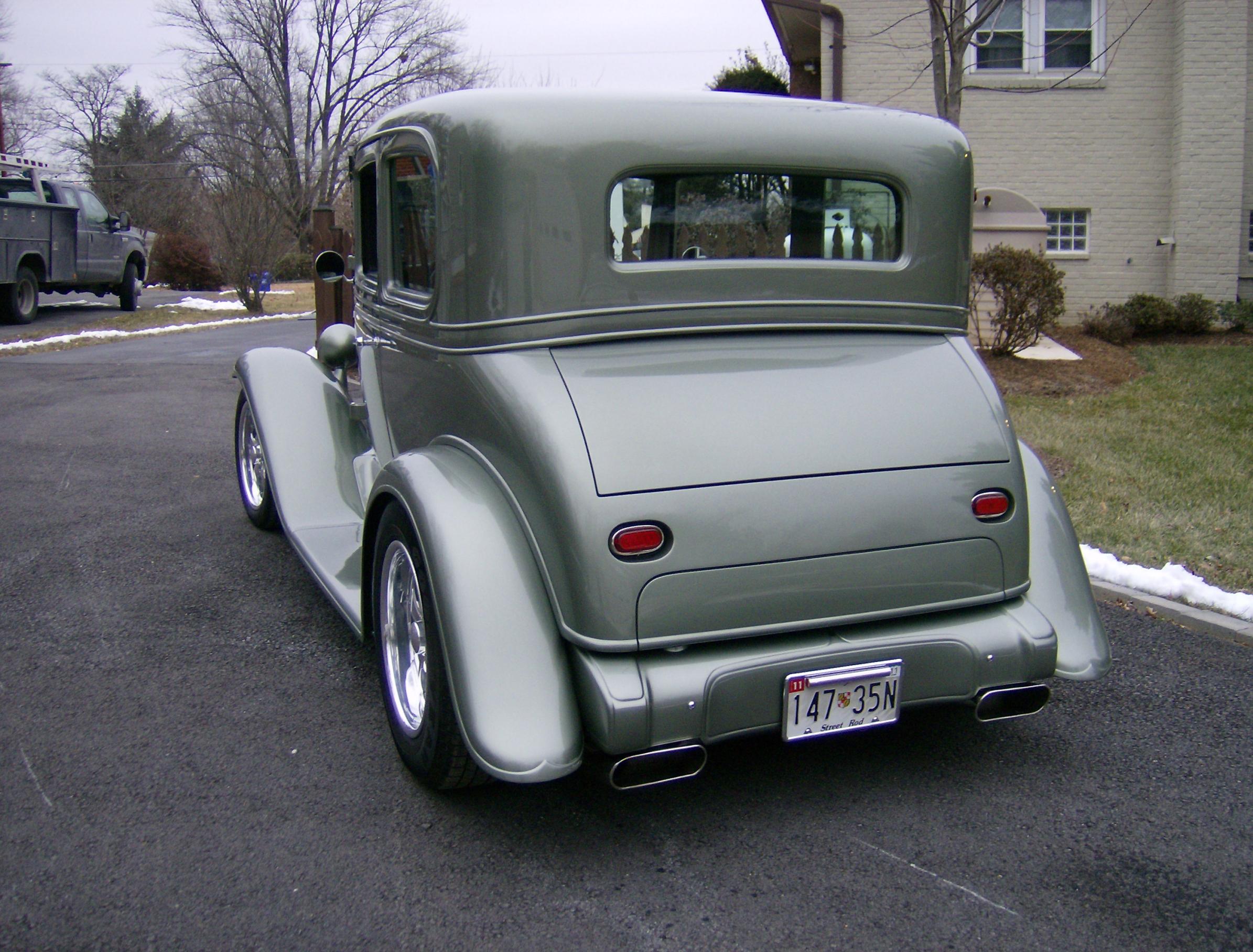

    This is my 1932 5-Passenger Coupe that I am finishing up.

    Jackt1932, that car is beautiful. Total class. Gary

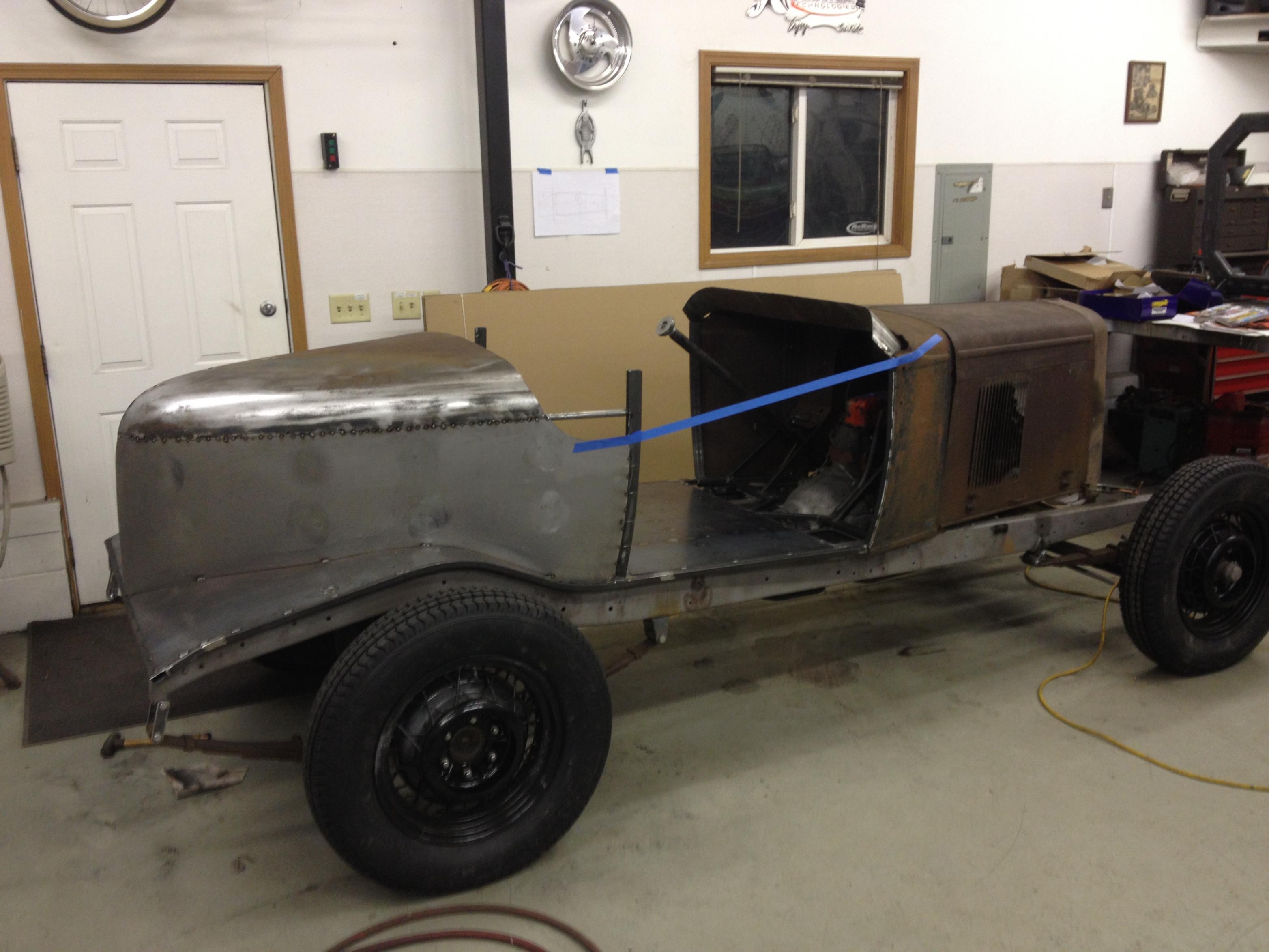

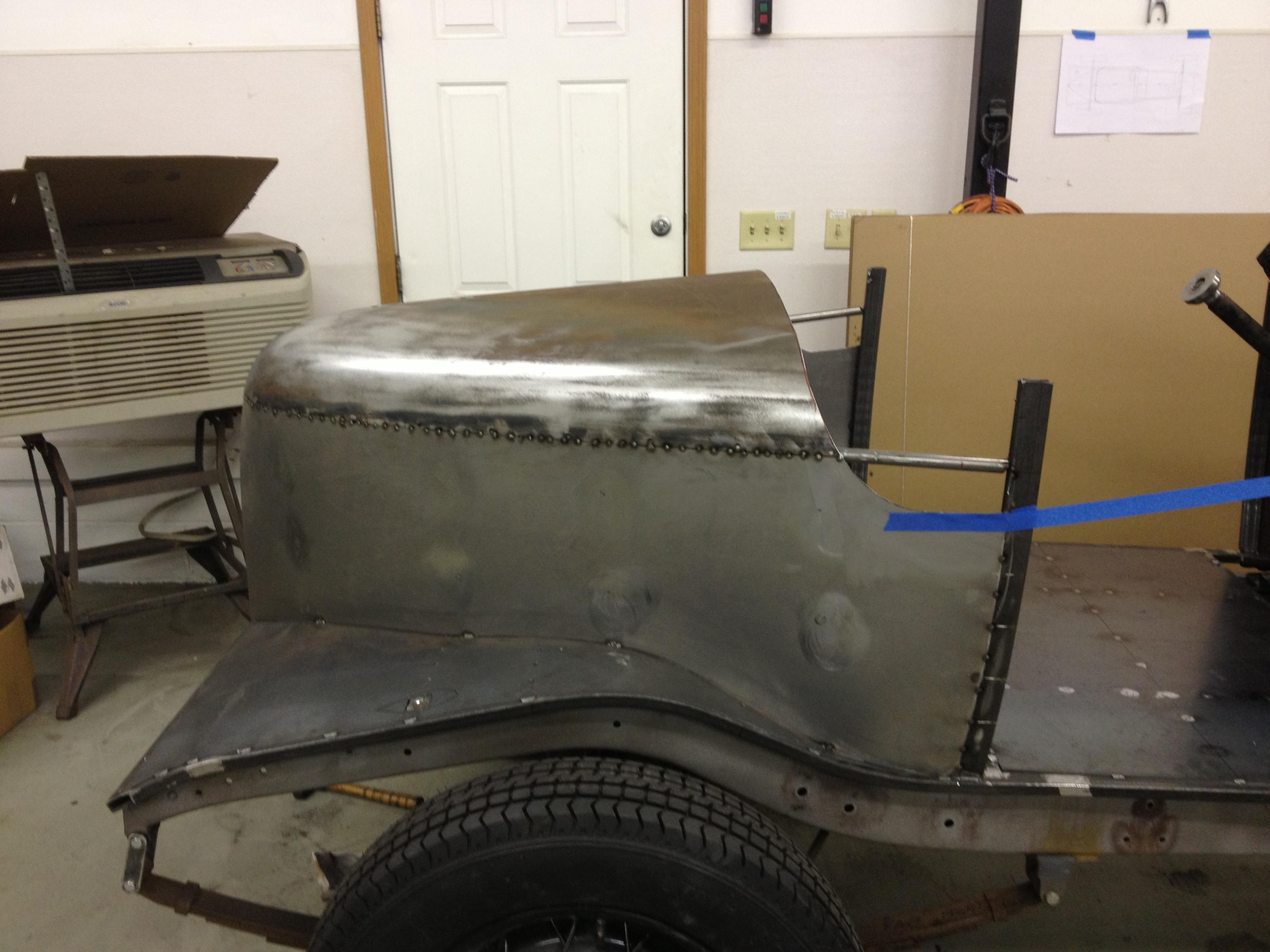

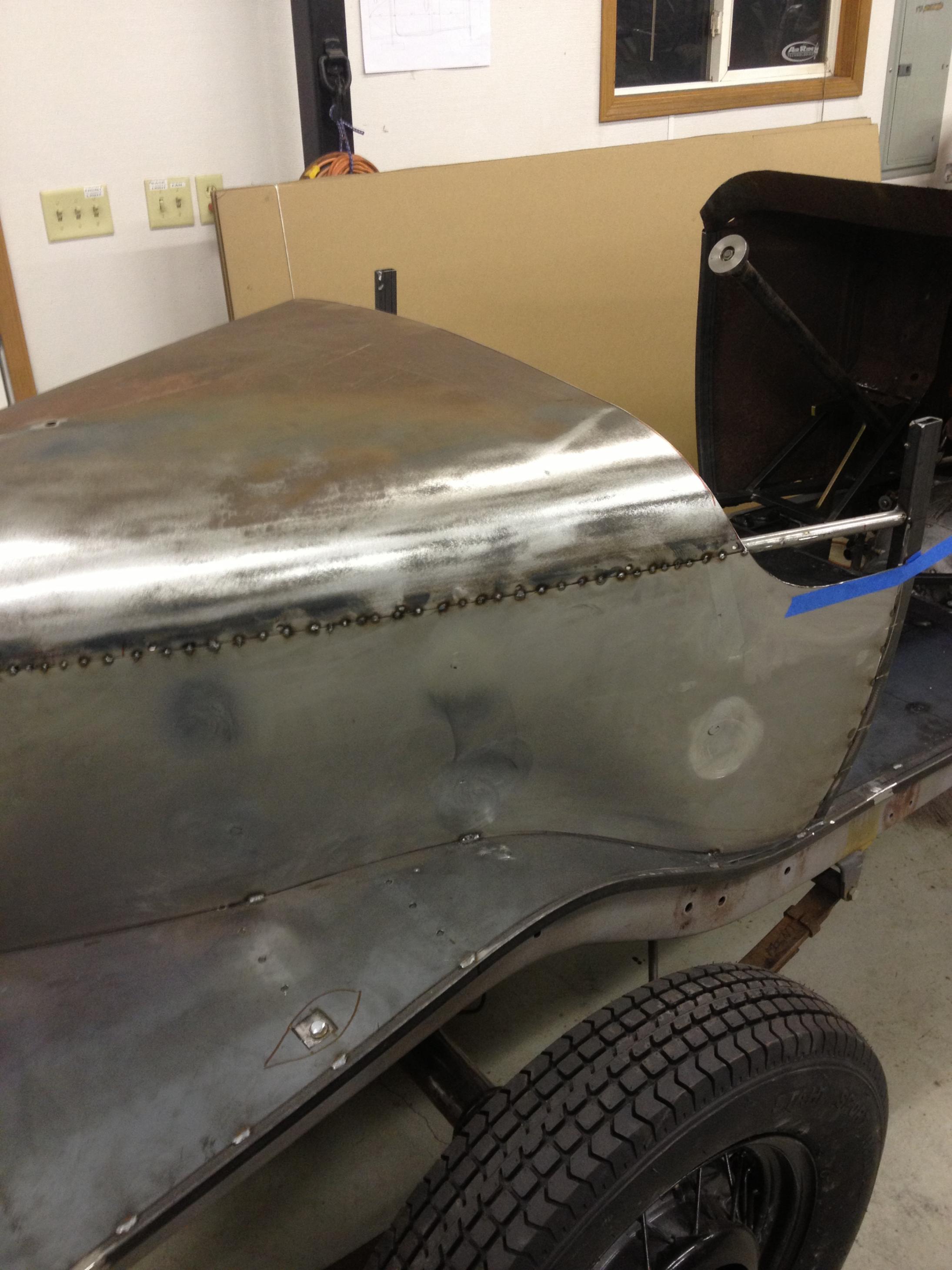

    Monday night at the shop. This weeks pictures. It's been a blast to make so far. I love the Early Chevy Group. Gary
    mgtstumpy likes this.
  5. Looks nice!
    Have you thought about taking a piecut out of the top of the cowl to give it more of a roadster profile?

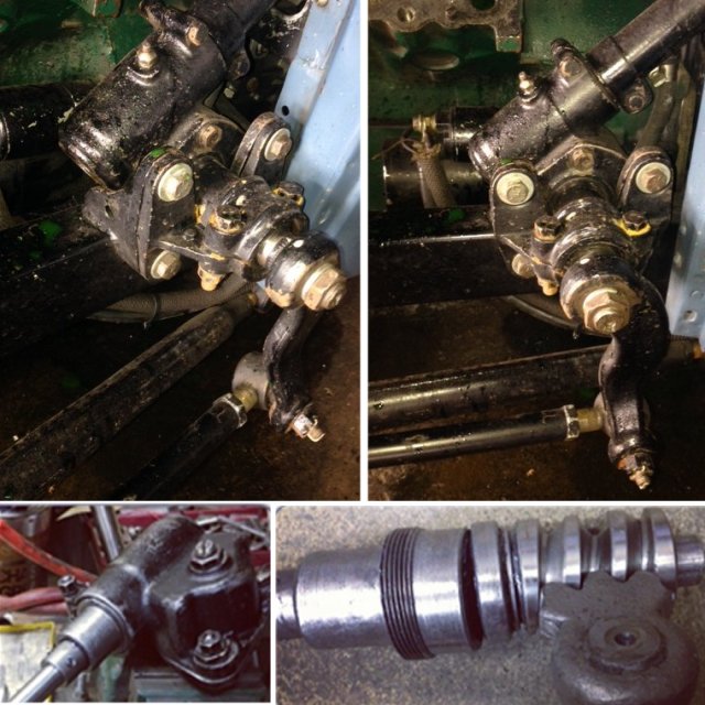

    Help! Need 1930 chevy steering box worm shaft, rebuilt box or NOS box
    I surely removed this from 1930 chevy.
    Probably it's Saginaw steering box.
    look like a 1936 1/2-1 1/2 ton steering gear..
    However, NOS steering box is difficult to find here.
    So I rubbed a worn gear together last year though it's not smooth .
    It is smaller than Vega and 32 Ford steering box.
    And my Hot Rod cannot put on a big steering box any more.
    Bracket is needed to remake though model A box is similar shape and size to this.
    And because headers, drag link, starter motor each clearance are so tight, I built a bracket to fit the shape of the box.
    I got the advice from HAMB member.
    http://www.jalopyjournal.com/forum/showthread.php?p=9570316
    My worm shaft original parts number is 261489.
    And sector gear original parts number is 262946.
    Worm gear 261489 was 500 dollars though sector gear was easily found in ebay.
    I do not have the budget to buy worm by such a crazy price.
    I am looking for worm shaft, rebuilt box or NOS box.
    Does any of you have the info?

    I hate to use this thread weekly but here is the latest. Cockpit has been formed with tubing and it's taking shape. Thanks again to Roadburner1 for all the fabrication skills. Oh, I just received two Brooklands windscreens to sit on top of the cowl extension. They look awesome. Gary

    That is really looking good. It is going to be a lot of fun to drive.
  13. 2ndchance, nice work. That'll be a really cool ride.

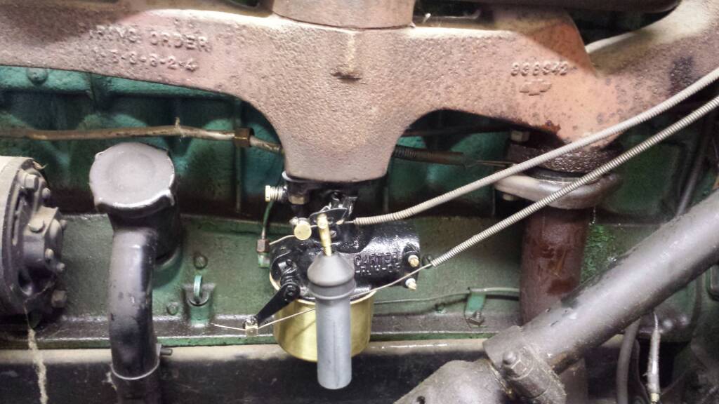

    Finally got the original carb back on her over the weekend
  24. Paulie, you might want to look into finding a later/better updraft to use... a good friend told me once that stock Chevrolet carbs were good for lawnmowers and not much else :D

    A thing of beauty. Having an old Chevy is like a trip to Disneyland only instead of looking for the hidden Mickeys it is hidden Bow Ties. :D
