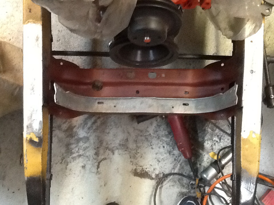

    Mike,
    The fender bracket gets mounted to the cross member and then the grill gets mounted on top of that. If you are not using fenders you would have to make a spacer the same thickness as the fender bracket to locate the grill in the stock location. If you need the thickness of the fender bracket where it mounts to the ch***is I could get it for you some time this week.
    Tom

    Tom,
    Since I will not be using fenders up front. I plan to mount the shell bracket directly to the cross member. It will lower the radiator along with me lowering the body over the ch***is.
    Does the shell brace mount on top of the fender bracket mounted at the front of the cross brace?
    Thanks for your responses.

    Thanks Tom,
    That info will get me going.
    The part that I did not know was where the fender brace lived.
    I will fab a thin (1/4") thick flat bar to subs***ute for the fender bracket.
    Looks like from your picture that the shell bracket bolts to the outer two holes of the fender bracket and the fender bracket is secured to the crossmember by two bolts in the inner holes probably with a rubber pad isolator between the two.

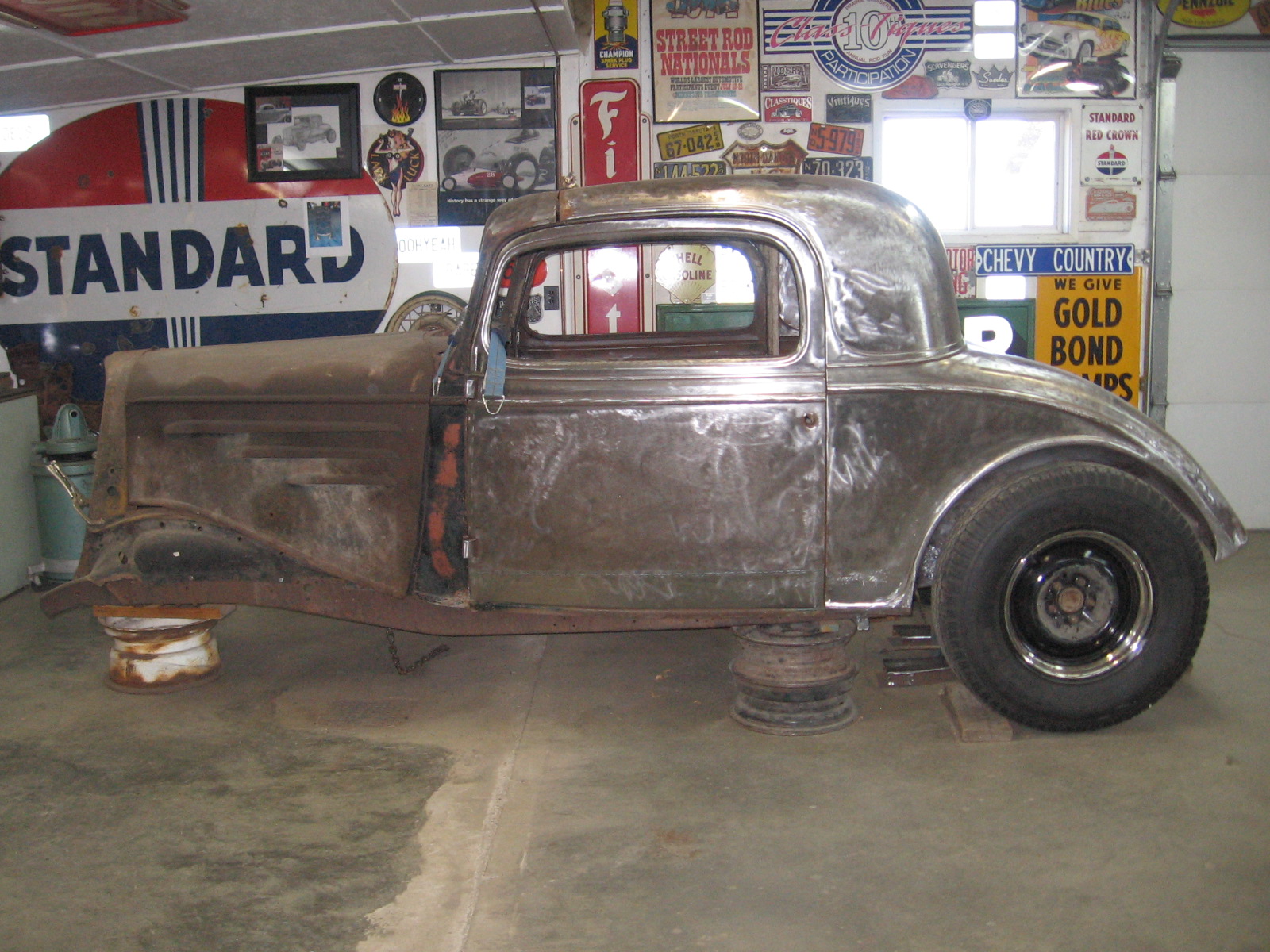

    My current project '35 std front , doors back 33 master. Going on a 34 F ord frame
    bigheadbaxter likes this.

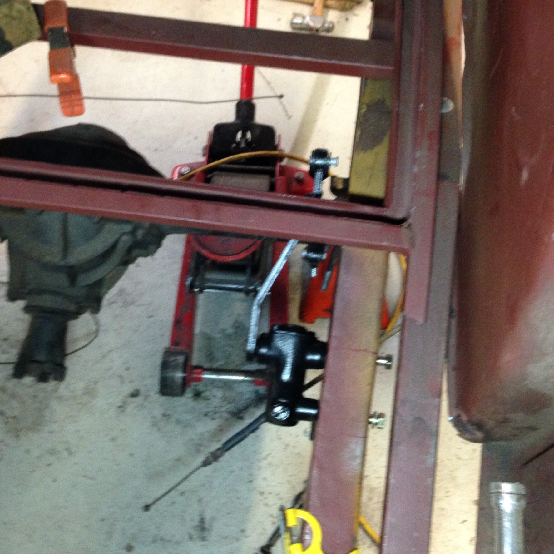

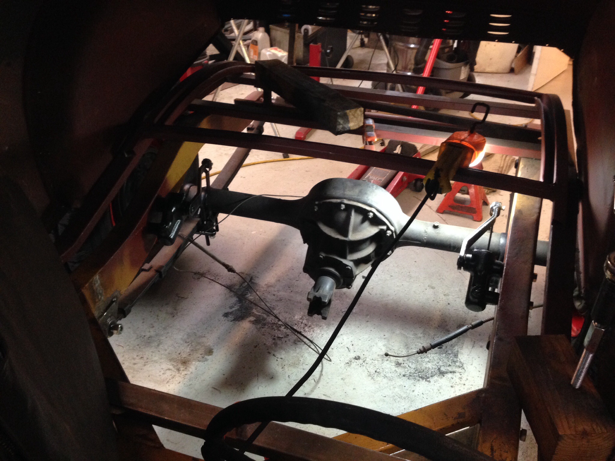

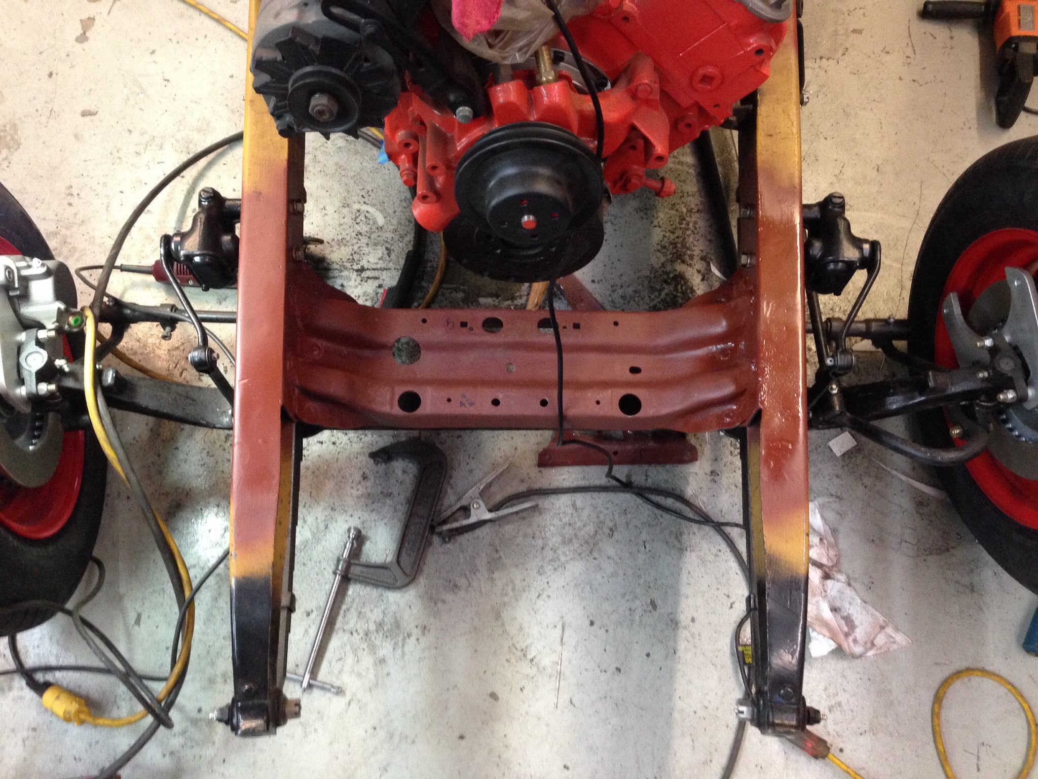

    image.jpg Nice work Tomh.
    I am using my original shocks for the old look.
    The front shocks are now mounted to the rear of the I beam.
    The rear are mounted on the boxing plate in the original area though I
    Bent the arm to align with the custom made spring plates much like the original set up.
    I just drained and refilled the shocks with hyd oil from Tractor Supply. If they are too stiff I will thin with kerosene and refill. image.jpg image.jpg
