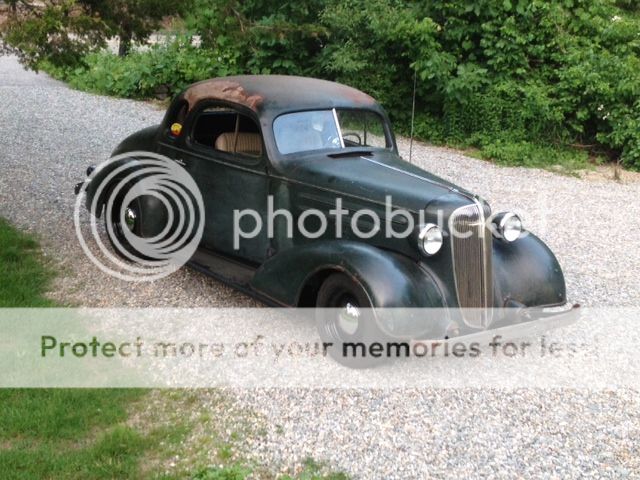

  5. Lucky to find my wood still firm in this 79 year old bowtie......
  6. Chuck, that is one CLEAN '36!!!

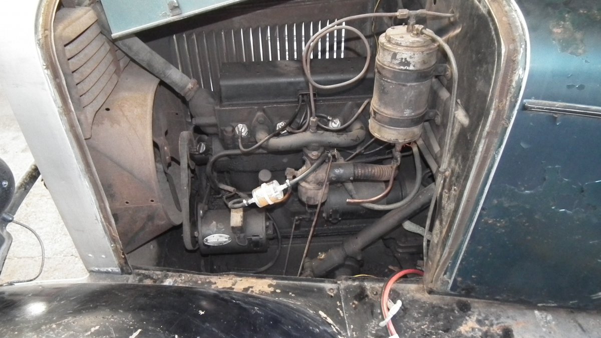

    Hi Folks, I've been lurking for a long time drooling over your rods, and finally found a thread where I feel qualified to join in!
    My '28 Coach was dry stored since 1970, sorry but the wood is GOOD, no termite nibbling anywhere..:D
    Can I still join in?
    Decided it's way too cool to mess with so fixed the important bits and just running it as it is, never knew it was so easy to have so much fun!

  24. @282doorUK , that is a cool car.
    what an awesome fan shroud. i never noticed one with that before.

    Those fan shrouds are only on '28s, because '28 frames were made longer to take the stovebolt 6, which didn't get used till '29.
    The fan on the 4 banger is too far from the rad to be effective without that long shroud, but the top louvered part actually does nothing really except look uber cool!
