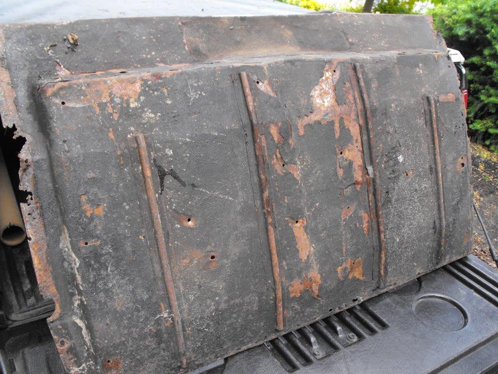

    More of how the rumble seat floor was rebuilt. The rumble seat floor behind the front seat or the floor behind the phaeton front seat is much different than a FISHER BODIED CAR. The rumble seat floor drops down over 6" for the footwells area as you will see.. A trunk floor drops and then slopes with no provision for feet area.
    Before I bought the roadster , I had ZERO idea about all these special features in the open cars.
    I used an angle gauge on a flat level surface , then put the holy panel on it. Middle was 0 degrees, the ends swept up 10 degrees each end. Took the original panel to METAL MART and they bent up the main panel and also the side panels into a 90 degree 2" wide. piece that will form the sides. It was all welded up by my friend Rick who has a gas MIG does much nicer job than regular MIG I own.
    We used a zip cutter disc to remove all the damaged area and kept the stock back area and attached the new panel parts to it. Other than not having the piece in the middle that divides the feet its perfect.
    The underside stiffening ribs I had removed , got sand blasted and all the former spot weld holes were filled. Matched pairs of new 10/32" holes were drilled in them. These were clamped to the panel and new mounting holes drilled.
    A whole lot of eastwood special ceramic ch***is paint was applied. I made oil-gas-waterproof paper gaskets to go between the ribs and the panel to be attached with ****on head allen heads and 10/32 ny-locks.
    Funny thing is this winter I was able to buy a like new panel from ebay. just needs sanded and painted. But I am more than happy with the one I reproduced.

    If you look at the ends of the panel you will see multiple small holes. Those are factory nail or screw holes as the original is nailed to a wood panel that goes from side to side.
    C.jpg D.jpg E.jpg F.jpg bottom side painted A.jpg floor panel painted with braces D.jpg floor panel redone 3.jpg rumble seat floor redone.jpg
