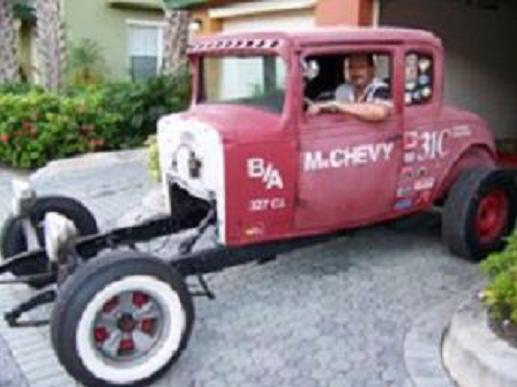

    That truck looks great Chuck, you never sent me pictures of it .

    Will try and do better on the pix, it is a driver 39 1/2 Ton, with 106k miles on it, lots of nicks, road rash and it is showing signs of needing a total redo but it is a great driver.

    Chuck not looking for nics and road rash, I just like the way it sits, I think its a cool look and kinda menacing.
    We ever get together over those fenders , will see it first hand.

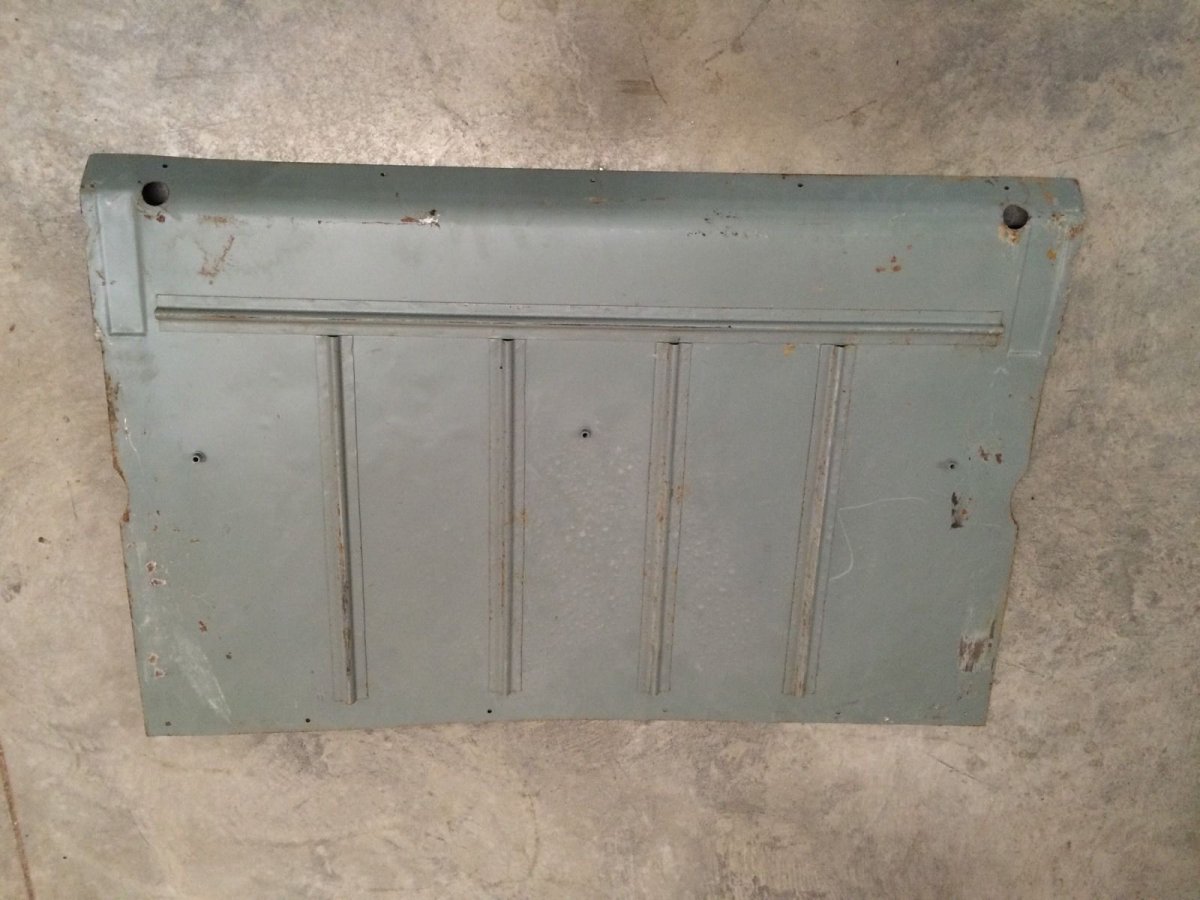

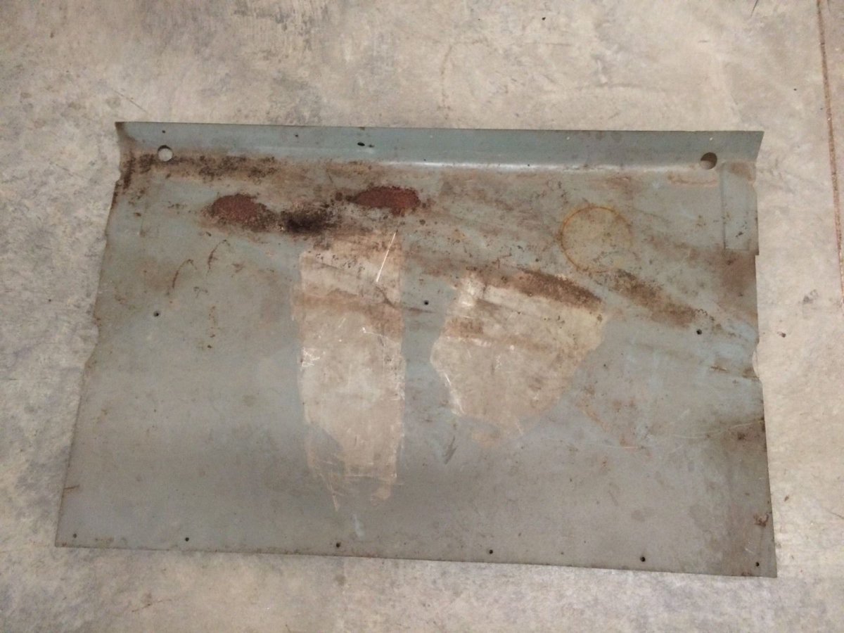

    Did the 34 Master 5 window coupes use a different gas tank apron from the sedans? The original apron from my coupe does not have the raised area. However, I found a nice steel one from a Master 2 door sedan. This one does have the raised area.

    Too the best of my knowledge only the 1933 Chevrolet master series CA had the stamped in raised area across the panel . If you look at the gas tank " cap location" , the 33 master is much lower down.
    The 34 master series DA the panel was plain and gas tank cap location was about 1" from the top.
    The 1933-35 chevrolet standard series rear panel is plain and the gas cap location was about 1/2" from the top.
    I did have a factory drawing that showed the rear bumper braces attaching castings , center to center measurements for the various years.
    At one time in 70's I had acquired a 33 master cover and discovered it was too wide. I talked to a body shop about narrowing it, the cost was prohibitive at that time. Looking back I should have had it narrowed and spent the $$$$ involved
