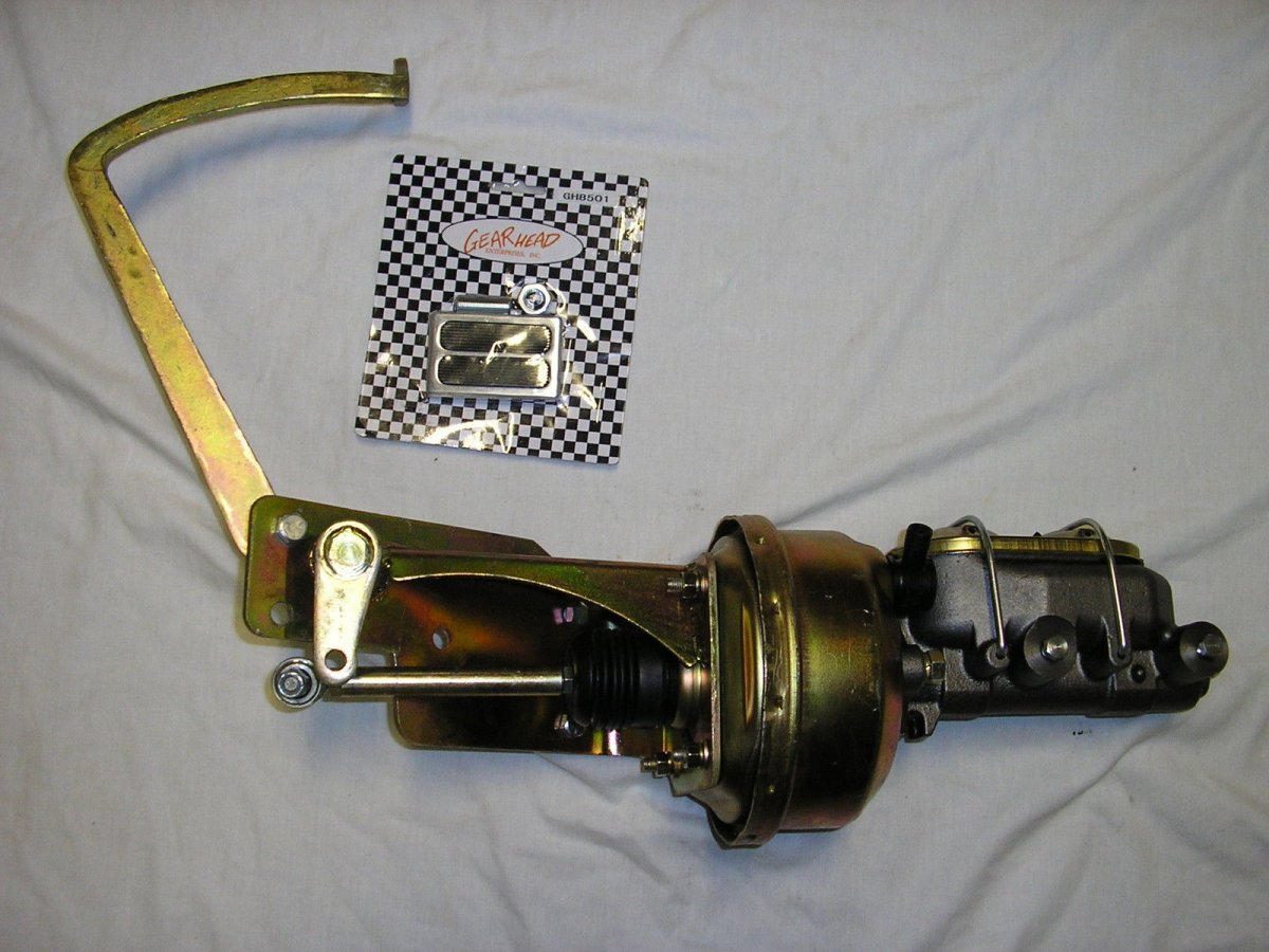

    Joe............I am keeping my setup. BUT just going thru ebay typed in ' 1935 Chevrolet brake pedal booster " and a few of them showed up for a lot less than I can sell mine to you. Wow prices have come down.
    You need to figure out now whether you want to run drum brakes in rear or discs.
    Whether you want to run a power booster or not. ????
    Because different corvette master cylinders are used. disc disc, .....disc drum. ..power boosted or non power.
    You will also need the correct factory COMBINATION VALVE for the above set ups.
    Get one with the pre-made steel lines from master to combination valve.
    Also you will need residual check valves when the master is under the floor...2 pound for disc and 10 pound for drums.
    You will also need a firewall mounted dual master cylinder** reservoir** to have the lines run to the master cylinder.
    NOTE.......when using the pedal / master / booster kits for 1935 Chevrolet because the 35 frame is an X member design and the kit puts the booster right over top of the drivers side front running board mounting bracket. Solutions............move the booster/ master farther back with an extension and make a new rod to go in the booster.
    Other solution is to make a modified run board bracket with a U shape under the booster.
    The running board mounting brackets especially the fronts are an integral part of the strength of the frame. Stock those brackets attach too the transmission mount . Cannot remember the name of the company that makes an automatic transmission cross member for the 35 frame that takes a 350 or 400 auto.

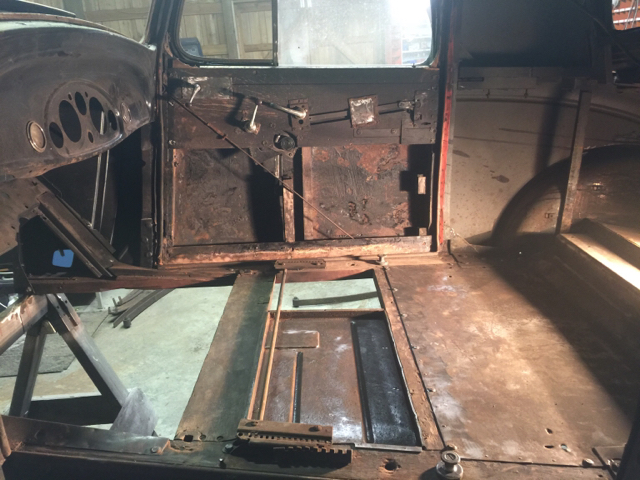

    Joe, on your doors. Notice the 3/16" rod running diagonally across the door. What this is for is to adjust the bottom of the door INWARDS so it lines up with the outside sheet metal quarter panels . Its a problem most model a fords have hanging out.
    The seat adjuster setup with the WHITE METAL GEARS............be extremely carefully with these almost impossible to find. The seat will move around 6" by pulling up on the lever allowing seat to go FWD or RWD. If your tall, you can move the seat ***embly bracketry rearward and also those little metal THINGS screwed to the floor, seat track underneath rides on them. To get more room front to back, cut down the shelf behind the seat........mine is at 5 1/2" wide.
    If you mount the battery in the trunk and use welding cable as a battery source, that allows you to take a LASANGA baking tin about 4-6" deep joes 35 coupe.jpg and mount it in the battery hole.......why???? so you can run your wiring into the ron francis fuse control unit. Lift seat if wiring problem and there it is all there and easy to see, no twisting yourself like a pretzel to see under the dash.......smartest move I ever made.
