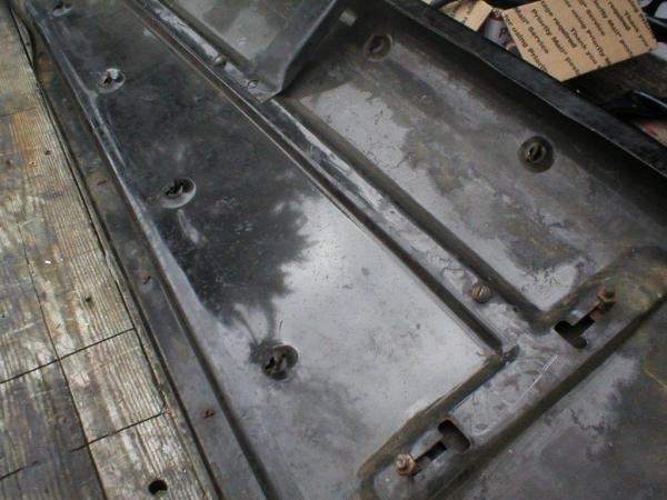

    they do not have inlays for running board rubber, because they are SMOOTHIE STYLE.......rubber from I&I repo is glued directly onto the boards using a special contact cement from them.
    Stock boards..........rubber is glued to special METAL BACKING PLATES and attached to run board with twist tabs.
    Study your existing running board. Oh NOBODY makes those metal backing plates nor the twist tabs. You have to find an original with rubber crapped out and not wreck it getting rubber off. !!!

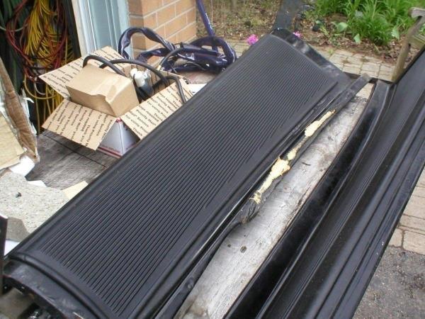

    these are the NOS running boards I won from Chuck, right out of the crate before I gave them a soapy bath .
    I had just got back from Brockport NY with S10 extreme truck, whole bed was full of stuff for the roadster .
    mike NOS BOARD UNDERSIDE.jpg RUN BOARD 34 35.jpg RUN BOARD NOS UNDER.jpg RUNNINGBOARD NOS.jpg
