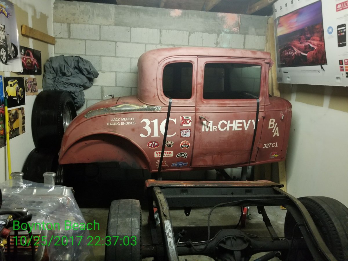

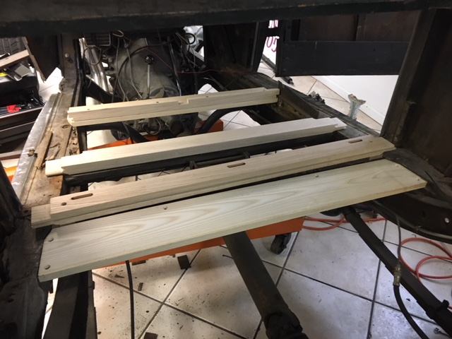

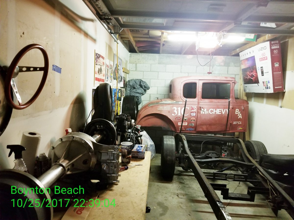

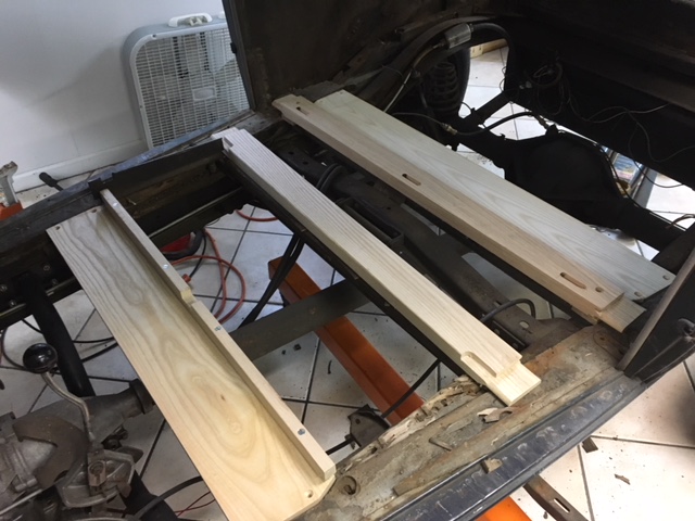

    FINALLY! After at least over a month now, I finally was able to grab some guys to help me take the body off the chassis. My own build thread will be coming soon, just need to pick up a mig welder and order the in-chassis boxing plates that I will need to supply measurements to send to a plasma company. 20171025_223704.jpg 20171025_223757.jpg 20171025_223904.jpg
  6. 31chevymike
    Joined: Feb 9, 2008
    Posts: 1,441
    31chevymike
    There's 21 years of oil soaked chassis rails, bottom of my new at-the-time complete wood floor kit, rear end, etc. Seriously, you know I will enjoy every minute of the cleanup, more so grinding off the POR-15...

    Thanks Tom! Been very anxious to begin the cleanup and more importantly, to strengthen my original chassis. I have a VERY HEAVY power plant going in if anyone has noticed in my photos above. A '58 Chrysler Hemi, originally built as a supercharged application. I lost the supercharger in a very uncomfortable situation I had with the engine builder, so for now, the '92 will be a dual quad setup. Eventually, the supercharger WILL GO BACK ON!!!

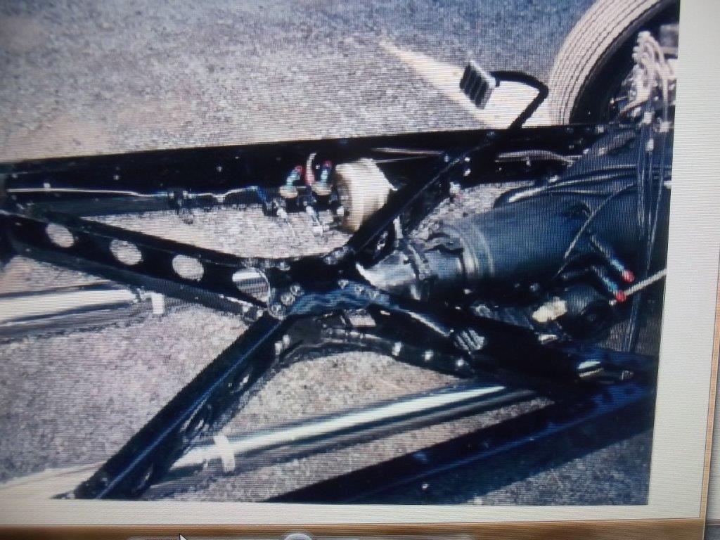

    if you intend on putting a torque monster 392 mopar in that chassis, just boxing it isn't going to be enough. Its got to be designed with an X member design to stop twisting the frame. Probably a tubular style one , as you see used on model A and 32 fords . You also have to consider what it might also do to the body if not done right.
    In a nut shell it all comes down to this.........if the car will smoke the tires and not hook up, reduces the twisting effect. But if the car will hook up , the potential problems will quickly surface and things will break.
    My 35 coupe in the avatar, at one time , had a 57 olds 371 bored 1/8" over with 1/4" stroker crank displacing 421--422 " of horsepower and torque. A 35 Chevrolet standard series is a fully X membered frame held together with 186 3/8" rivets replaced with grade 8 button head allen heads. The chassis from under my coupe ( pre 1996 rebuild )is under my 35 roadster now as its being constructed.
    picture is of the new chassis under my coupe a 1935 chev std X member frame

    Wow that was back in 96, I think it was ECI or somebody like that. I have one brand new in box, pedal assembly, I was going to use on the roadster 35 std series, but have purchased a brake clutch pedal assembly as going to 6 speed stick tremec. If I can get the stock pedals to work, will sell that ford based brake clutch setup too.
    Suggestion if you do put one of these 35 std pedal assemblies in..........make sure you can put bolts thru frame onto bolts welded to pedal assembly, because once you get the setup in the TIGHT X member corner, its a beast to get back out if you have to access the forward bolts. from below, took me 2 hours once. Easy when no body on top, almost impossible with body installed.
    The booster was single diaphram 8 " ?? Master was 1" late model disc disc. Was never happy with way it felt and replaced the master with 15/16" bore corvette, added the factory disc disc combination valve setup , fed off remote billet filler on firewall . Also added a 8" DUAL diaphragm booster and a STAINLESS STEEL BRAKES electric vacuum booster that gives CONSTANT 18--22" of vacuum . Brakes work exactly like they should now. Too much camshaft in motor gave low 13" of vacuum and that doesn't allow booster to work. So need the electric pump.
    I have all these same items to swap over my phaeton with all jag stuff, headed to trash. Doesn't stop worth shit and dangerous. Prior owner thought it was great, little did he really know how poor the braking was. He trailered car everywhere, I drive.
    I also have all these same items for the roadster and just got the special WILWOOD dynalite brake adaptors to jag rear end ( 1962---1986 ) made here in aluminum. Flips the Wilwoods to face rearward and has Wilwood spots for emergency's.
    I am having a run of the aluminum adaptor brackets CNC machined in Oregon, that I will be selling on ebay shortly. Plus grade 9 tapered head side bracket bolts with safety wire and a few of the bottom side jacking plate in aluminum.

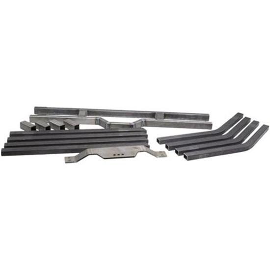

    Already thought about the center x-member Mike! I purchased one from Speedway a few months ago, knowing that I did not want a tubular one. The square tubing will work out much better, because I intend to finish the setup with boxing plates to make it even stronger! Center Xmember for my hot rod.jpg

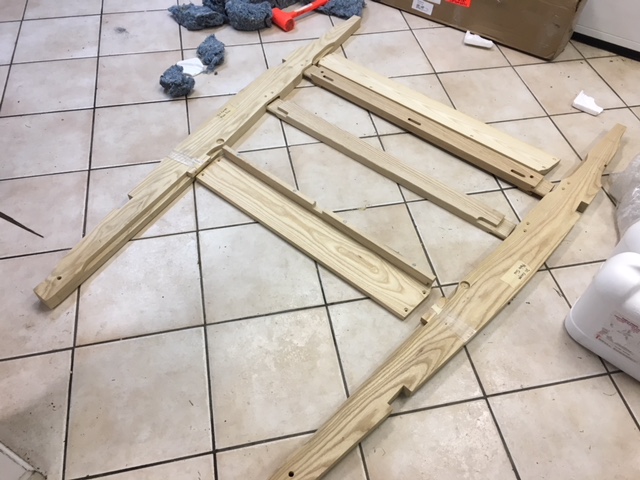

    found a picture file in my computer of a complete wood kit for 34-35 coupe, will post some of them. This was for sale on ebay about 6-8 months ago 35 CHEV WOOD a.jpg 35 CHEV WOOD C.jpg 35 CHEV WOOD  E .jpg 35 CHEV WOOD  G.jpg 13f047a37bd0aeacd5d86959fde7cf9b.jpg 35 CHEV WOOD a.jpg

    Bought my complete main floor kit from Auto Wood Restoration, back in 1997. They're in Hanna, Indiana - 219-797-3775. KC Wood Manufacturing is another source. The search goes on for vintage Chevy wood Flatmotor.
