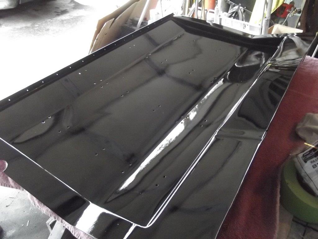

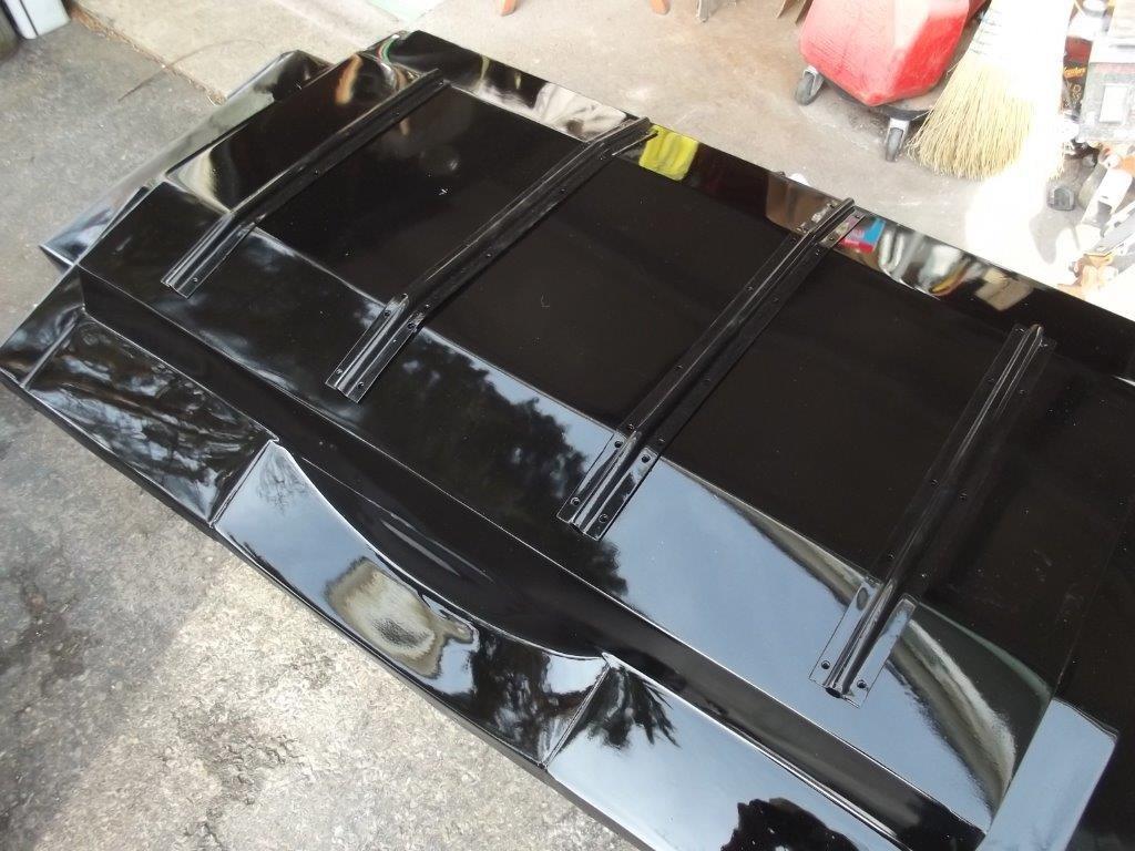

    after what seemed a long time prepping the floor and buying some special eastwood chassis paint with ceramic in it. I dug out the low pressure hi volume gun. It layed on pretty good and when these pictures were taken the stiffening ribs were not bolted down yet. I applied an oil and water proof cork rubber sheet mix to the bottoms of the ribs so nothing gets scratched.
    mike lynch bottom side painted A.jpg floor panel painted with braces D.jpg floor panel redone 3.jpg rumble seat floor redone.jpg

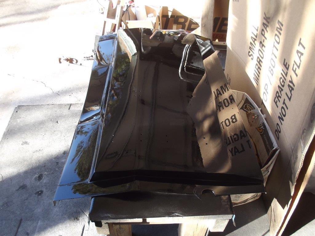

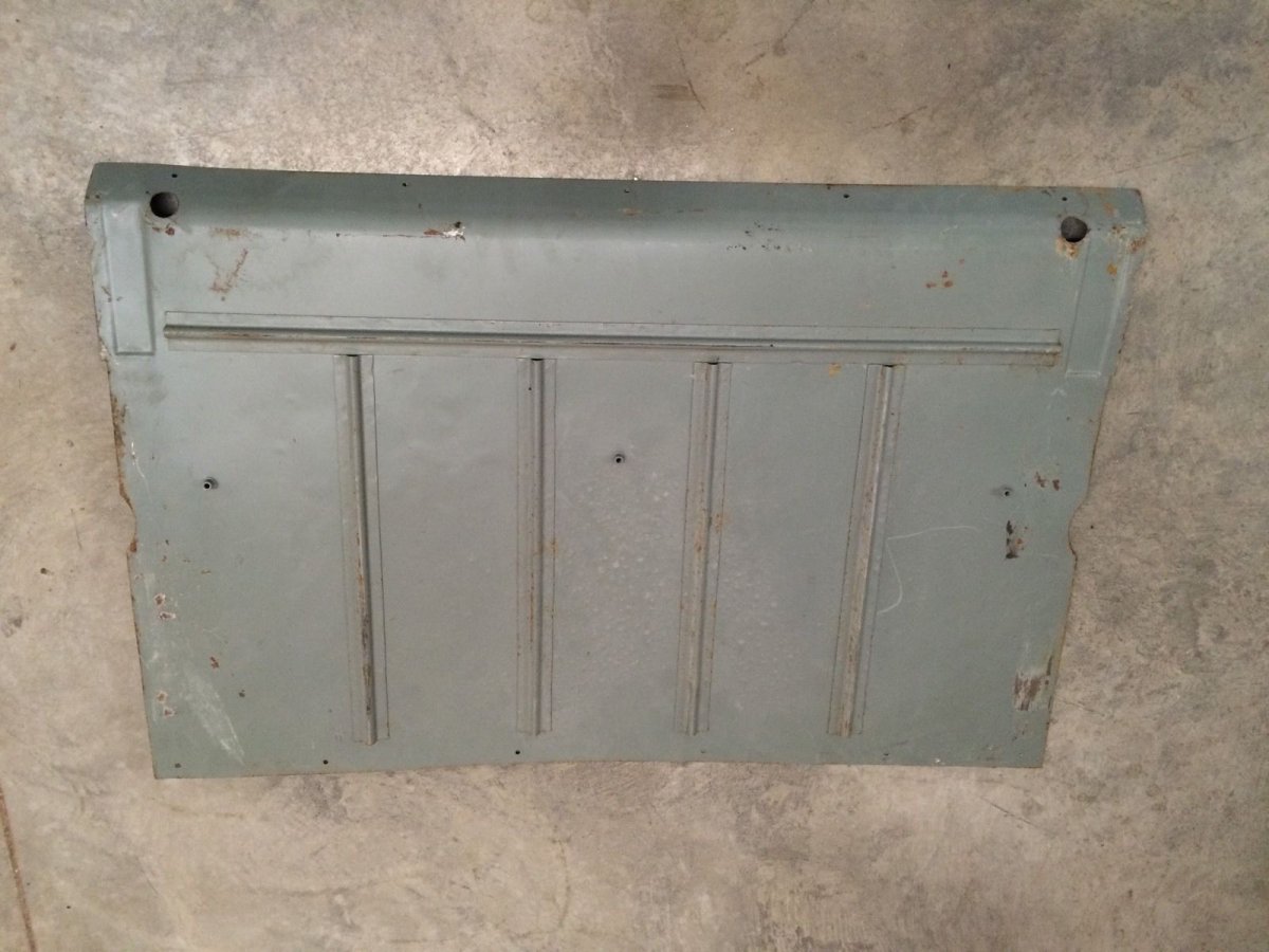

    yes the hump area would be for rear end travel, the only saveable part of the original floor panel. Seeing as how I am running a jag rear end there is no need for the hump , as center section is fixed. After I repaired it, last fall I bought one that was like new and its for a roadster or a phaeton only, extremely fortunate for me to actually find one and in that good a shape, cost me $500 and worth it.

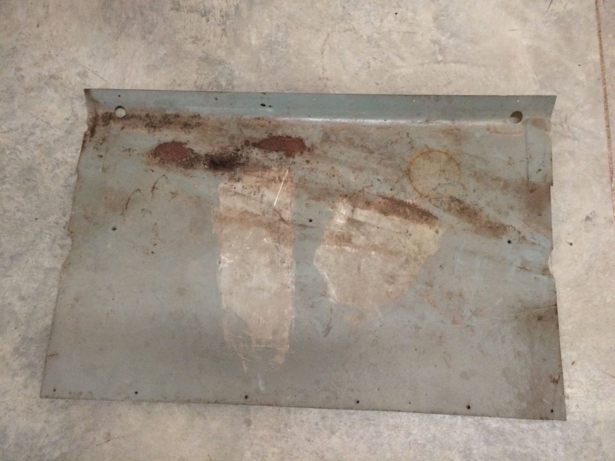

    My 35 phaeton' s previous owner took the original floors out and made stainless steel ones, which I plan to replace with originals, which I now have. When that was done early 80's with SS , it was the trend.
    This is the very rear floor panel for a coupe or sedan, roadster or phaeton. Those 2 large holes in the corner are for the drain hoses from the water troughs to dump on the ground. A trip to metal chemical stripper will have that coming back 100% rust and paint free. You dream of finding sheet metal like this.
    This panel will end up in my 1935 Chevrolet coupe as what I have in there is home made and no character at all. I like the stamped ribs, even tho nobody will be able to see it , except somebody I run over....???
    You can see the factory holes for nailing this panel to the rear wood and the 6 holes for nails into joist that runs across where its nailed there to.
    The 3 staggered holes across the middle that are threaded, I think maybe are to hold the wires to the right side of car tail light ???
    mike lynch the real madmike3434 34-35 std coupe floor A .jpg 34-35 std coupe floor.jpg

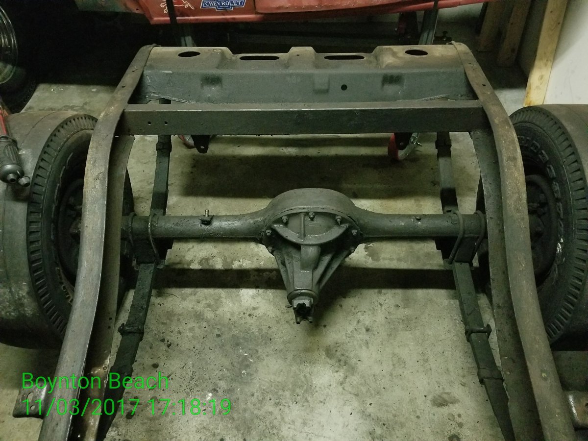

  5. plan on running a stock tank, and to get the QC cover off, it 'should' be an issue hitting the tank. I still have to put the tank in place and see if i can get the cover off. But by the looks of it, i will have to modify the tank a little.

    You know, I will be installing my Winters Champ QC as well (which type is yours), but decided to place my 20 gallon stainless fuel tank in the trunk. Originally designed to be in original location. I didn't think the QC would be that close to fuel tank! Figure the studs are about an inch long too. Nice fab work toward the rear, looks like you're using leaf springs to mount the QC. I'm planning to use adjustable coil overs and hairpin radius rods for my QC. Coming along great PBR!!

  7. Thanks Mike. It's an old Jones mag QC, and yes using a custom set of leaf to lower is about 1 1/2" from stock. Makes 28" tall tires fill the rear fenders perfect. Cant take all the credit for the fab, we did it in my buddies shop, and he's a mad man when it comes to that stuff. Also made mounts for a set of NOS Traction master's. 32leaf.jpg

    PBR, you're right about your QC being too close. Just measured mine and from the center of the axle tube to the end of the long rear cover bolts is about 12-1/2". Measured on my rear of this measurement and seems very close, although my original tank is already out, so it's hard to say exactly. Guess you'll be using the short cover bolts to gain as much room as you can.

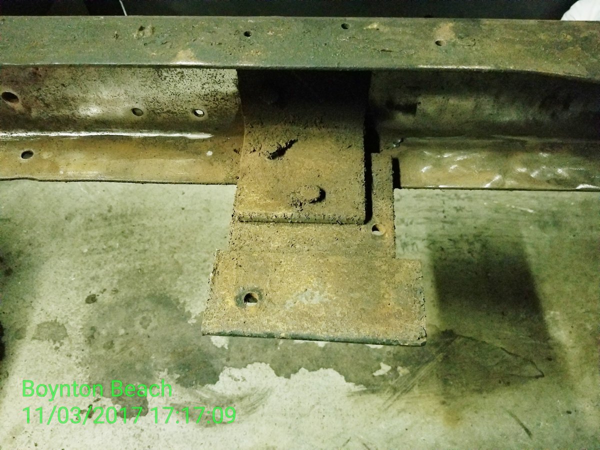

    The first photo shows an example of how "rough" some rodders were at their fabrication skills. It's the master cylinder mount which had the early '49-'54 Chevy mc. The rear is from your ever-so-common '55 thru '64 Chevy posi with 4:11 gears. The only mishap I had with this rear is that I broke the ring and pinion, could not locate another posi unit, so I found a 4:11 open ham. Hey, this rear lasted a LONG time in my possession and the prior owners. The Winters QC will be gladly taking its place soon enough! 20171103_171709.jpg 20171103_171819.jpg 20170915_211950.jpg 20170922_205531.jpg

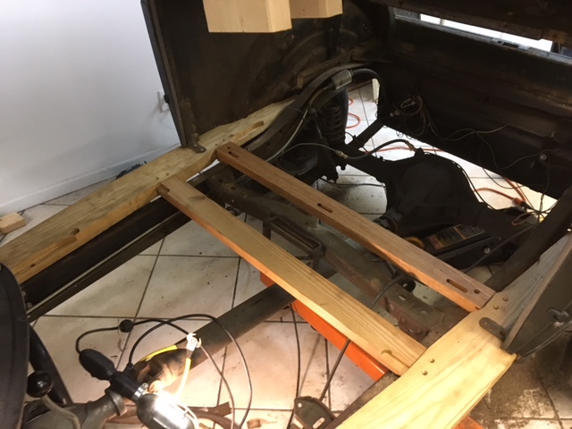

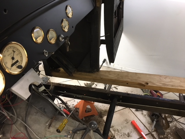

    IMG_0455.JPG IMG_0463.JPG IMG_0464.JPG IMG_0465.JPG IMG_0471.JPG Got all my sill wood replaced and the Hinge pillar, still need to get kickups in but went ok replacing all the termite damage so far.

    Ordered it and fit right in. Took some tweaking to get it all in with metal still on car but worked out. Like I said in previous post I have some liberties since it will be a hot rod not a correct restoration. I will be adding some steel bracing and plan to do interior in sheet metal but still wanted the original wood structure.
