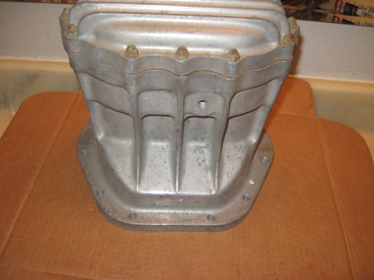

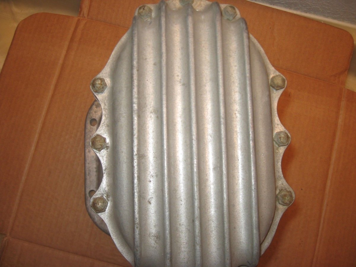

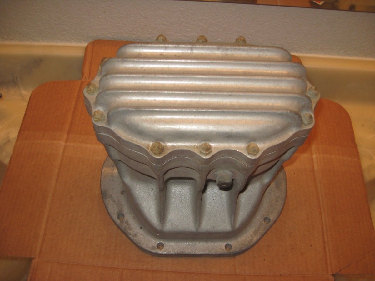

    went shopping again on ebay THE STORE FOR MEN. I had already bought the jag rear quick change cover and a week later spotted this on the cheap, just over $100, so bought it.
    Going to attempt to convert it using aluminum plate somehow to work on a jag rear rear. I like that it has the fluid reservoir wings below and would really stand out on a highly visible jag rear like in a model a ford or t.

    I am hoping I can get it to adapt, not going to be an easy adaption, I don't think, I could be wrong as I have many times before...... going to take a big thinking cap.

    Just went poking around on ebay and there is another cover just like the one I bought for less money. Has a few damaged fins on a corner. As near as I can figure only Speedway Engineering made this particular style #5160 . It would also appear that quick change rears using the 6 bolt mounting pattern as shown on this cover , are the same .
    I would also assume the bottom wings are to hold extra fluid. The bottom would have to be tapped for pipe thread plug in order to drain it easily. It would also need to have a vent pipe installed to take away the pressure build up. 90 degree fitting and hose to a small filter. Very trick looking on early cars model T & A or early 32 and down chevys without stock gas tank .

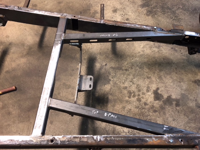

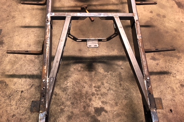

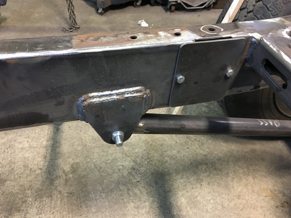

    Sorry been sick then on a vacation here are a couple of last pics, should have more done by next week.
    Fern 54, Six Ball and TFoch like this.

    Clean and simple, I like that.

  14. Never any apologies at all, just cool to see any progress JGR!

    Actually should be back together tomorrow night to start mocking up where to mount the steering box.

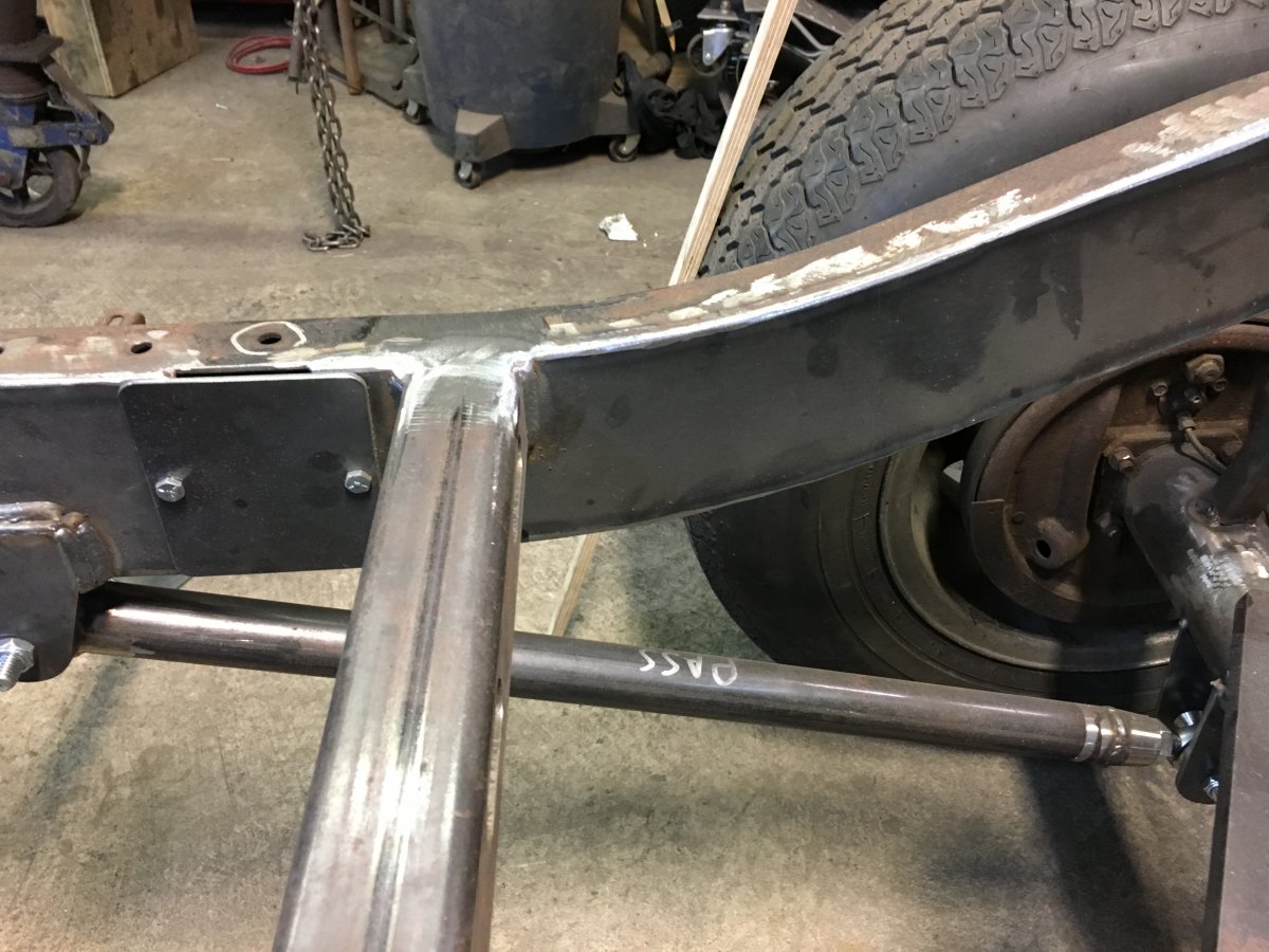

    Well need to custom make motor mounts now these that were on car wont allow any chance of the steering box mounting. They need to go on top of frame so Matt will lay out some custom ones and plasma cut them then we can actually work on getting steering box mounted. Also will need to make the steering arms so I can put the cross steer in. But at least the frame and rear suspension is done other than from firewall forward .
    31chevymike likes this.

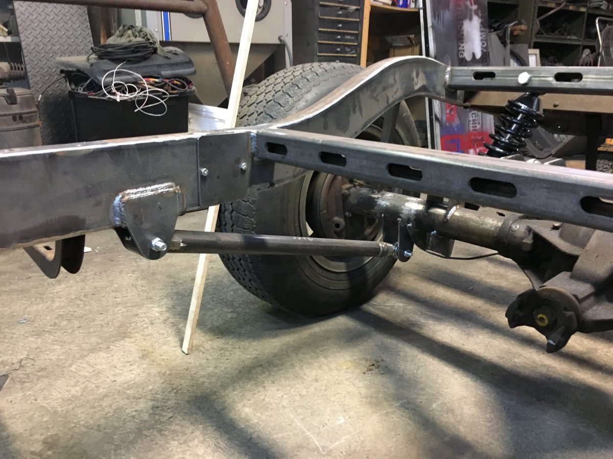

    Got motor mounts fabricated so I can start to get steering box mocked in next
    biggeorge and Fern 54 like this.
  23. jgrohio, what are your front springs? mono leaf?

  26. do they seem to hold with a V8 in there? could you measure the eye to eye length?

    they seemed fine when I got car before I tore into it. I wont be back at shop to measure till Friday or Saturday. The shocks that came on car are Pete and Jakes. I also can look and see if any kind of stamp on spring when I'm there
    31chevymike and PBRmeASAP like this.
