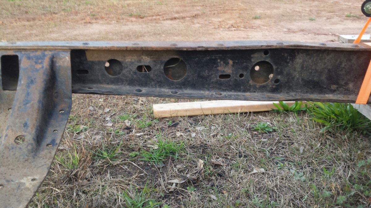

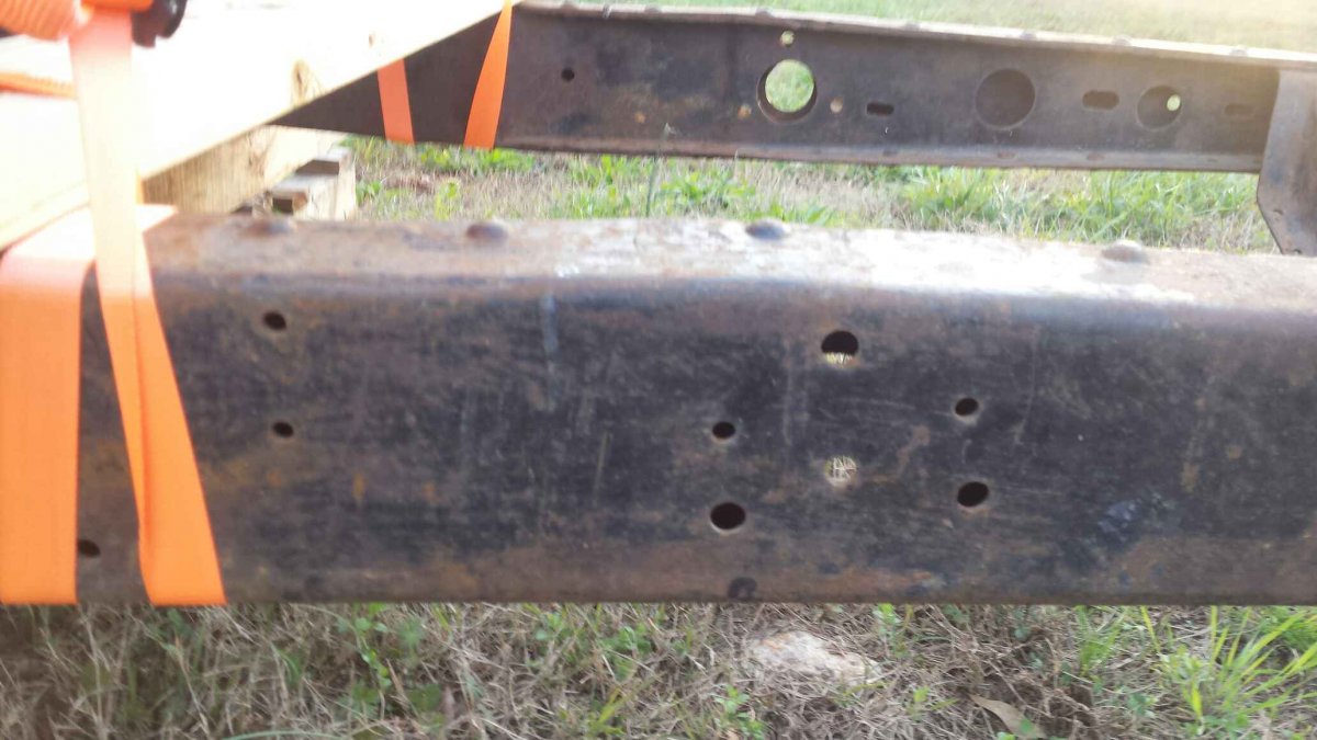

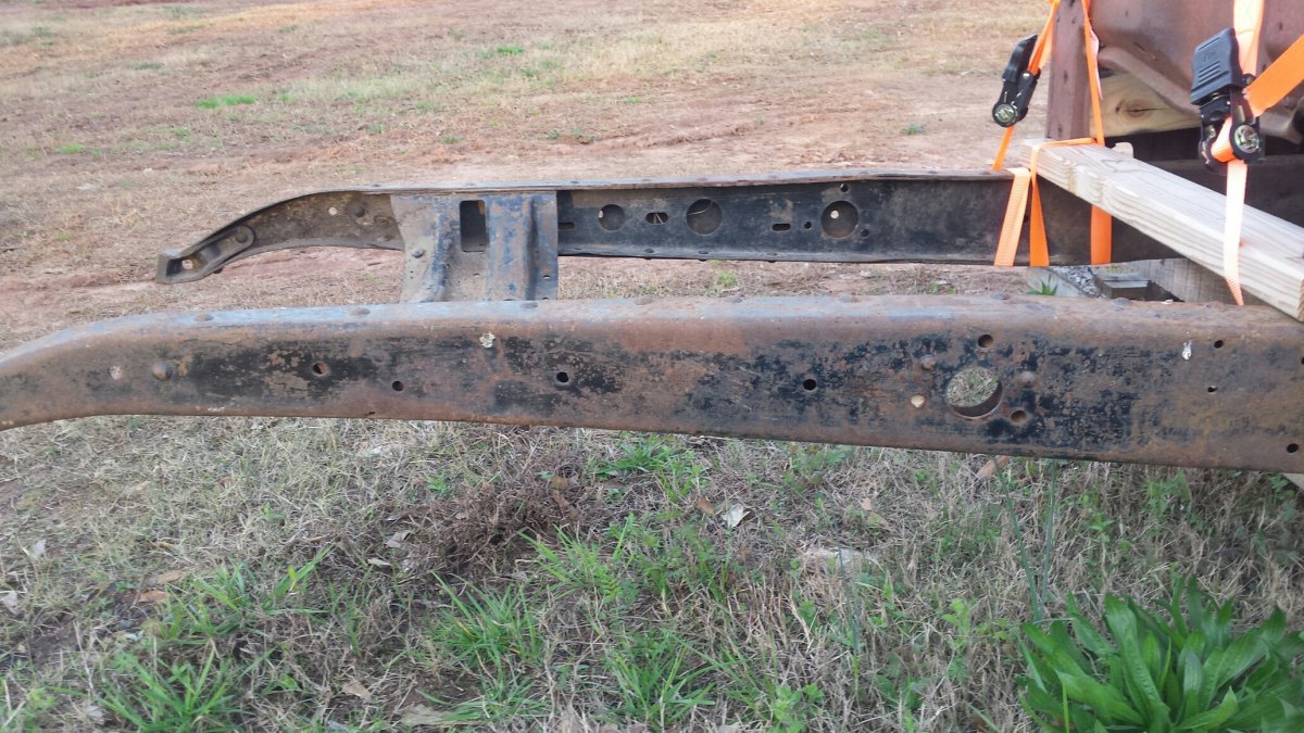

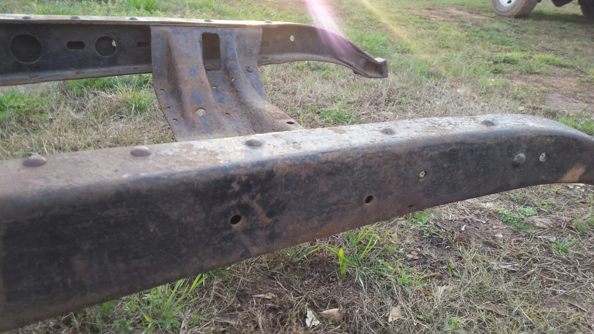

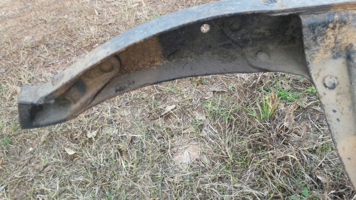

    Just received these photos from the new owner of his '34 Chevy Master. Can anyone identify or recognize his chassis as Chevy original for the car, or a frame from another make?
    This is the very first time I ever saw boxing plates bolted in or is original deed from factory... 20180314_081206.jpeg 20180314_081213.jpeg 20180314_081219.jpeg 20180314_081232.jpeg 20180314_081237.jpeg

  3. Looks like a 34 or 35 chev frame, hard to tell with just pictures if front . The knee action front suspension has been removed . The knee action frames did have the extra boxing plate
    And also an X member in the frame.

    Thank you very much Wood Remover, appreciate this info a lot... I tried looking on eBay with a company called AMMUSCLE, who supply a lot of parts for early Chevy vehicles and came up short for the '34 Chevy Master trunk lid. Although I found a glass one, but would be the last resort to put glass body parts on these vintage steel Chevies. I'll let Mike @drifter9 know that you may be willing to part with your trunk lid.

    I think the key to identifying the frame is the cast bumper mounting brackets at the end of the frame horns. Definitely not 34-35 standard series.
    The factory riveted in frame boxing/stiffening stampings. I do not have a 34 master nor ever got close enough to a chassis to say its a 34 master. JOE wood remover says its ( boxing plate ) is in a 34 master and he should know.

    That's what i think the frame is, a 34 master . But not 100% sure.
    Re your friends coupe body 3 window. It could be a master or it could be a standard series. Looking at the quarter panel wheel well, the master has a specific body design stamped into it, the standard is flat like the picture, if it has not been replaced ?
    The standard coupe body is shorter than the master. The clue would be the length of the doors with the master being longer 2-3" . My coupe is locked up in storage and would take a day to go measure it if needed. ?

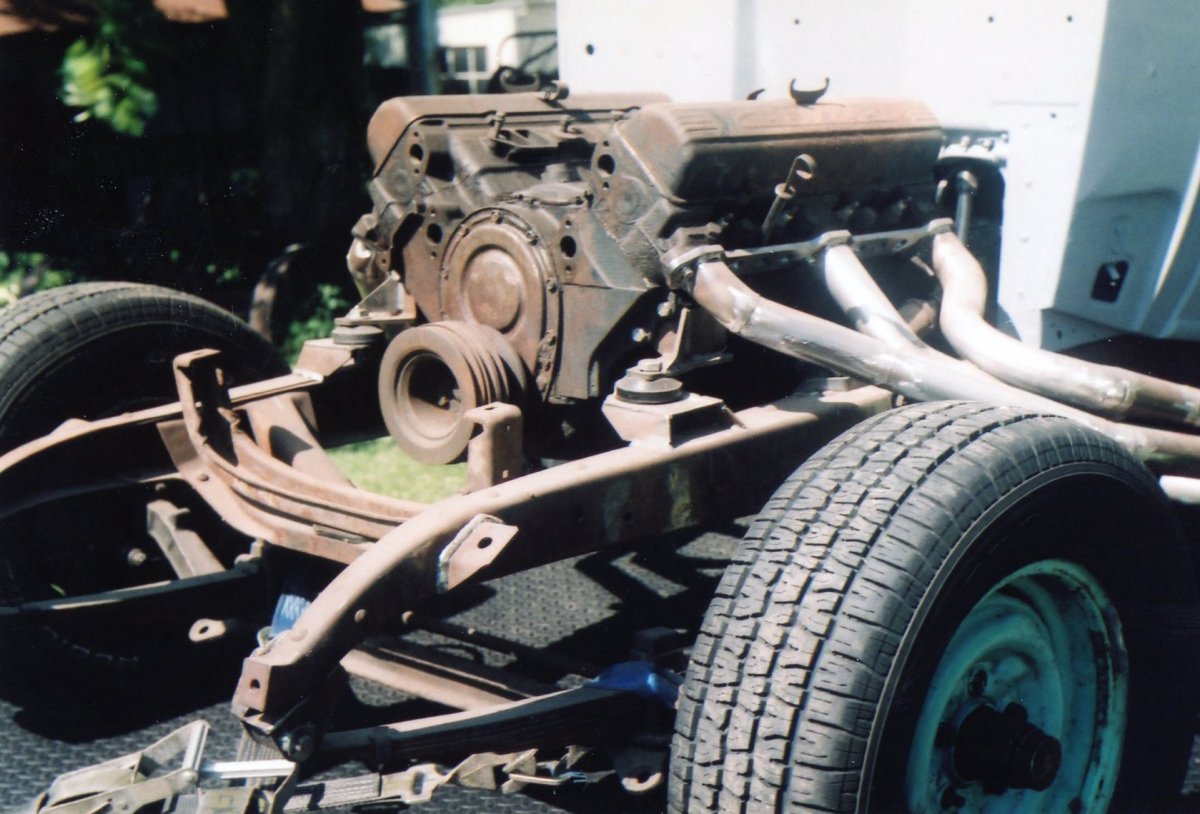

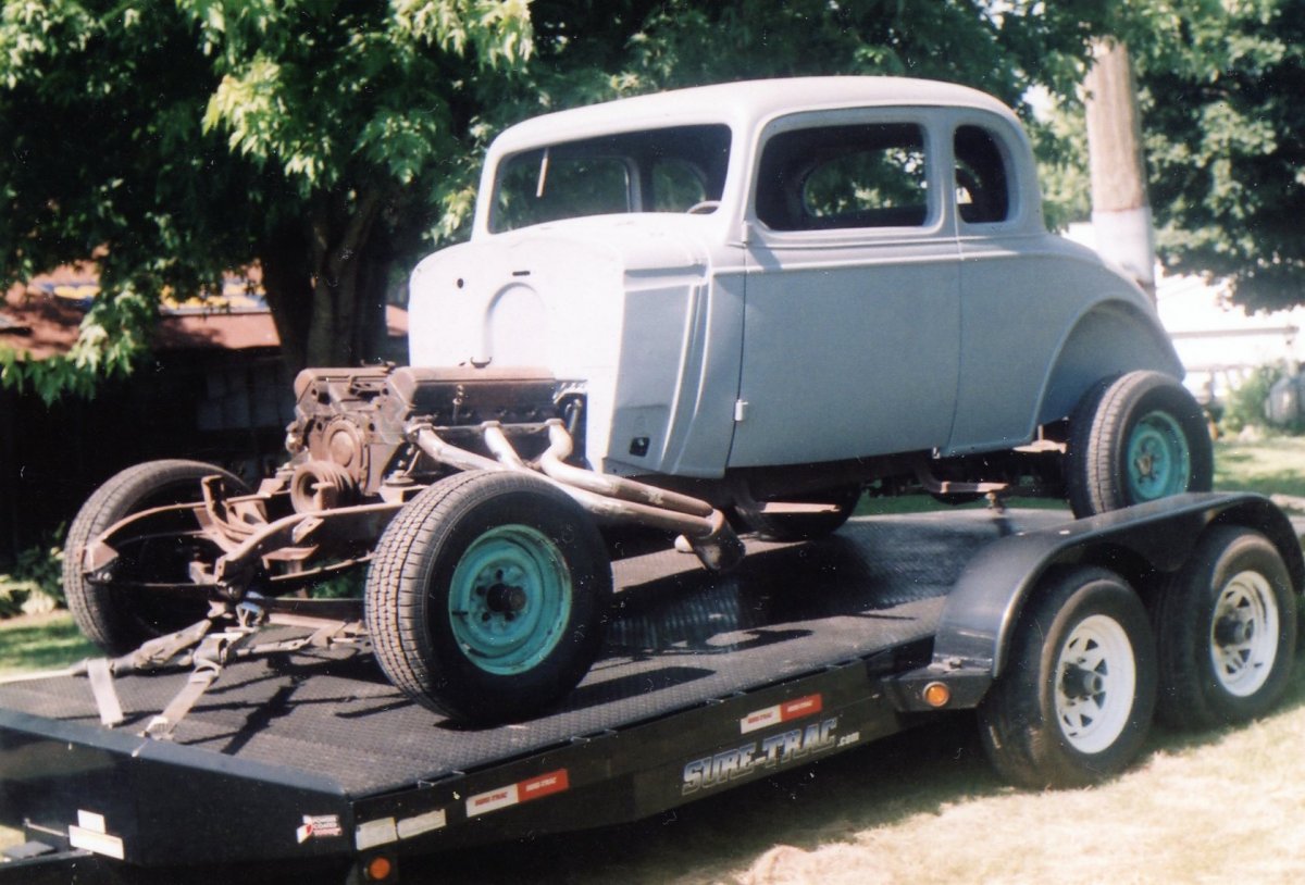

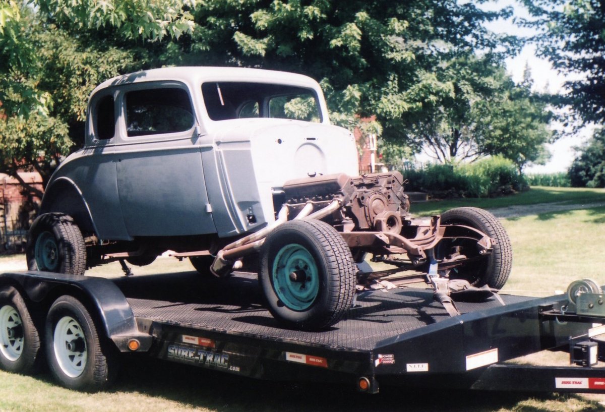

    Hey guys , this is the car in question , I appreciate all info you guys are sharing. All the wood inside is missing, no chance of any tag there, I had to stiffened it up for the ride back from Mississippi with the 2x4 . Not pretty but kept more damage from occurring to the body in transit. nothing on the cowl but It does have the rear fender bolt holes under quarter. It has a standard style dash. It is going to be a long project and will sit for a while before being touched. I will be collecting parts for it along the way and slowly doing a little planning for hot rod it will be. Thanks again for the help and advice on it. 20171216_105444.jpg
    cactus1, 31chevymike and Fern 54 like this.

  17. madmike3434
    Joined: Aug 14, 2009
    Posts: 691
    madmike3434
    BOWTIE..........starting in 1929 Chevrolet used a MODEL DESIGNATION for that year of manufacture.
    1929------International....series AC......wheelbase 107
    1930------Universal..........series AD.....wheelbase 107
    1931------Independence....series AE.....wheelbase109
    1932------Confederate....series BA............wheelbase 109
    1933------Master..............series CA...........wheelbase 110
    1933----- Standard ..........series CC............wheelbase 107
    1934-----Master................series DA..........wheelbase 112
    1934-----Standard.............series DC..........wheelbase 107
    1935------Master................series EA.........wheelbase 113
    1935-----Standard ...........series EC...........wheelbase 107
    mike lynch
    slo_joe and Bowtie Coupe like this.
  18. madmike3434
    Posts: 691
    madmike3434
    drifter9..........went to my storage unit and measured on the door of the coupe.............between the body lines, measured 38 3/4 ". Thats for a 1934---1935 Chevrolet DC_EC standard series .
    If that's what you have that 1934 master frame is too long. Preferred frame for the standard is the 1935 as it has the factory X member. Has 186 rivets holding it together. Can be disassembled totally into 11 pieces and using 3/8" grade 8 button head allen heads with washers and lock nuts. You can sandblast all inside the frame parts , paint them inside and out and re-assemble using the allen heads and drifts to line the holes up again into a perfectly square frame, again. That's what I am doing.
    You can use a stock 34-35 dash panel from a standard with gauges in the middle or use a 1934 chev master with gauges in front of you on drivers side and a glove box on the right. You see them on ebay all the time This is the only MASTER series 1934 part that fits the standard.
    Hope you have the door rocker panels as they are a bear to find and costly.
    The 1934 master outsold the standard series 7 to 1, so its harder to get parts for the standard.

  25. Torkwrench
    Joined: Jan 28, 2005
    Posts: 2,730
    Torkwrench
    Definitely a 34 Master frame. It matches mine. The boxing plates are factory.
