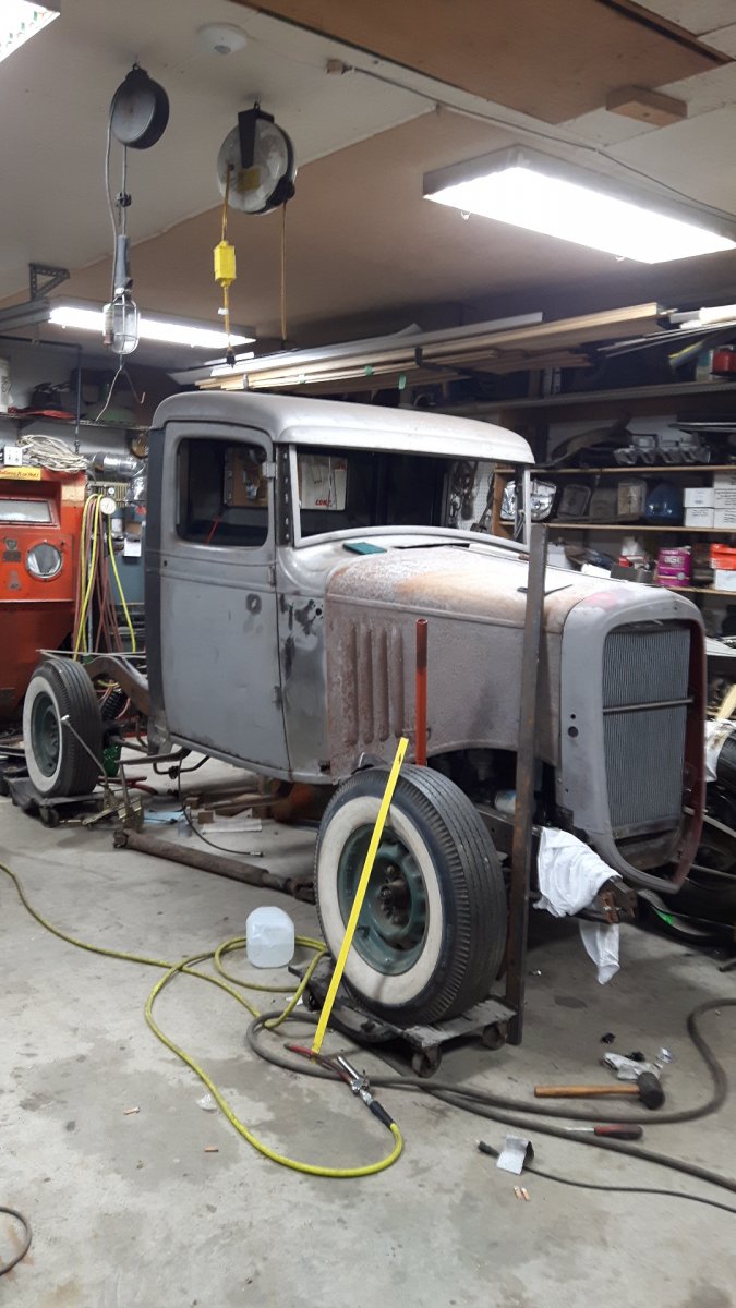

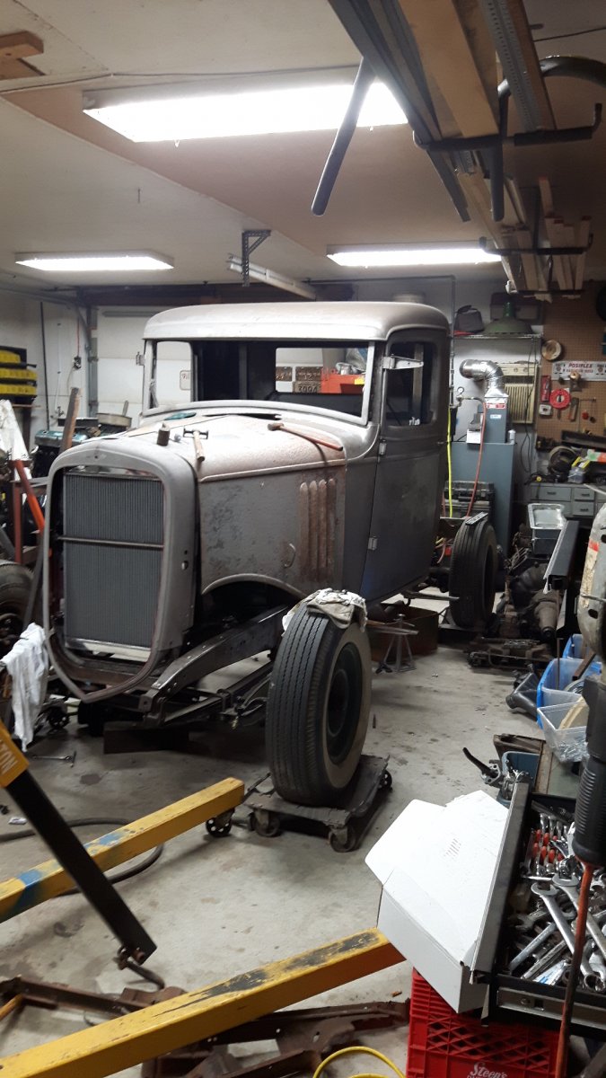

    Busy putting floors in. Glass comes this week so can get them finished .New box and rear fenders. It's getting close !!! 20180209_224211.jpg

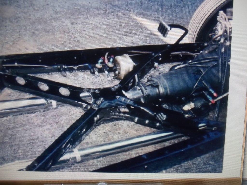

  17. This is the 34 5 window I built and sold .
    34 ford chassis with a 1961 390 hi performanc

    JOE, I can see you also got the 1935 only under floor brake booster and master adaptor, think it was ECI brakes.
    There should have been another adaptor to take it from the front part with added in middle part to make it work properly. Who ever designed it , did it without ever seeing the actual chassis.. I have same one from GEARHEAD ENT. not using as going to stick instead of auto. My coupe has this setup. Roadster will be diff., Booster ends up right over top of the 1935 only front run board bracket support.
    Oh this system as shown in picture DID NOT WORK. Booster was single diaphragm, does not have the GM disc disc combination valve , needed 15/16 bore corvette master, and most important, engine needs to be able to produce 18--21 + inches of vacuum. Running a hot cam, your not getting any vacuum. SSBC makes an electric vacuum pump also sold at JEGS, end of brake problems, like night and day !!!!!!
