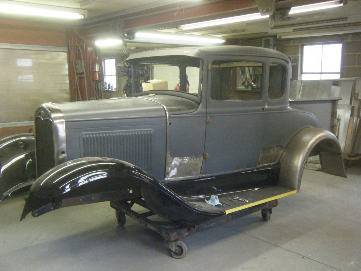

  15. try not to rely on the shims for body fitment when replacing panels/structure. i just went through this with a job i got in that someone else did the metal work. he tried to do it off the frame and it was so far off they would have needed 1/2 thick shims and the body looked like it was crooked.
    always start by bolting the sills down to the frame, you can skip the rubber cushions at this stage. bolts should be tight, now start changing panels and structure, adjusting them and the gaps to fit as you go AND keep your eye on the "big picture" by comparing measurements from side to side.
    this photo is after i fixed the gaps/panels/structure, using no shims.
    sorry for soiling this great chevy thread with one of these turds. DSCF0002 2.JPG

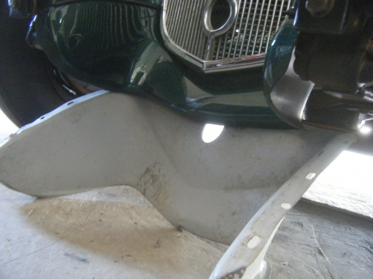

  21. thought i would post these here for future reference. Mallomike brought over his '33 master parts and we compared them to my '33 standard. master parts were about an inch wider. the first photo shows the front apron, the standard apron would would fit inside. the second photo shows the three rear aprons the standard one is hard to see in the back ground but is narrower. the other two are both masters. one with a reveal one without. they both fit the same. DSCF0002.JPG DSCF0004.JPG

  26. we also noticed my fenders [standard] have a bolt that screws down into the brace, the masters have a bolt that screw into the side of the brace. DSCF0003.JPG
