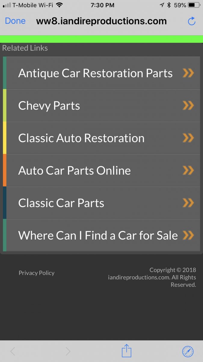

    It did it to me too just now. G D F A_HOLES have these programs that switch out your search to other stuff rather than EXACTLY what your looking for.
    Same thing with that travel thing velocity.com or the one that finds you a hotel , expedia.com ? Their system directs you to hotels where they get kick backs. TV story other day showed where this hotel in BC was shown as full for all the days the person wanted , but was less than 1/2 full booked for days the person wanted. The system is trying to direct you away to hotels they work with. The 1/2" full booked hotel did not work with them. Now are suing them for damages. Of coarse the search company claims its just a glitch..............ya sure !!!!!!!!!!!!!!!
    In the words of Jesse James Bike builder.......PAY UP SUCKER.

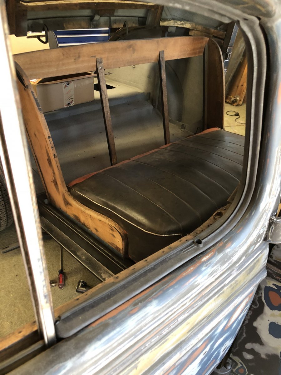

    How did you all weather strip your doors, I figured out they only did the top and the bottom , that’s not going to work [emoji849]

    For 33-35 Chevrolets weather stripping doors. You have the cloth cord that surrounds the door opening on the inside, it gets upholstered , whipcord ?? windlass ??? name escapes me
    The vent window rubber.
    Other than that Lynn Steel makes a special rubber that fits into the window riser glass channel and you push the metal over it to hold in place. Its sold by the foot. When you wind the window up all the way the L shaped rubber fits against the bottom of the door glass opening. See if I can find it again on their online catalogue
    The window channel that surrounds the glass and allows it to go up and down smoothly, lynn steel may sell it or many other early chevy parts suppliers.....I AND I repo, the filling station
    mike

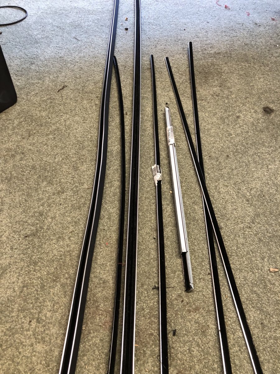

    IMG_9677.JPG IMG_9678.JPG i have all the window Chanel and rubber for the wing windows, I have no ideas where to get the other stuff

    told you where..........iandireproductions in calif or *the filling station* in Oregon also has printed catalogue , or direct source LYNN STEELE RUBBER. Order their printed catalogue and mark everything you need and phone them up with credit card in hand and get it all. They make everything needed in rubber we chevy guys need.
    They also have running board ANTI SQUEEK that goes between the top of the running board and the bottom of the car and fills the gap that's there.
    mike lynch............. bought my first set of vent window rubber in 1972 , still on car.
