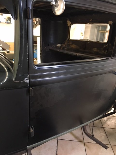

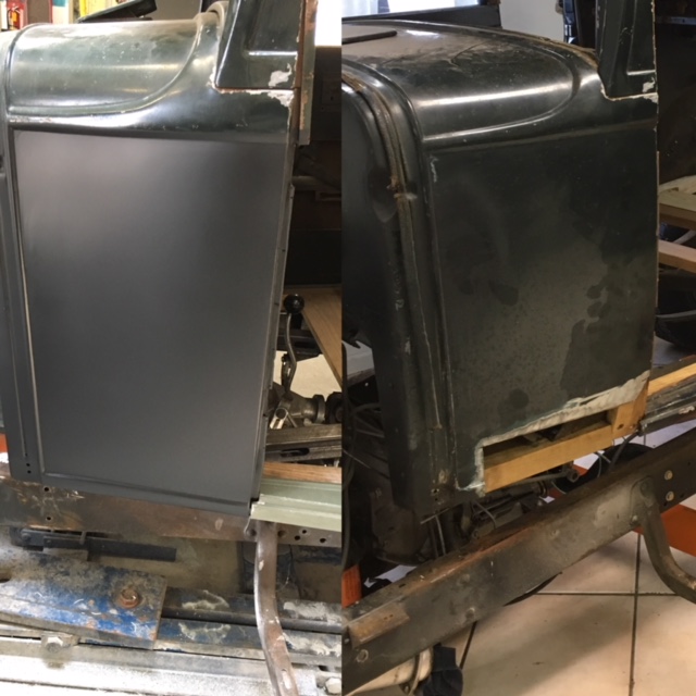

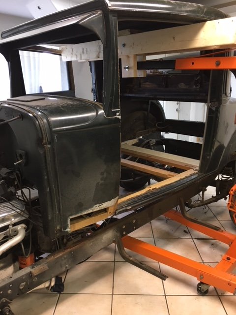

    713C6F40-B871-4F29-9A07-18E098A277E1.JPG IMG_0491.JPG IMG_2699.JPG IMG_2732.JPG Not much progress since it's motorcycle season. But cowl finally patched and getting door aligned and hung.

    Best part is I hung the door and it fits really well and will be able to get away with very little if any shimming looks like. Of course body will be off and on a few more times.

    I had to shim the doors on my 34 STD under the sill plate to get the back side of the door to come up to make the body lines fit. Depending on where you put the shim you can raise of lower the back of the door.

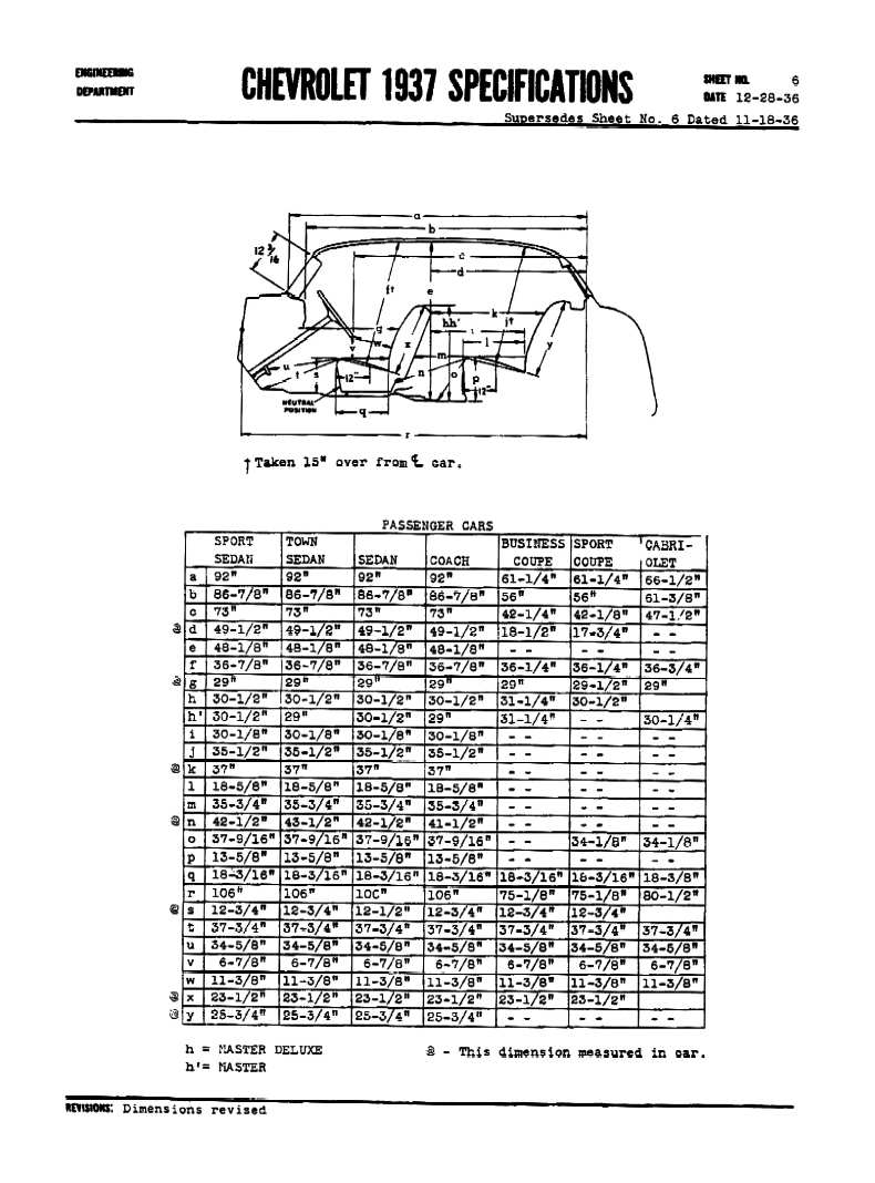

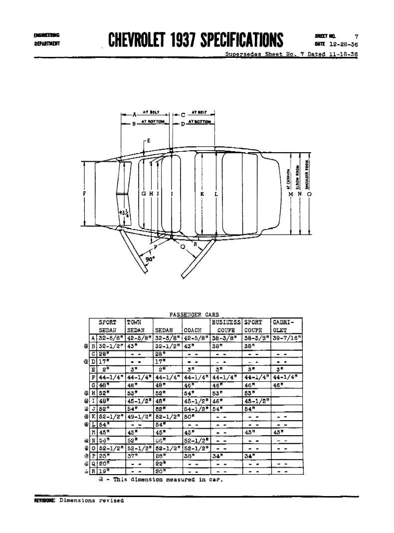

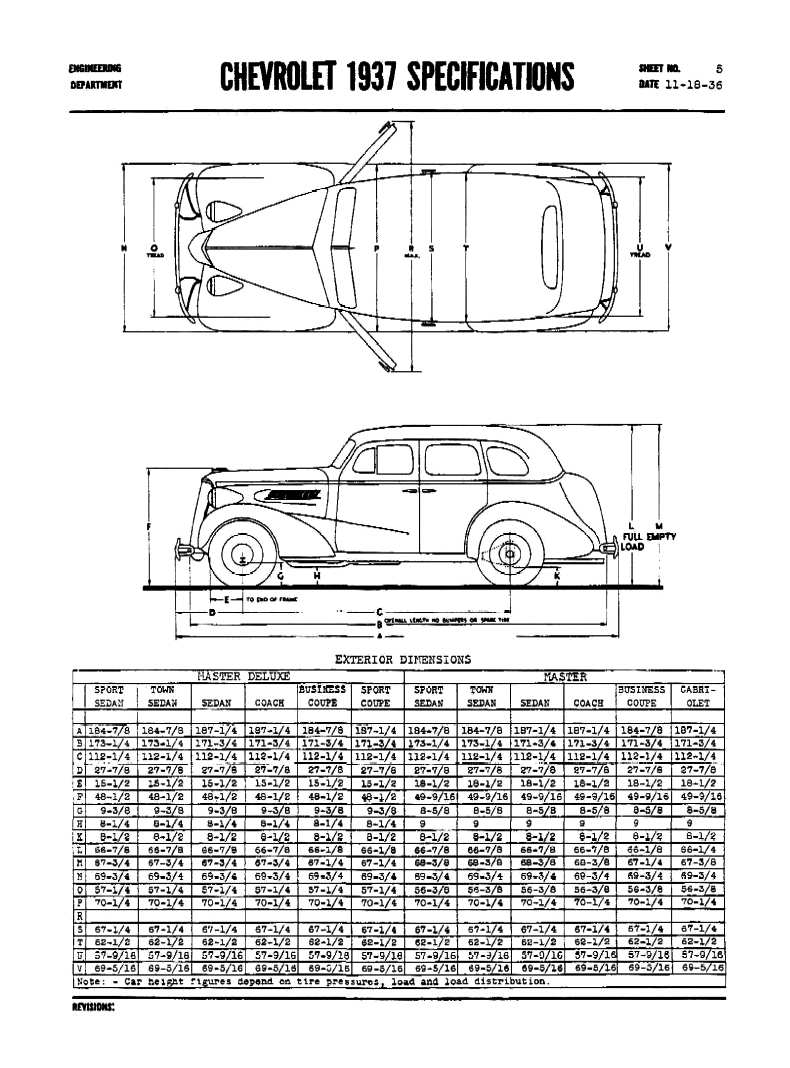

    Hope you dont mind if i jump in this thread. Seems here is a lot of knowledge for us with oldies.I have an 1935 sedan master without floor. I will start to make a new now but need some measurement if someone can help me?? Have a few pictures in my album on the build

    images-1,415.jpg Hi turbo57 here you go GDluck on your build .cheers p.s View attachment 4006688 images-1,417.jpg View attachment 4006688 you can use these pics as templates just hav them inlarged at a local print shop 1.1 scale then transfer to cardboard then to steel sheet afterwards. The measurements you need are in pdf.:cool:

    Ty for your answer speeddemon, GM heritage is a great place to find info for us with old chevy, and old chevy manual have also much info. I cant use orginal floor measurement, it will be a little different. I only need 2 measure between left and right side where i have marked, those i havent find anywhere, hope someone can help me with this DSC05951_LI.jpg DSC05945_LI.jpg

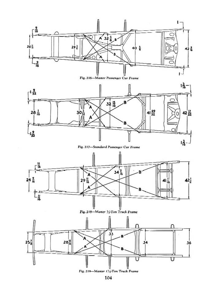

    FIGURE 217 PICTURED IS FOR A 1934 CHEVROLET STANDARD SERIES CHASSIS. 35 STANDARD HAS AN X MEMBER...............mike

    Yep and my master has a Y- K member, but i am greatful for all tips i get
