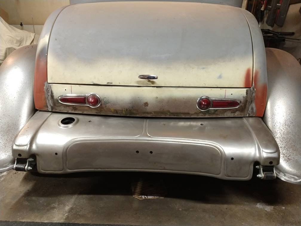

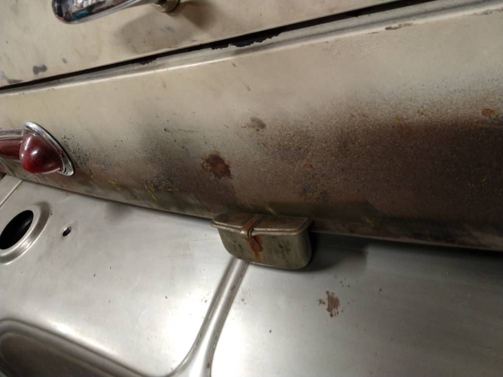

  10. Yah, my 32. Taillights are 42-48 buick IMG_20181123_191306_634.jpeg IMG_20190112_153421575.jpeg

    those tail lights really suit the early panels more so than the 39 ford teardrop or the round Pontiac light commonly used or rectangular Chevrolet lights.

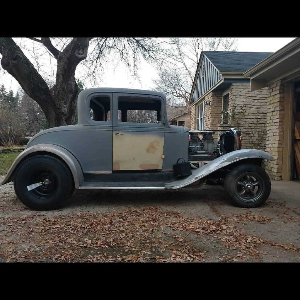

  13. Thanks guys, been a long 8 years working on her, drove it up and down the driveway last month, probably the first time it's moved under it's own power since dad drove it in 66-68

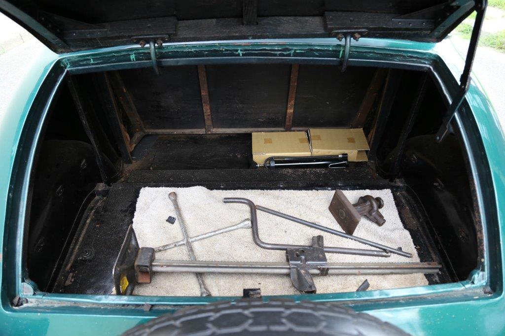

  17. Would you explain the definition of "free floating" on the rear panel below the trunk lid Mike? Or how the panel is supposed to be attached? This could be the very reason why after so many years went by on my coupe, that this panel has to be replaced AGAIN. We're talkin' 1996 for me...
    Bowtie Coupe likes this.
  18. Repop's from bowtie reproductions

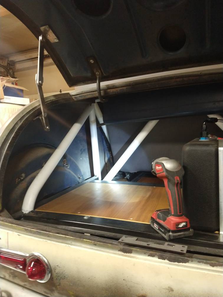

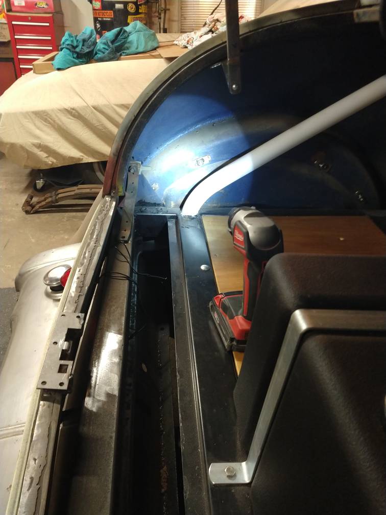

  19. This spring I'll get the car into dp60, to do a shake down for a year or so to see if anything moves as it does still retain some original wood. The wood sub rails are gone and replaced with 1 1/2 x 3 steel and connected by a 1 x 3. Plus everything it tied in with the white round tubes (8 points). Lots of planning went into the frame build and body mounting knowing what the motor puts out and how I'll be driving it. Time will tell.... IMG_20190127_104309759.jpeg IMG_20190127_104323560.jpeg

  20. RoarsRods
    Joined: Nov 6, 2018
    Posts: 81
    RoarsRods

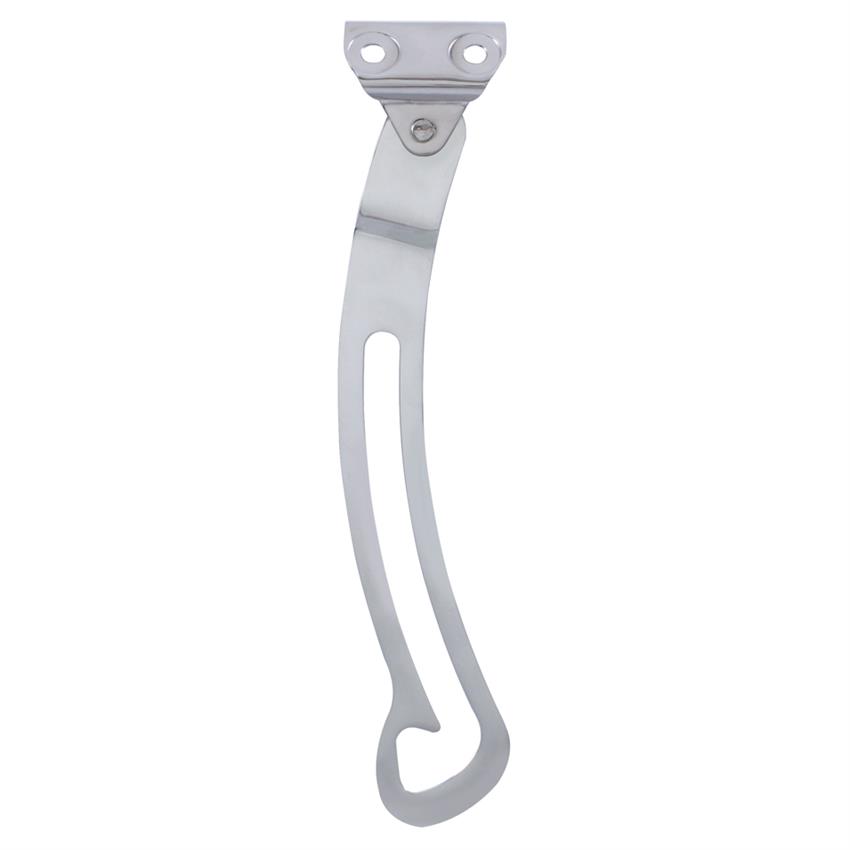

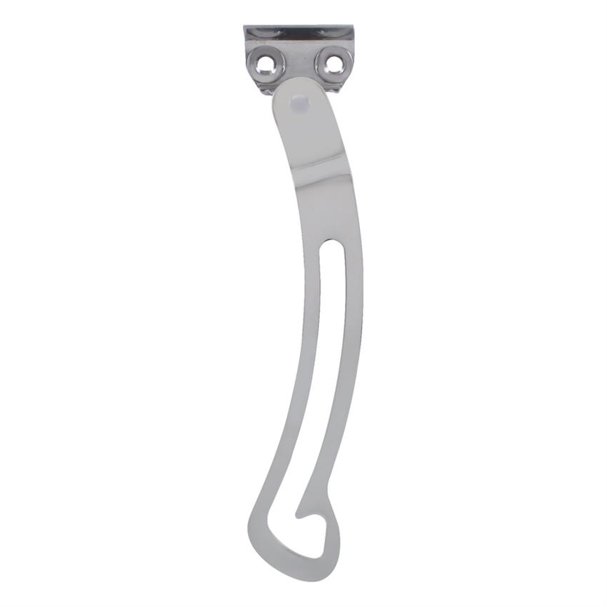

    I like that simple trunk lid support you are using on your car and planning on switch my 34 Chevy Roadster Rumble over to a full trunk! Do you know what trunk lid support you had used? I had found this Speedway United Pacific B20037 1932 Ford Trunk Lid Support Arm $49 each all SST and a pair of universal 91132632_L850_fc6ea672-29d9-43e4-9e6e-e66682026e6f.jpg 35 coupe trunk (1).jpg hinges! Plus also looking for a pair of hinges for this swap! Any thoughts on what model for a pair of hinges?

  21. madmike3434
    Joined: Aug 14, 2009
    Posts: 691
    madmike3434
    he is using the same trunk lid brace / opener holder as our 34-35 standards would be if coupes. That picture is of a 34- 35 standard trunk
    told you I have one or more, its too f---ing cold out there to search either of the sheds for it.
    Like I told you before, YOU need to flip your rumble seat lid and see if it flips end to end, before you consider your next move.

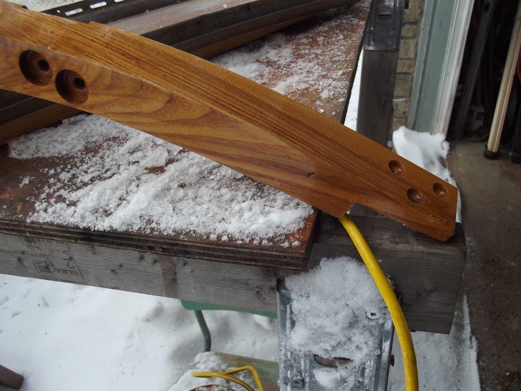

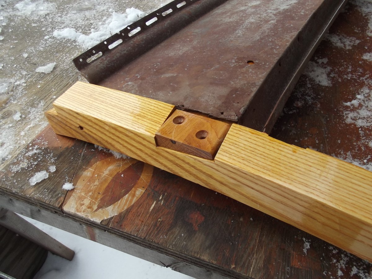

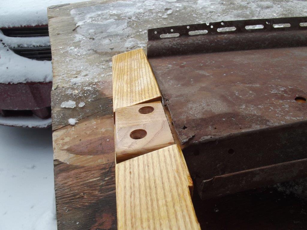

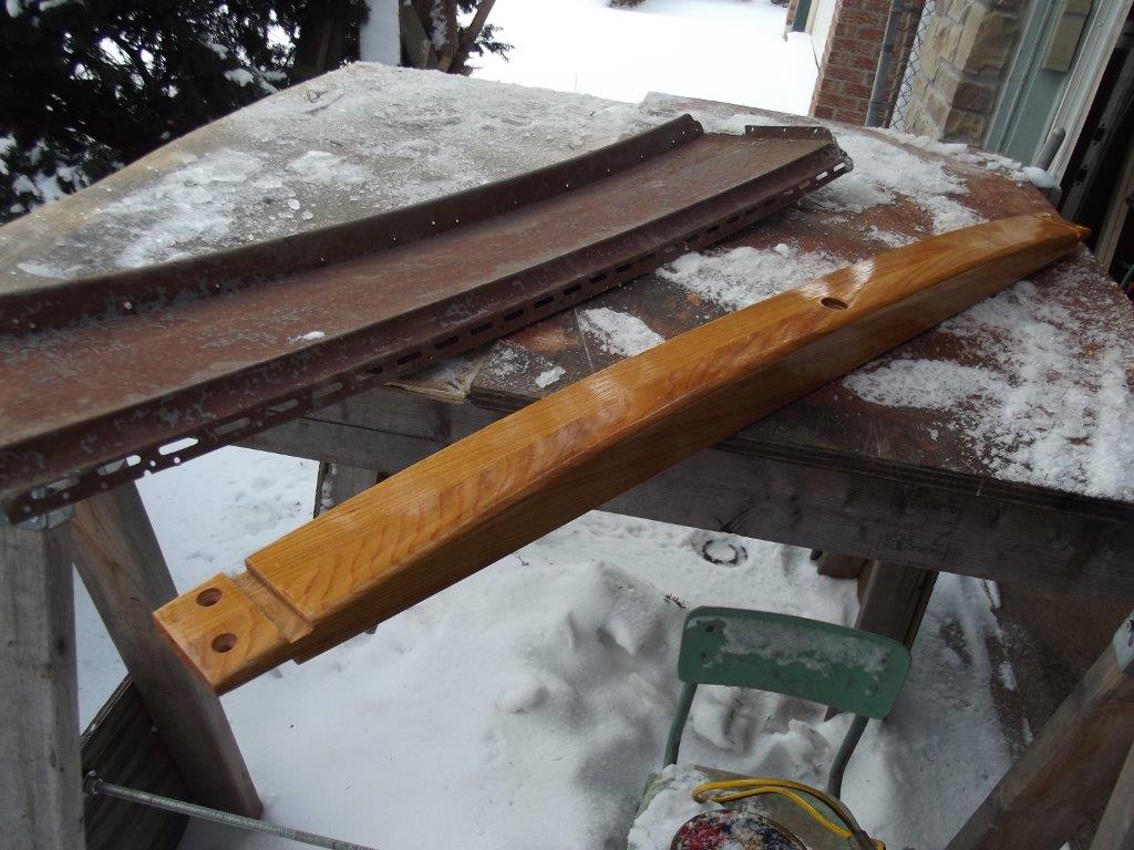

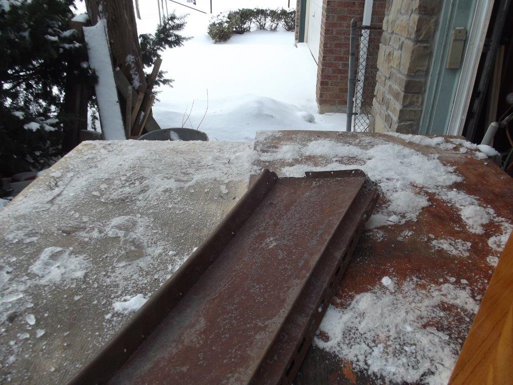

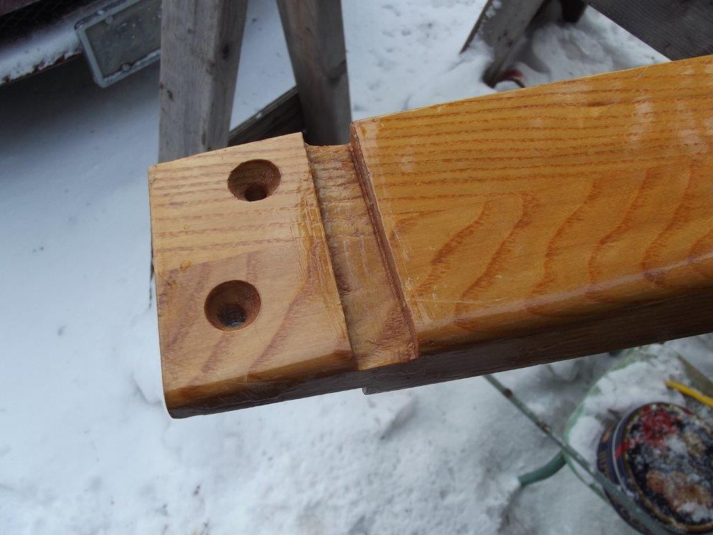

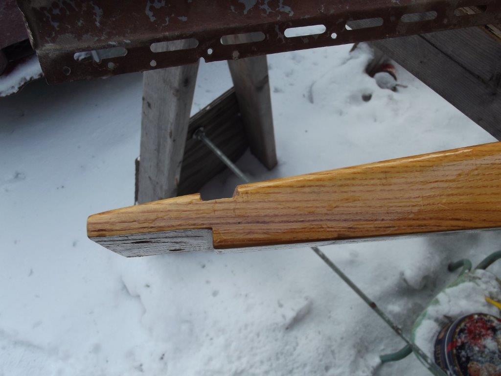

    DSCF3838.jpg DSCF3839.jpg DSCF3840.jpg DSCF3841.jpg DSCF3842.jpg DSCF3843.jpg DSCF3844.jpg DSCF3846.jpg IMG_5193.JPG DSCF3845.JPG
    I could not find the " lower panel " wood parts, might be out in one of my sheds and freezing cold, so just took what I have inside from basement and took pictures of the parts.
    These parts are for the top of the quarter panels where they join the panel ahead of the trunk/rumble seat lid.
    The bottom area is similar in that it allows the panel to "float" as the wood expands and contracts with the weather.
    31chevymike, Inspectors and PBRmeASAP like this.
  23. madmike3434
    Posts: 691
    madmike3434

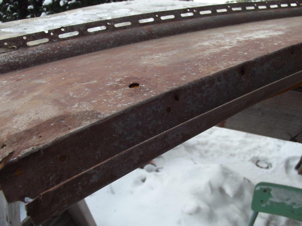

    picture # 1 show the roadster panel behind the seating area and ahead of the rumble/trunk lid. Note the ends turned 90 degrees and the original nail holes in the metal . Also notice the area where metal was removed right down to level, not supposed to be like that, is supposed to have about 3/16--1/4" metal in that area. This is the area that FLOATS in the wood slot
    picture #2 clearly shows the SLOT in the wood. I enlarged it slightly.

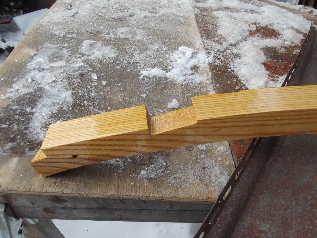

    picture #3 shows a side view of the wood part, slot on top and a recess underneath
    picture #4 shows a very close up of the wood floater slot and 2 counter sunk screw
    holes from the TOP....to get to these the quarter panel would have to be removed !
    picture #5 this is the metal panel above rumble /trunk lid, shows the water drain trough is stamped into the panel and also shows all the nail holes that would be used to attach the metal panel to the wood crosspiece.
    picture #6 this wood part runs all along the sides of the trunk/rumble lid quarter panel and nails are driven into this part thru the sides. The very top square knob looking end goes thru the roadster top holding area.
    picture #7 shows the bottom area where the panel on your coupe would be, cannot find the actual wood part, its damn cold outside. You get the idea from the top, keep reading.
    picture #8 shows the metal panel above trunk / rumble lid, along with wood piece and the wood part for the sides of the opening. All laid over each other.
    picture #9 shows a 1925---1928 ??? chev coupe wood framing
    picture #10 shows the narrowness of the gap in the rear upper panel and the quarter panel. Doesn't need much and I really did not need to open the slot.
    Hope this answers your questions as the bottom panel fitting idea , would be the same as the top.
